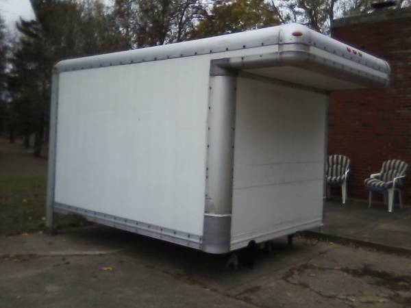

It was for sale on here a couple years ago. I found it on Craigslist and traded my 30' deckover for it a few months ago. I'm not sure why the previous owner cut it in half, but he got overwhelmed and listed it. It sat for a couple of years before I got it, so I had to strip it and finish weld it. It's since been fully rewired, new floors, insulation, a/c, etc. It started out as a 28' Pace enclosed trailer.
The day I picked it up
