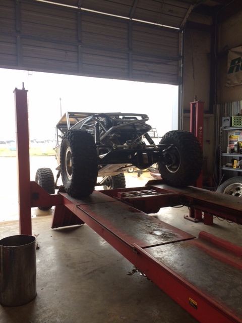

Having a problem getting the air out of my cooling system. Im running a LS1 pump, Griffin Radiator, coolant running through chassis. When I first fired up engine I had problems getting the coolant to flow like everyone. Ended up cracking some fittings loose and adding coolant, would run here in the shop or raising hell cutting donuts and not get over 195 with one fan going. thought everything was working great. Went to Grayrock this weekend and almost everytime I would get the front end up pretty high for any good amount of time it would get hot fast. Drop it down on flat ground, bleed the steam out of the fitting closest to the water pump, add a little water and it would be fine. Or I could just turn around and set the rear end up high and the air would move to the radiator, cool off super fast like cutting a switch on. This morning I picked front end up on lift, let it get hot and tried bleeding the air out. A lot of steam/air but it still running hot. Im thinking after you bleed it with front end elevated should it cool of right away or should it after you let it sit back level on the ground where air will got back to radiator cap??? BTW I have an LS6 intake so I blocked off the rear steam ports and have the front tied together, bled it at the ports also. Maybe adding a bleeded at the pump would make it easier to get air out? Figured once its out its out though? Any help would be appreciated.

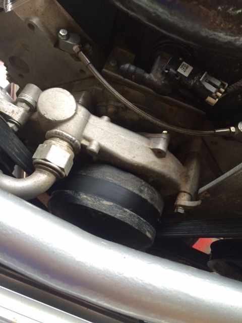

I just tried bleeding at the steam port with no luck, a lot came out at the water pump though. If you notice in the water pump pic I have spacers to make the water pump line up to the crank pulley and the WOD acc kit. One spacer is already tapped for a guage/steam port etc. Think Im going to run the steam port there :dunno:

The steam port should ideally go to the top of the radiator on the low pressure side. (Opposite side of the inlet) A lot of people tee them into the upper radiator hose though. I've also seen a lot of people plumb them into the water pump too. Whatever you do will be better than having them blocked off.

I completely agree, anything is better than just having them capped. Capping the rear ports is normal, the truck motors came that way, but the fronts should be tied together and tied into the cooling system somehow. I can't remember the vendor but I found a kit on eBay that converted the fittings to -4 and came with a hose and tee fitting to tie them together.

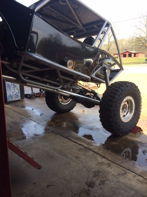

Update After bleeding what I could out of it at the pump outlet and steamports I took the fitting loose at water pump and added about 1/2 gallon of fluid. fired it up, bled some more air out. Let it warm up till fan kicked on at 195. Then I picked up front end to 75 degree angle. Took exactly 3.5 min to get to 220. let it back done nearly level and cooled back down to 195 in less than 30 seconds. Most of the air has to be gone for it to cool that fast. Im sure I still need to plum steam port to water pump but thought that was good progress. Really don't wanna plumb it all the way back to radiator.

I would definitely try plumbing the steam ports to the water pump then. I think you'll see a big difference.
