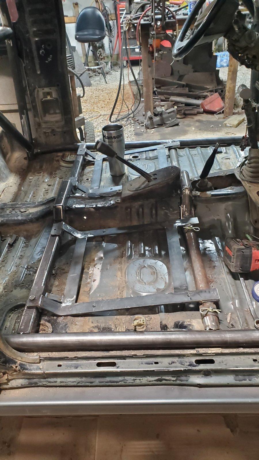

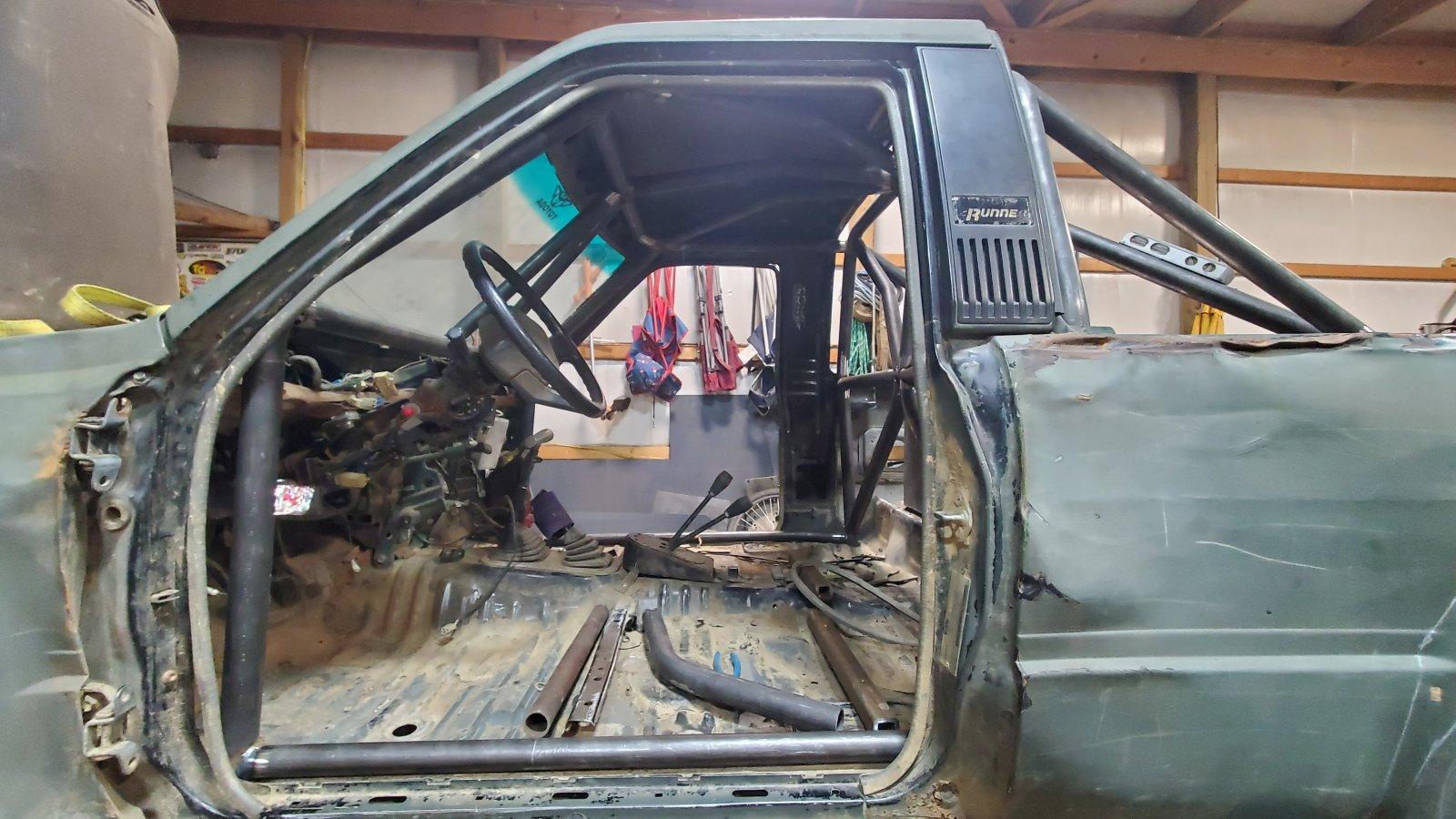

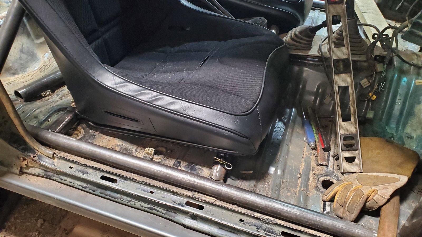

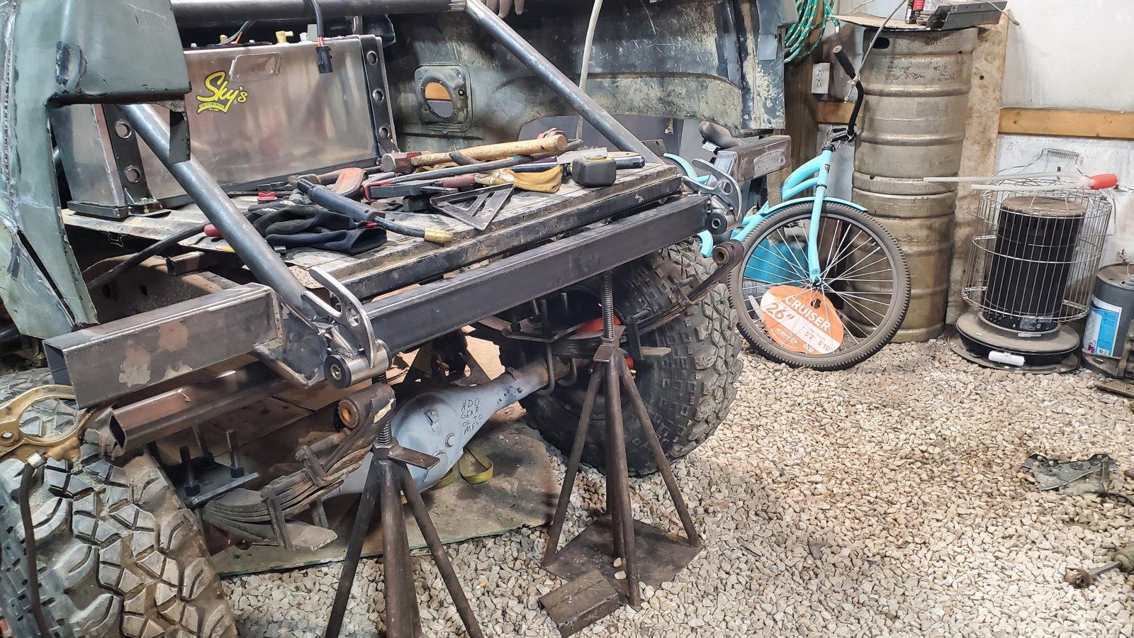

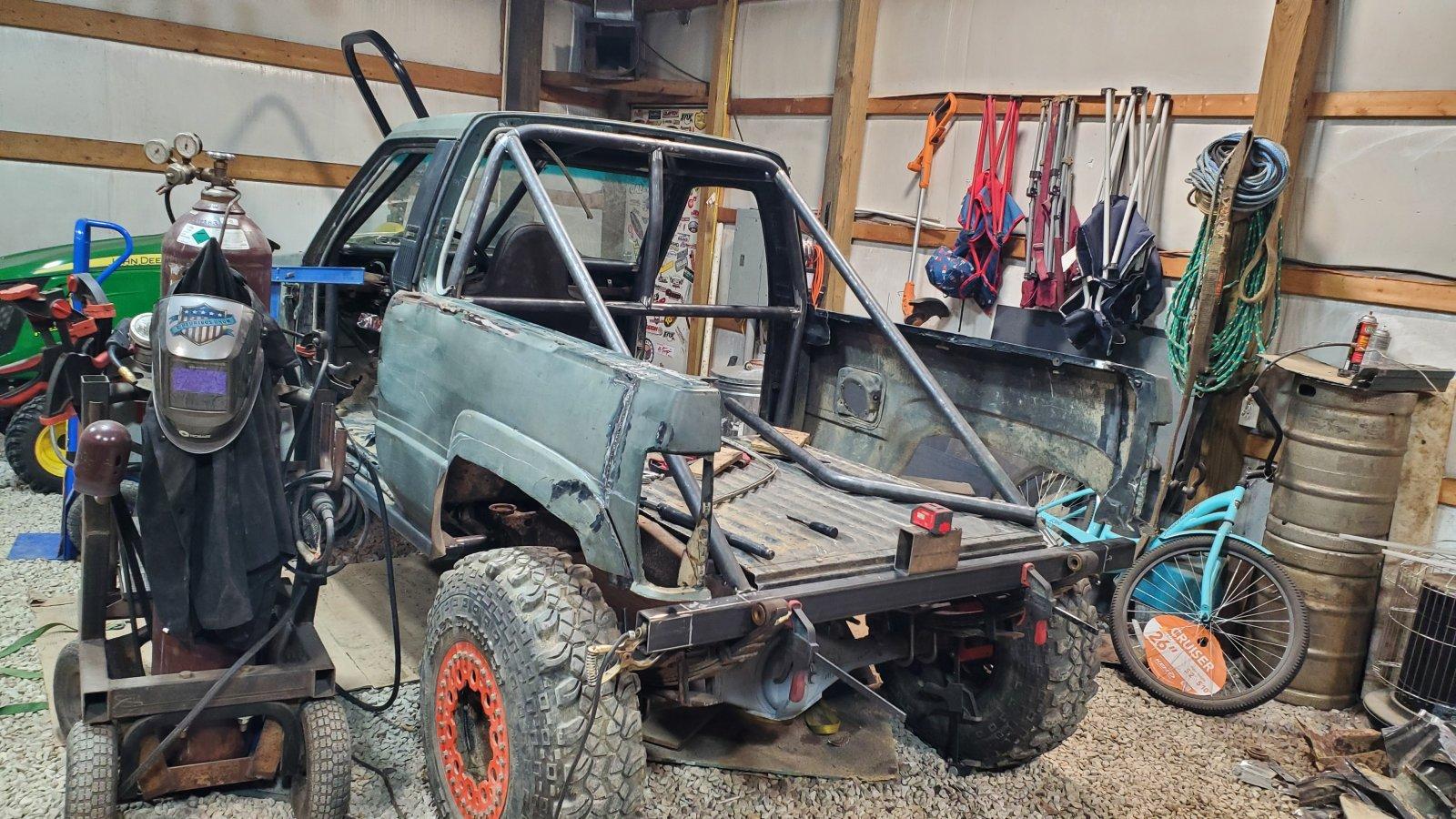

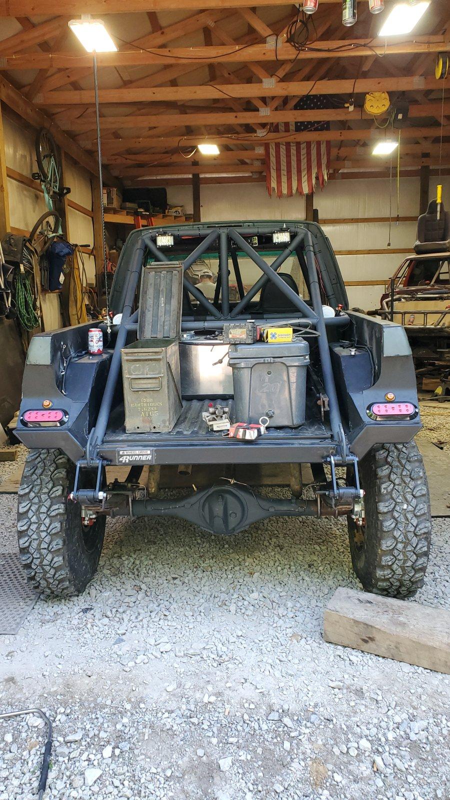

Ok, so tried to get him to come on here and start his own thread, wasn't interested YET.
It's the first vehicle he bought on his own, he got it and started wanting to do all kinds of stuff to it, I said no. Reason, he needed to learn from the build process.
As it sits today rebuilt 22re stock, stock trans, into toyota to dana 300 case, ****ty cable shifters I had laying around. 5.29s welded rear sparten locker up front, ifs/hub brake swap up front, cross over with 5th hole mod. Typical yota stuff.
