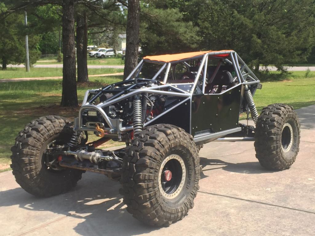

Copied an idea on here and made a roof. It was supposed to be for rain but the shade will be nice too.

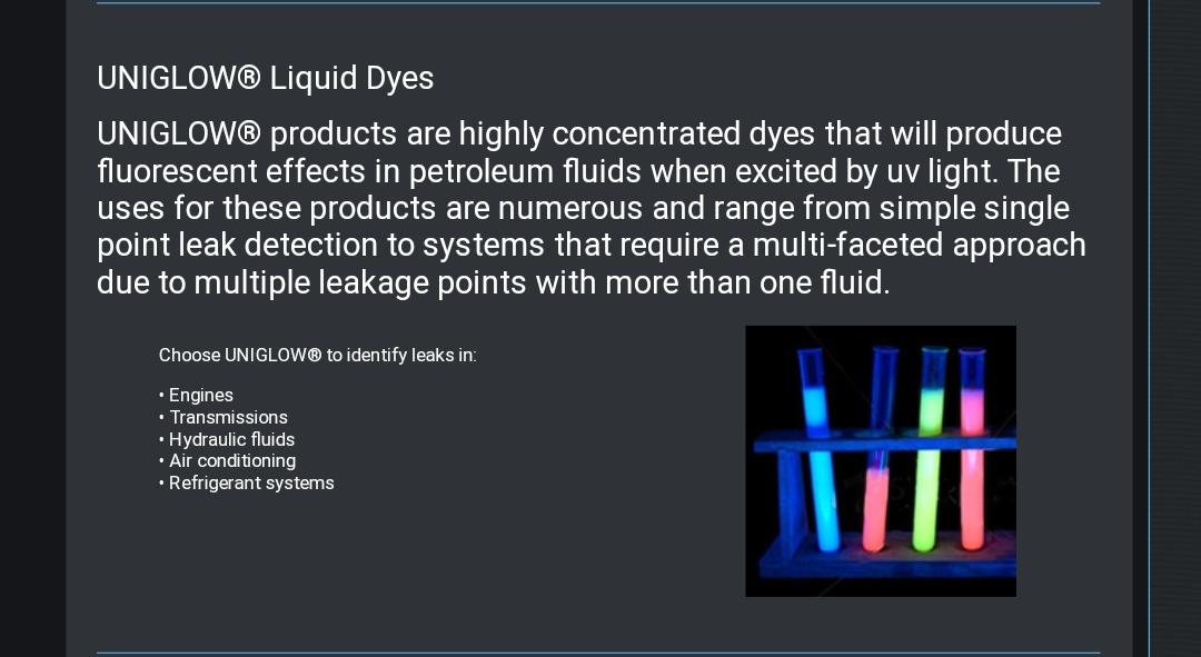

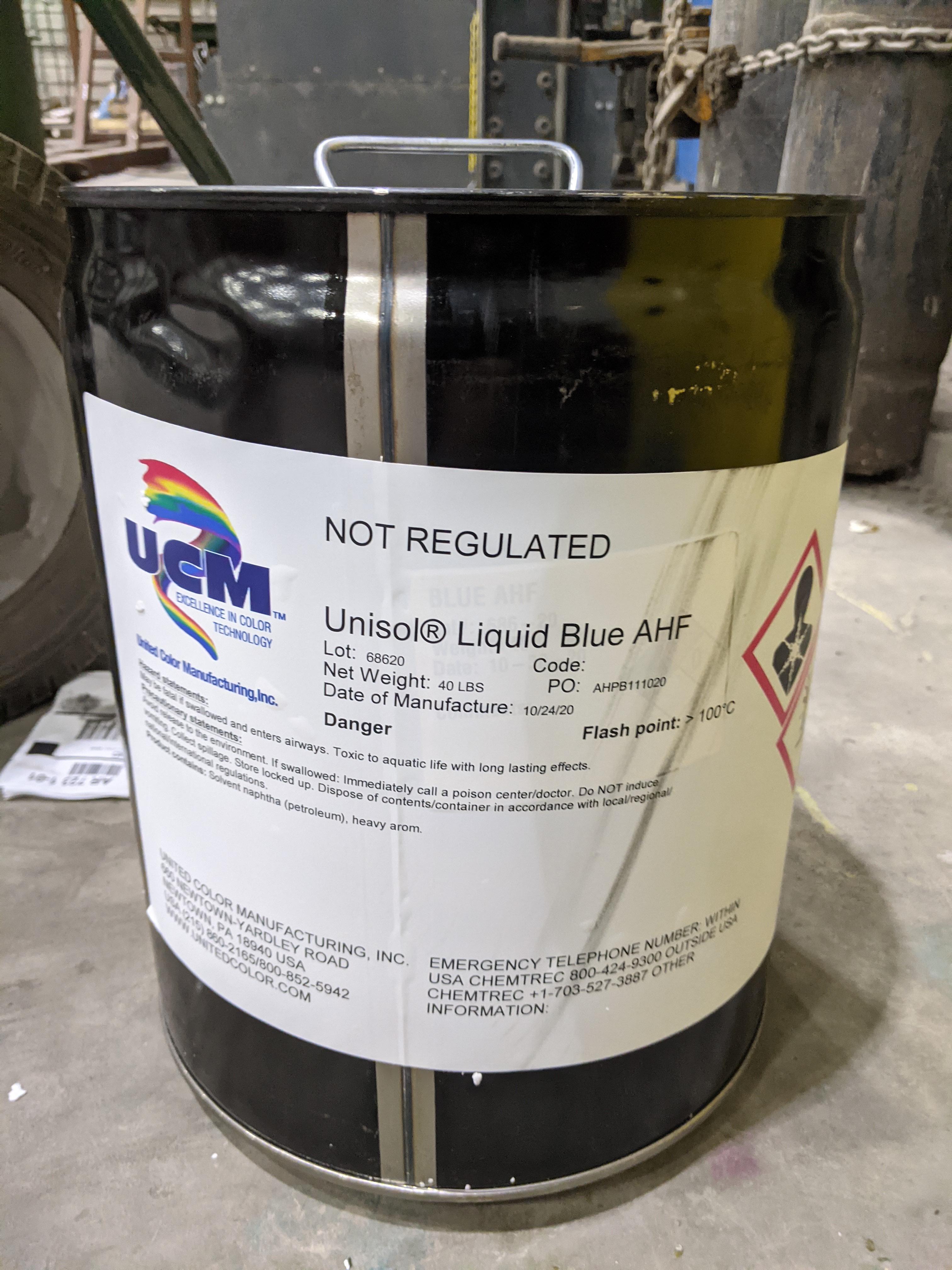

Ed has told me that as well, but I always have ran a quart of Dexron for it's color value on the stick. You cannot see it when it's all clear and the red tint is just enough to see it

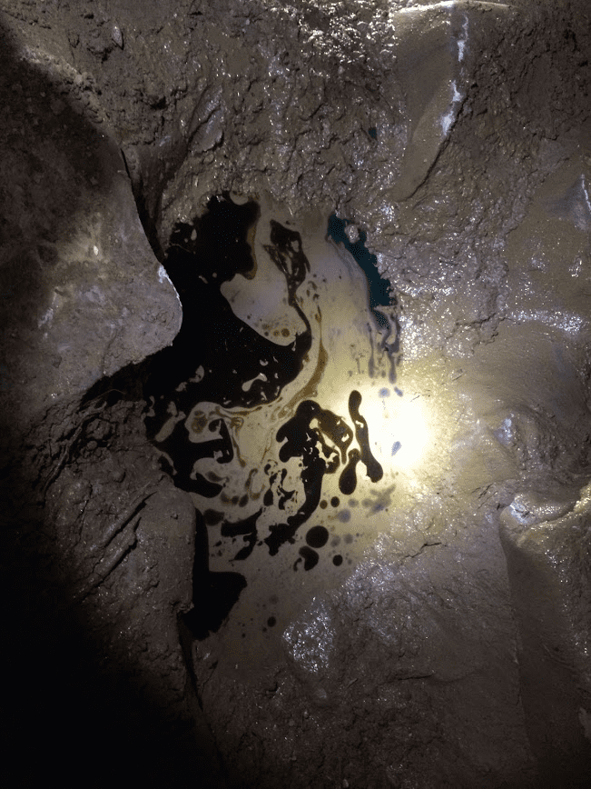

To add color, ask @Dirt700 for whatever fluid coloring he uses. It doesn't really show in the picture, but the fluid at the top right of the mud puddle was an odd color green/blue.
I saw this machine at Hale Mtn one time and it is very nice. Love Jduck's work and would love to have one of his chassis.
