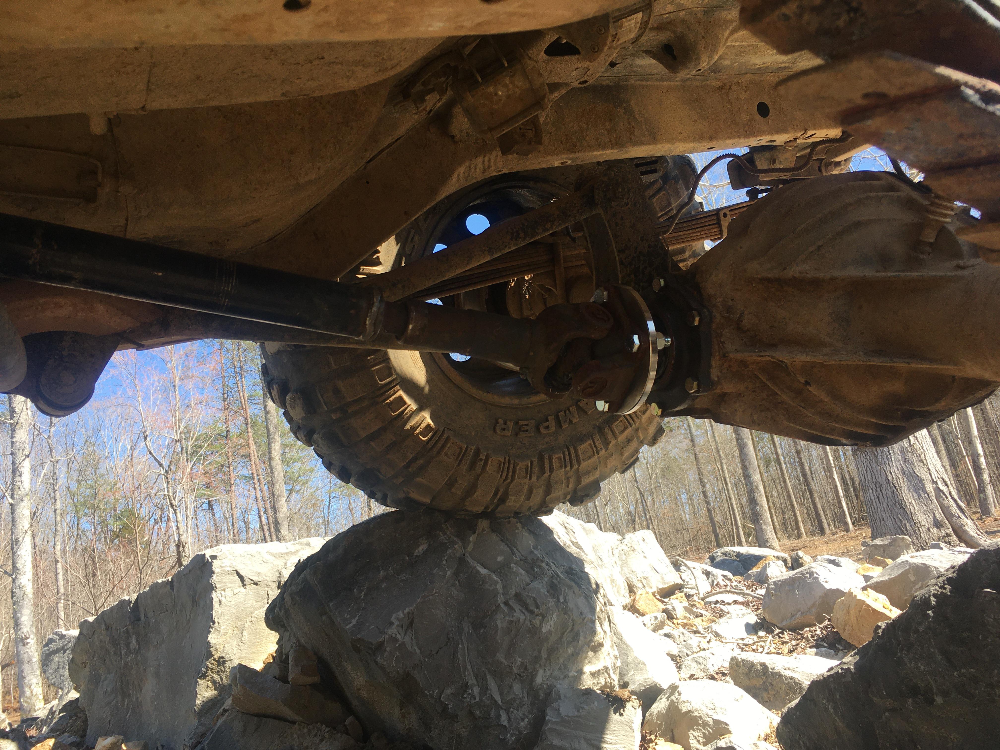

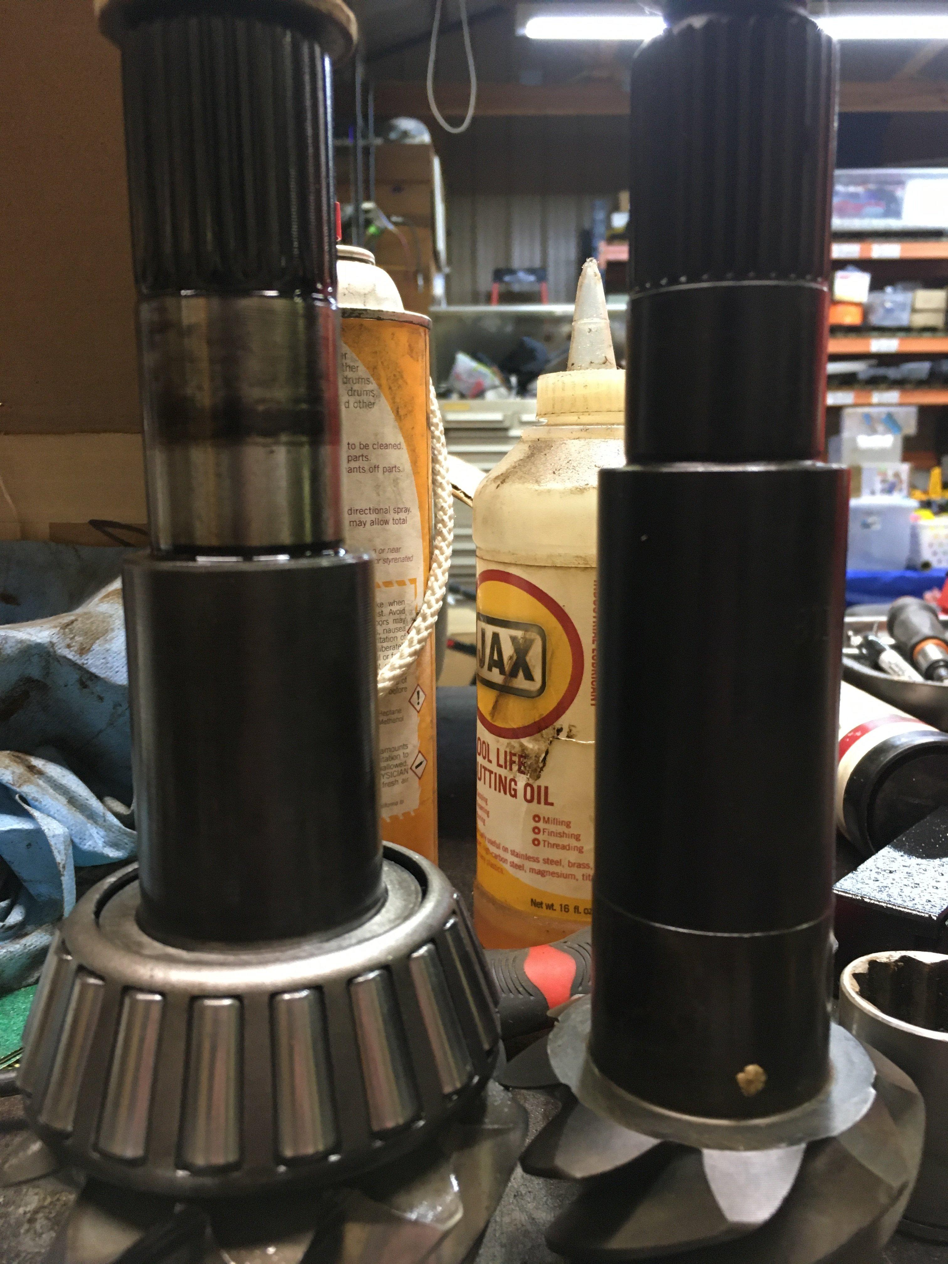

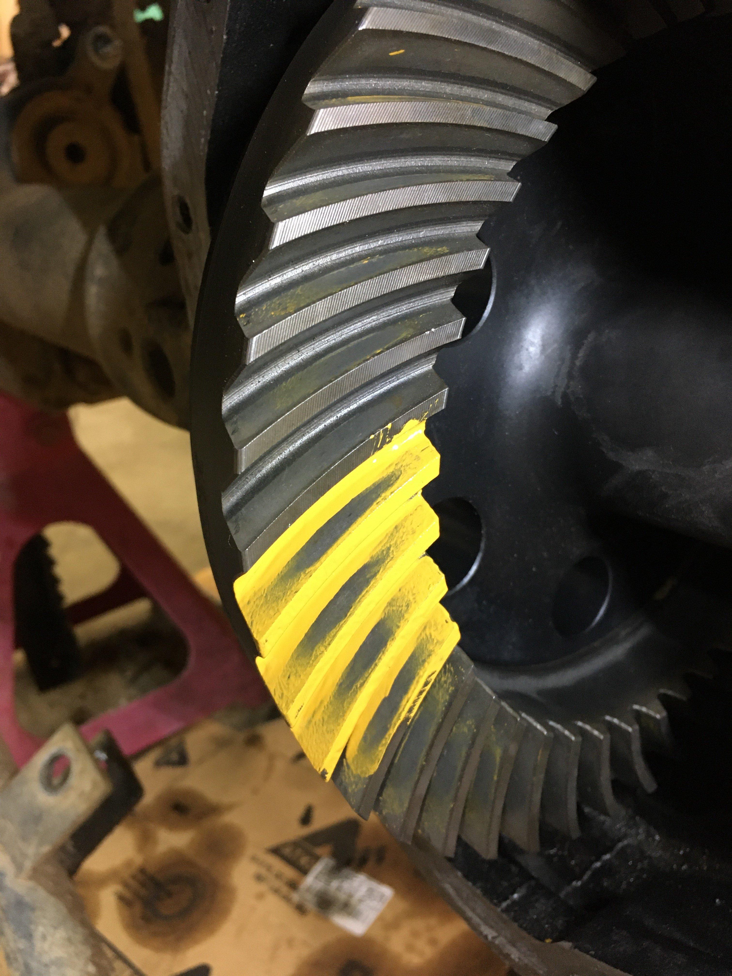

The Luke brought Just another XJ down to the house for some 5.38 gears and a few other fixins,
Put a full spool in the front at the same time as the 5.38s, since he got a screamin deal on some thin gears and needed a new carrier. Easy bonus is the old style gears don't use crush sleeve like the new Dana 60s.

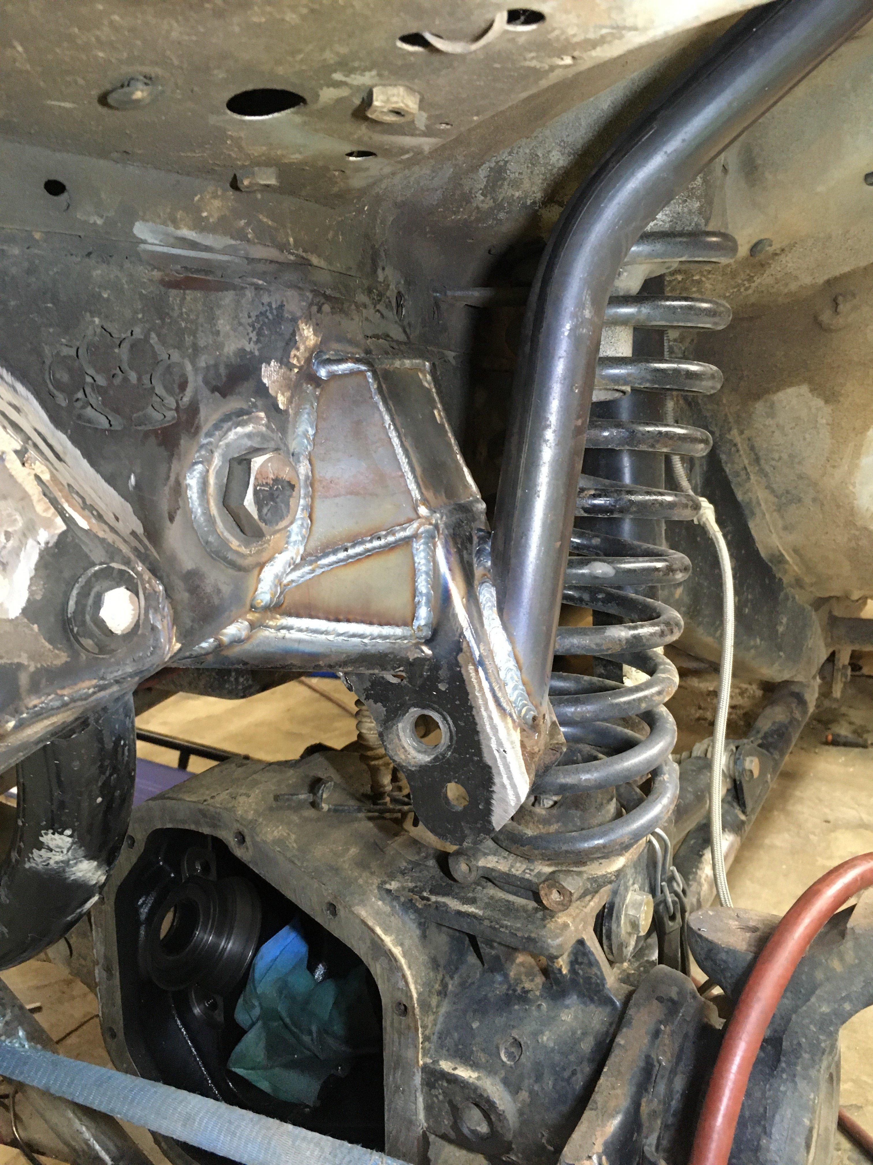

I plated the bottom side of the unibody "frame rails" and some more welding around the frame stiffeners and random places, and boxed/plated/tied the panhard mount on where hopefully it will quit trying to get away.

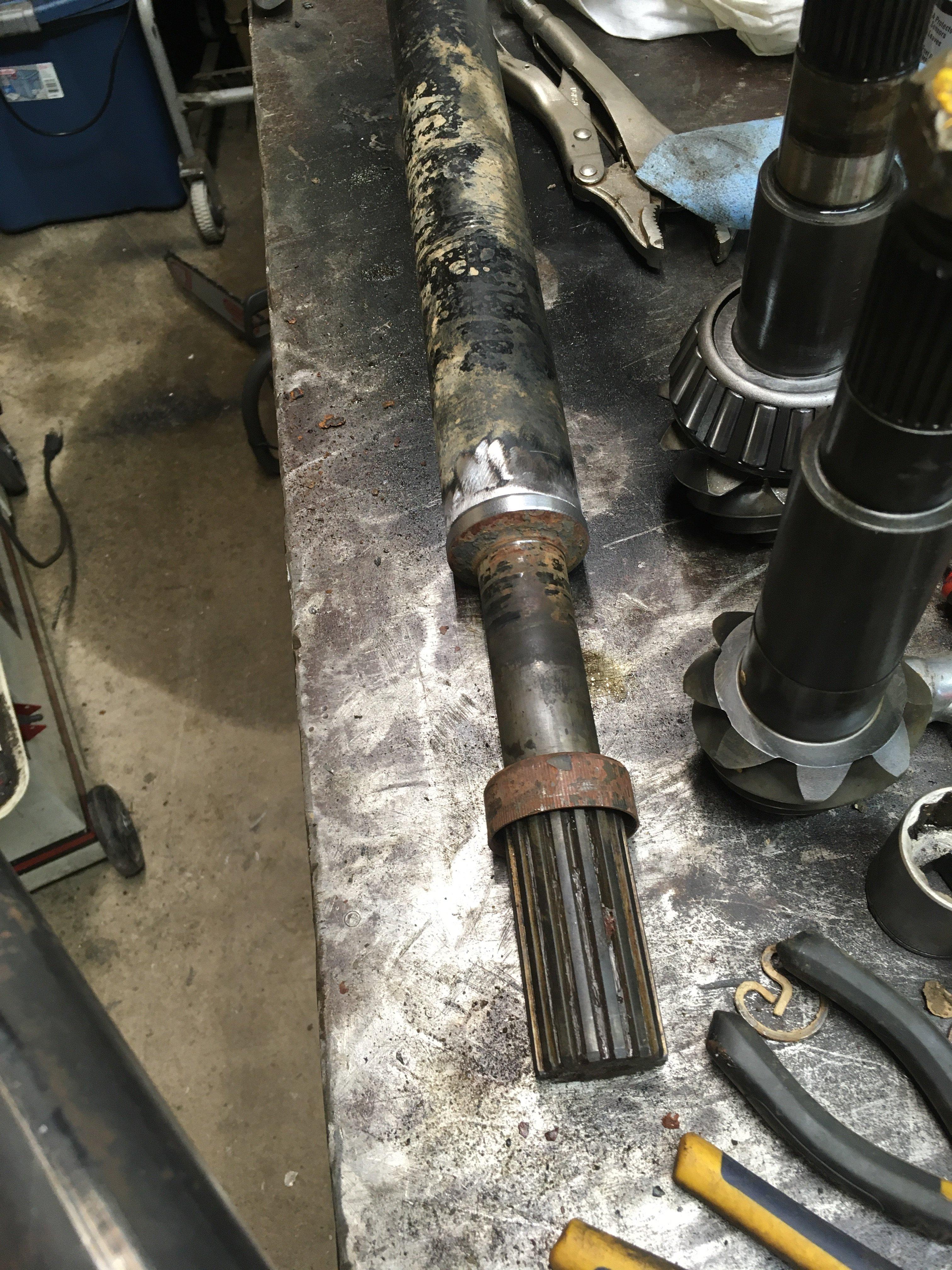

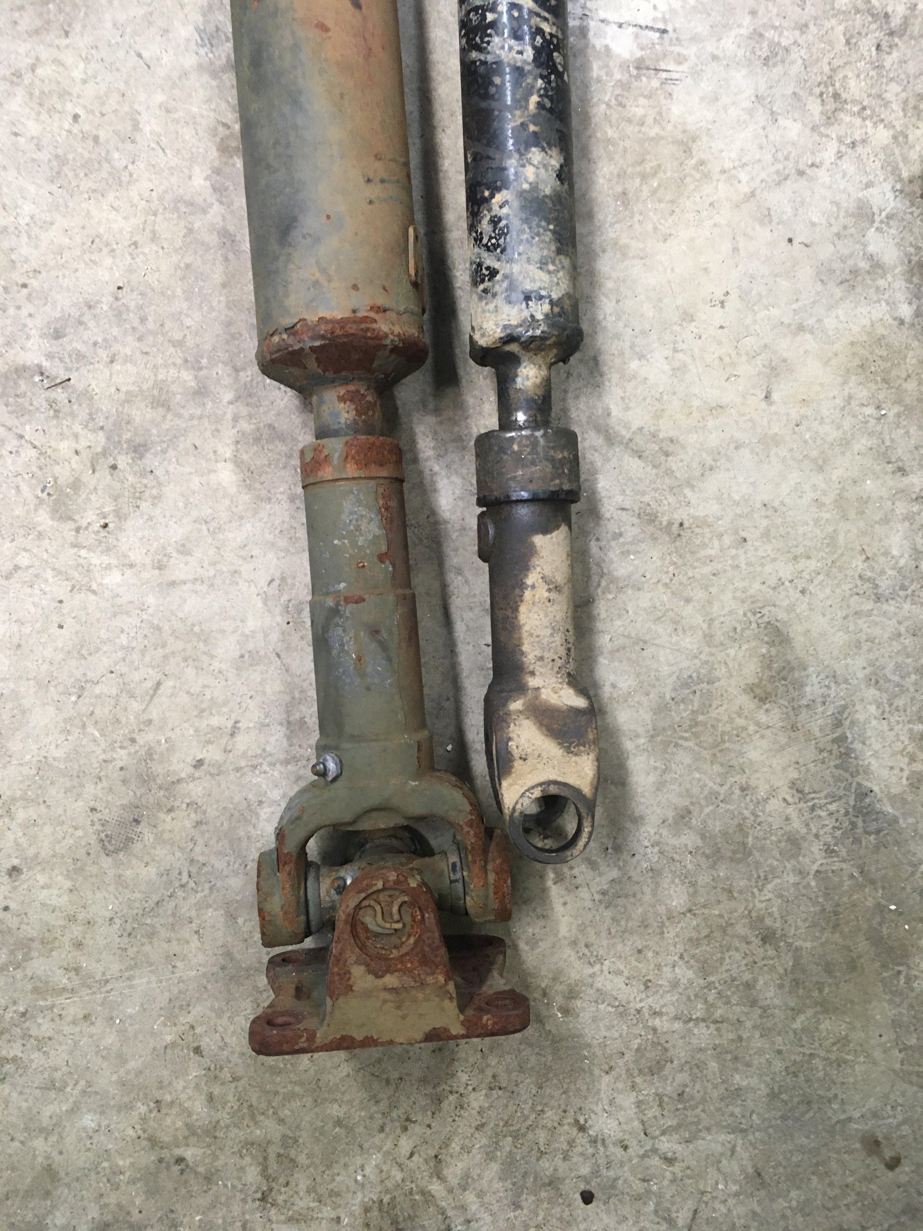

When I got the the back, the 1310 slip spline was twisted and locked up tight, and the 1310/1350 bastard joint was trashed. So Luke went on the hunt for a 1350 slip spline/yoke/ujoint that we could get quickly and get together in time for CFR, the pinion guard was trashed also (it was light duty 1/4" thick one)... I dug around in my stash pile and found part of an old Rockwell driveshaft that had a good spline and ujoint already together. So a call to Northern and we had a 14 bolt/Rockwell flange on the way. Yes, the spline is about the same size as the driveshaft tube
Markrobinson
Aug 13, 2010
594

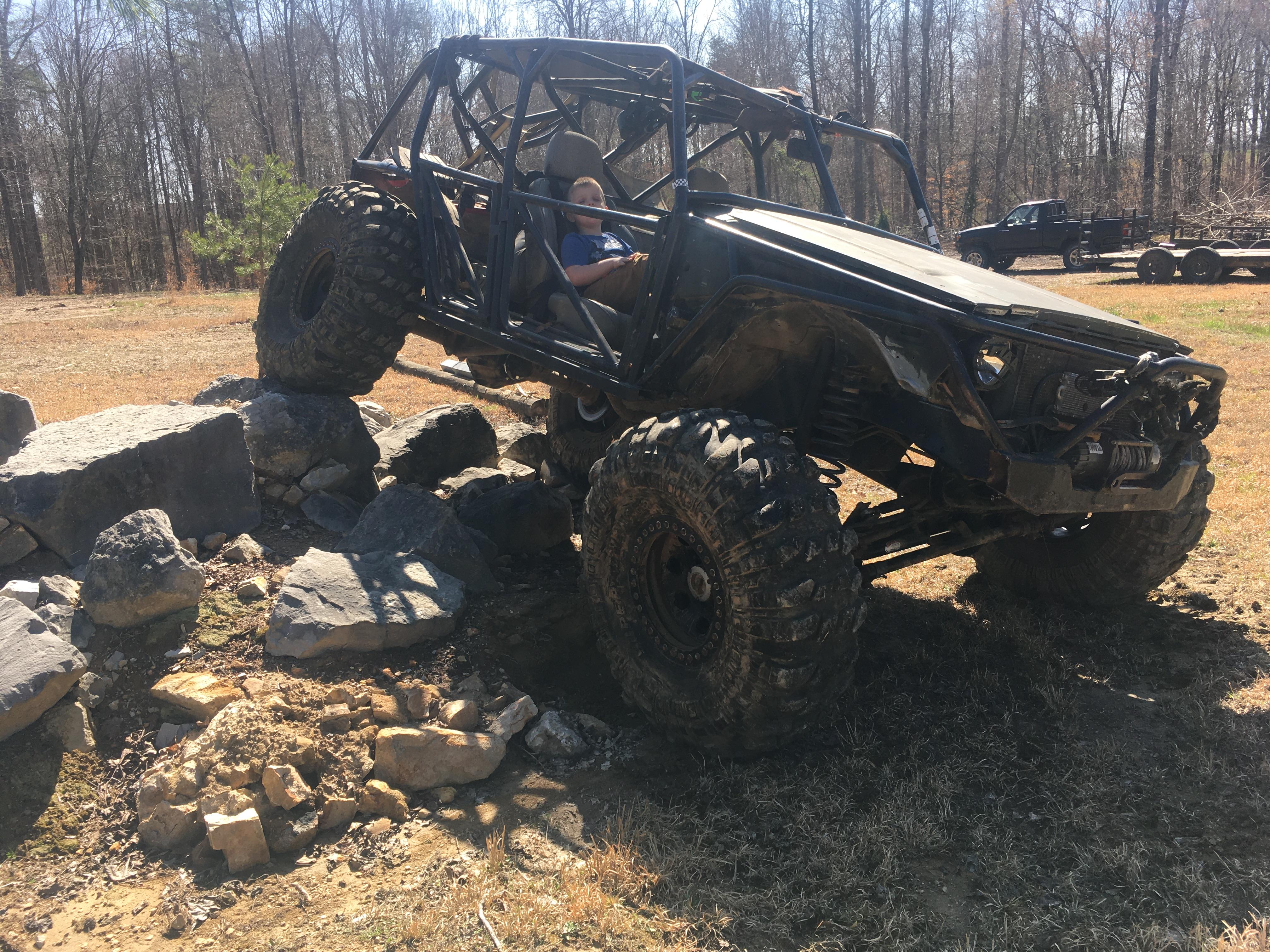

Got everything buttoned up and took a little (mile) road trip just to see how it drove and did some rock pile flexin and ditch crawling the woods behind the house.
View attachment 122972View attachment 122973View attachment 122974
That dang 1410 flange is so fancy it’s got it’s own rock light! I swear the brightest light on this thing shines right there.
I didn’t hang around to see any beat downs, but it sure seemed happier with the low gears.

I've only driven a few vehicles with a 4.0 6cyl, none of them in the woods. 95% of my offroad driving has been in 4cyl rigs with 200:1 crawl ratios, or rigs with 6.72 gear rockwells...
When I took it down on my trails, it definitely seemed to have acceptable low range gearing. I reckon if you were going to do BIG rocks and super technical crawling it might need lower tcase gears/doubler?
When Luke loaded it up on his bounty-hill trailer ramps (anyone that's seen his trailer will understand), he said "Wow I didnt even have to hit the gas!"

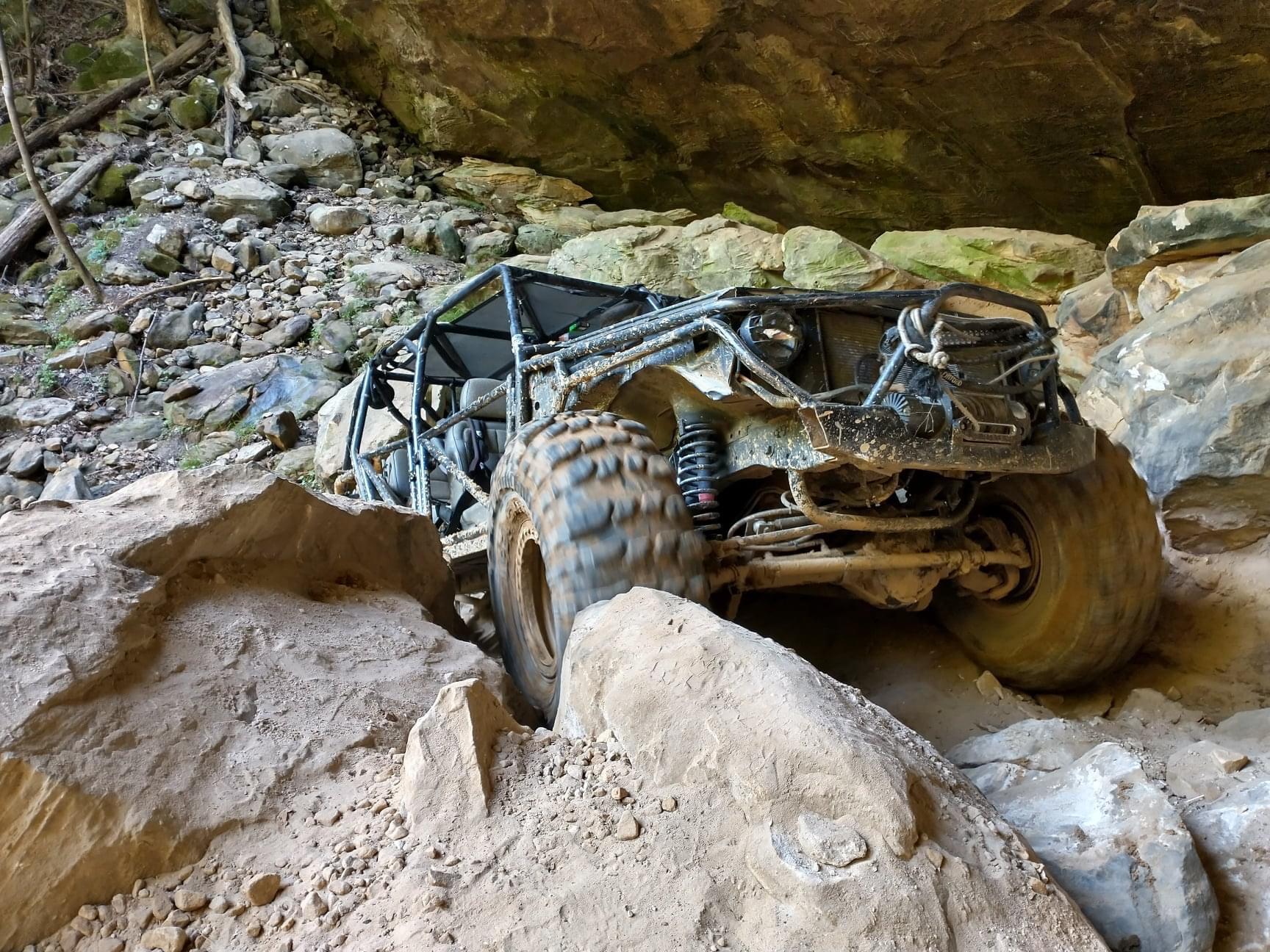

@TBItoy thanks again for everything! The Jeep turned out great. Super responsive and makes the Jeep feel like its back on 33’s.
i think you’re right about the possible doubler if in some super technical stuff. But for most southeast wheeling, I think it’s pretty spot on.
Overall the Jeep did great. Had a few minor issues. Need do work on some better spring retainers, limit straps and shocks. Also my 15+ year old inline fuse holder melted. So it left me at 1am with no lights or winch. Luckily my one headlight through the factory harness worked and got us back out.

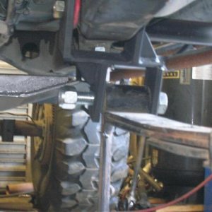

Alright, so I chopped up some ford shock towers, welded in some bumps and even bolted on some bk limit straps. Came up with 3.5” up travel and 7” down at the shock.
