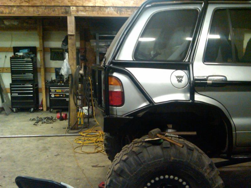

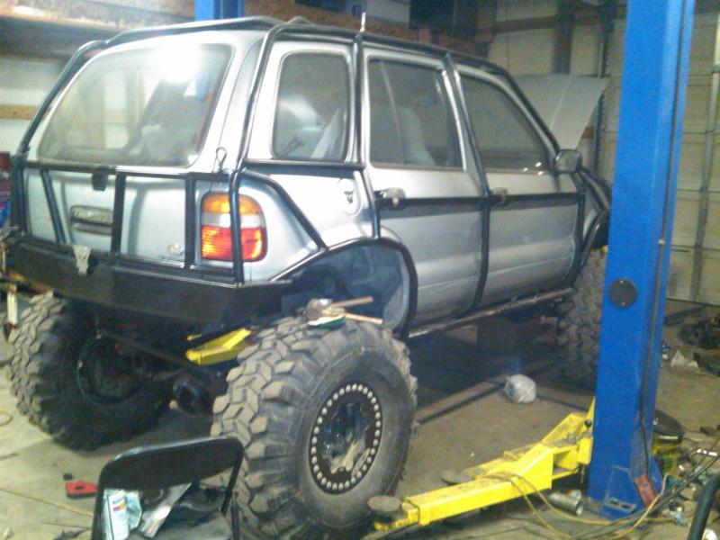

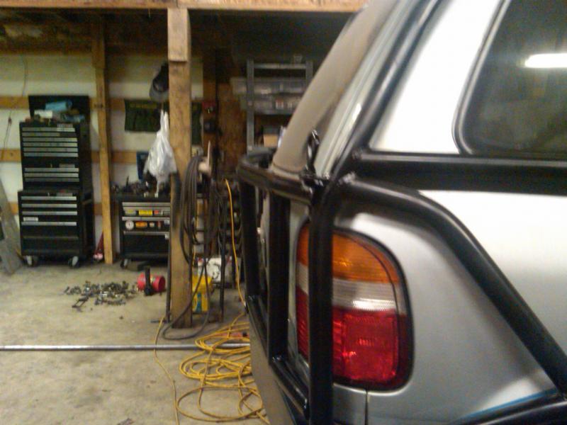

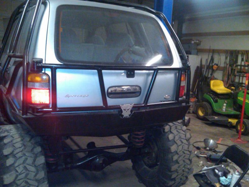

So I got caught up on all my projects and got back to work and got the trunk latch done it latches with the factory latch from the stock one and I put a pin in it just in case that fails for some reason. The passanger side is all buttoned up and painted, I knew it was sitting a little too long cause all the fresh shiny tubing was getting rusty but here is a few pics and its on to wiring tomorrow I got the Gm harness all thinned out and ready to drop in and everything is wired in the chassis besides the temp guage and all the dummy lights. I also need to flash the ecu so I dont have to mess with the vss and the passlock system but I think Clark might have the answer for that so we are rolling again. Oh and I got a full hyro steering setup for it just need some high steer arms and that will get thrown on there. woo hoo :bananadance:

freakin outa control jason!!

That's a big paper weight. :haha:
Why didn't you just build a driver cage for it and beat the hell out of it? Is that your favorite body style, and you dont want to hurt it?
Top notch work though:awesomework: Pictures of anything else you have turned out? :corn:

It is a big ass paper weight right now :fawkdancesmiley: but maybe in the next few years it will be a wheeler :awesomework:
I built a full cage so that I could keep everyone safe not just myself and also keep all the glass in it and keep everything working the way it should. I didnt like the body when I got it but it kinda grows on a person.
