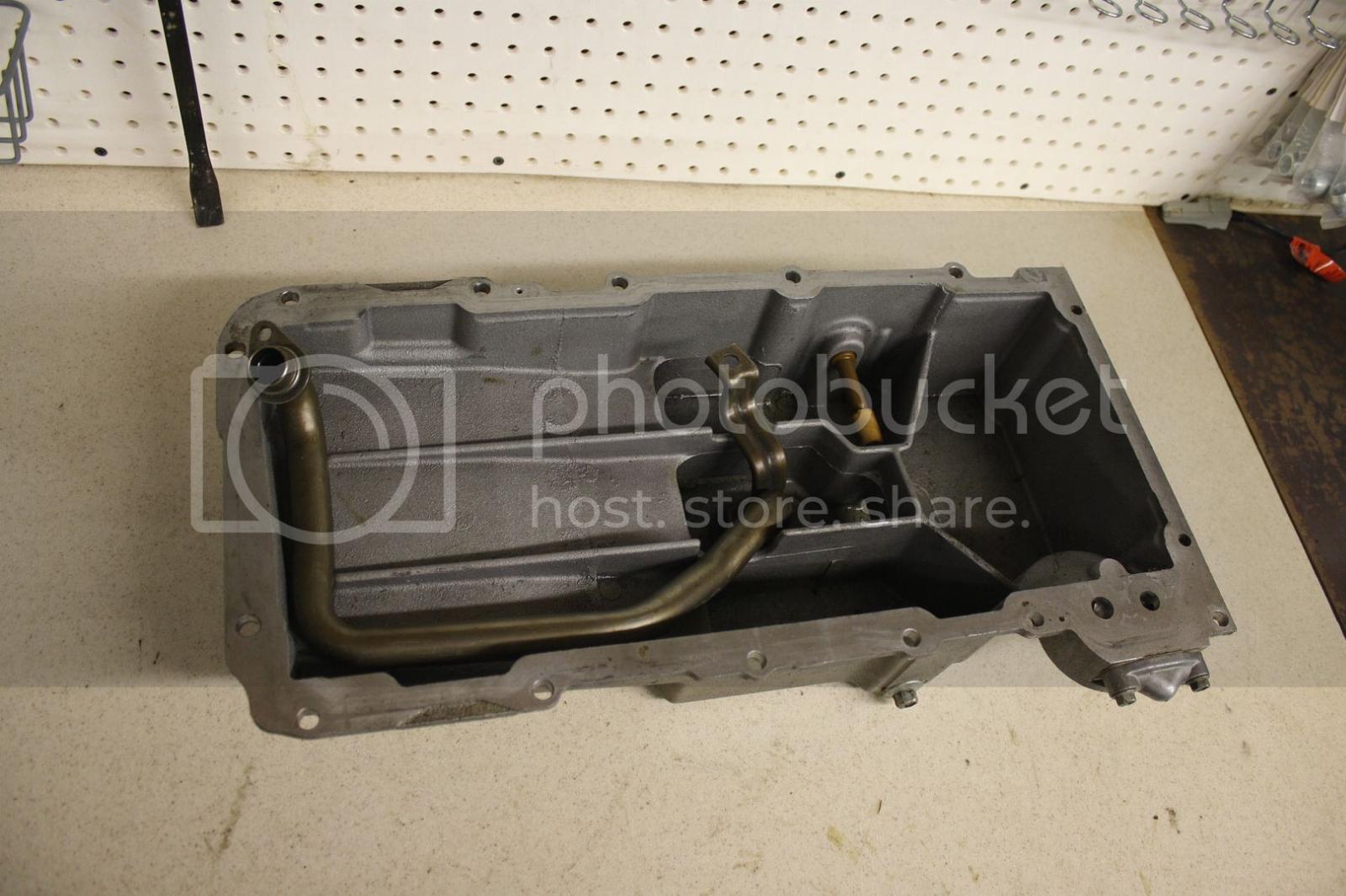

I've got the ls1 oilpan for my 5.3, but i started reading about oiling issues, so I thought id ask what yall are running? :afro:
InDaShop said:I used to still lose pressure pretty fast with the Kevco, it wasnt instant like the stocker. I believe Blase had the same experience. Just saying dont buy the Kevco and thinking you are 100% fixed.
Beyer said:I have not been upside down with new motor, but have had it up and down Viagra, wailing wall, and a few other steep obstacles and the psi has never even budged.
Maybe I am just lucky???
Or just that damn good!
InDaShop said:No you are just that good. Upside down it dont matter. Even an Accumulator is only going to buy you a second or two upside down. Its steep forward and on your sides that you are compensating for. Steep rear should really never be an issue with a front engine buggy with the pickup at the back of the pan.
