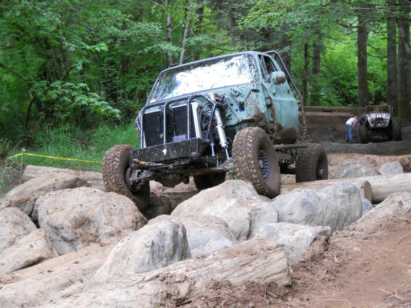

They dont start bulging till you get under 10 psi. I have no problems with the runflats, I have ran one at zero on the trails. There are pics of my Chev if you search some threads.

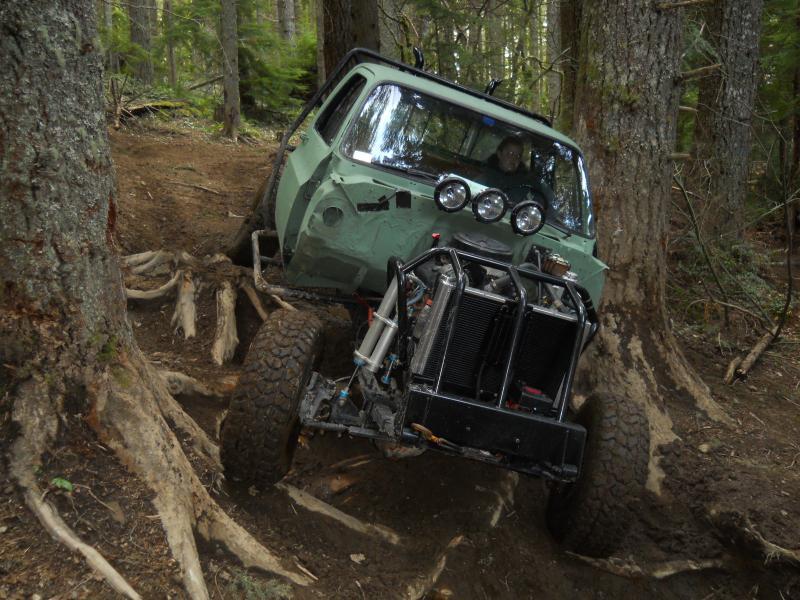

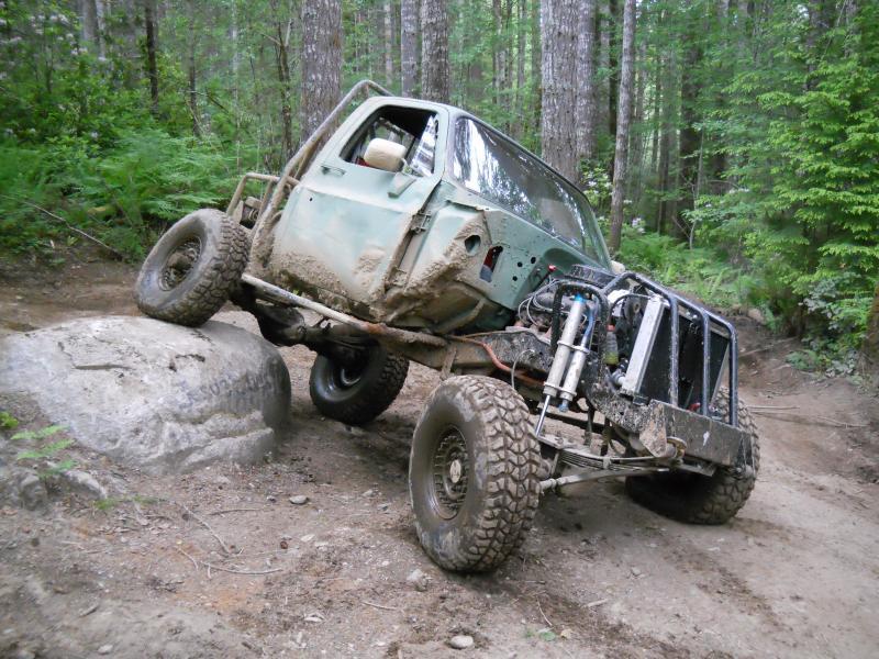

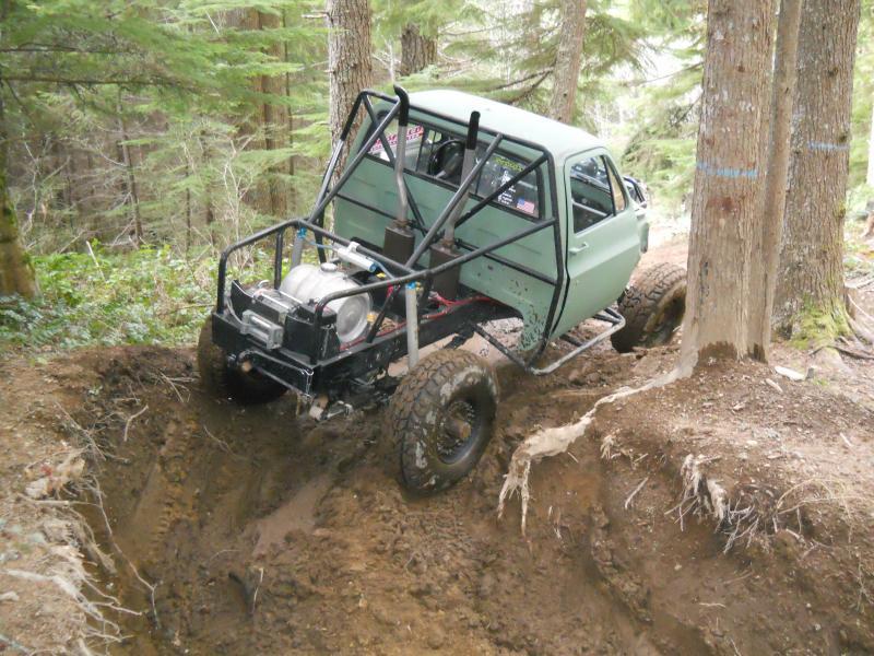

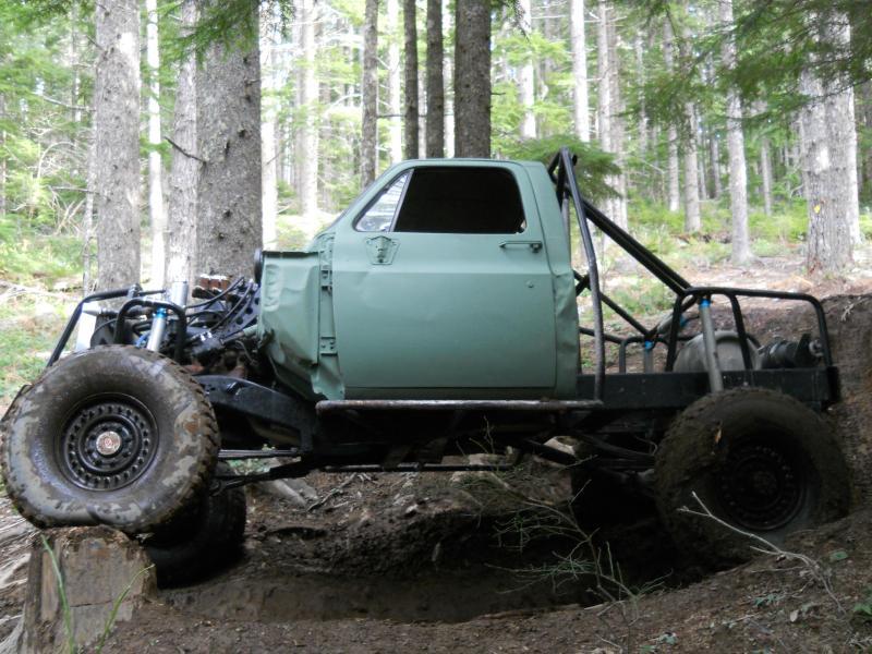

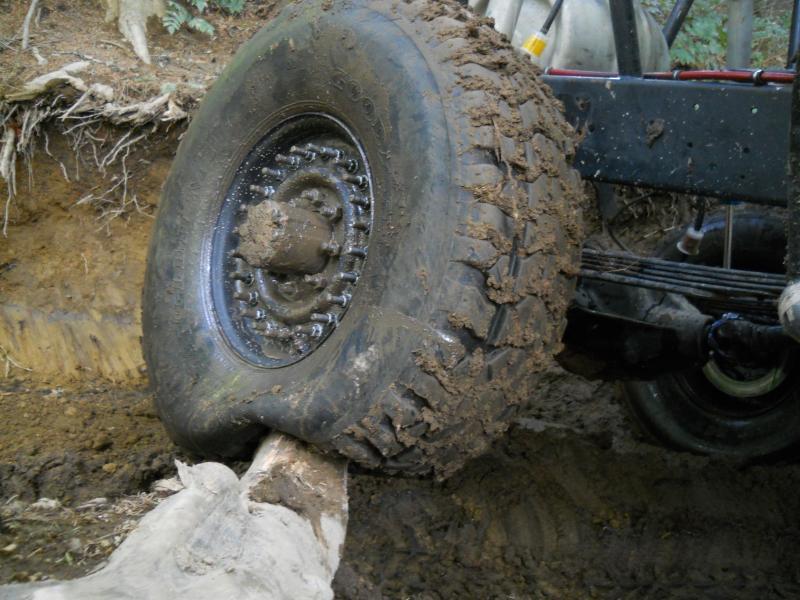

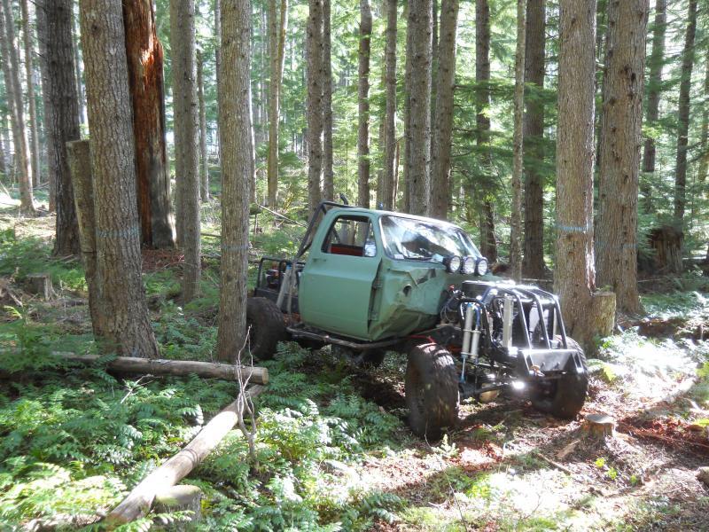

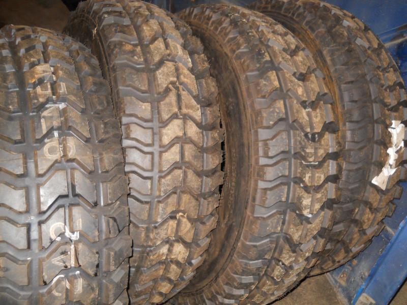

I ran all of Elbe, Evans, Tahuya, Straddleline races, CORE challenge and snow runs with the surplus tires and they are pretty good for radial 37s. If I dont sell the set I have now, I will be running them when the snow is gone

I have some SRW hubs and recentered 12 stud H1s to go with the new set of Goodyears so I can go back to Evans when it reopens :awesomework:
Im going to leave the tires ungrooved and run lighter magnesium inserts. The full rubber ones are alot heavier.
