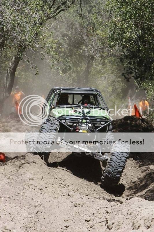

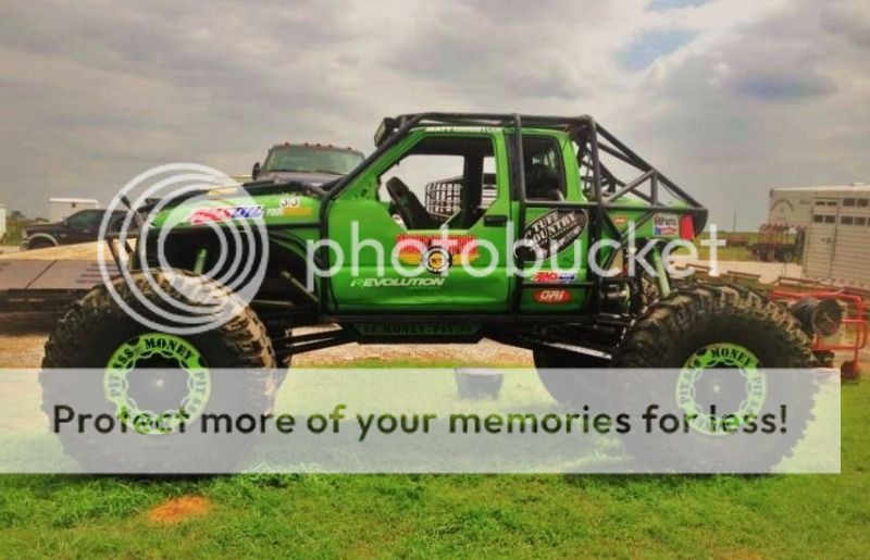

Okay well here is the situation... Many of yall may have seen my last build (money pit) which was actually the TTC champ in 2014. Well after ttc my lil girl was born and now it's time for a 4 door to accomidate the family. My first idea was a tbss so I bought one with intentions to build right after ttc. Well life got in the way and I bought some land and house and other stuff so I have not had time or $$ to do a build yet. Now that those things are about wrapped up I'm getting close to starting. I have had a guy hounding me to buy my tbss so I decided to look for a 4dr Colorado and I found one Dirt cheap so I have decided to continue the money pit theme! The Colorado will be a lot more capable than the tbss woulda been due to being able to get the cog down lower and not worry about bustin all the glass (I'm still worried bout crushing the rear doors).

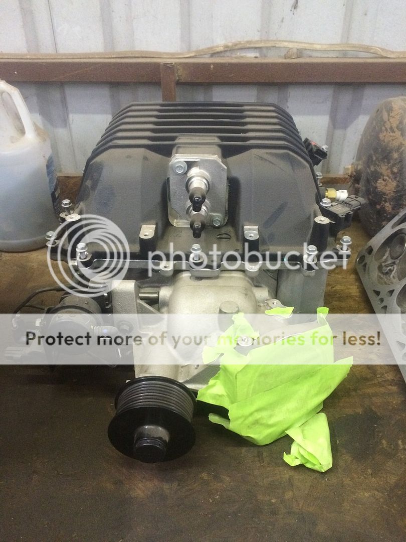

I ordered a ls3 blower cam from Texas speed along with lifters, valve springs, push rods, oil pump, timing chain, and head studs! I have a set of l92 heads and a blower off a zl1. I am going to run the lsa lssimple.com 8 rib accessory drive kit, and a 2.5 pully on the blower which should get it to about 13lbs of boost. My money pit with the 5.3 and mp112 was about 350hp, I am shooting for 600hp range with this build. Prob use doug thorley long tube headers for a 5.3 colorado, and use current performance conversion harness so everything will work like factory! Ac and heat are a must!

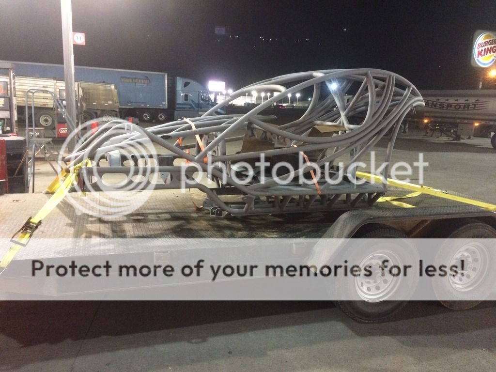

FRAME:

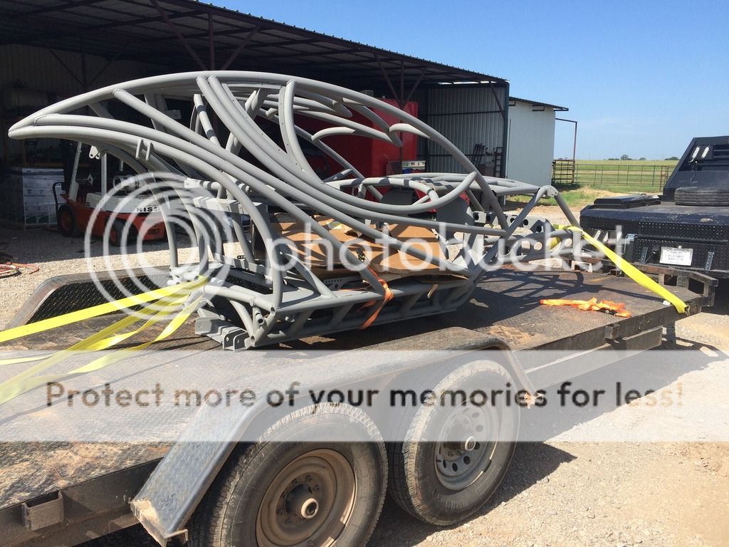

I am still up in the air weathere to run 2x4 3/16 like I did on money pit or to do a dual 1.75 or 2 in dom frame. Will be Exo caged even tho I know a lot of yall hate Exo cages I want it to not look like a crushed coke can.
