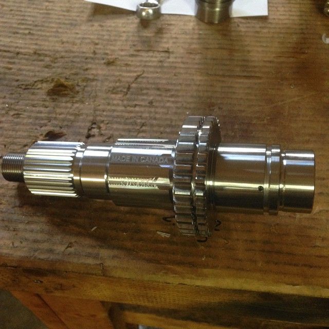

You may already know this but NWF will be making ***an front shafts also. They talked like they should be ready soon.
