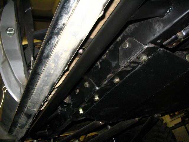

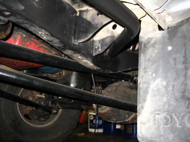

whats your theory on the no link seperation, looks like it will really unload when it breaks loose??
it's not so much the lack of seperation at the skid plate, but I also have very little at the rear axle, it is not going to ride for **** at any speed and that is fine by me. It will be a crawl or all, and yes it will hop like crazy in the mid range. This best suit's my driving style, It is very similar to ISH's old buggy and Jason's.

What's up with the Yota rear diff? Didn't you have two 9's?
I do, but there are 2 problem's,
the 9 is built for a moon buggy already, upside down, and the one bearing end is practially welded to the center chunk
The other problem is that I am a broke *****, and there is no really cheap way to build a 6 lug 9.
