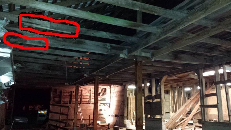

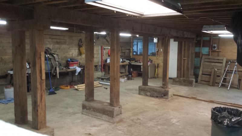

Mike, it looks like at least a few horizontal roof stringers are made to length by 'patching'...might want to think about trueing them up, and glueing/screwing a full length stringer along the other side...
You talking about the last one I patched kevin (where I went from the old to the new)?
Circled points...:haha: But I am no contractor! :redneck: Maybe they are ok...Just a thought since you are going to all the work. Uncle Giggly :haha: can likely chime in with his .02 on this...:awesomework:
Oh those. Ya they have been there for probably 10 years almost,lol. And are actually pretty secure. Plus nothing is going beyond the posts in the rafters.
:cool: Right on then...I like what you've done down the middle...Waaay more hi-tech than I do! :haha: Carry On! :redneck:
Damn--now ya got me worried about them kev... I will do a jump test on them :redneck:.
Shiiiiiiiiit. I just make everything freaking huge.... If your using rough sawn, a full length sister riddled with 20d nails would be fine, or galvie 16d nails in a hitachi if using store bought stuff.... Glue and screws are a relatively new method that's not necessarily better. A lot of 100 year old barns and houses are still doing fine without the benefit of all the new "technology", and I've seen a lot of moldy rotten tyvek and OSB palaces falling down. Don't even get me started on Simpson, he must have someone in his pocket. My grandmothers house is 400 years old, made of pegged timber, sticks and clay..... No nails. No fancy metal brackets!:haha:

But do I really need to "fix" something thats 100 years old, looks fine and no longer has any weight bearing on it?
as long as that sistered joist behind is nailed well and there is no weird gap between the butt ends of the rafter then no. It would however be better if the "sistered" joist was a few feet longer.

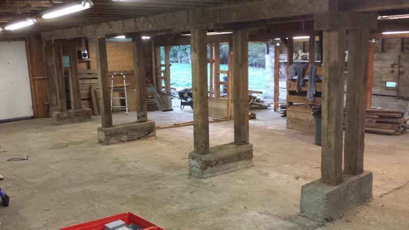

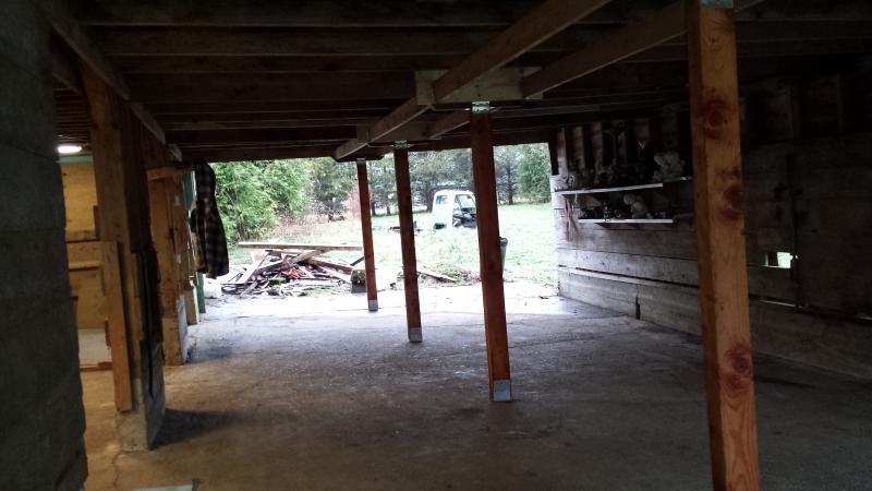

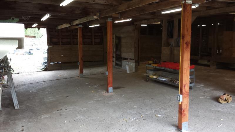

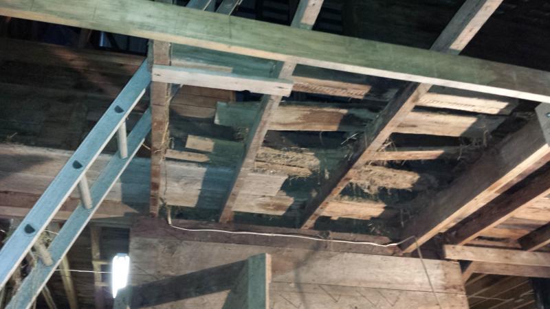

So I got the last 2 supports all done finally.
    50 KB

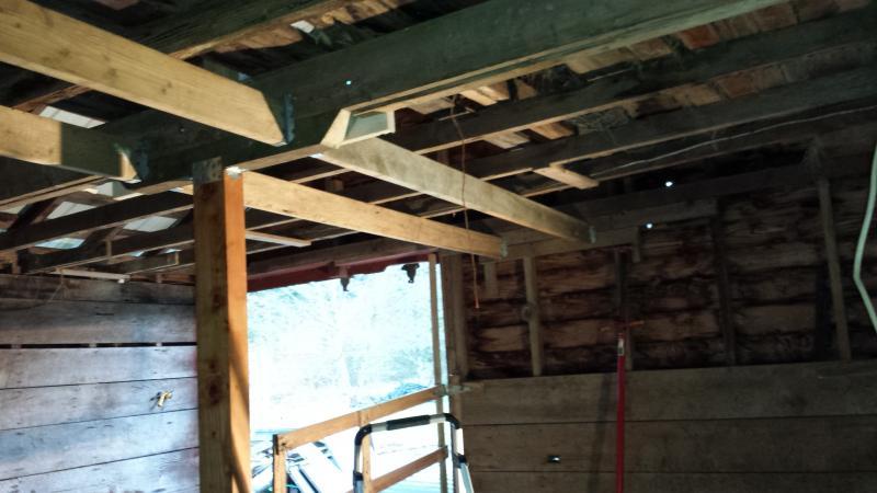

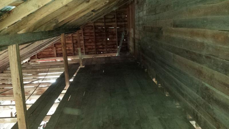

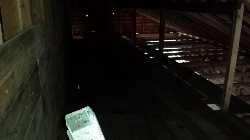

So I wish I had taken a picture of the side loft--it was a mess with lots of stuff that had been up there for YEARS.. The oddest thing was a garbage can half full of bailing wire (back when they used wire for bails) and the rest all mixed in what what I believe to be like 4 bails of hay. Most of the damaged boards were above the last section I did the supports on and boy did I make a hella mess,lol.
    62.1 KB
    59.3 KB
    53.1 KB
I got it all done and with all the work below it was very sound for me to walk anyplace. I was able to repair it all with used wood that I pulled from the no longer used hay chute in the middle of the second story of the barn.

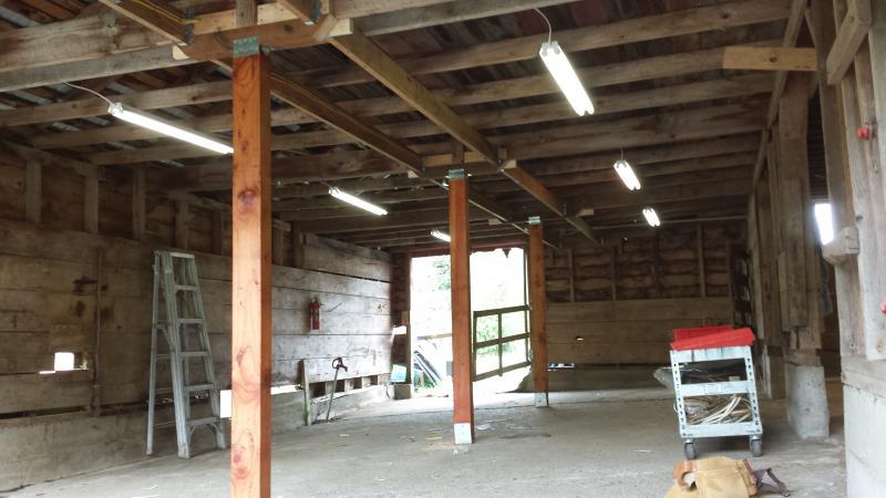

Got the lower area all cleaned up and ready to start lighting.

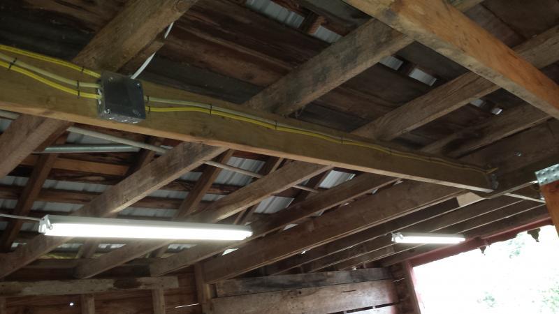

I got all the lighting done today along with 3 outlets. I was originally going to run them over to the far wall but after thinking why not run them down the beams. Same function allot easier..

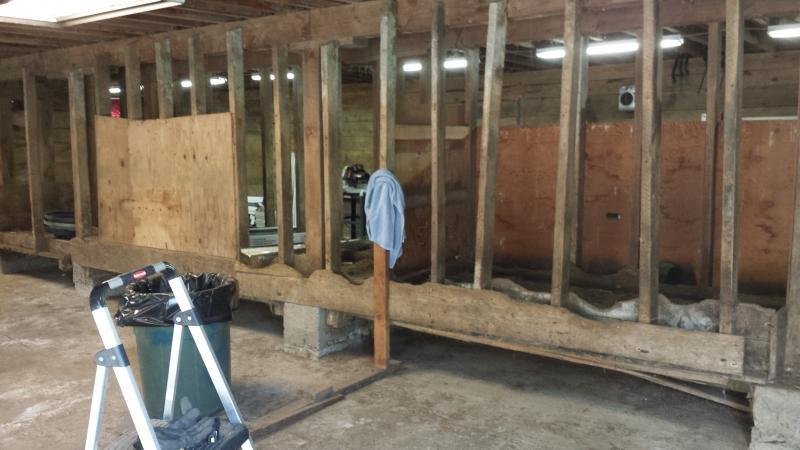

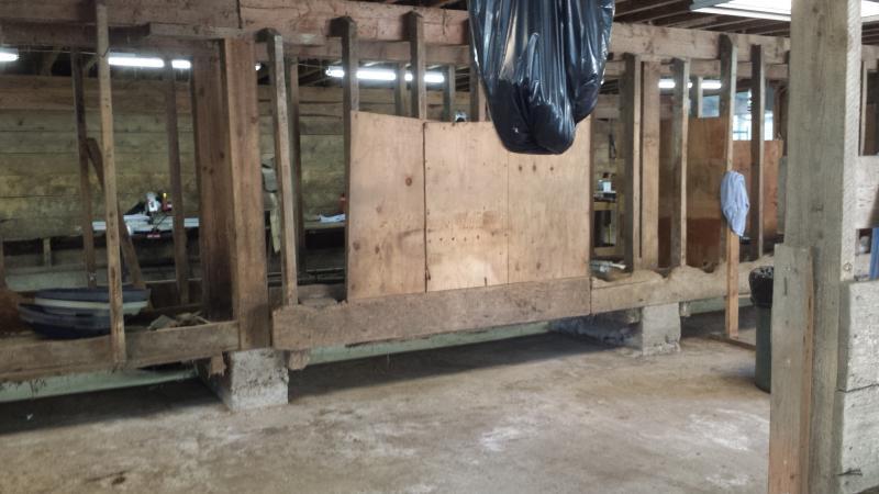

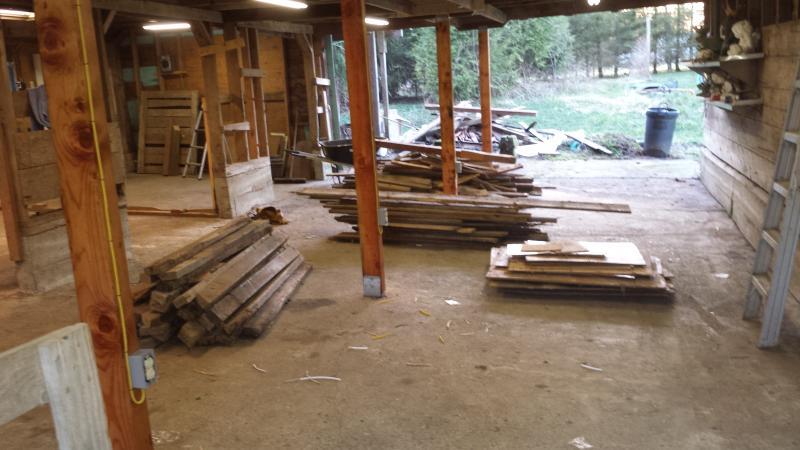

Next step--make a mess of this..
    51.4 KB
    50.2 KB

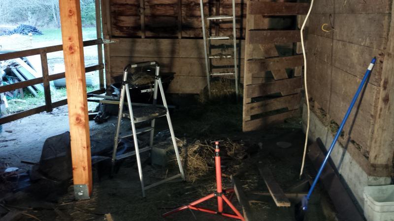

I was able to get more done that I thought. Man the old feeder setup was in worse shape than I thought. I found multiple layers of wood due to a layer failing---lets add another,lol. But it really totally changes how it looks with it all gone.

So now comes the hard part. So we talked tonight to try and get a rough idea of what the wife wanted and just how in the hell I was going to pull it off :haha:
She really wants a rustic look and I am going to use the few good pieces of wood off the feeder to build a second gate for the other stall.
But I am thinking possibly using cedar and then staining it but thats just a guess right now.
