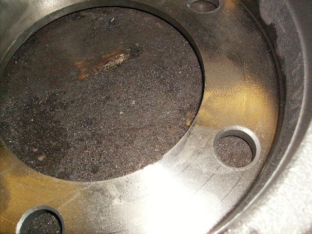

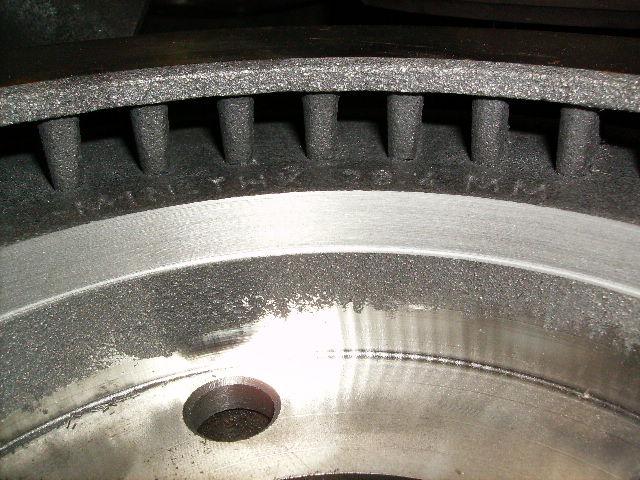

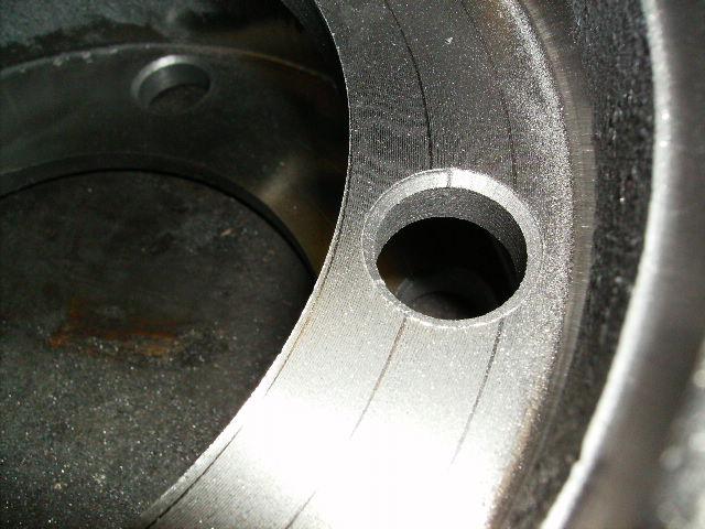

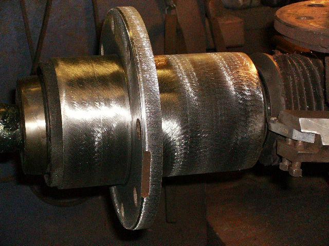

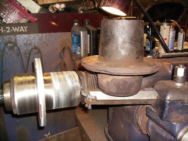

Probably, but the emery cloth will give the swirl effect that most definitely "get's the bitches"
So that's what I am doing wrong, :mad:
Now I need to rethink mine. Actually very cool and awesome stuff. Building is half the fun, and after it's done, look out!:awesomework:
Nothing wrong with back yard machine work. Shiiiiiiit I would have mounted it on a front axle then put the rig in gear.............Go to town with a die grinder.:redneck:
Angle grinder :awsomework:
Brake lathes do not like taking .080 off at a time, especially the the bar mounted upside down so the bolts are taking the force.
cleaning them up with a sander disc is what you are seeing in the pictures. Kind of like the non directional finish on rotor turns, Only with a 50 grit sander disc.

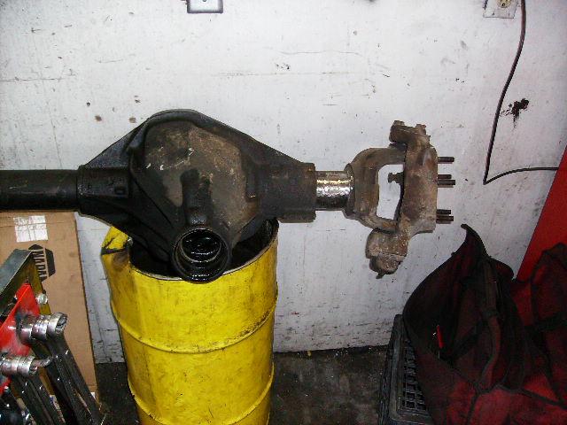

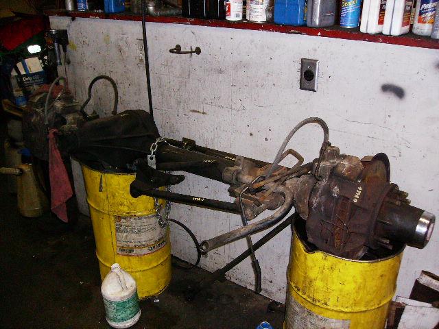

So I got a chance to work on for a couple of hours yesterday.
I knew I wanted 7.25" off of the tube, so measure 3 times and cut once.
next I cut off the tube as close to the knuckle as I could.
Then I made a couple of cuts through the tube to relieve stress.
Then I took a angle grinder and started grinding the end. I did it in the center and stayed away from the knuckle, grinding at an angle so as not to take material away that I needed. This also gives you a slight undercut when the old tube comes out. That gives you a bit more weld for strength.
When I thought I was most of the way through the factory weld, I stopped and using a drift and hammer tried moving the tube in the knuckle. After a couple of times I could see the part line and could drive it out from there.

cut off tube section and the pieces that were driven out of the inner "c"
I cleaned up the tube and the inner part of the "c" before putting it back on.
I tapped the "C" back on a little bit and then compared the caster angle to the other side. I knew the pinion angle would be close at the factory settings and as I was just changing one side, I matched the angle from the old side to the new side to make sure they are the same.
I then finished driving the "C" back on and after double checking the angle one more time I welded it back together.
Now the housing is ready for cleanup and putting back together.
