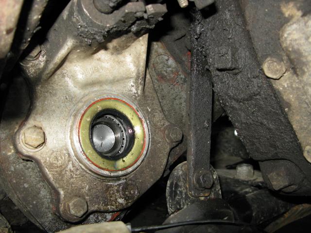

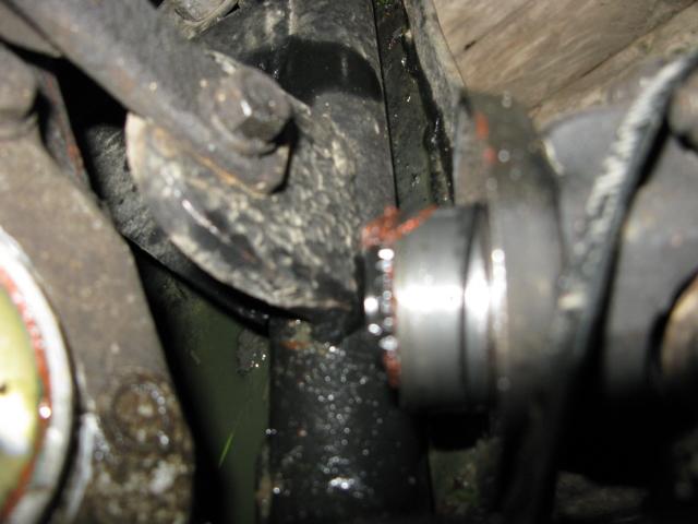

Well sorry guys, I went up to take a pre-run at Reiter and snapped my front output shaft on my Dana 300 doing a front burn on trail of doom. Got everything upgraded except that....go figure! Well got a JB shaft on the way so I'll have to catch up to you guys another time! I'm sure there will be lots of people to run with! Have a great new year!!:D

Do you have a 4:1.....I would assume so...that sucks. I have left my 300 stock so as to NOT have that happen.......but I still worry about it....ugh...I wish I hadn't looked at that:redneck:
Ya, I have the newer 5 gear tera low 4:1 and AA 32 spline rear output. the reviews I read said the front usually isn't an issue but I should have upgraded it last time I was in my case since my width requires tons of front burns:( Well it has every possible upgrade available and is now supposed to be equal to an Atlas....that's what they said. If I had to start over I would spring for the Atlas but damage done, now I should be set. I will have it rolling again by Mon.
