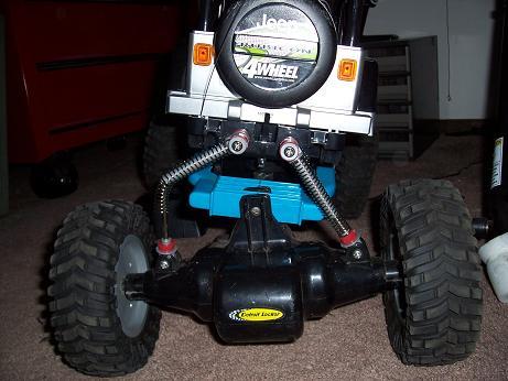

I have moved the front and rear shock's inward' and cut off the bump stop's. Now my shock's keep pulling out. do I realy have to figure out limiting strap's for this pos? Is there a good way to fix this that you guy's know of? Or should I just keep putting them back in every time?:wtf:

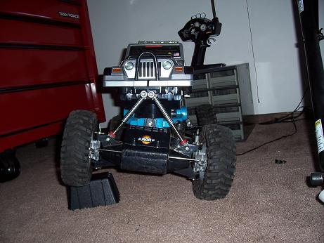

Thank's for your help dude. It realy work's a lot better now that it can flex this much. I will just make some little limiting strap's and will remember not to ask for your advise.:flipoff: jk
I tried all the BS you see on RCC, they work the best stock with the belt mod and a few 1/16 holes drilled through the rim in the back for softer tires.
I made the same mistake with my first one then on my current one(3rd) I cut half the bump stop off and inboarded my shock's and it still pull's the coilovers apart. inboard the spring's and leave the bumpstops alone.

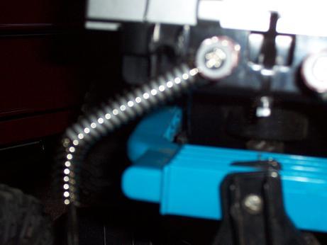

fixed it....
without limiting strap's even. I used some rubber tube with some screw's down the middle, screwed in as low as I could go with out the coil overs coming apart. I be R/C wheelin again:flipoff: next is the "O-RING" thing you were talking about, can I pick those up at the hardware store or auto part's store? my front end is slipping and get's worse every time I use it.:mad:I did take off the bottom of the front diff.,and see the pulley what's next? thank's for your help in advance Ryan

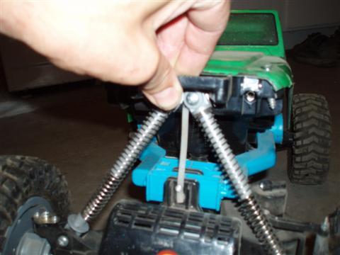

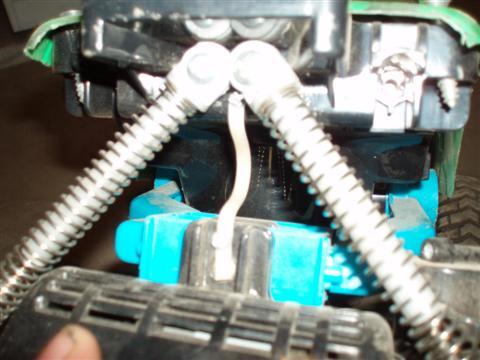

One more super cheap way to keep shocks from coming apart. Used 1 zip tie, 4 screws and 3 minutes of my time.

Thanx Dood!
Hey thank's for the great idea, my bump stop's are working great.(I think my nylint has reached it's full flex potential) You mentioned in a P.M. you sent to me that there's a number to call for free part's on my nylint. I can't seem to find it, was it on the skid plate's? Because I tossed those can you post it up thank's Bro. later Ryan.:cool:
