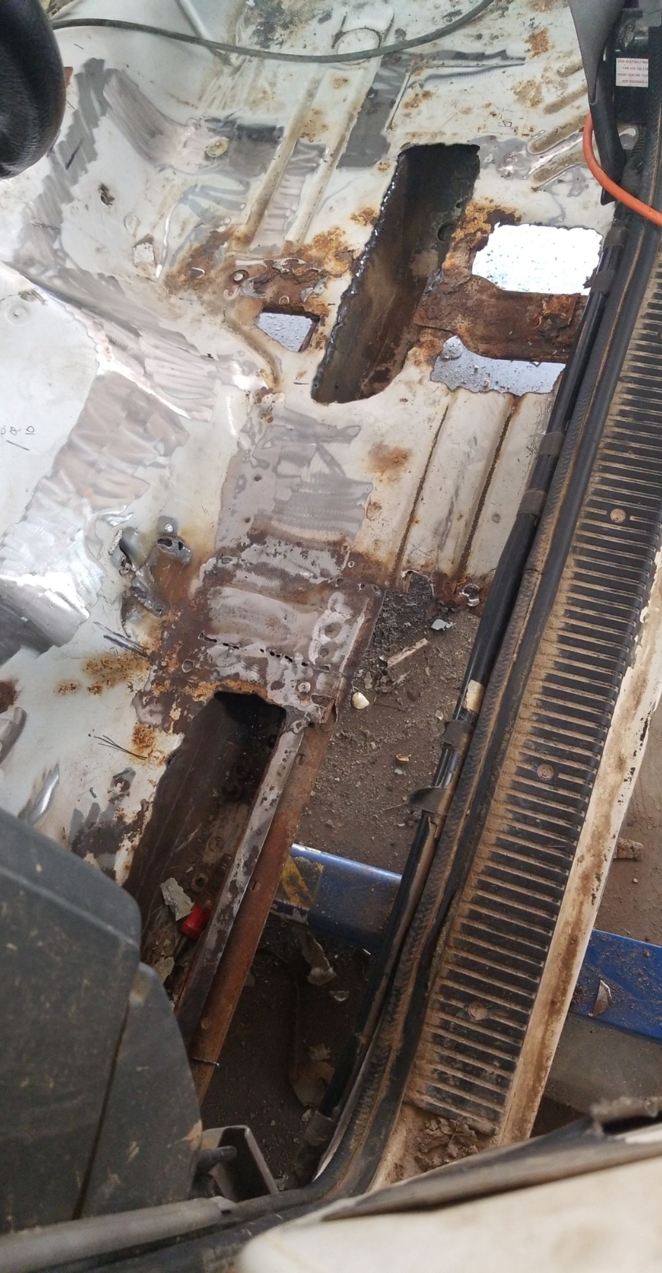

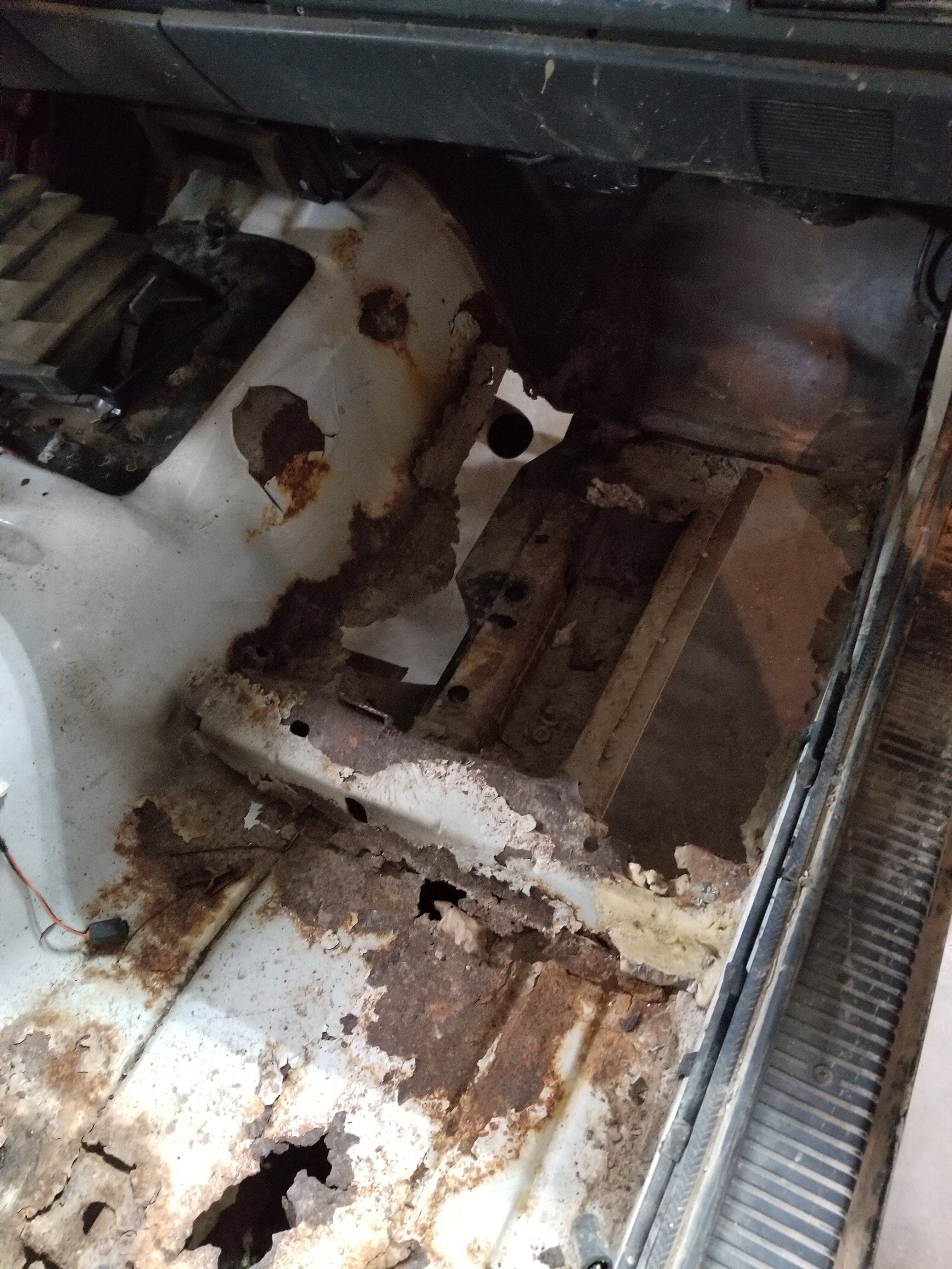

We hit 3 lbs today and her lungs are about to normal capacity.Plan on doing some rust repair in between visits on the jeeps floorboards and get to mounting some corbeau seats finally.

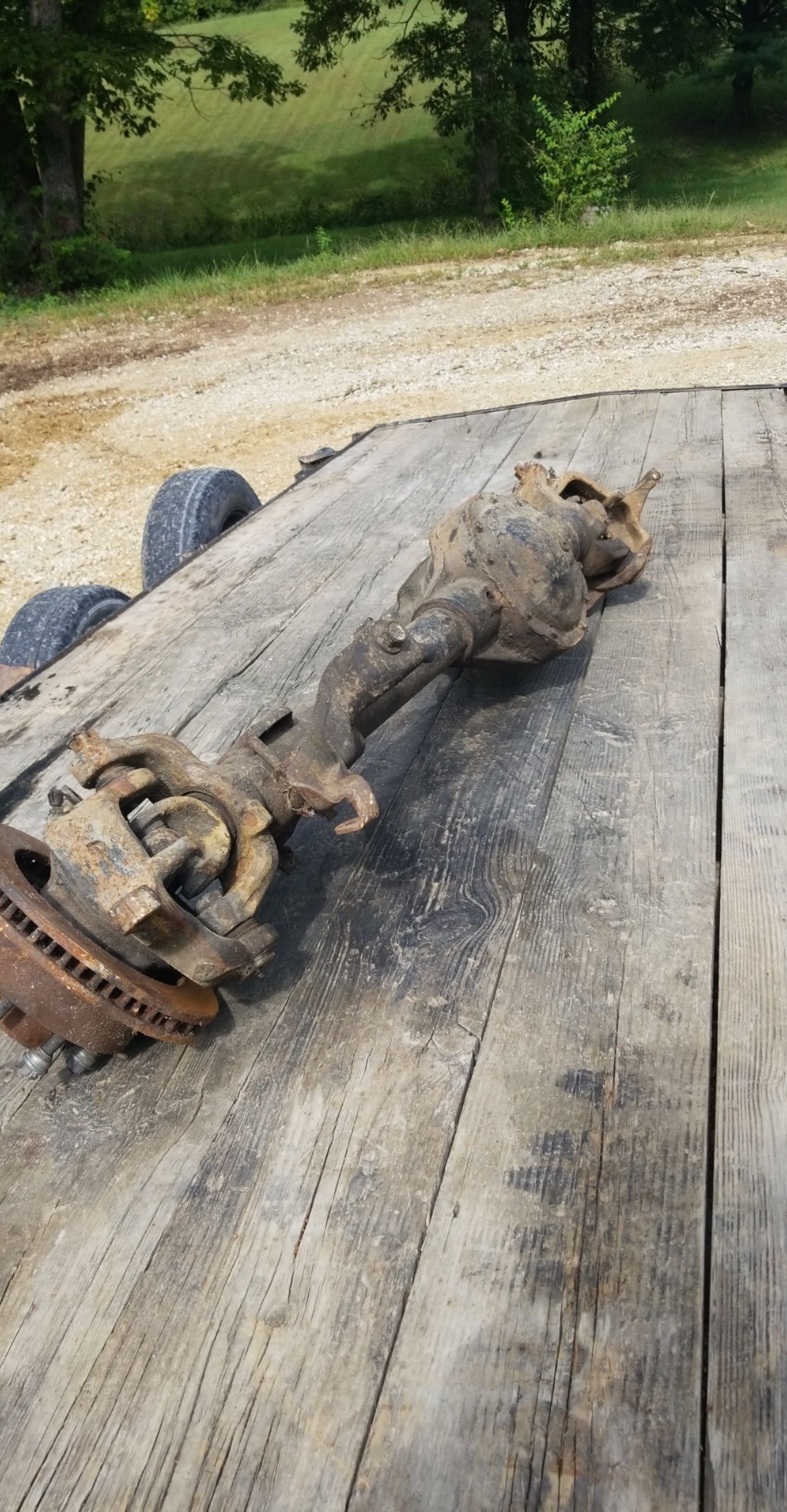

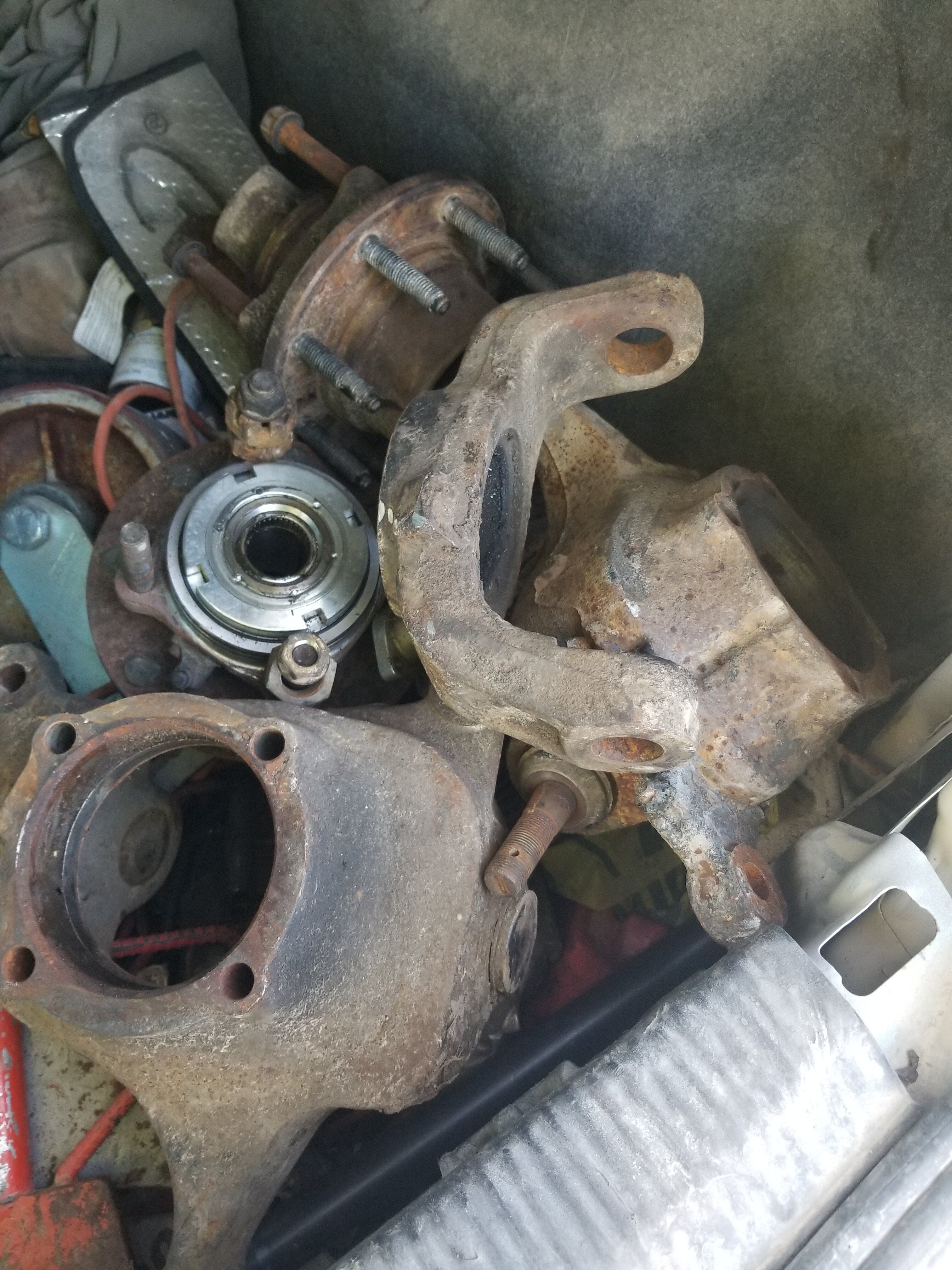

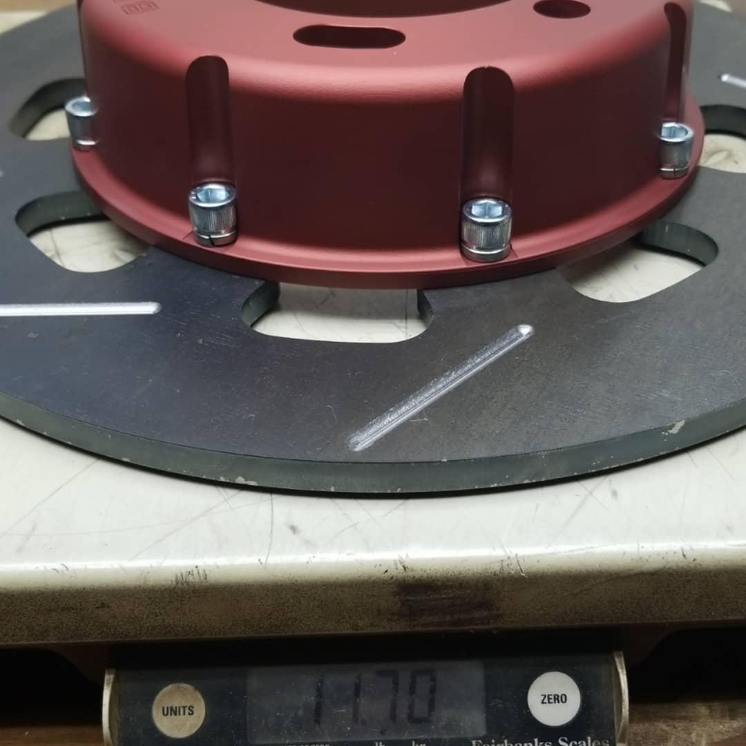

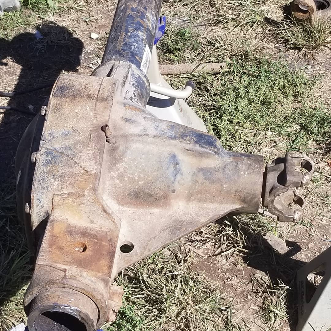

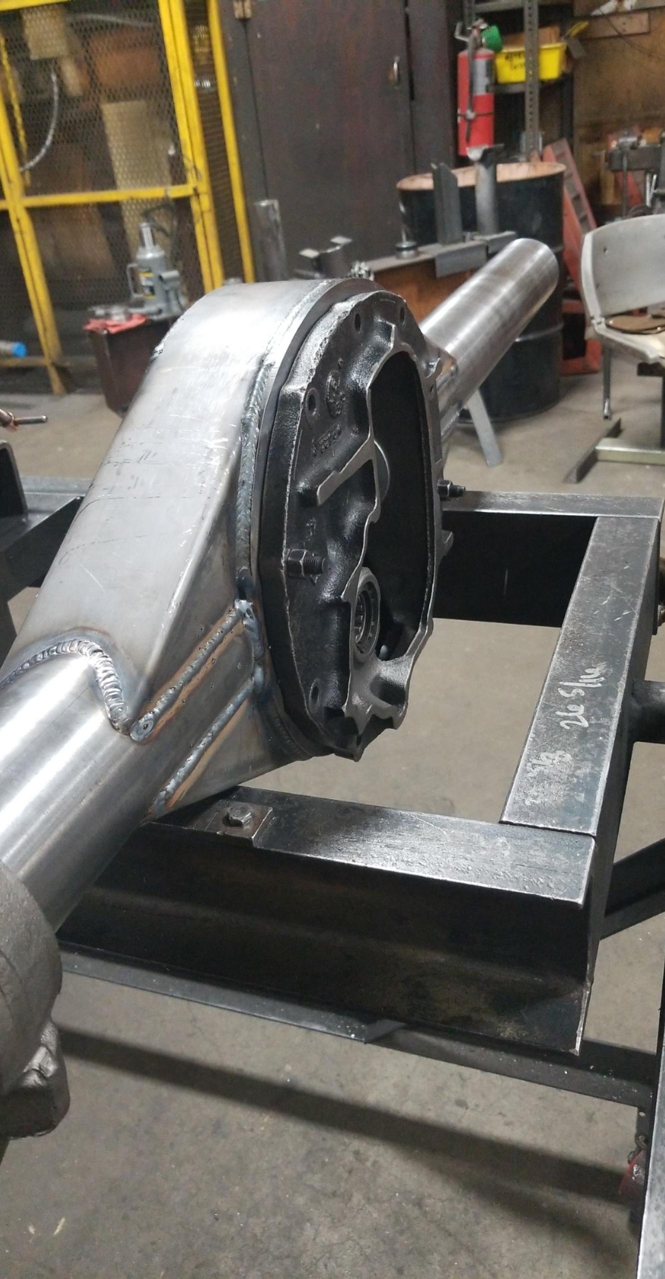

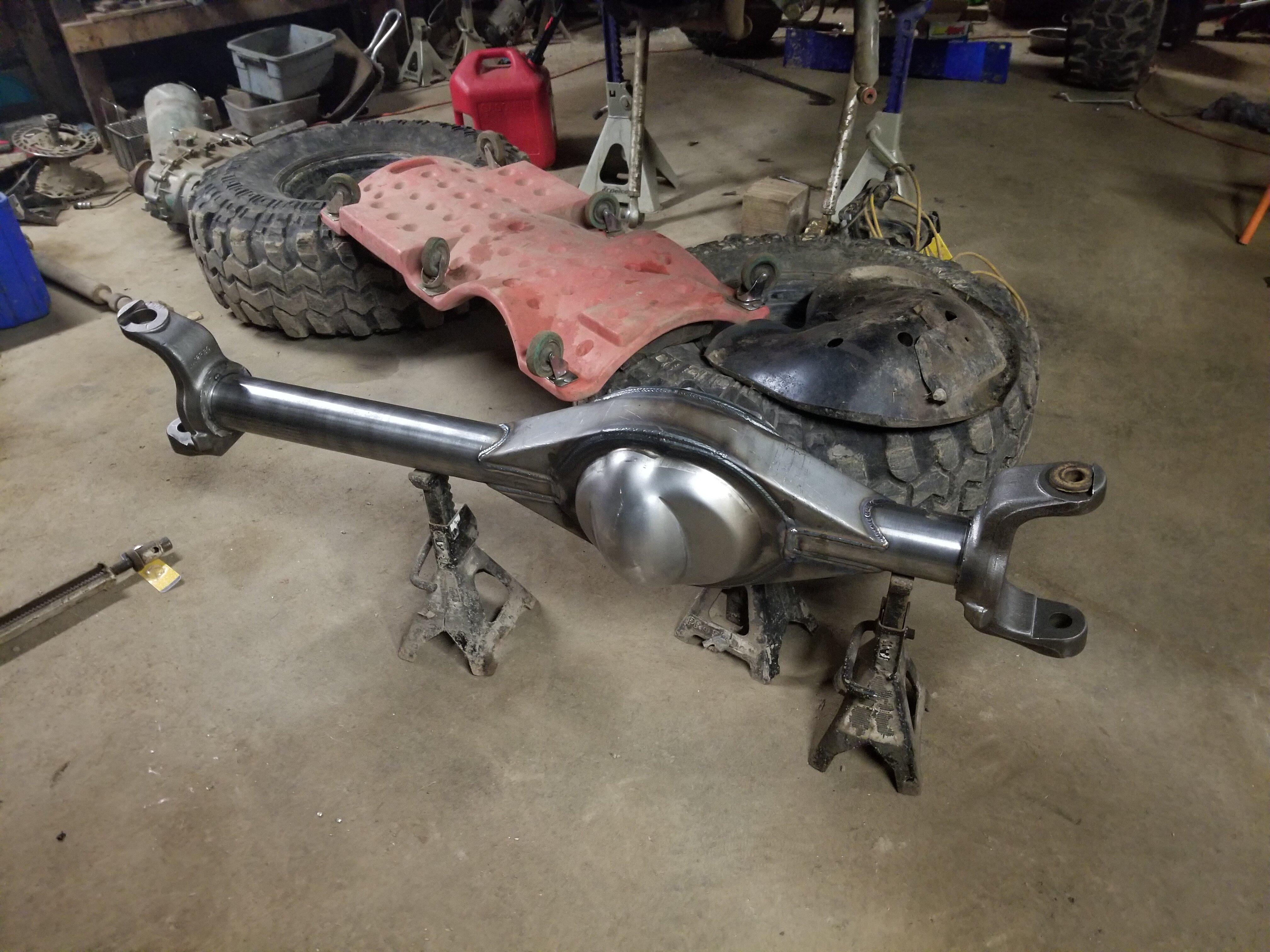

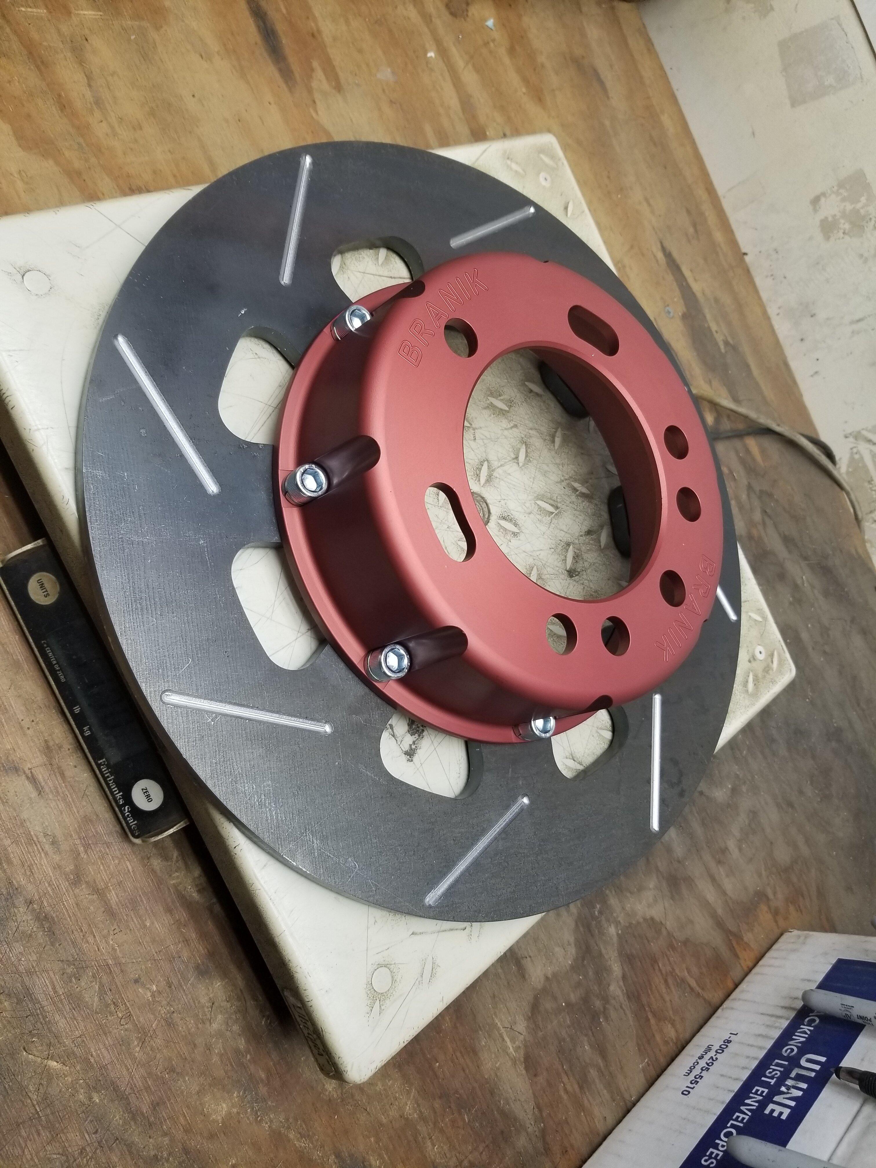

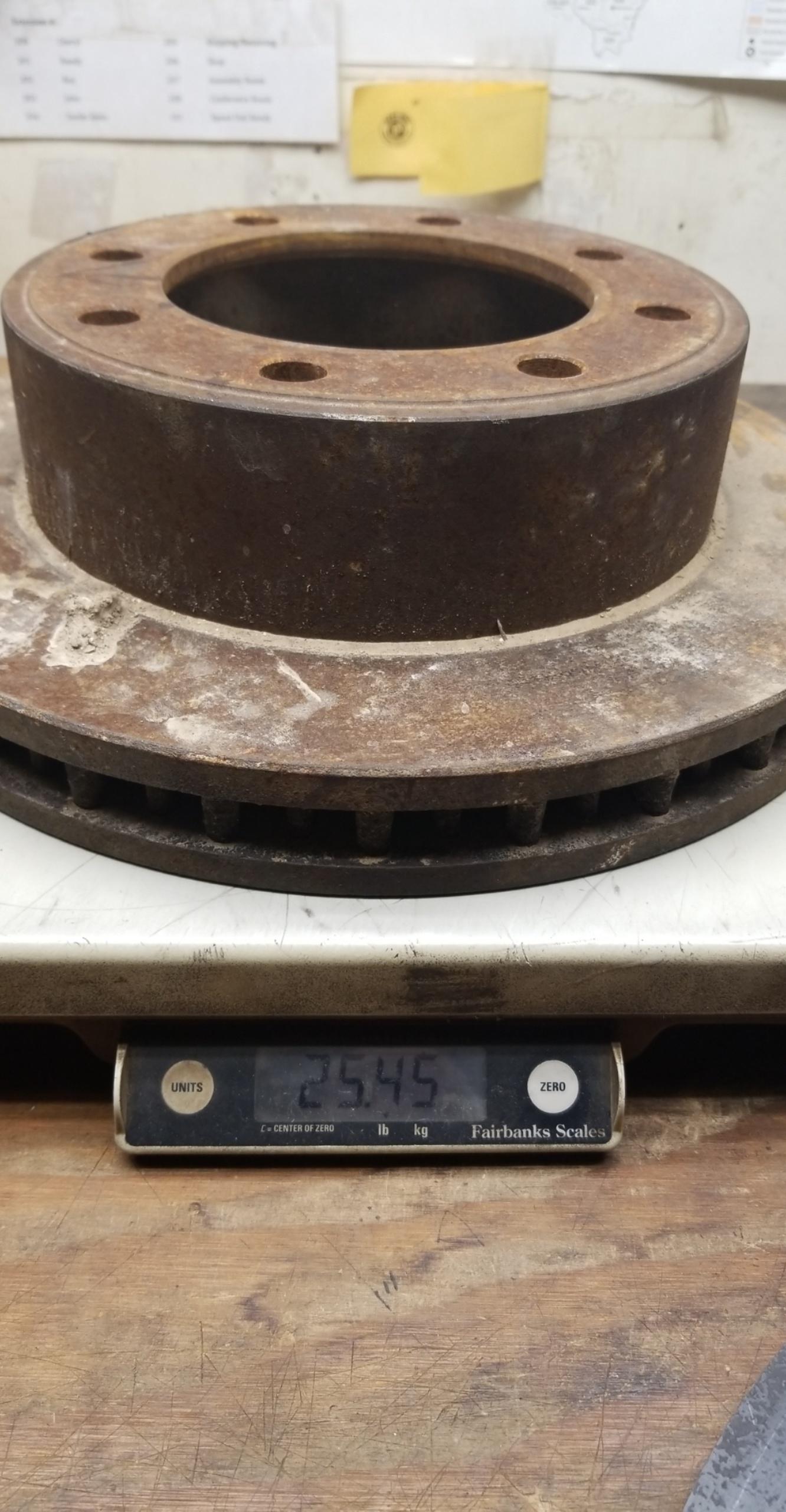

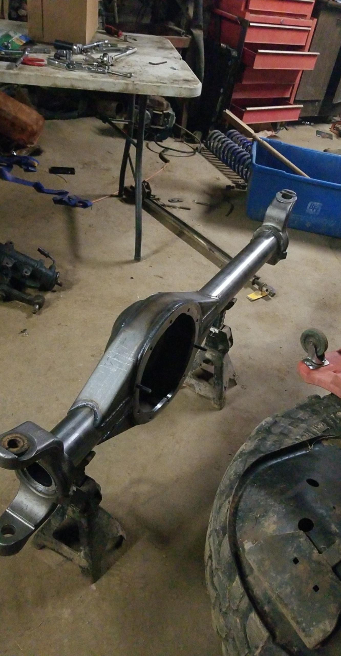

The replacement axle for the polished turd has started.Picked up the dana 50 for the 9in front build.Thinking $50 was a good deal.Want to run 5x5.5 on the front and rear.Going to get UBs redrill/
bored for 35 spline from Branik and try to make my own brake kit.Might have to drop the coin on branik hats and rotor down the road but we will see.

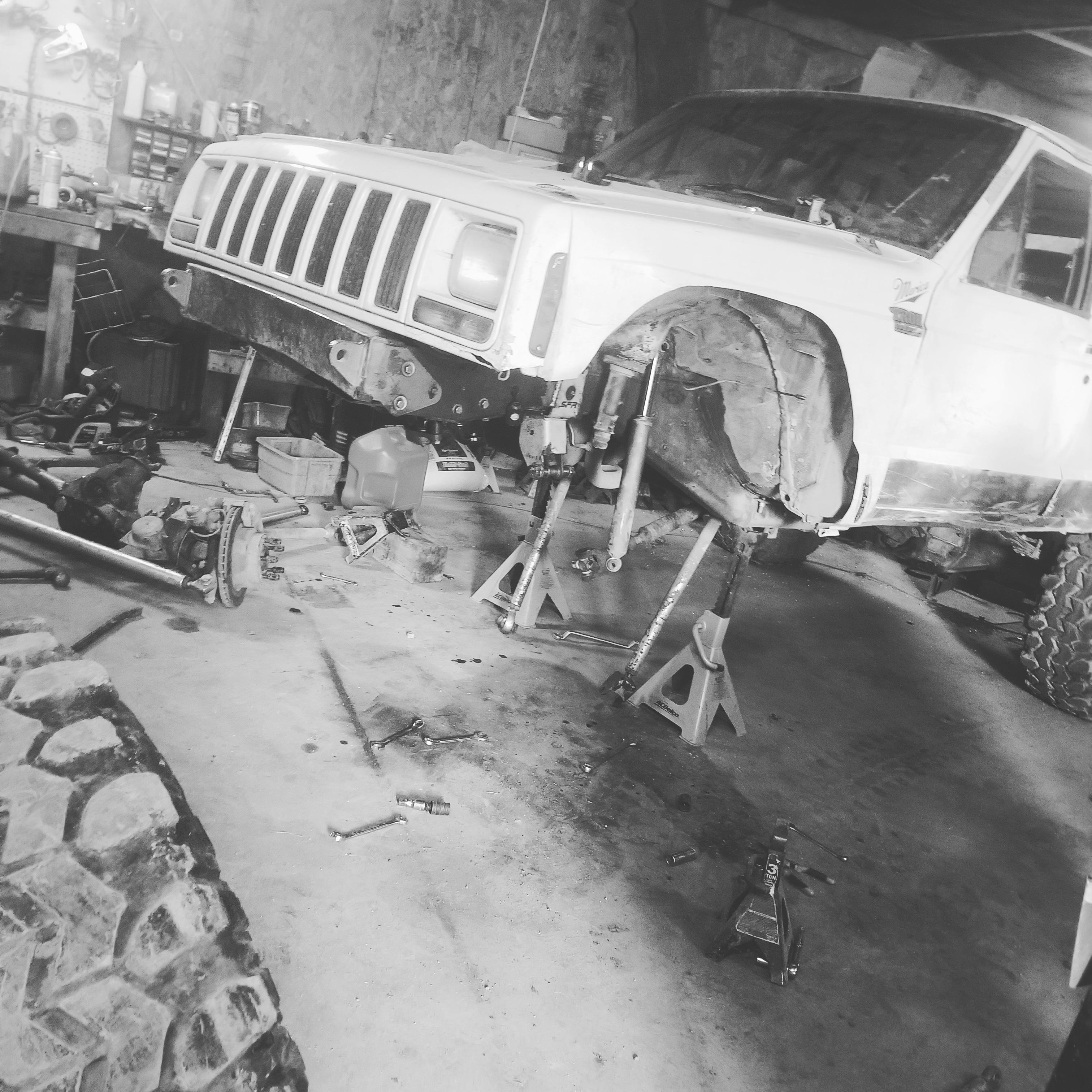

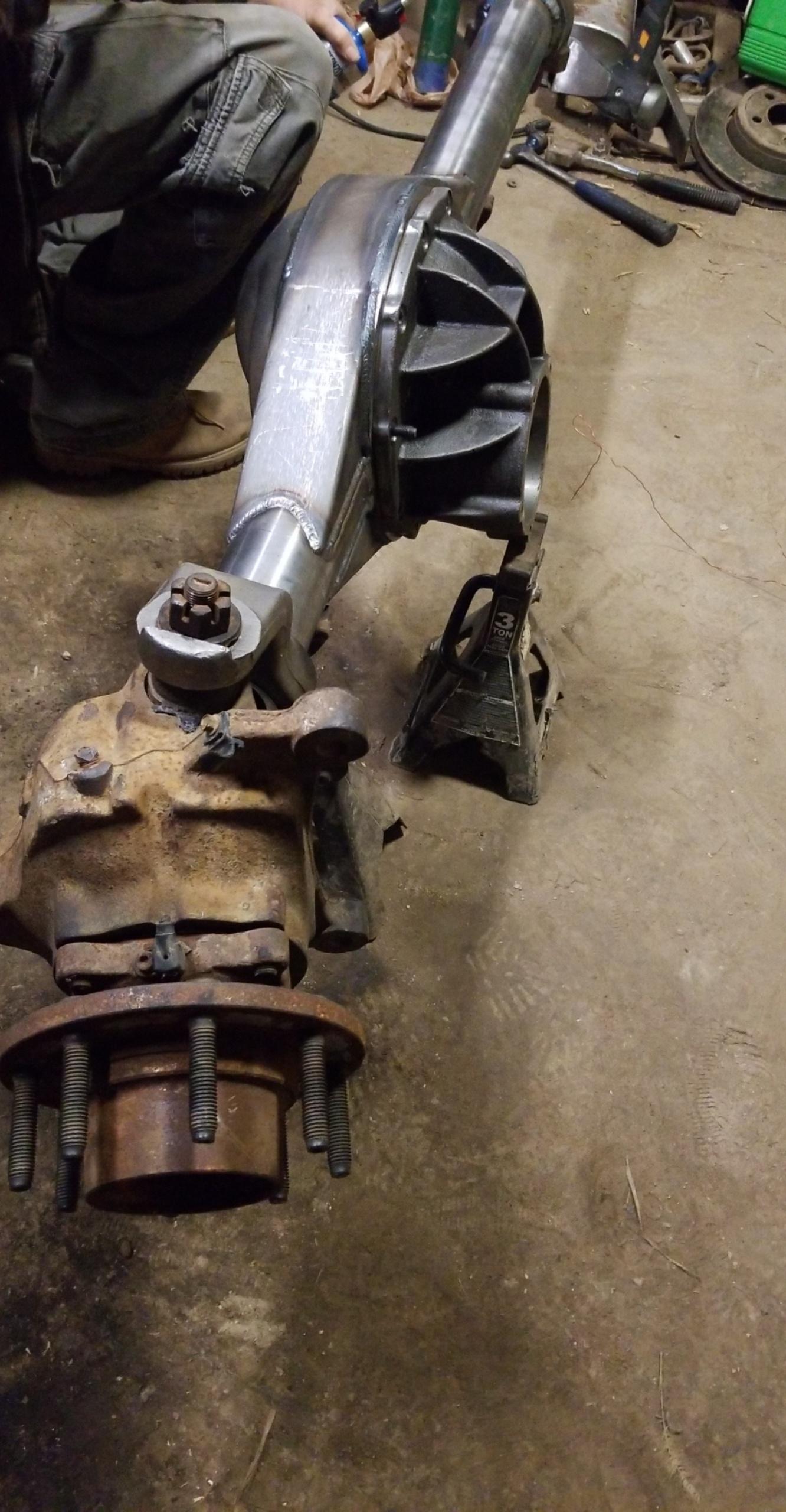

Bent,bolted and welded into place slow going but I'm happy with the progress

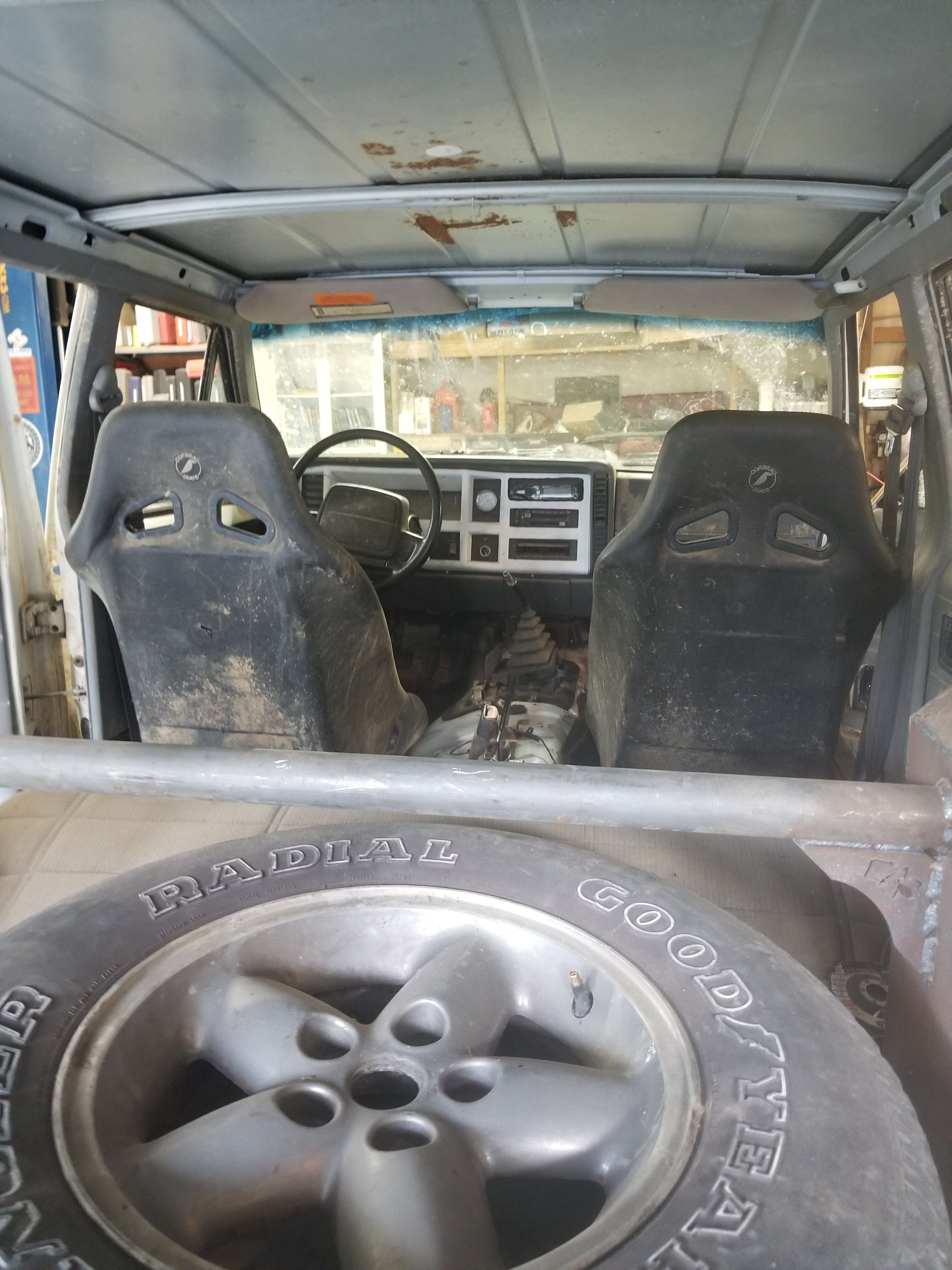

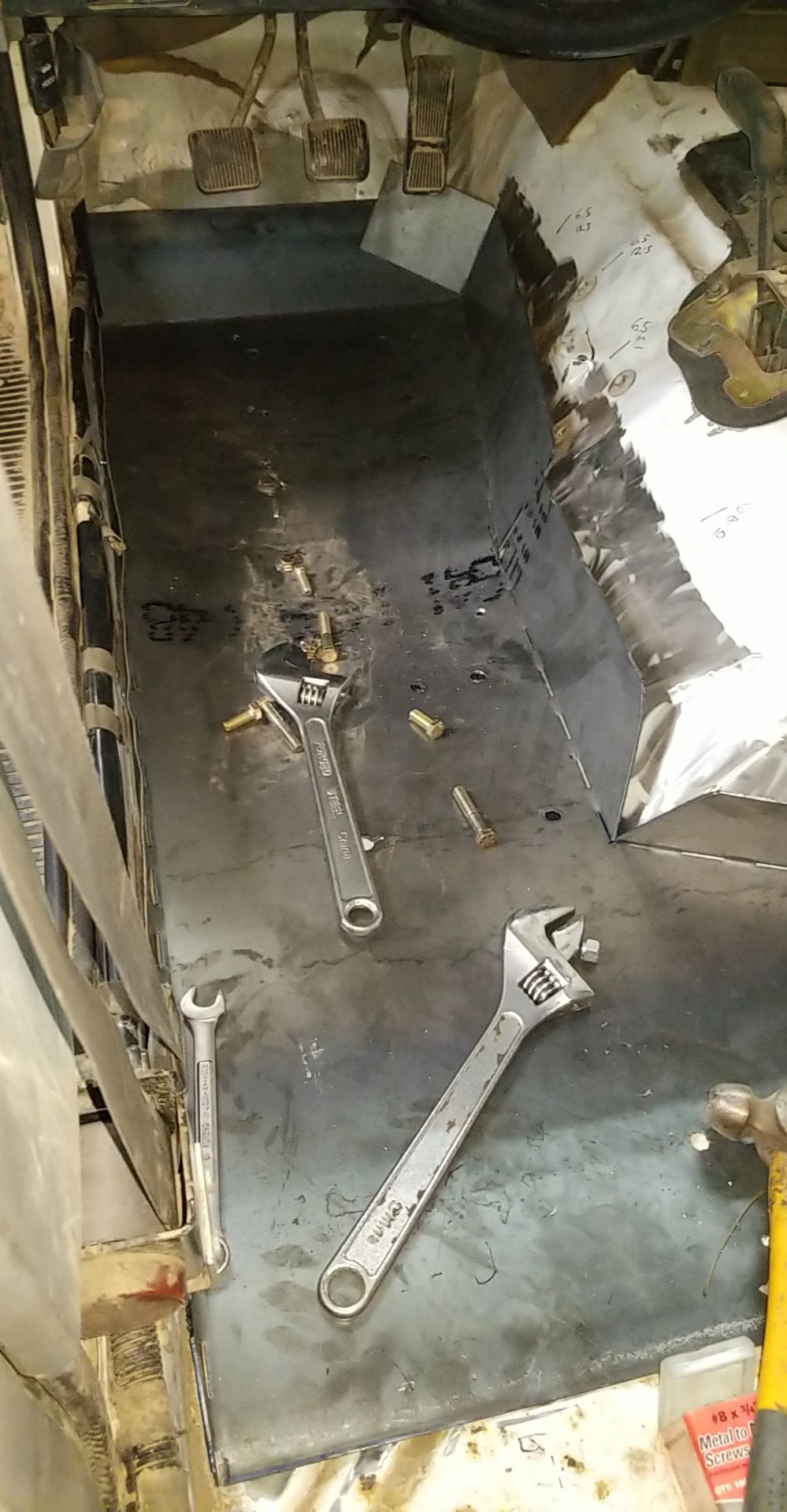

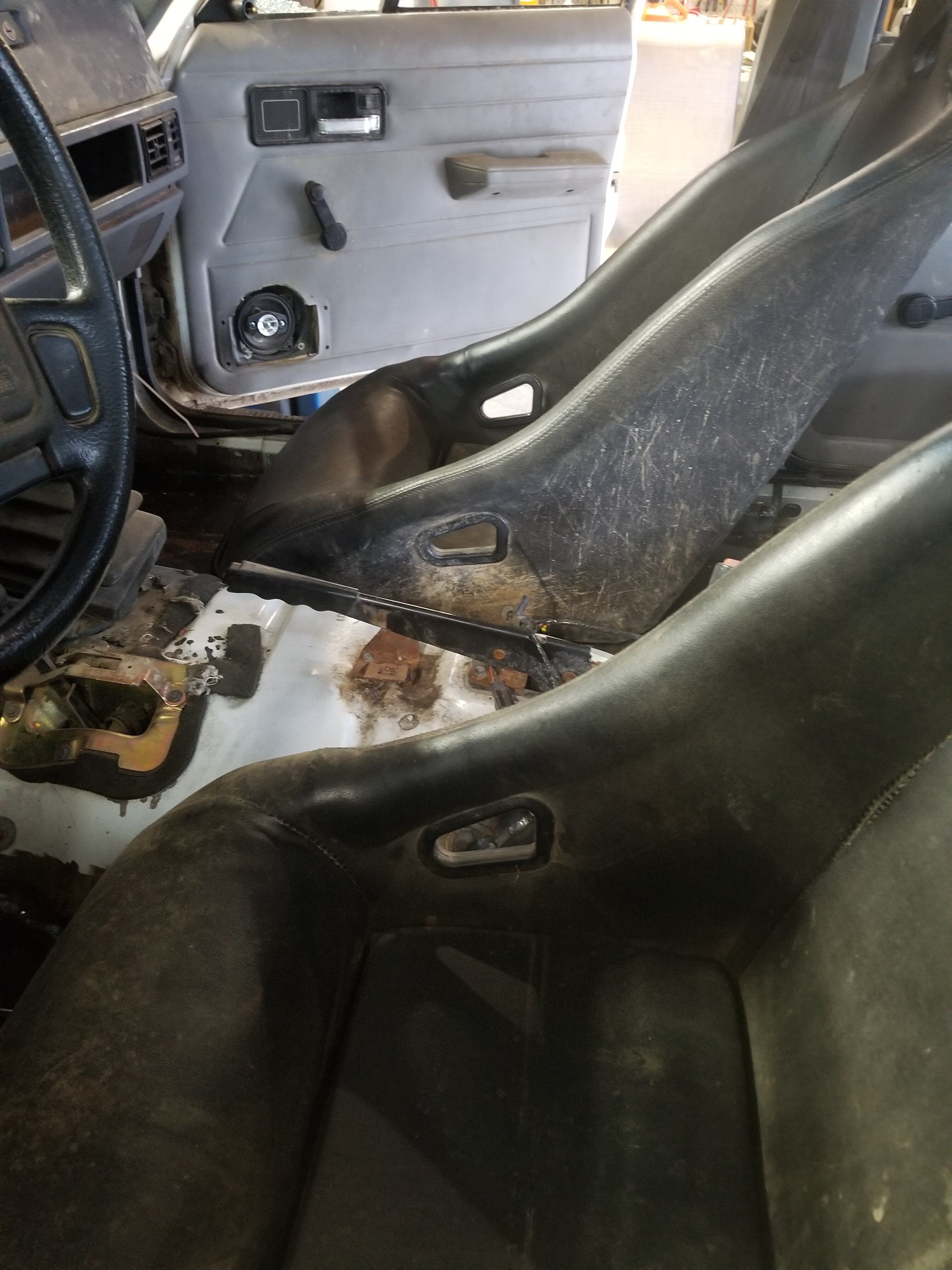

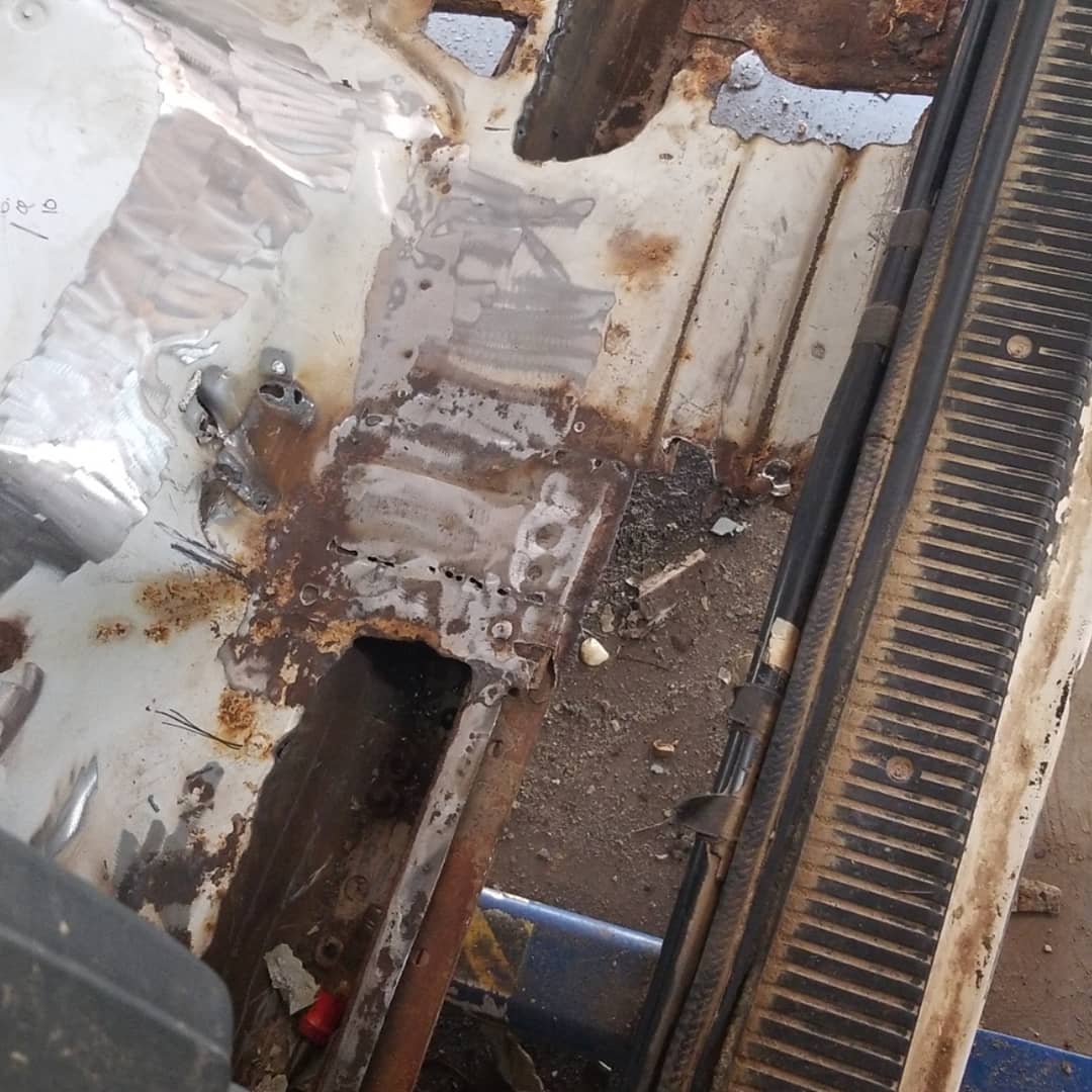

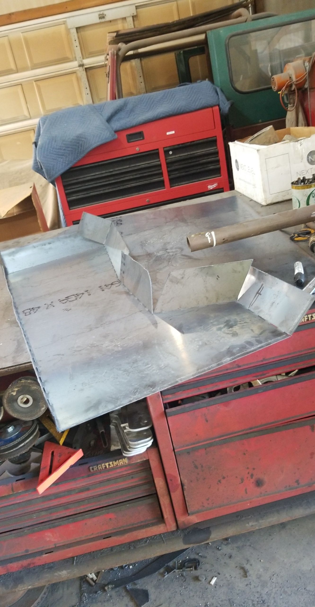

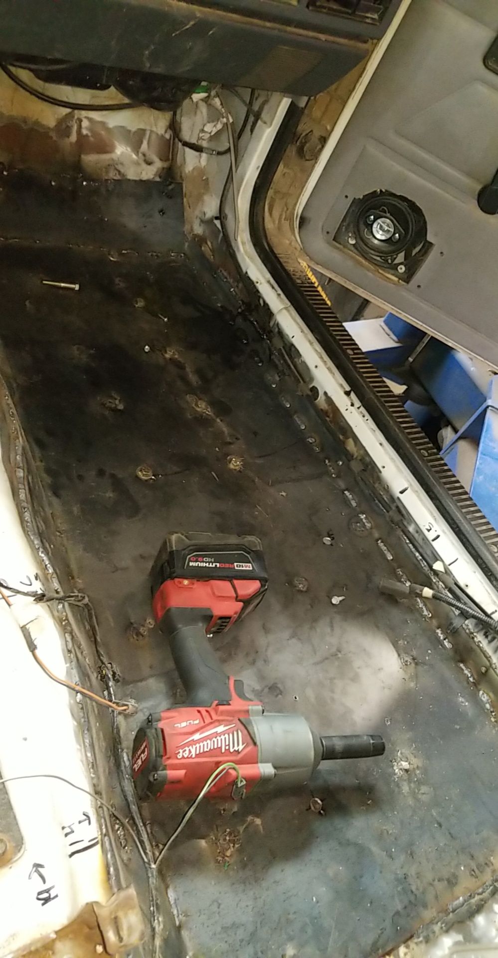

Pretty successful weekend floors finished,seats mounted,dana 50 striped and Cs cut.And most important time with Bailey.Looking like she will be home by the end of the month.:dblthumb:

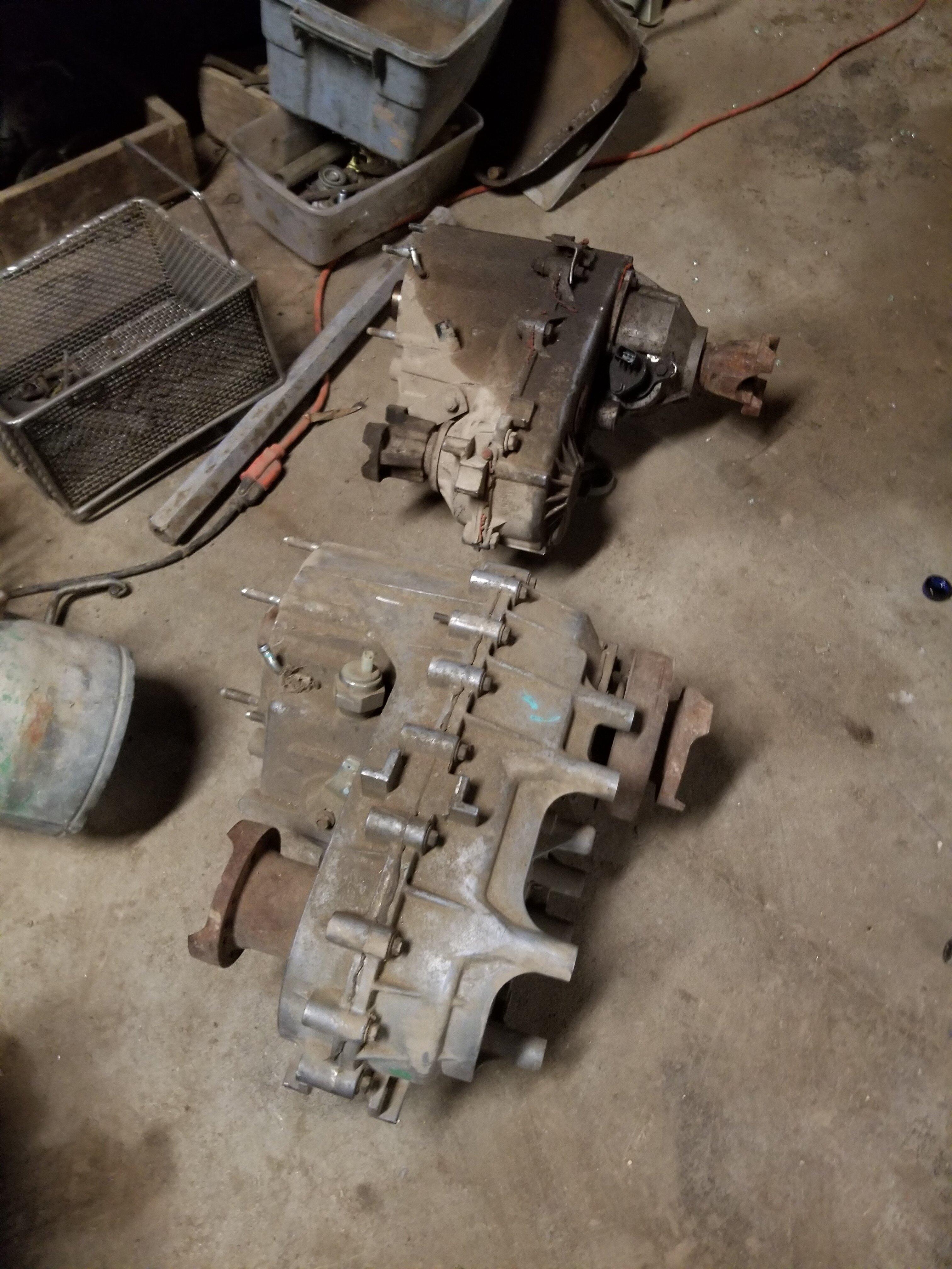

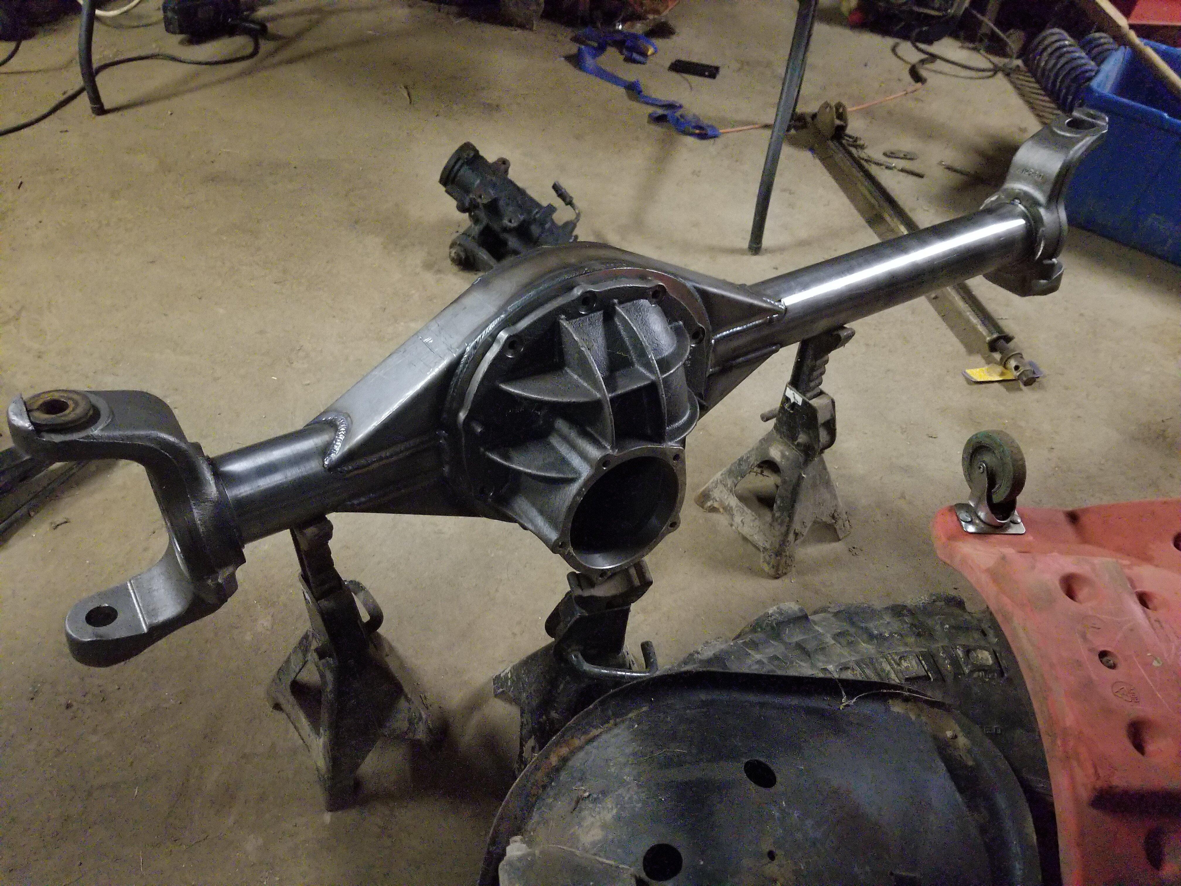

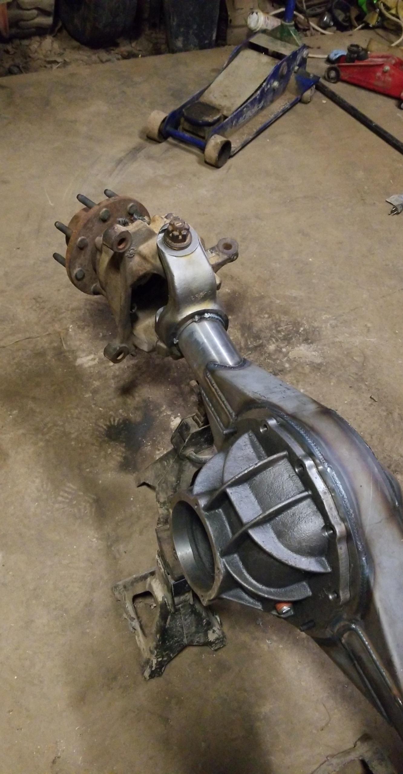

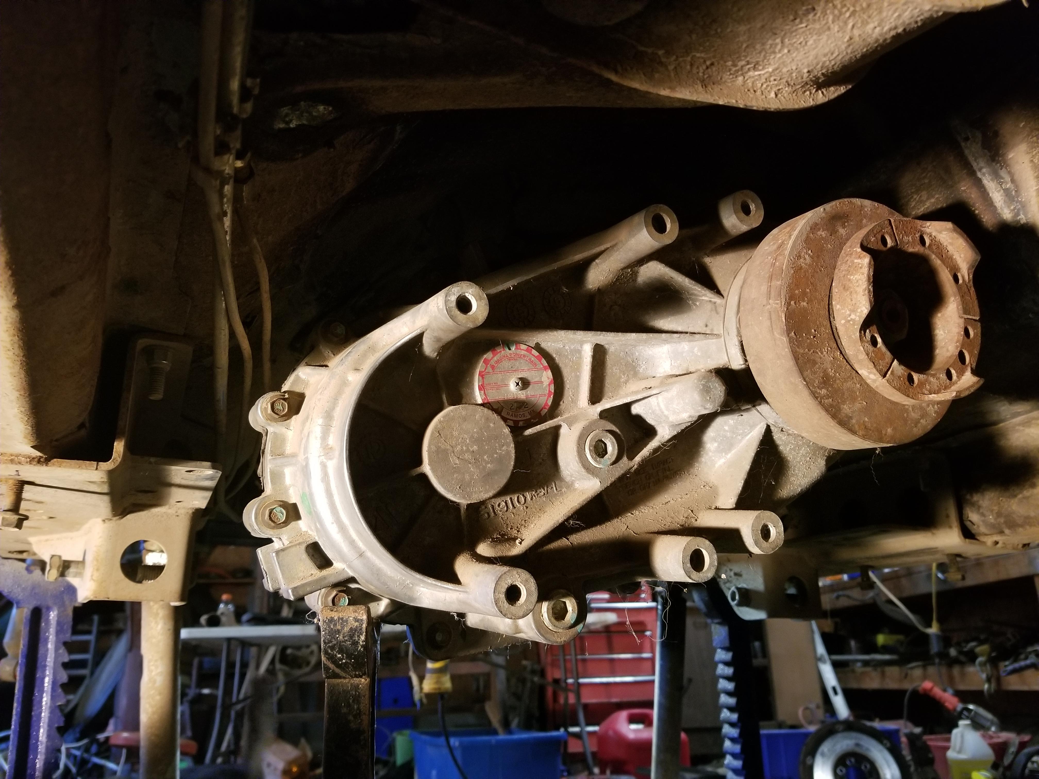

Posted the front axle,steering and tcase for sale sold in 30 minutes.Front 9in is in full swing.

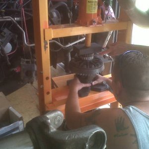

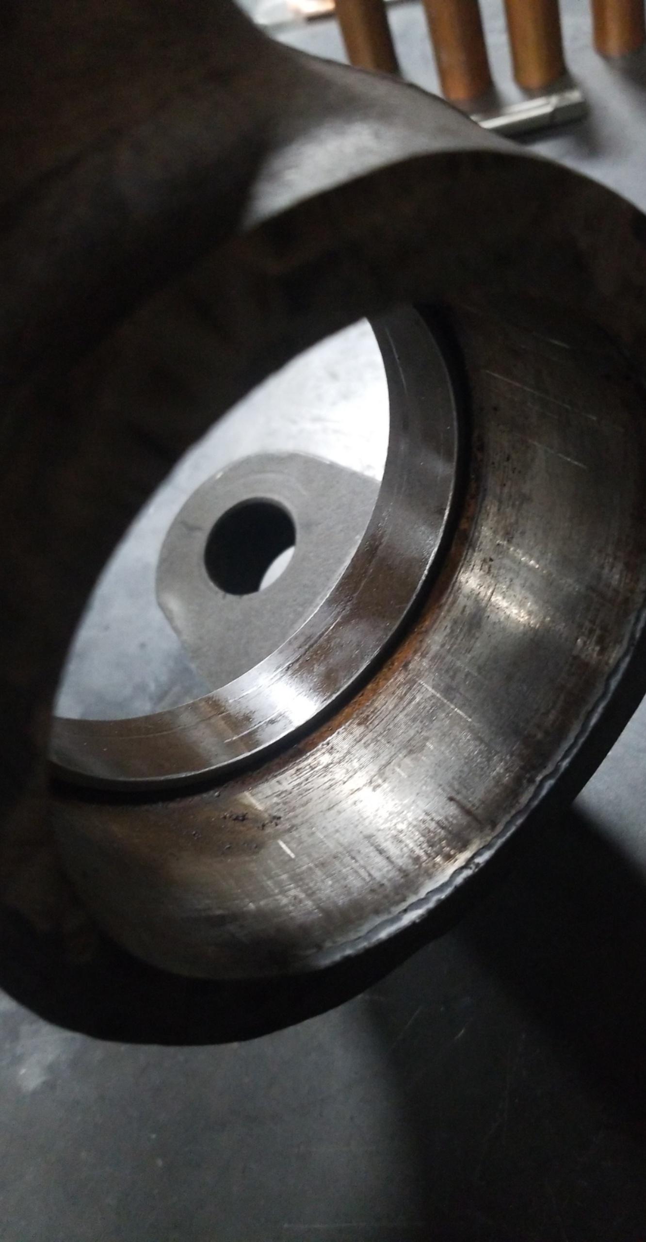

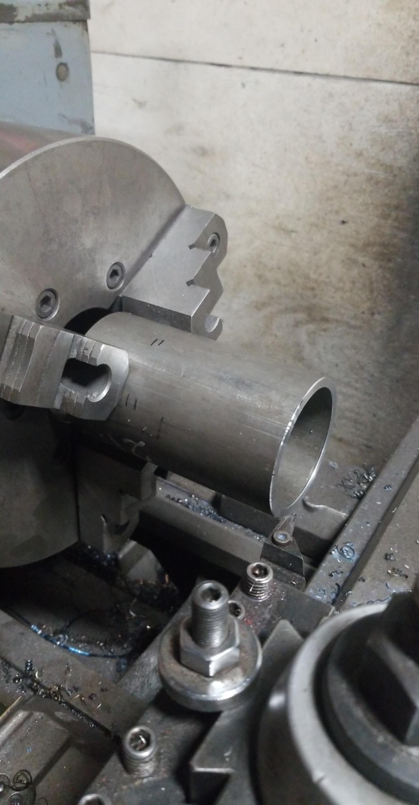

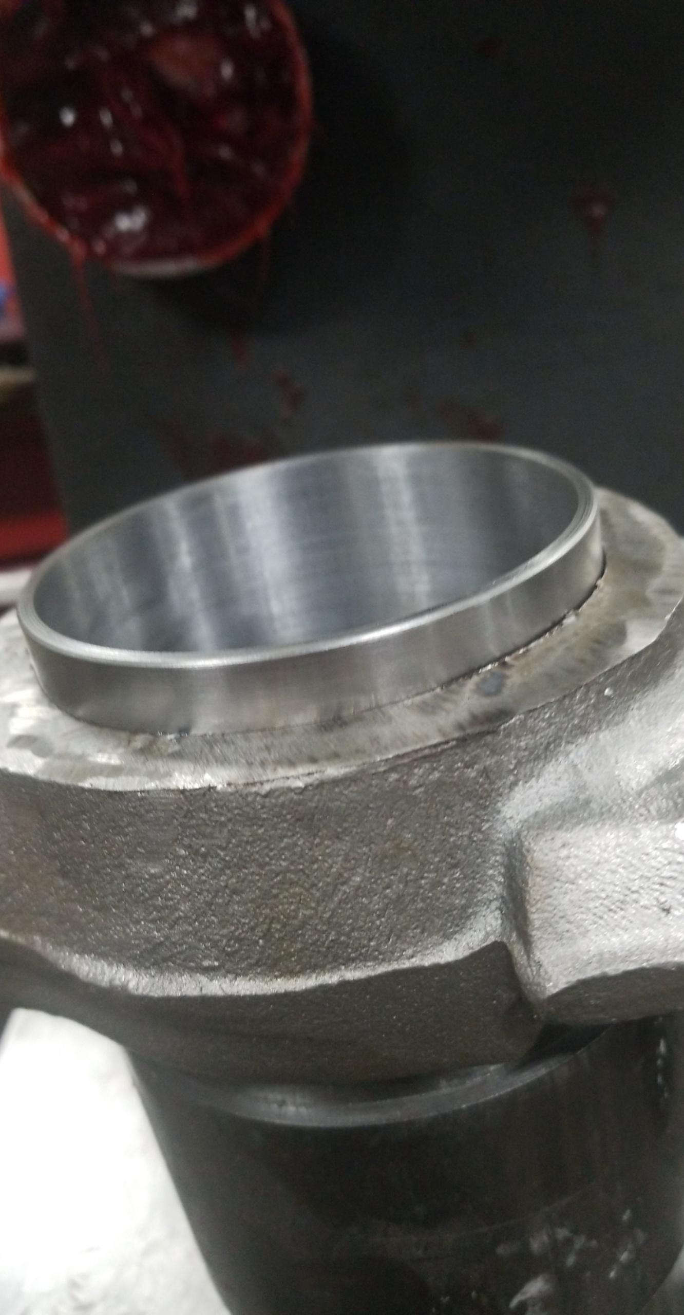

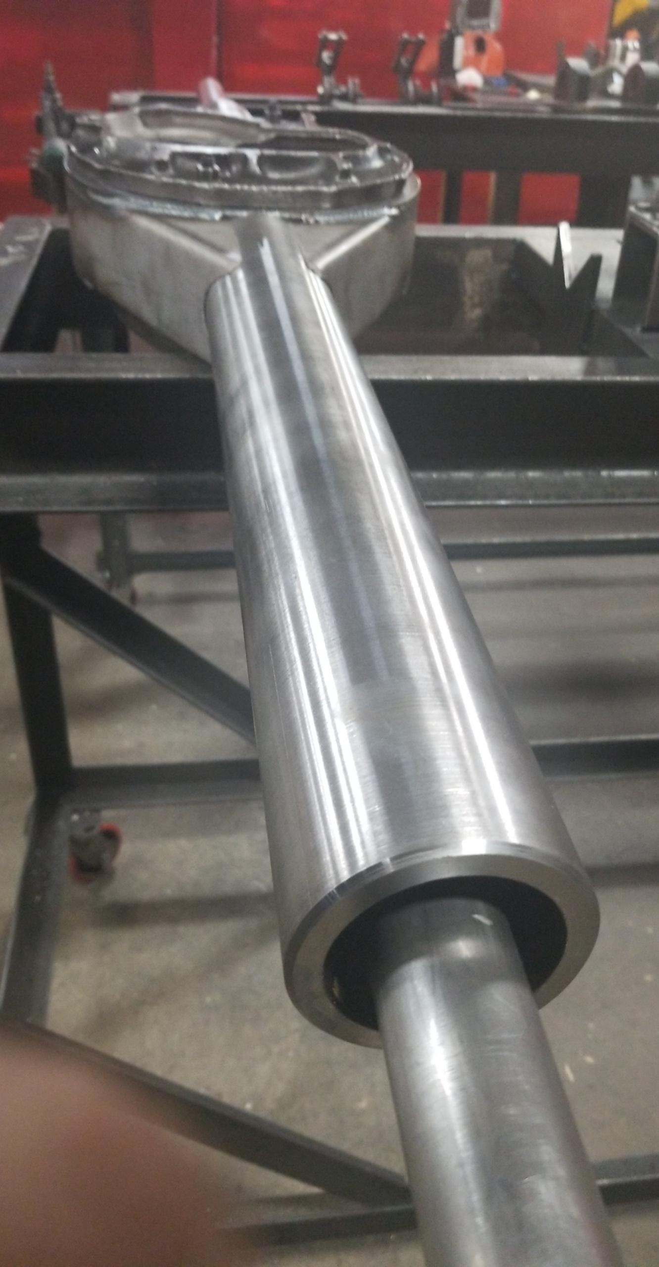

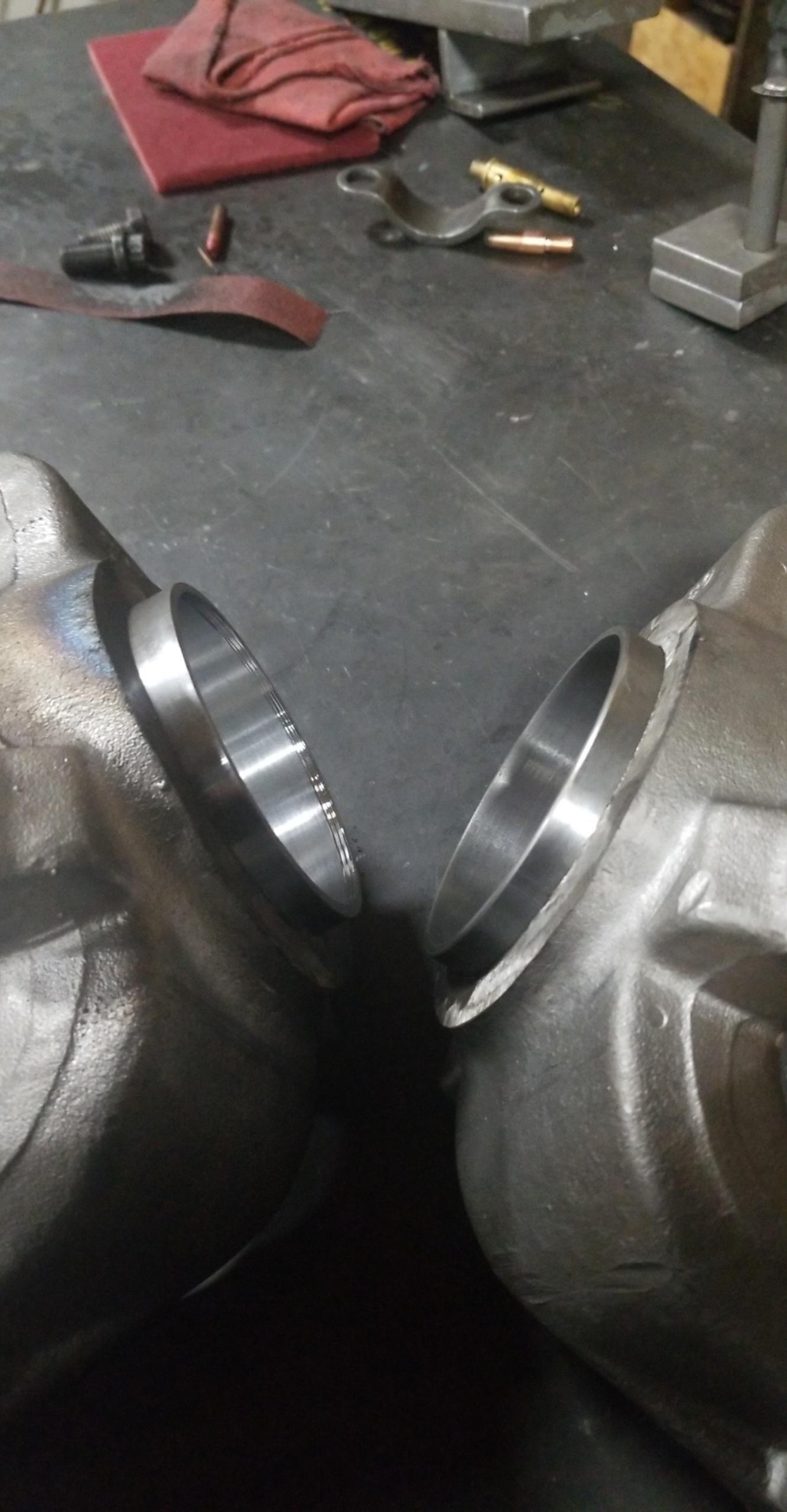

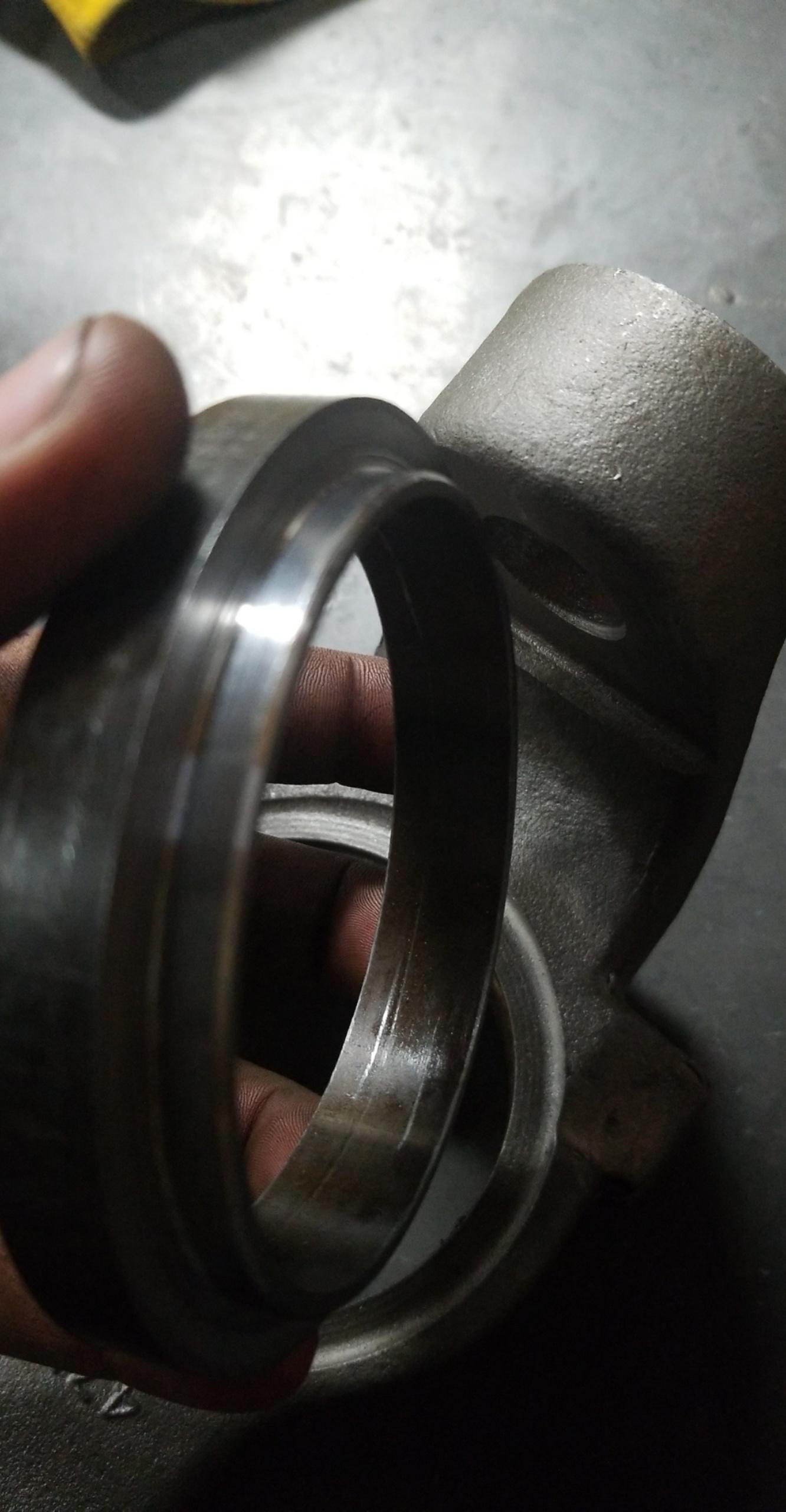

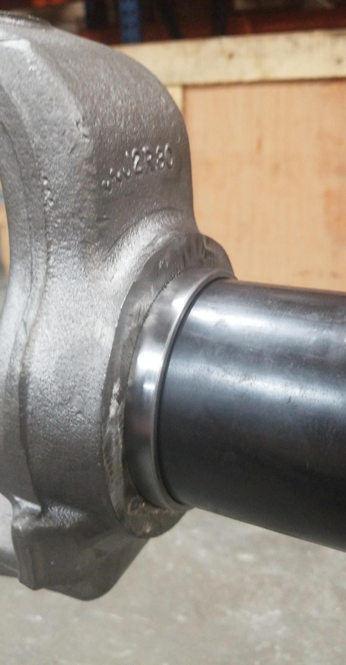

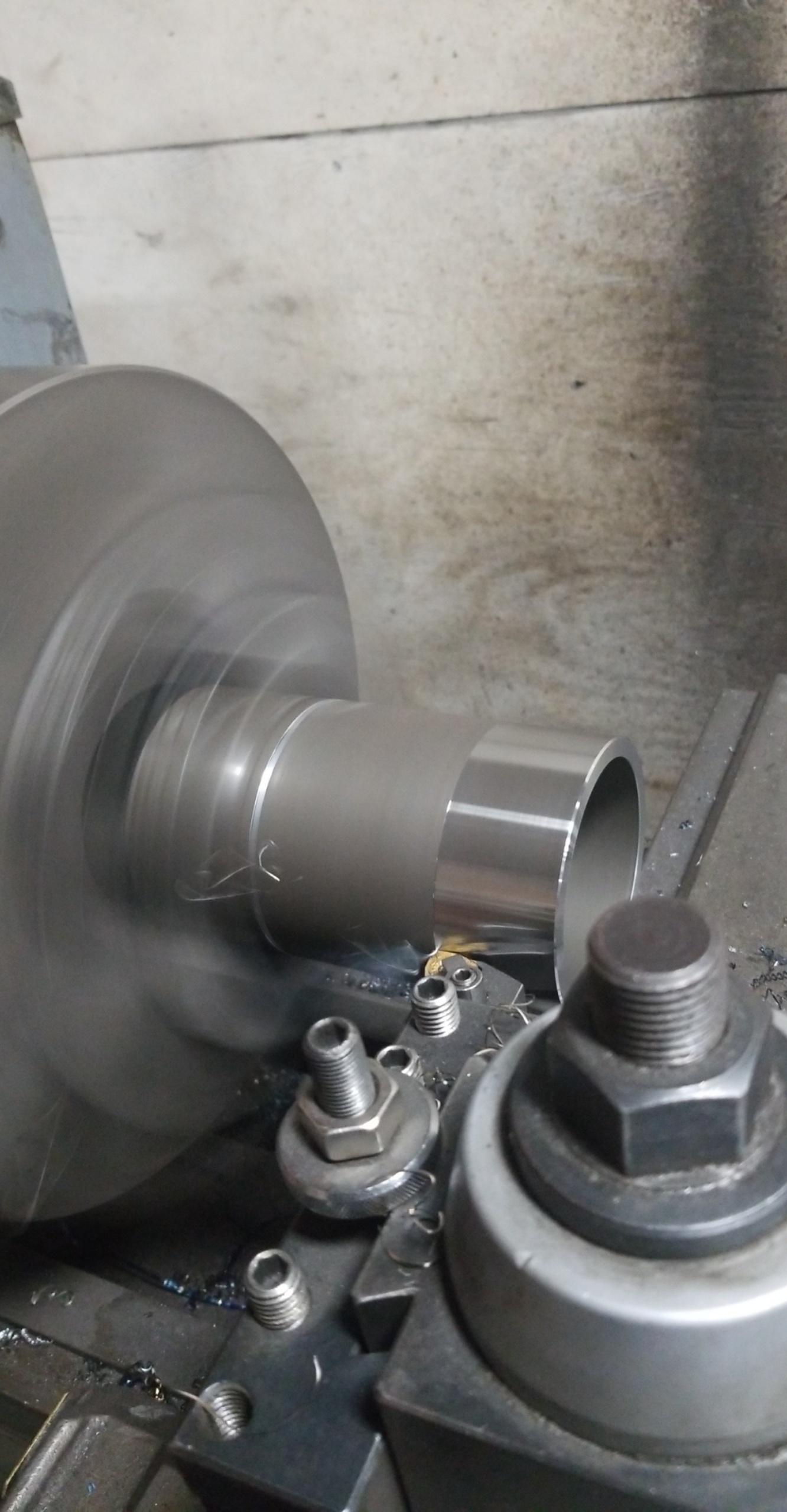

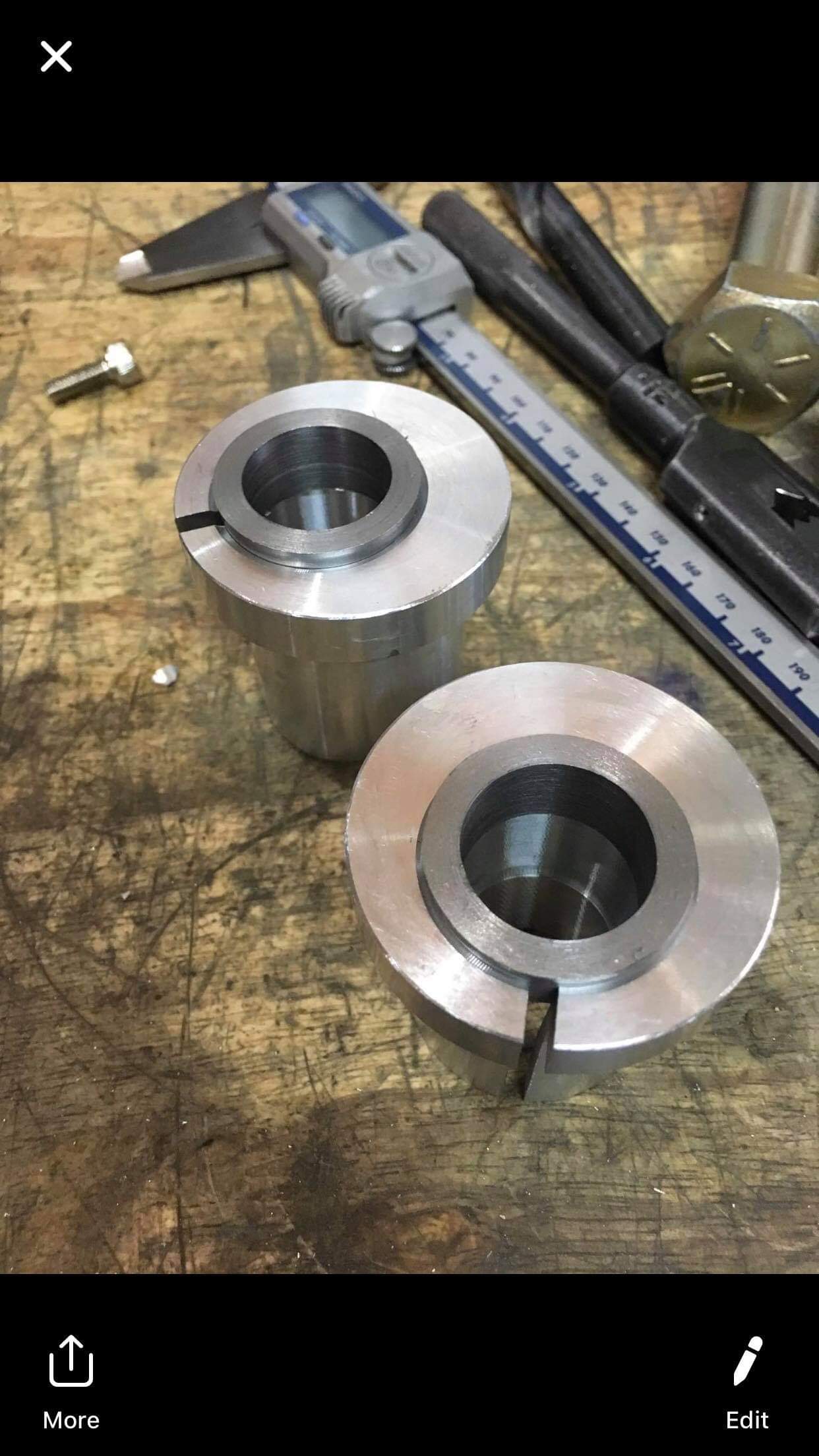

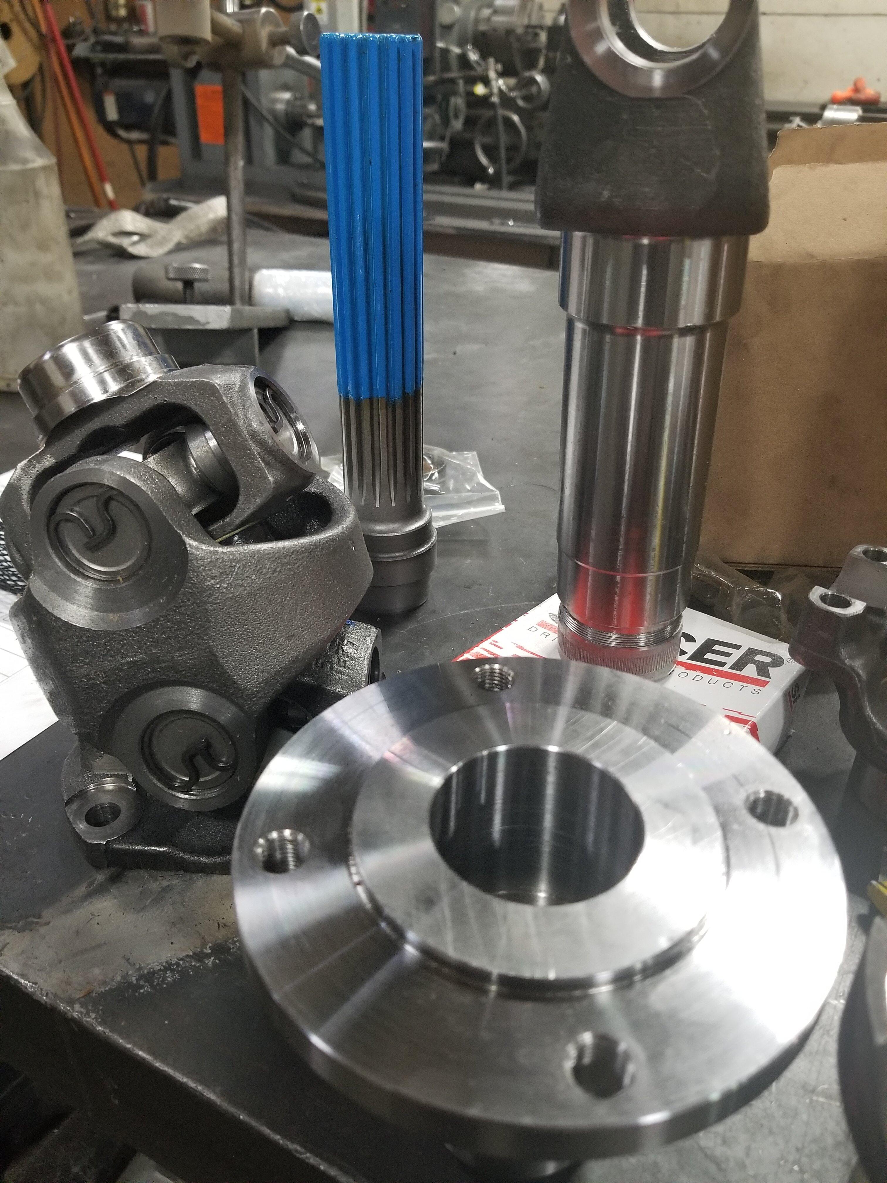

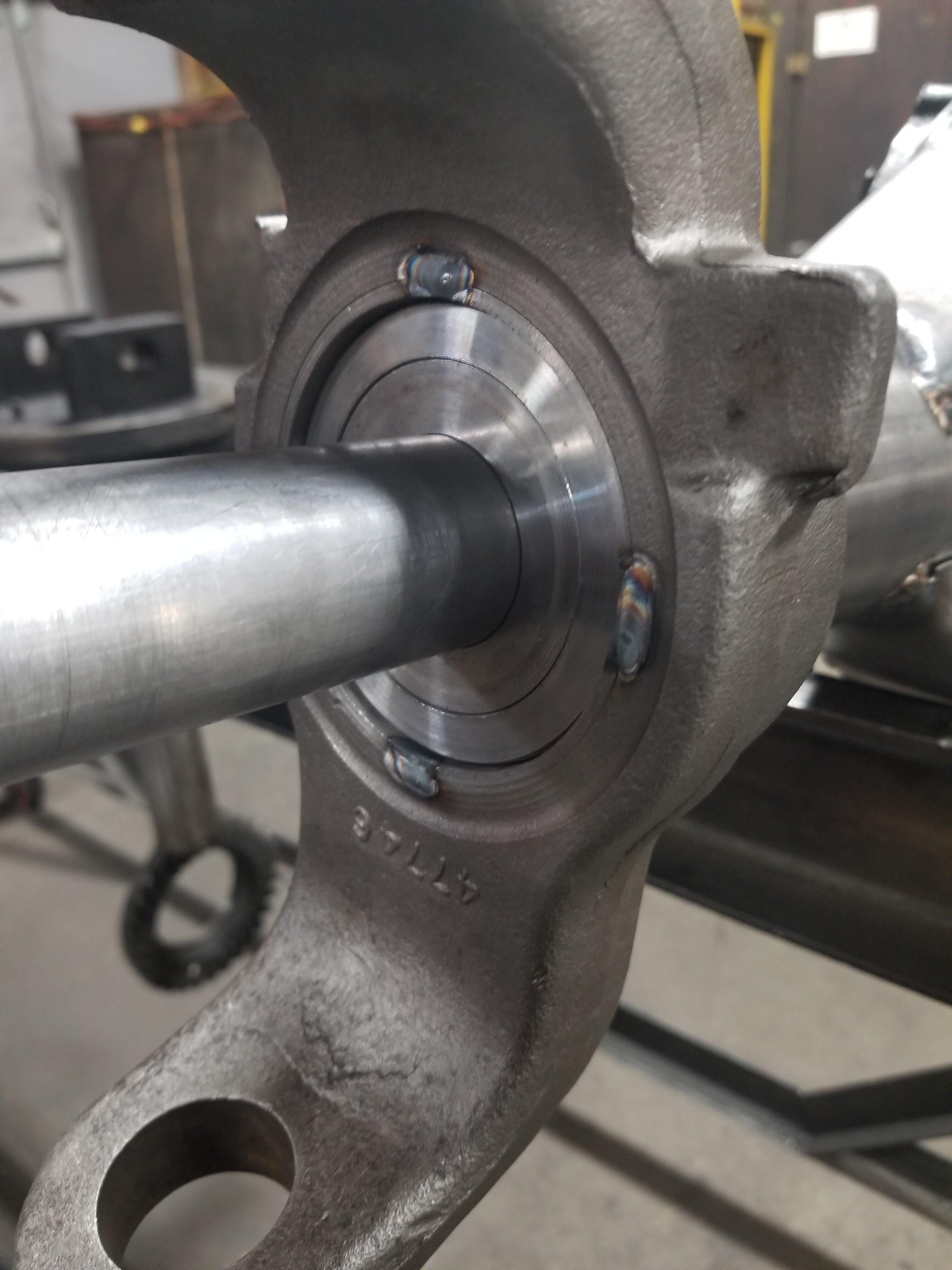

Started working on the inner C bushing/tube reducer.Kinda cut the Cs a little crooked so made my bushings a little long to get a set lenght.Machine a peice to stop the tube a .25in from the end of the C like the dana 50 wash.Then made my reducer bushing for the 3.5in to 3.25in tube out of 3.5x.25.Press right in and bored the bushing to .005 over the 3.25 tube dia for a nice slide on fit to set caster later

Nice build. I've really enjoyed it so far. Looking forward to more. Always nice to see some lathe work.
