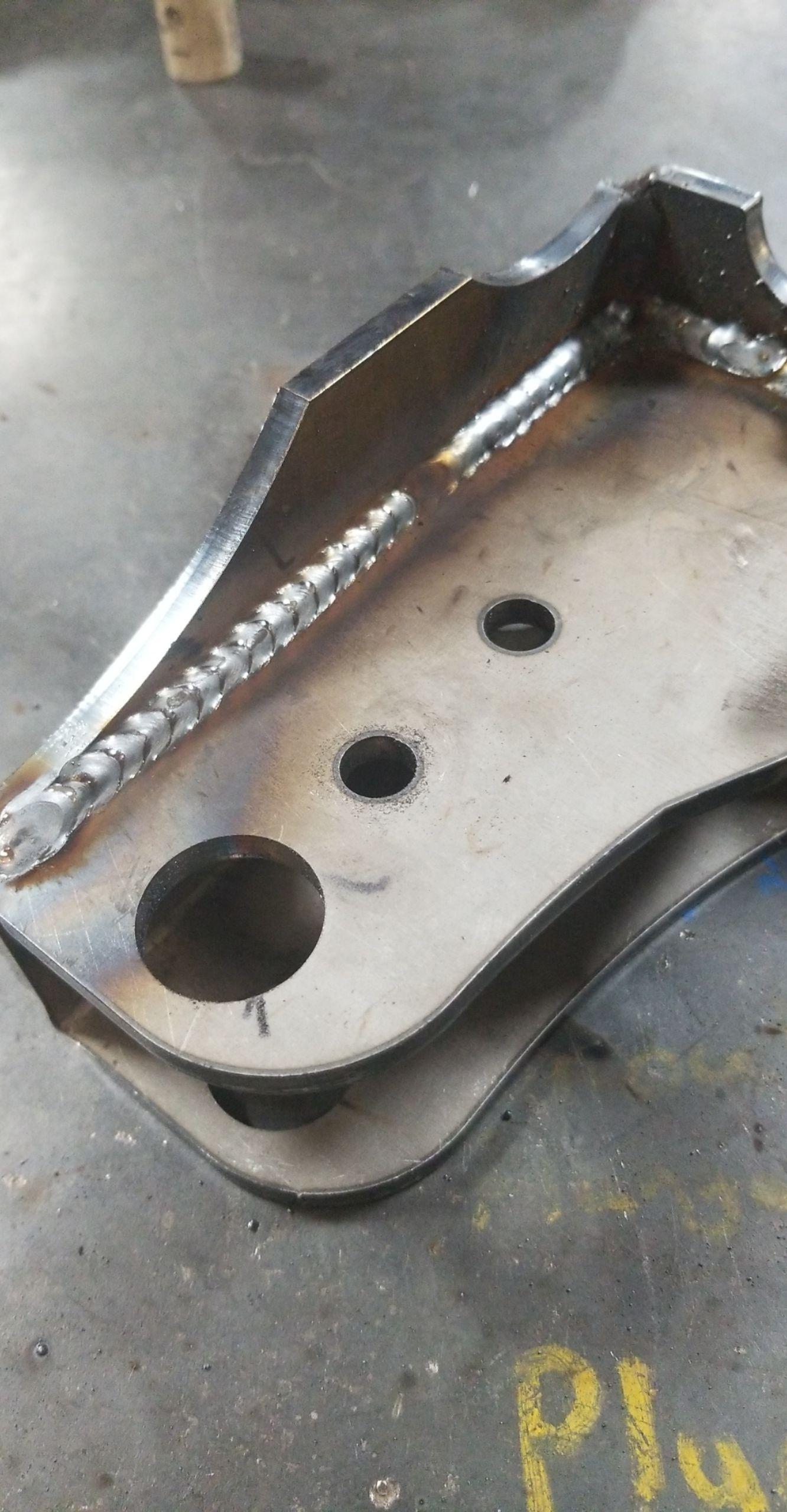

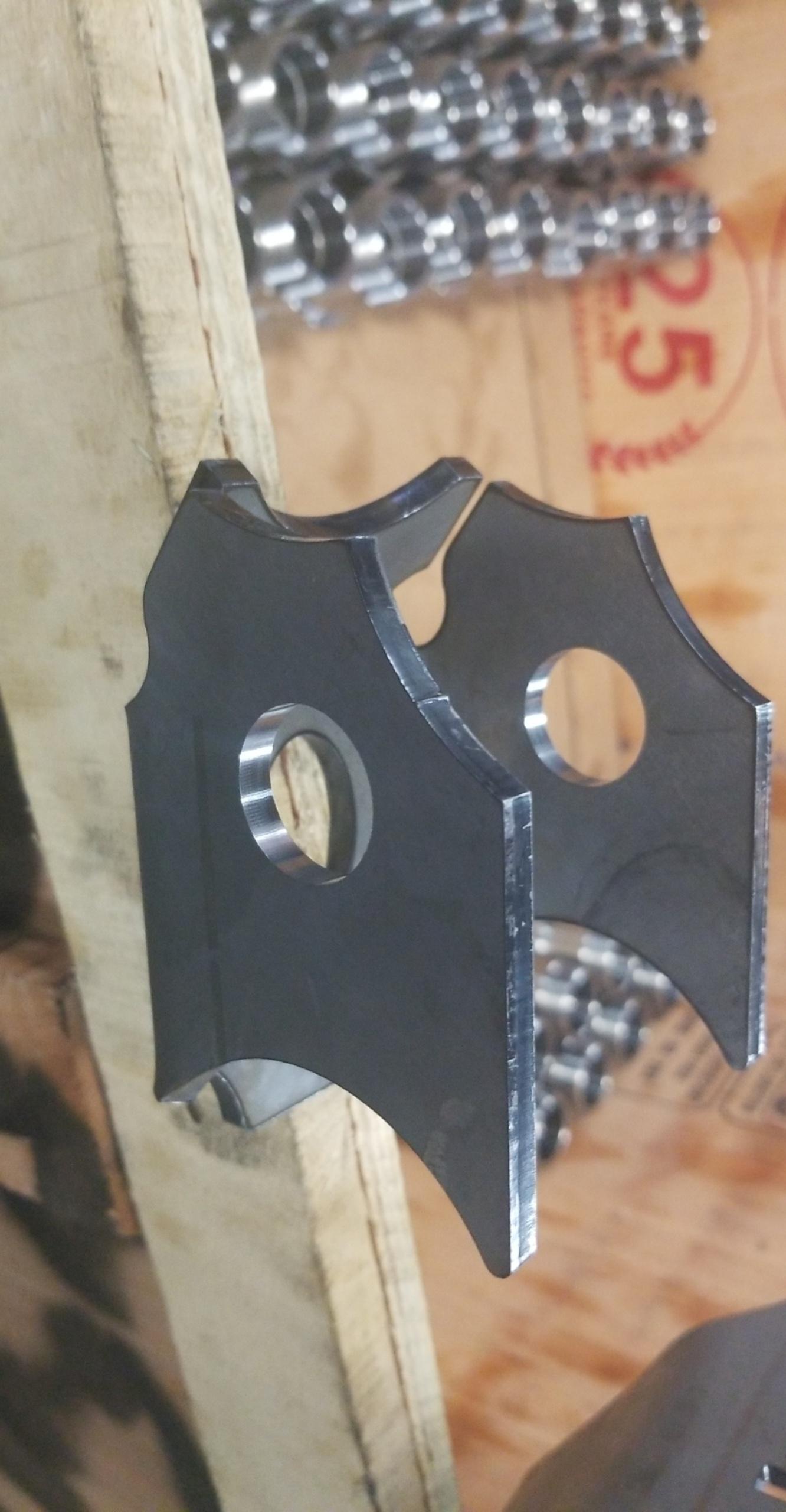

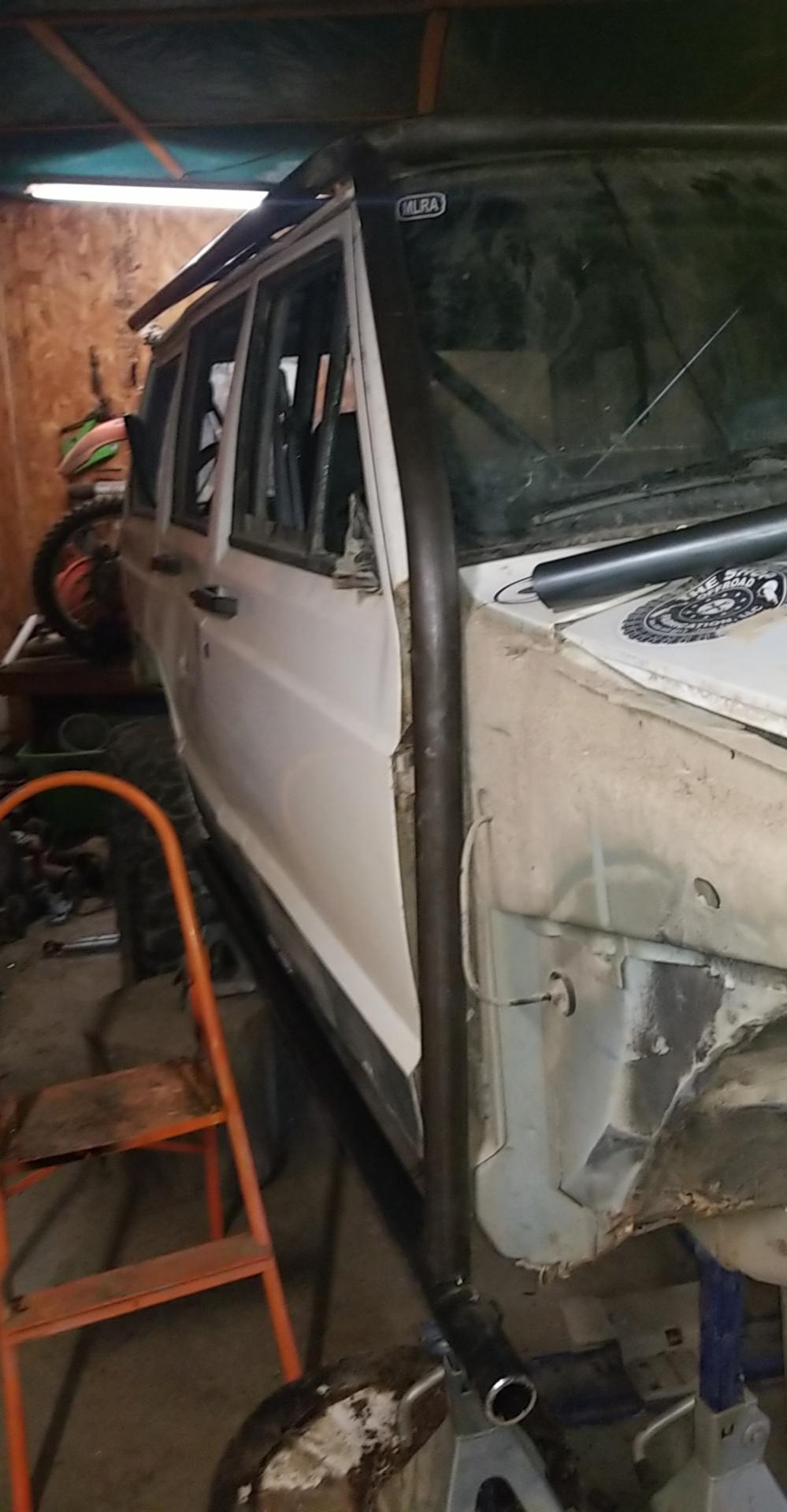

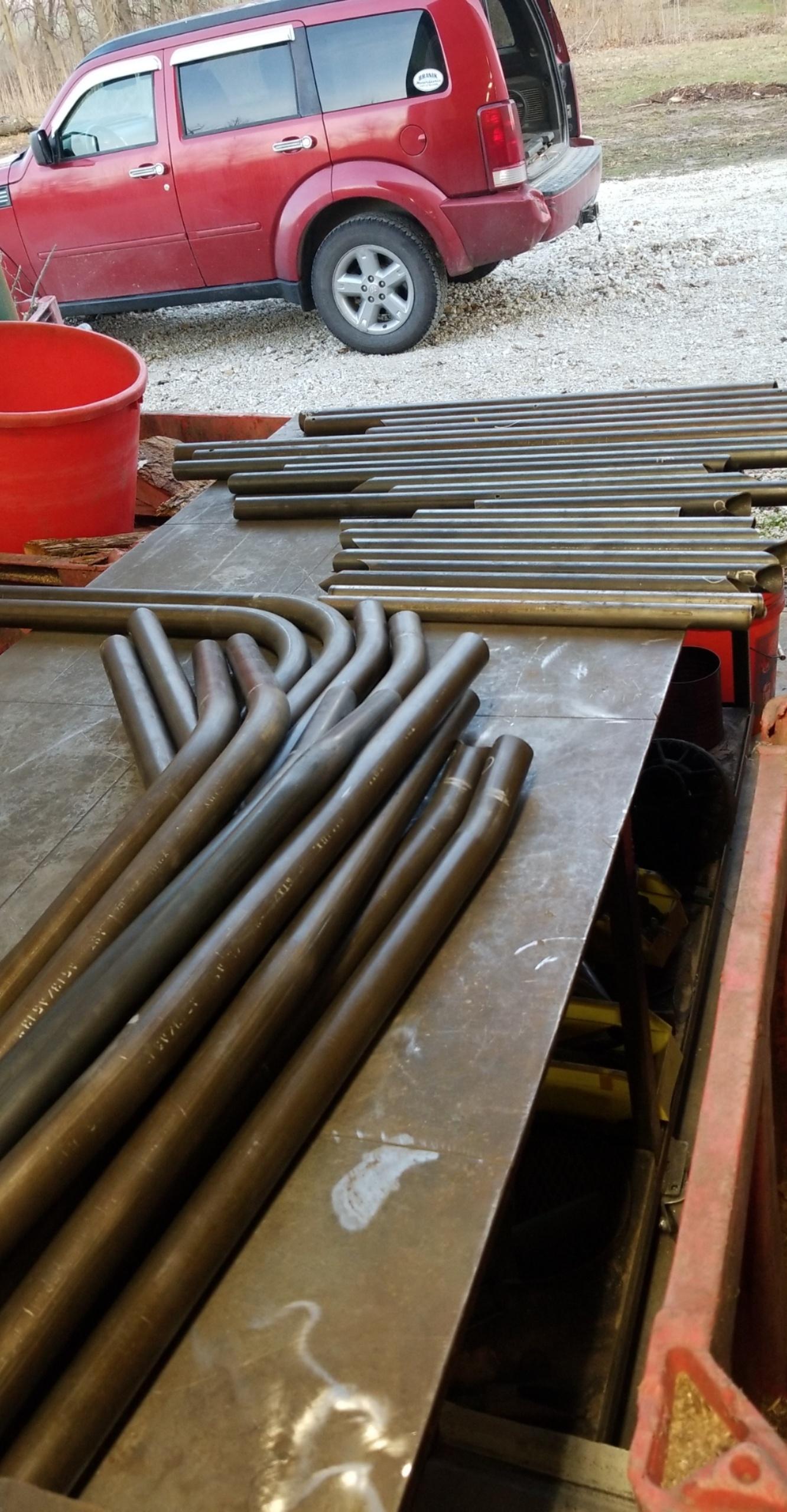

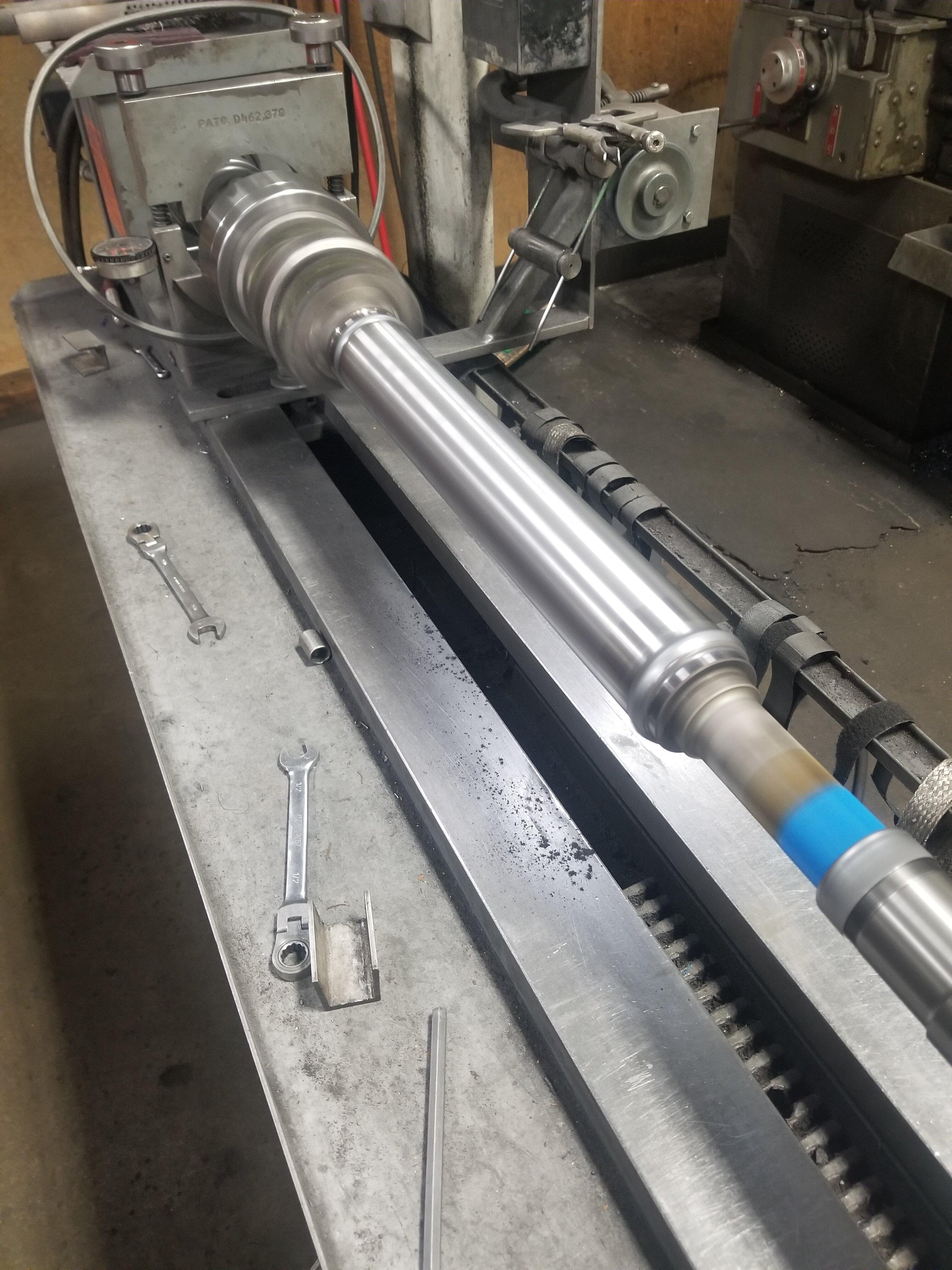

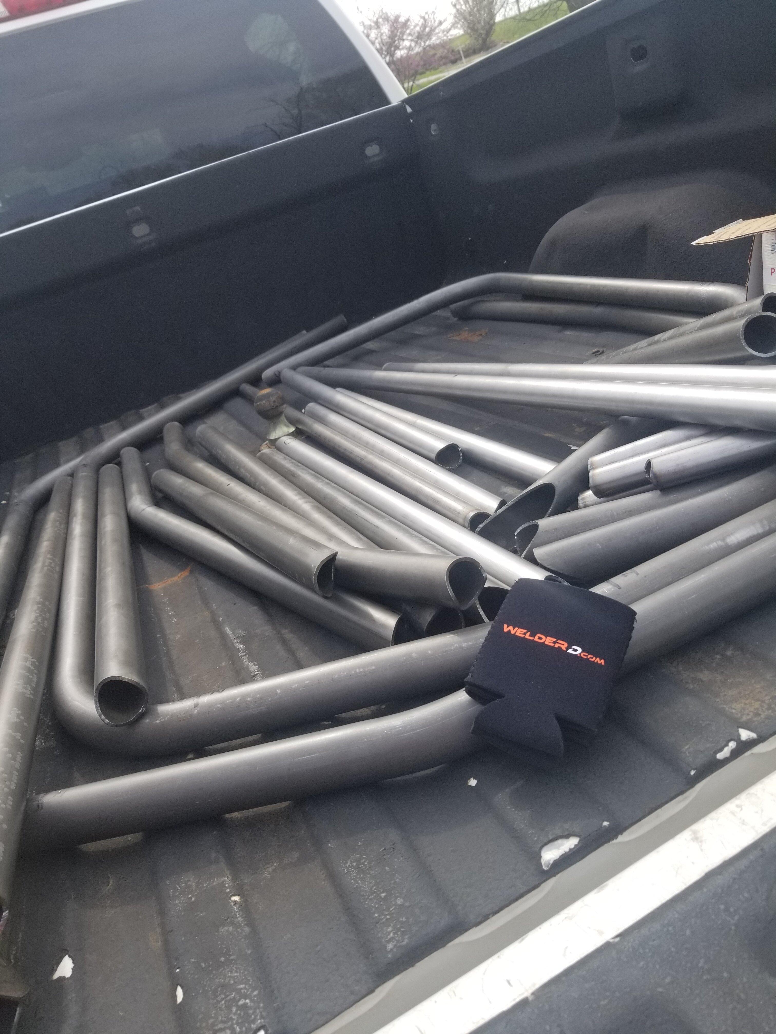

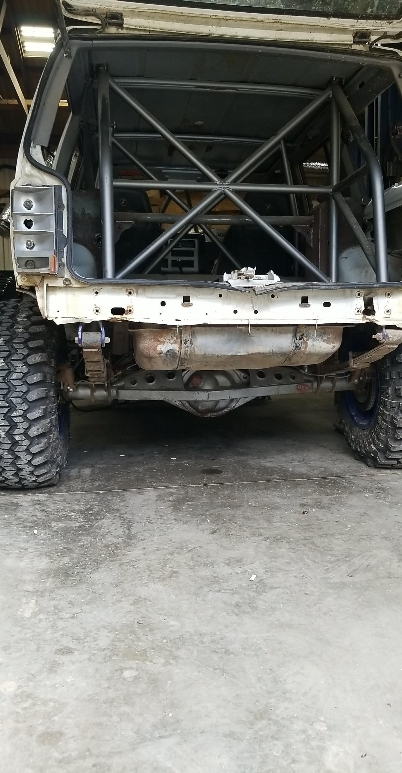

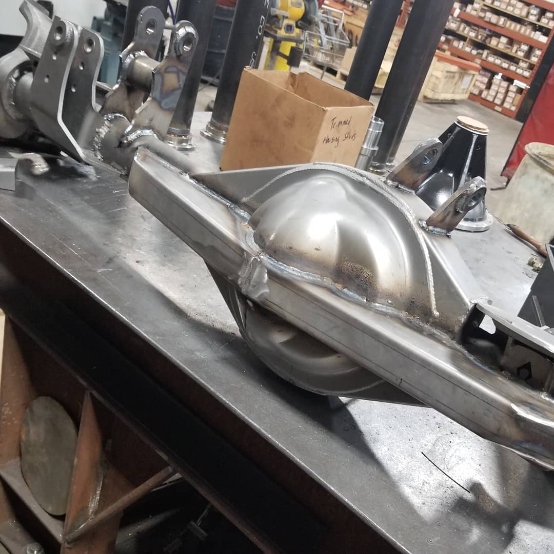

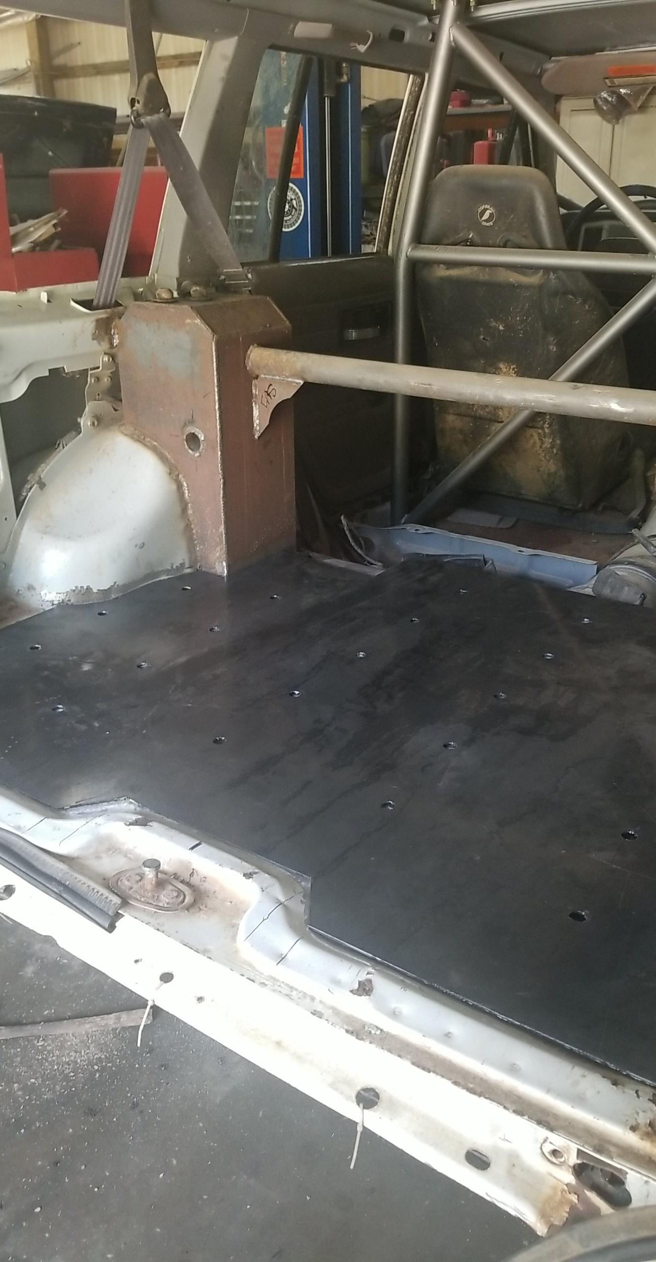

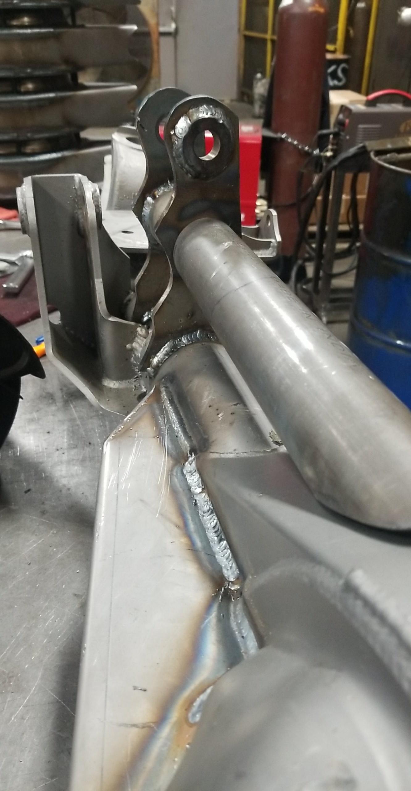

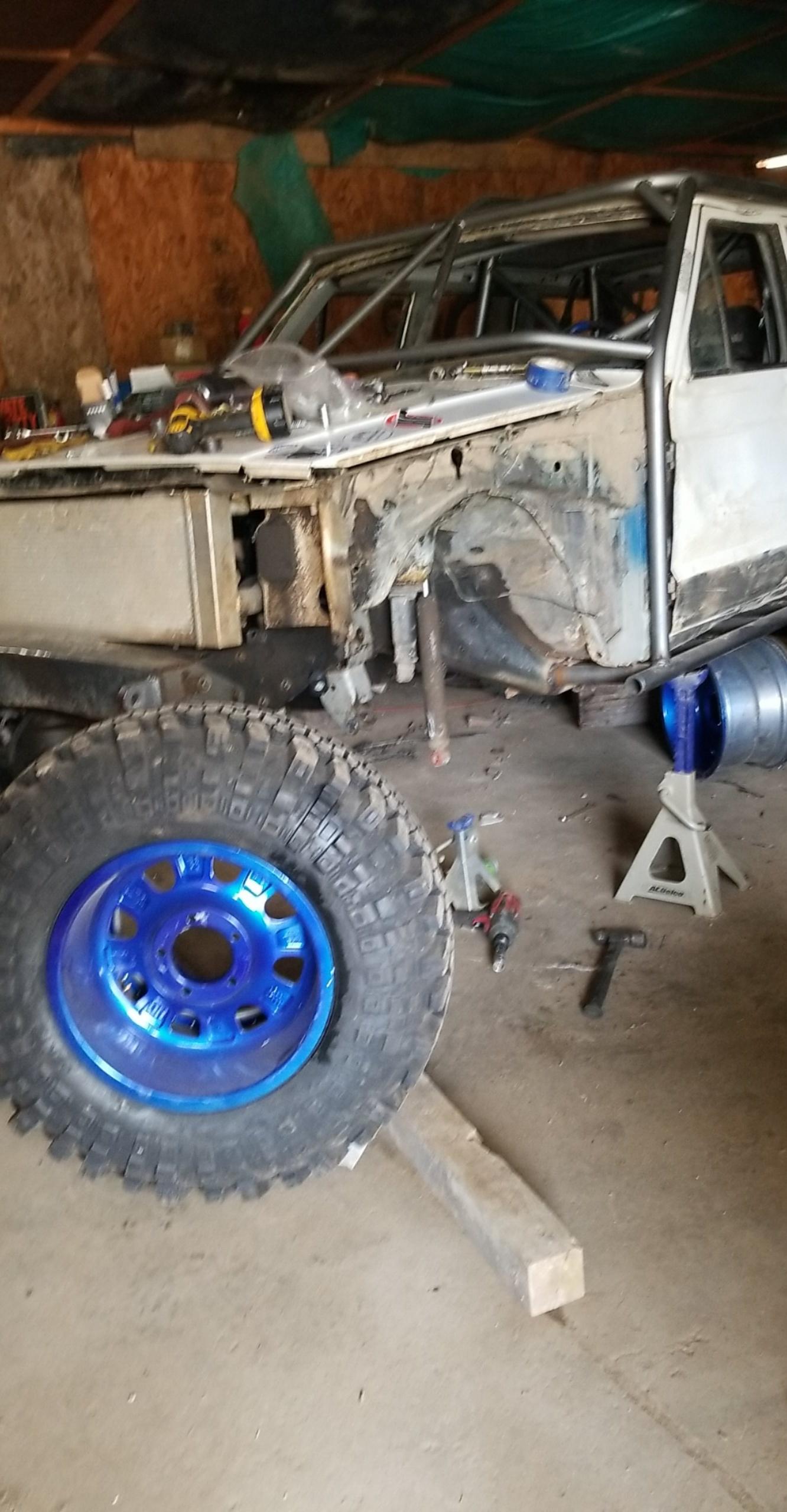

Been waiting on parts to come in.But have started welding out the housing.and machining brackets

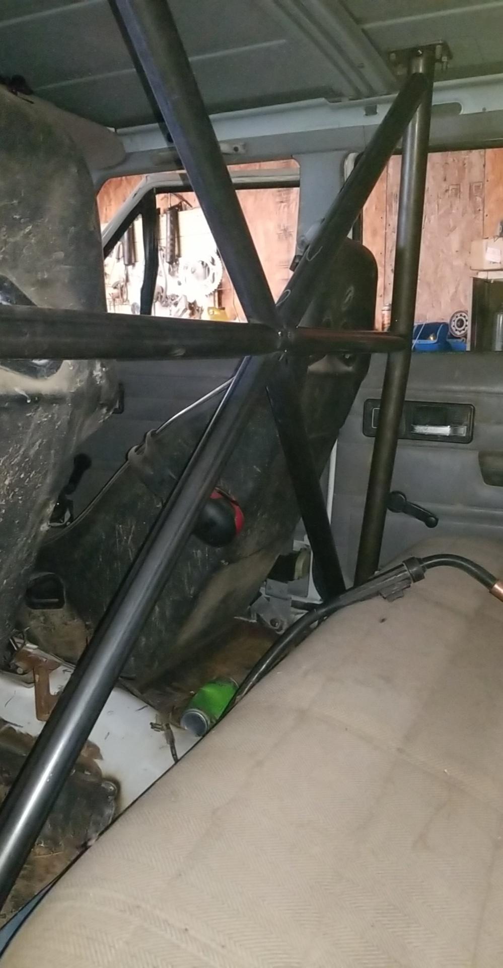

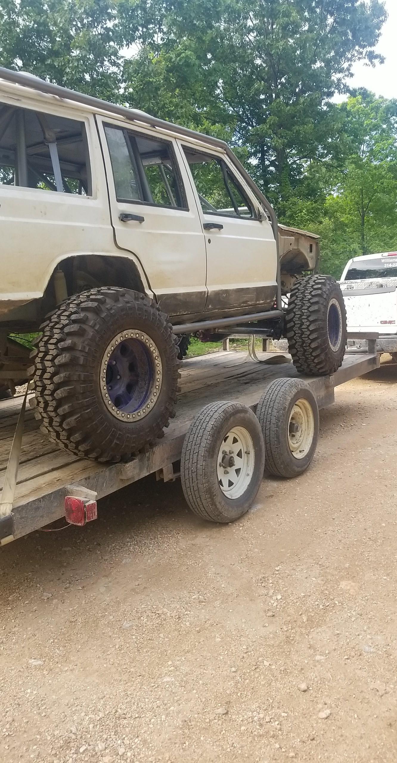

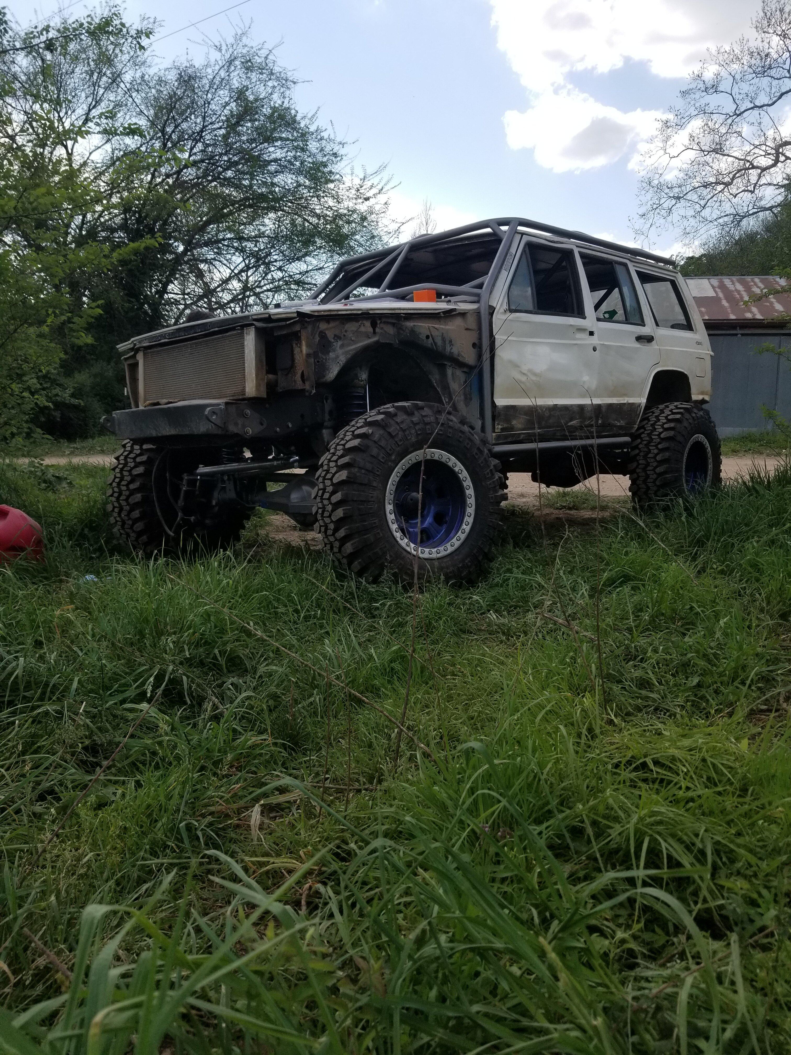

Also found a co driver Jake Pike and my number 77 for the class. Aiming for the first race in at Rush Offroad this year.

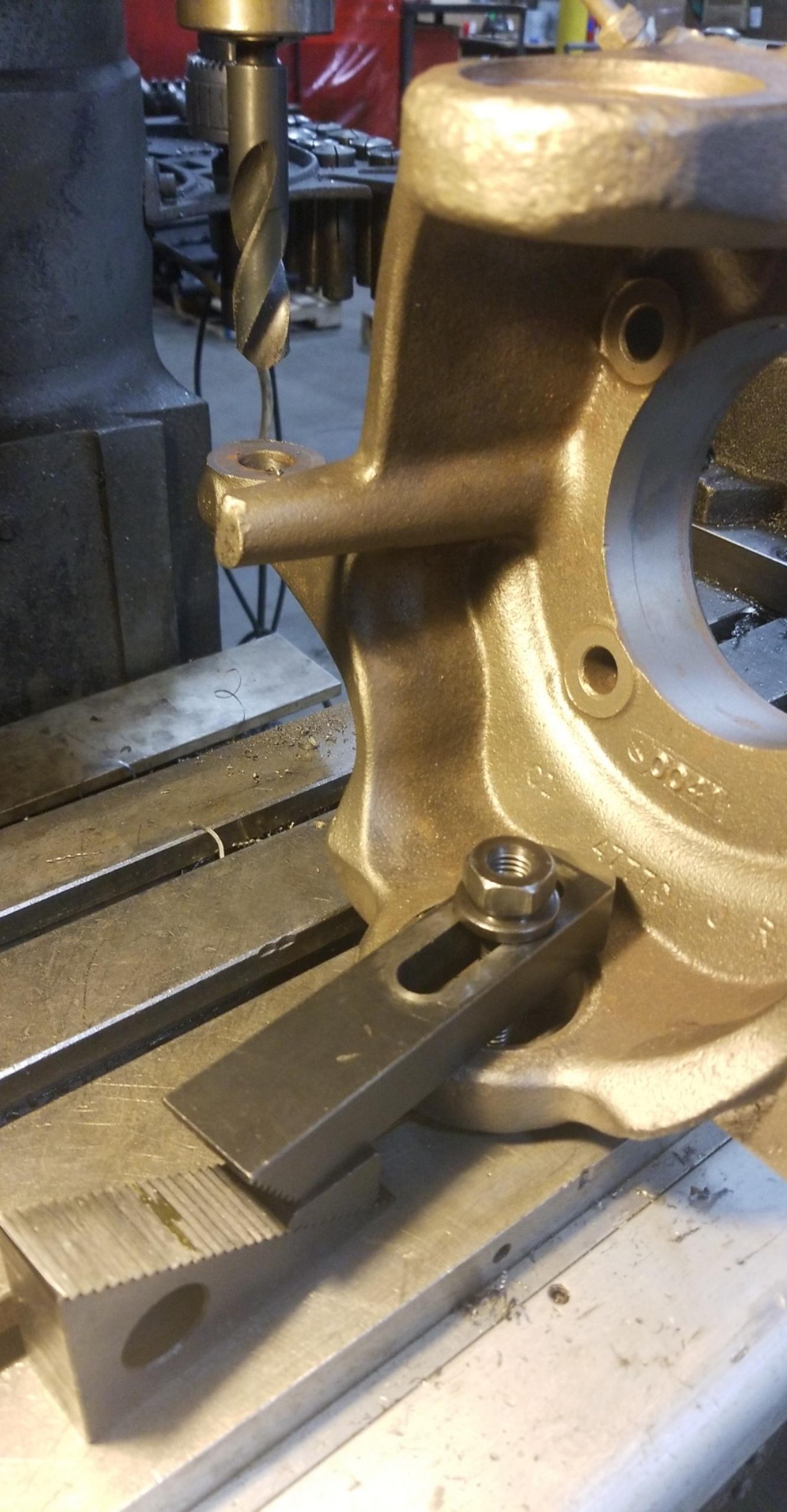

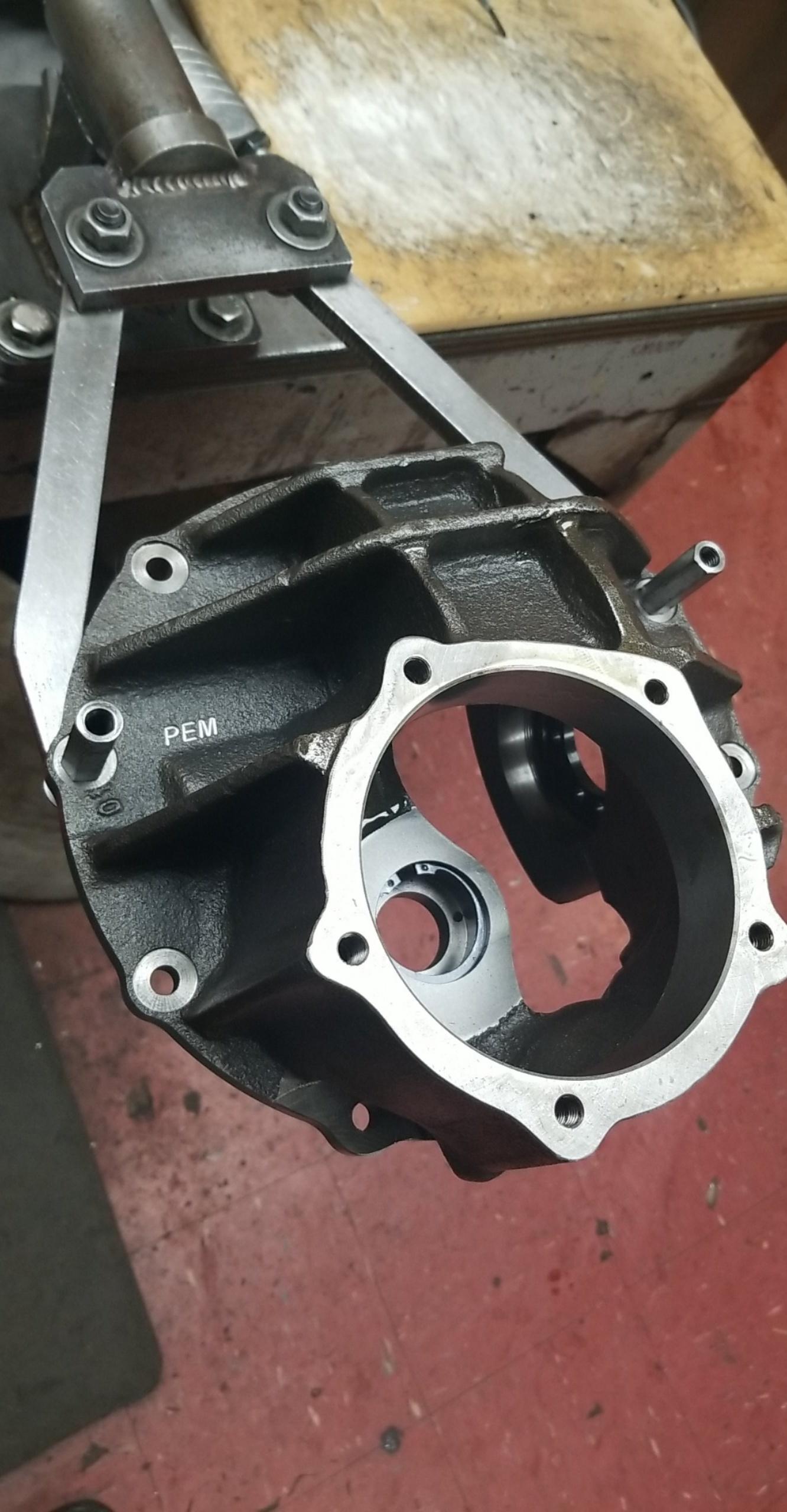

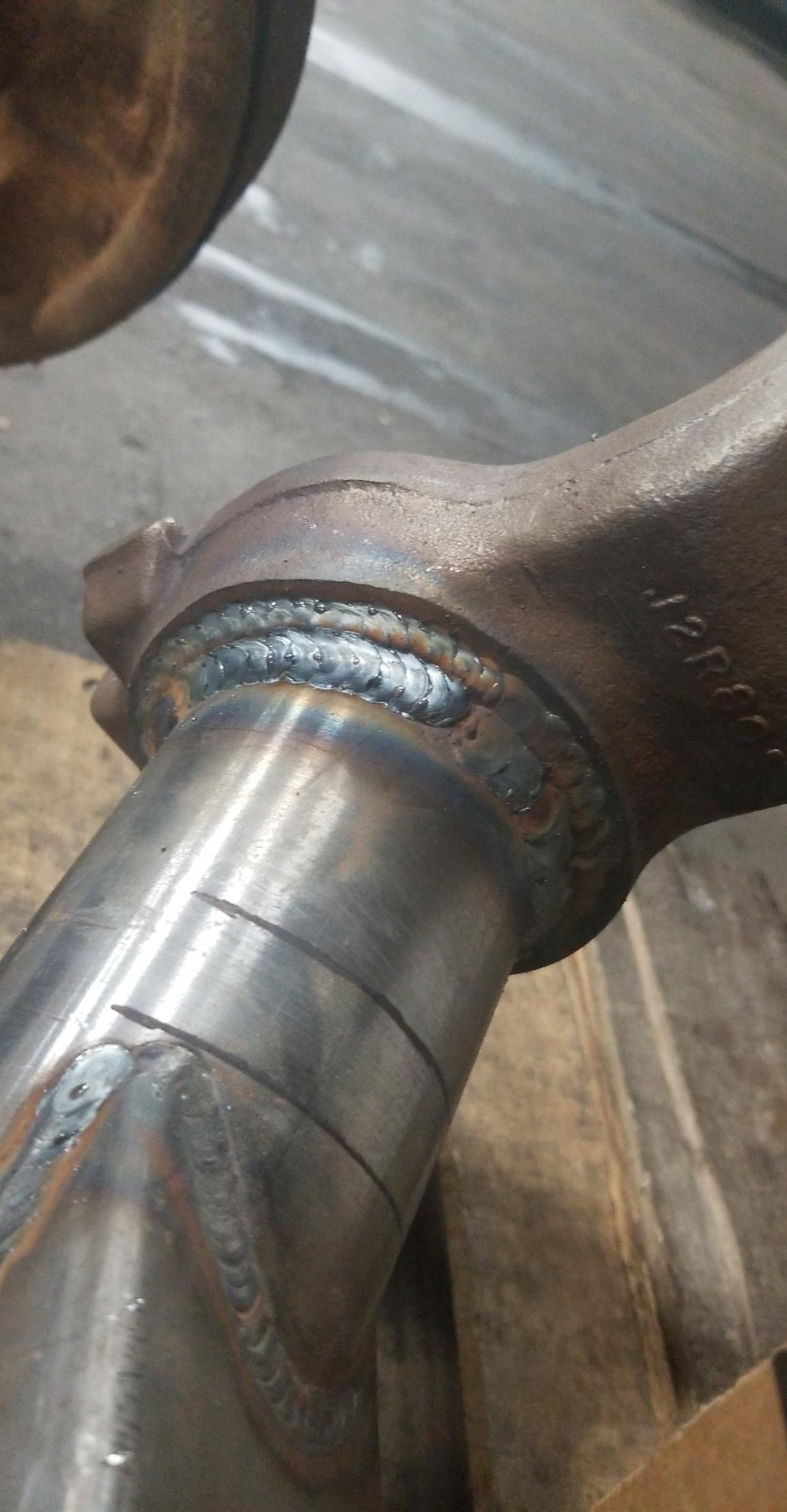

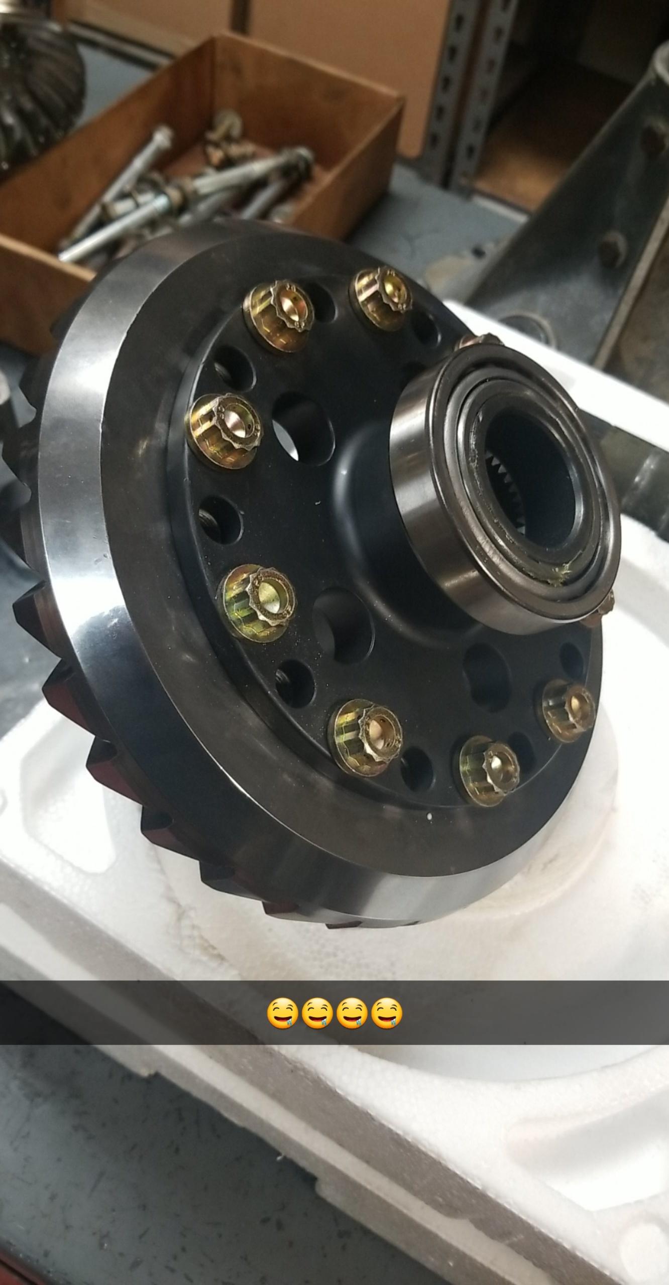

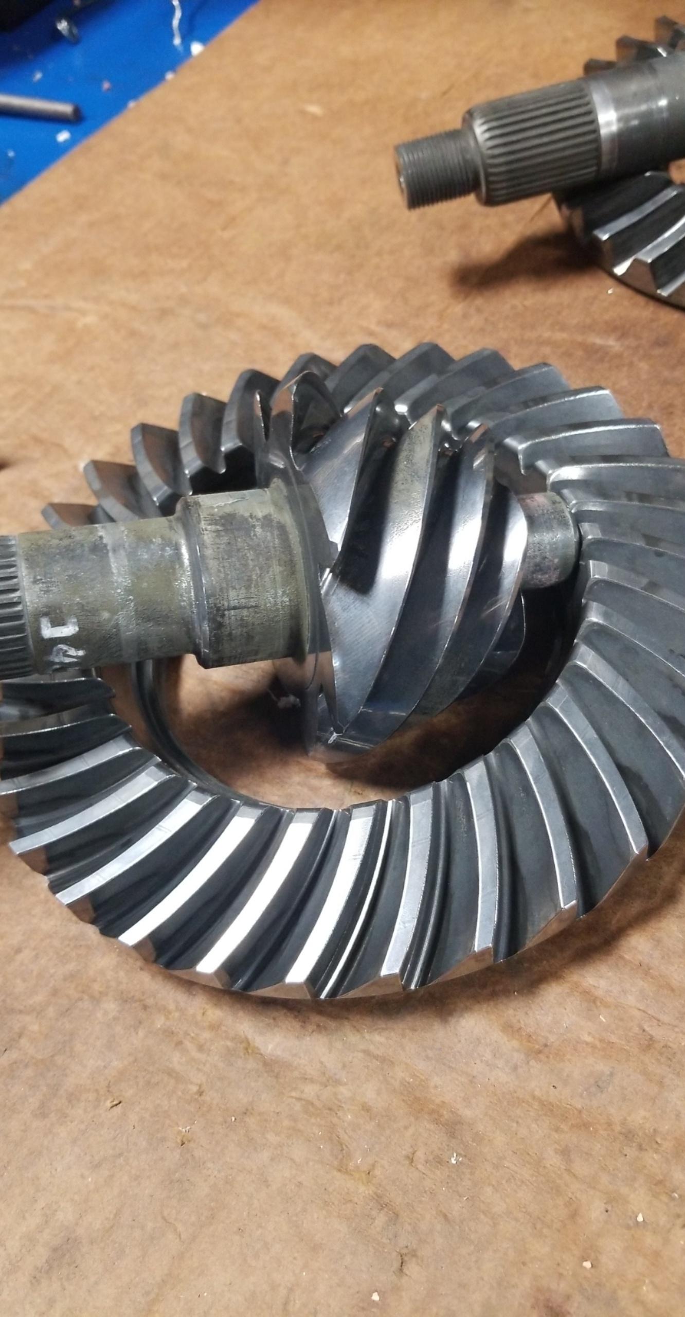

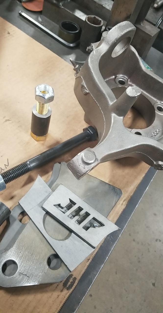

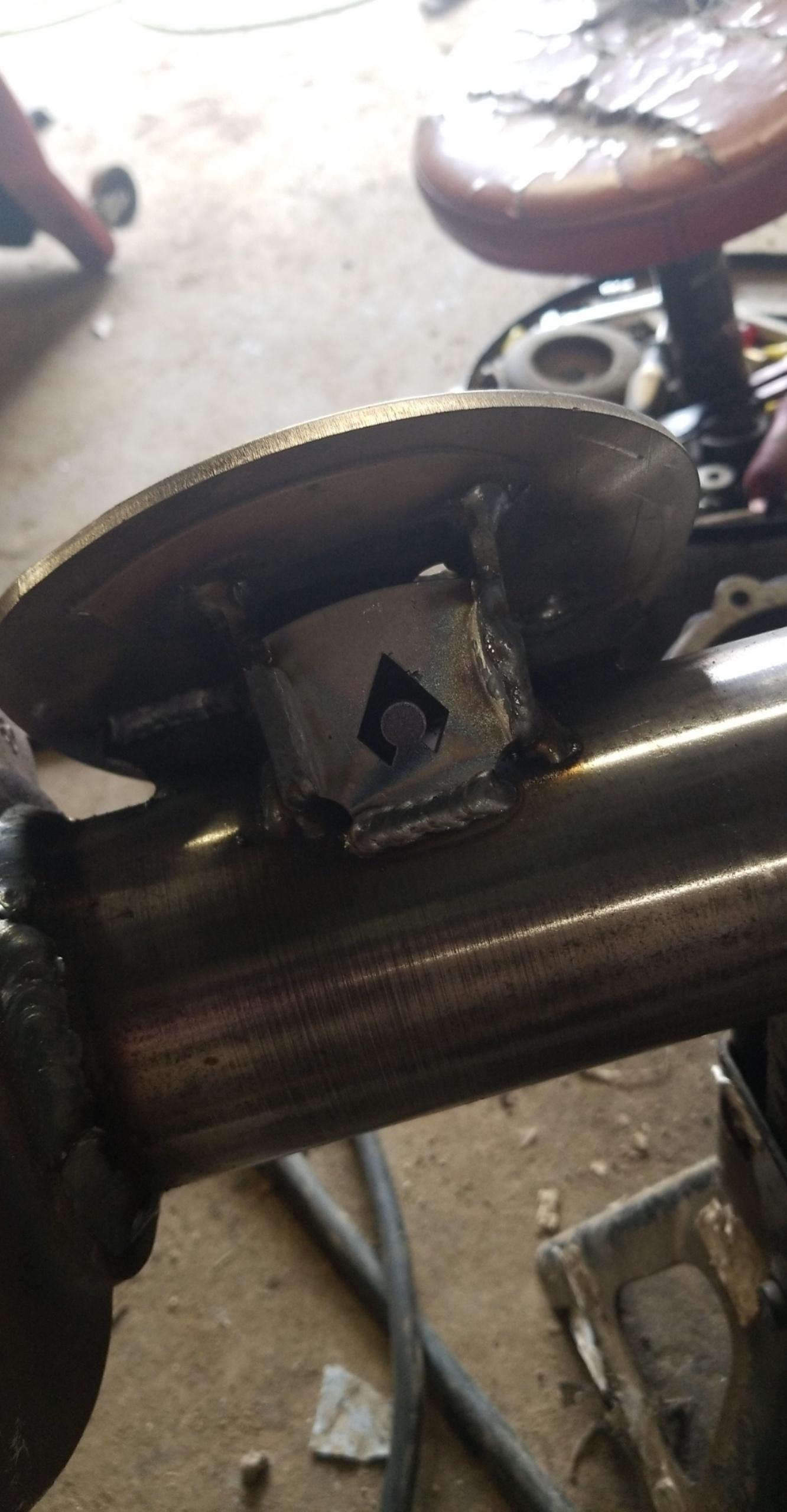

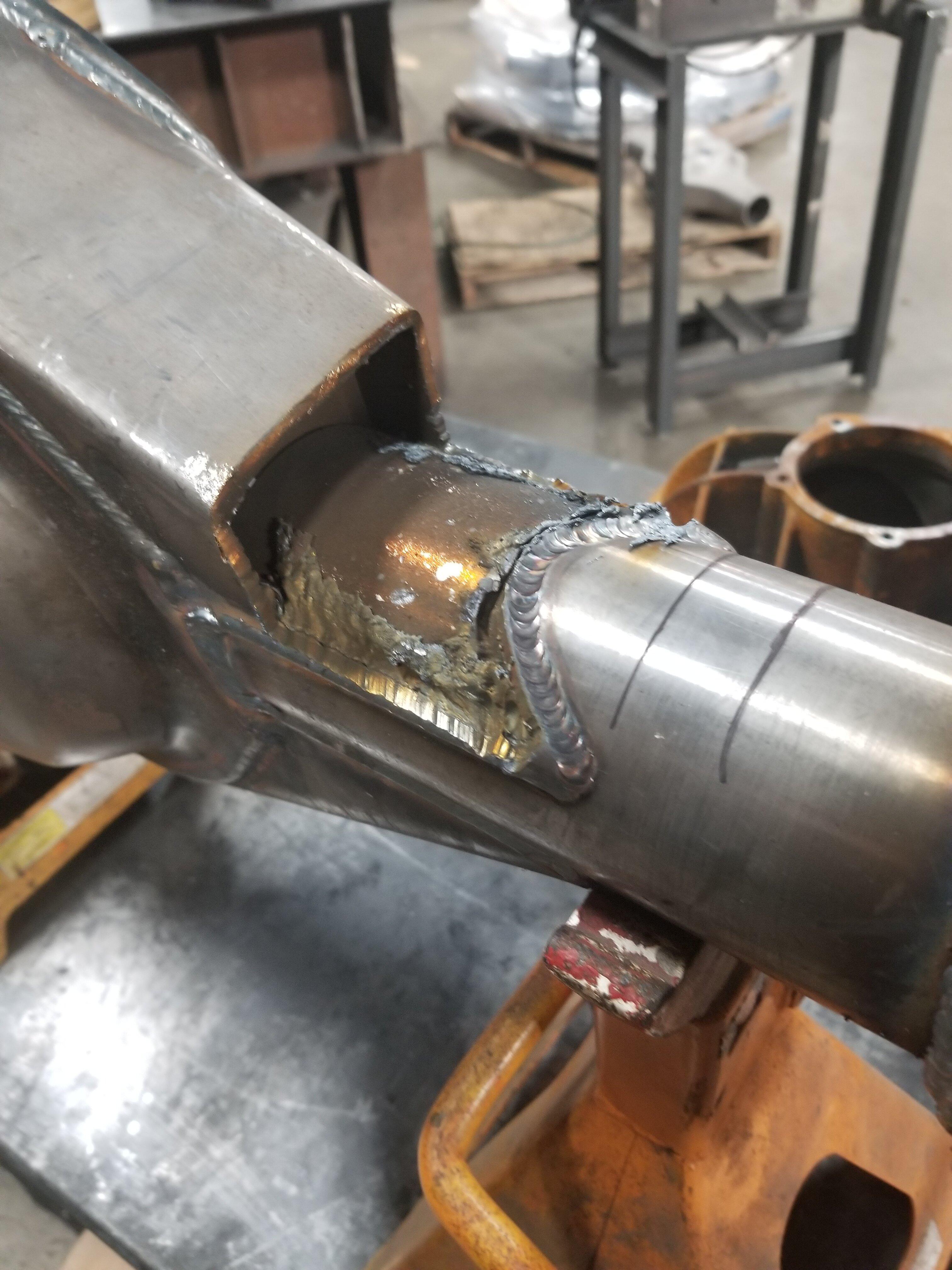

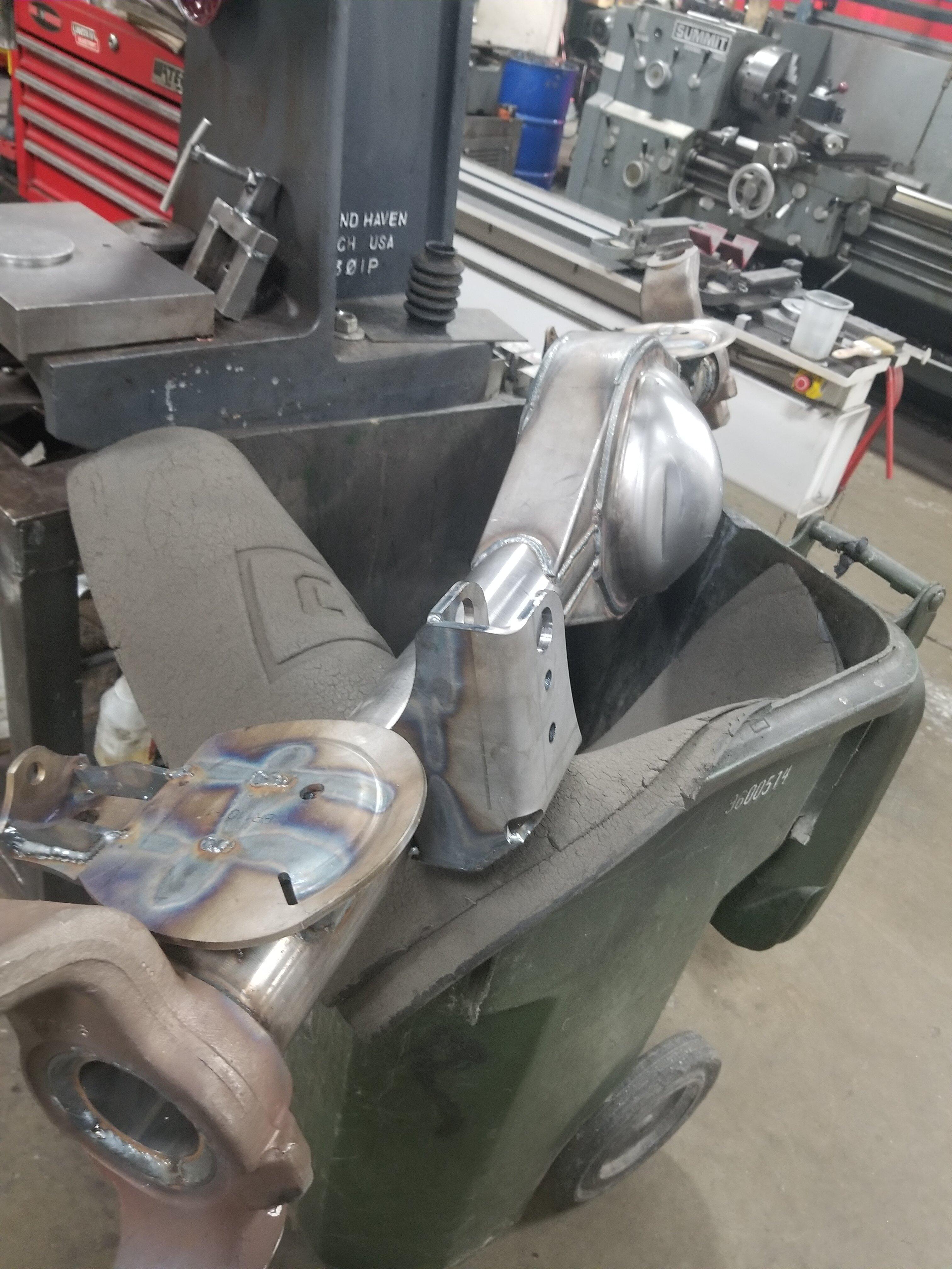

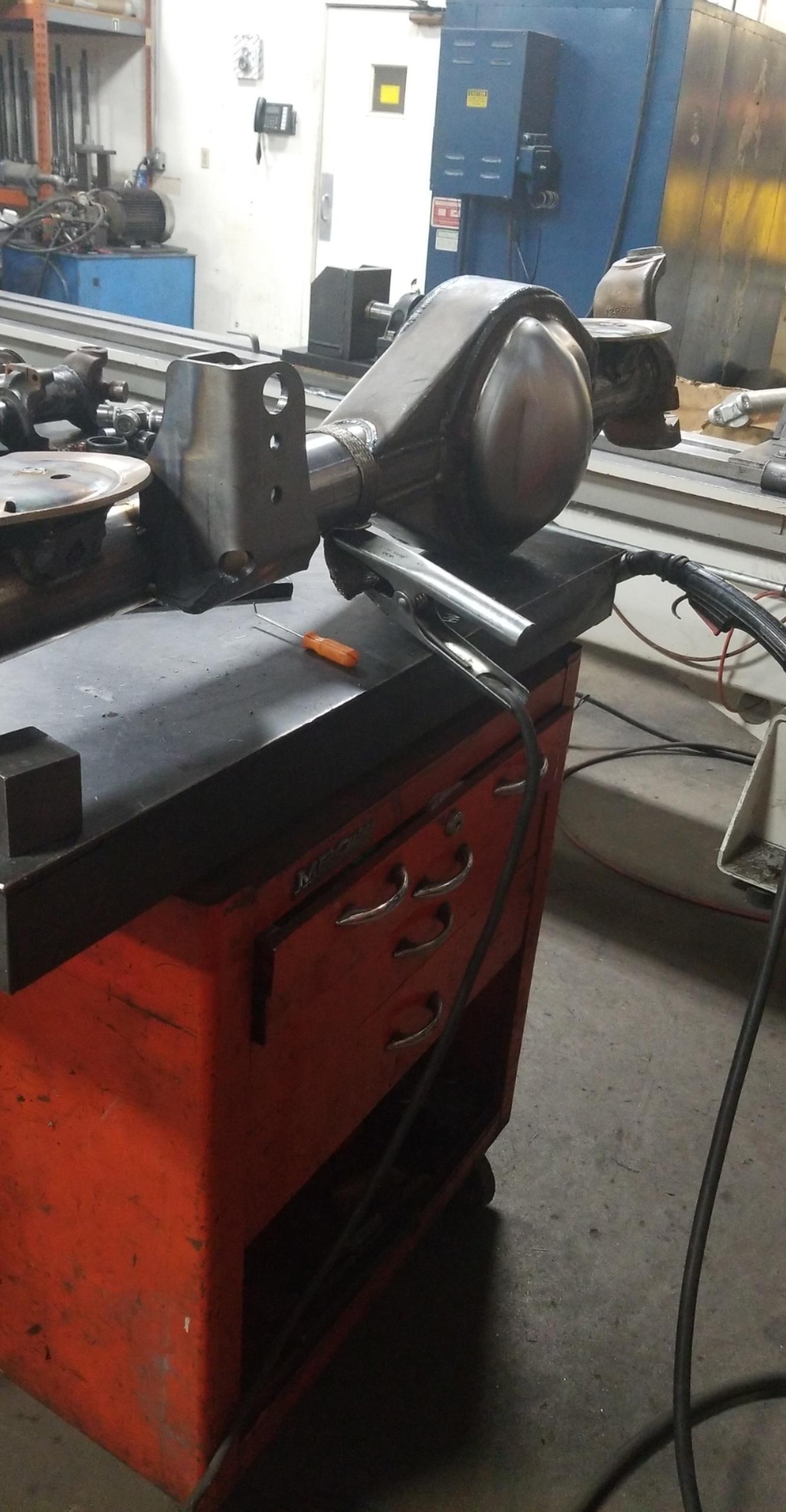

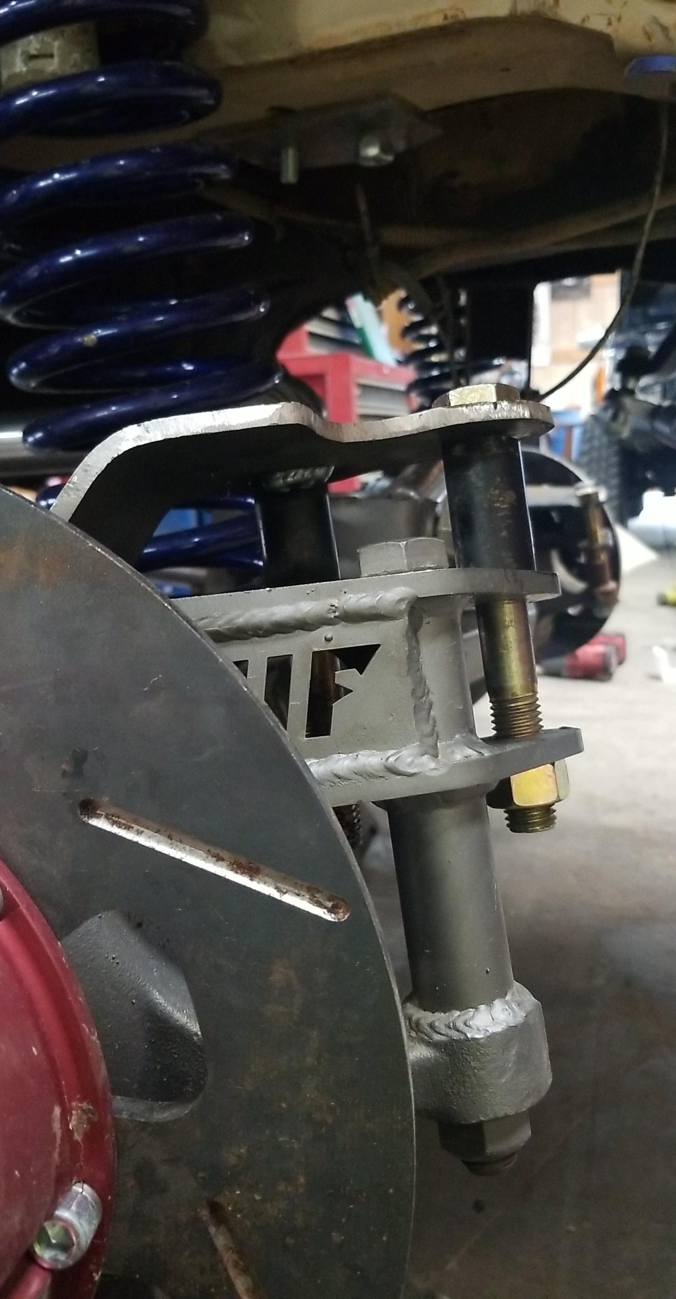

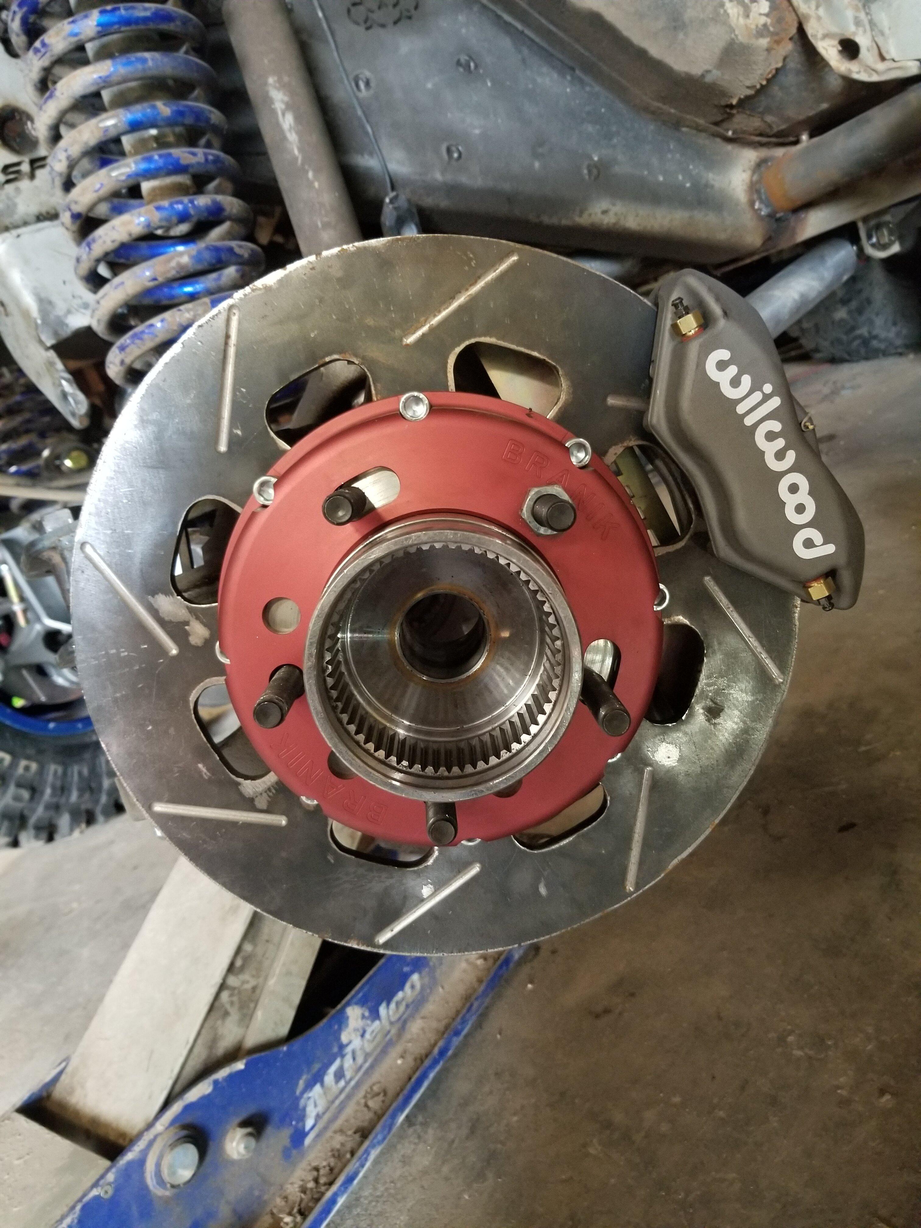

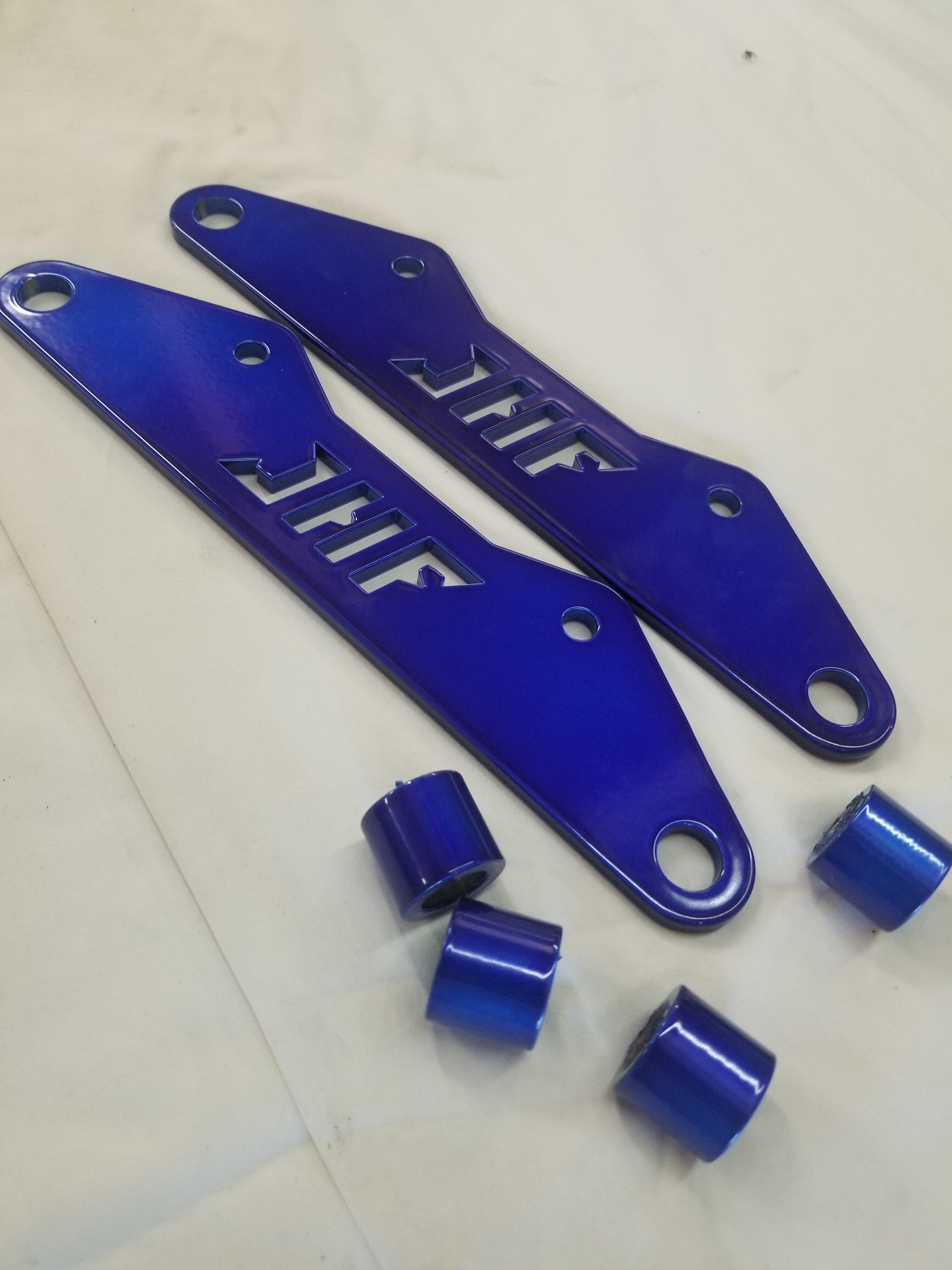

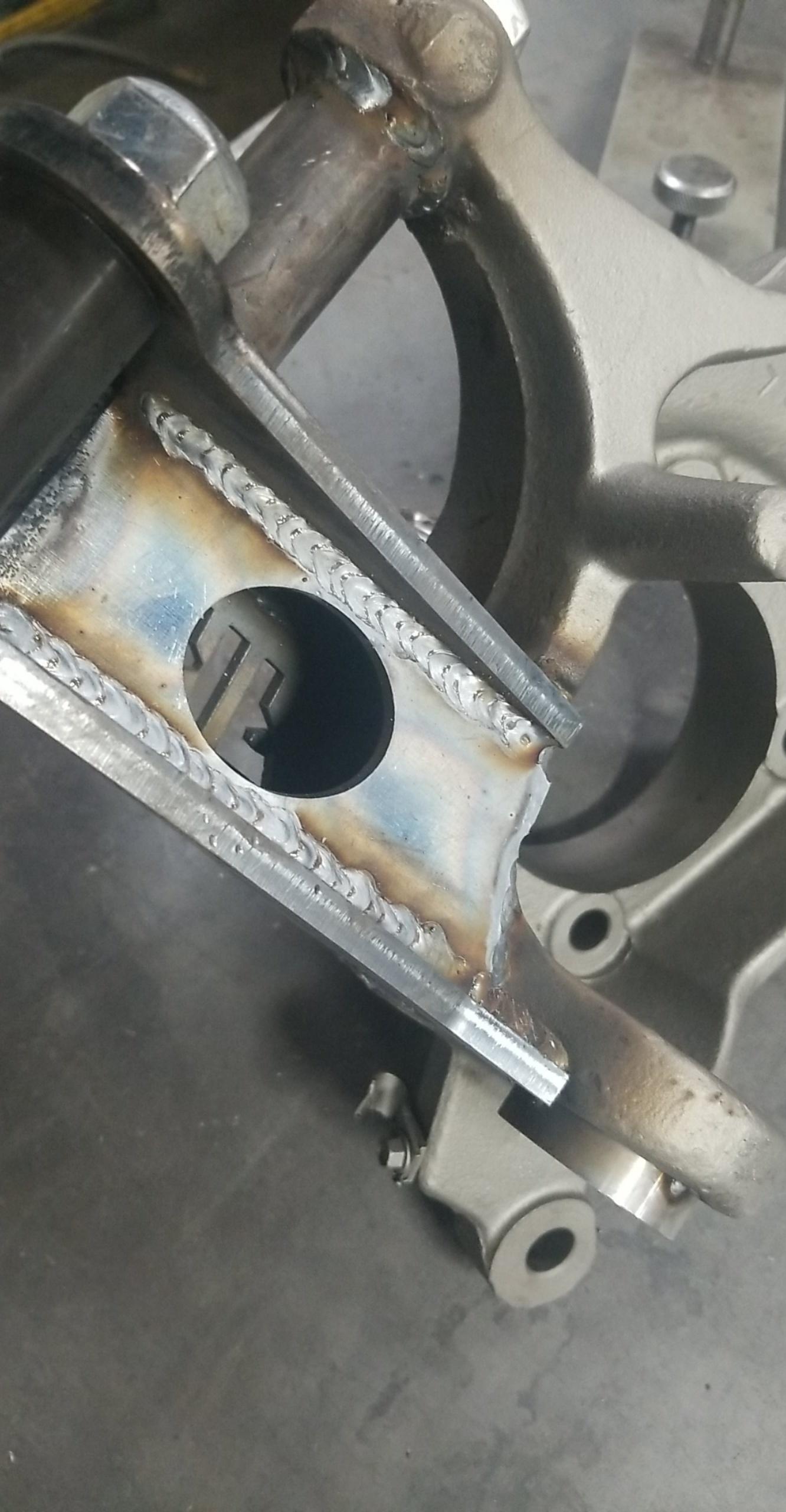

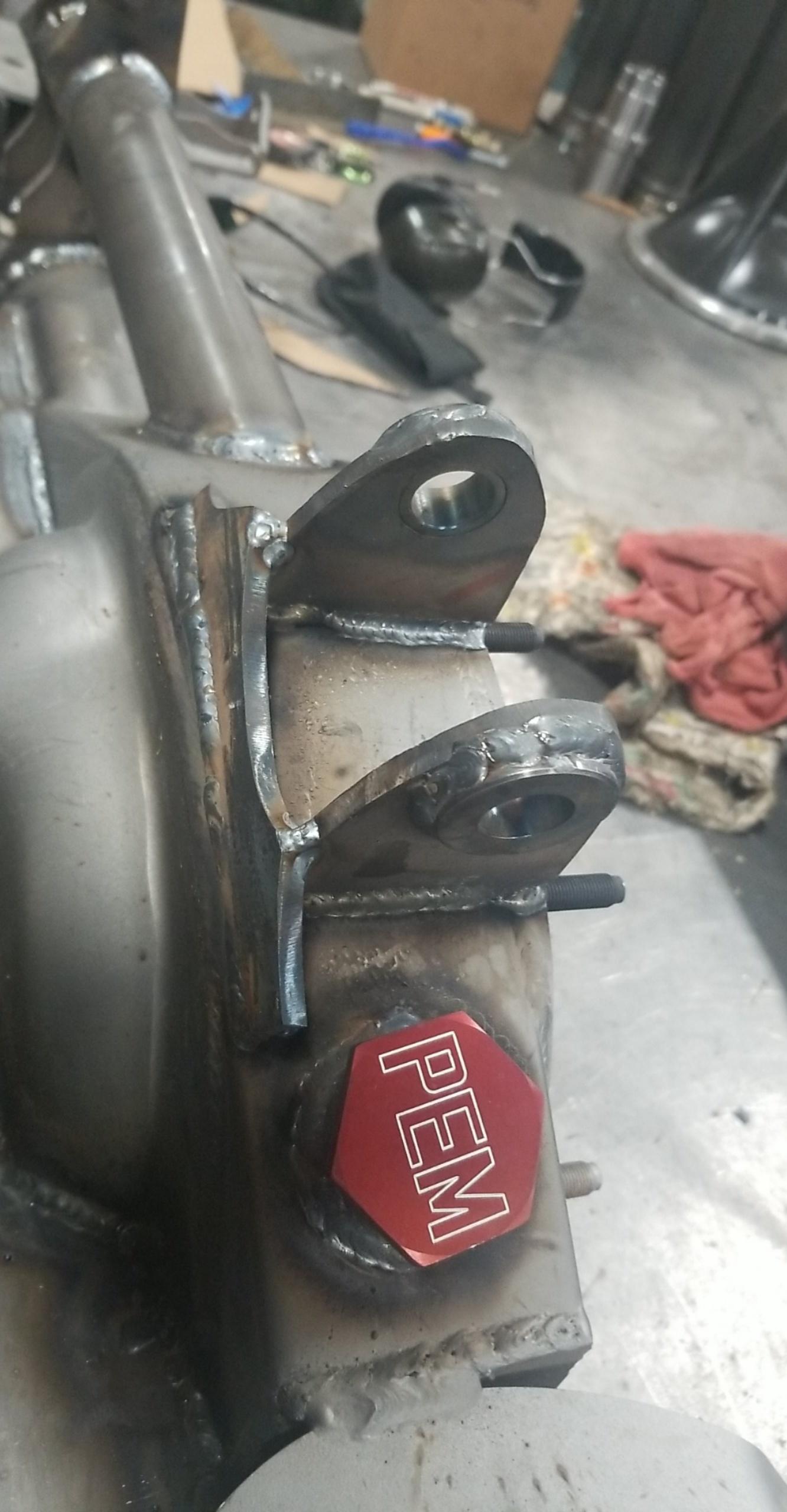

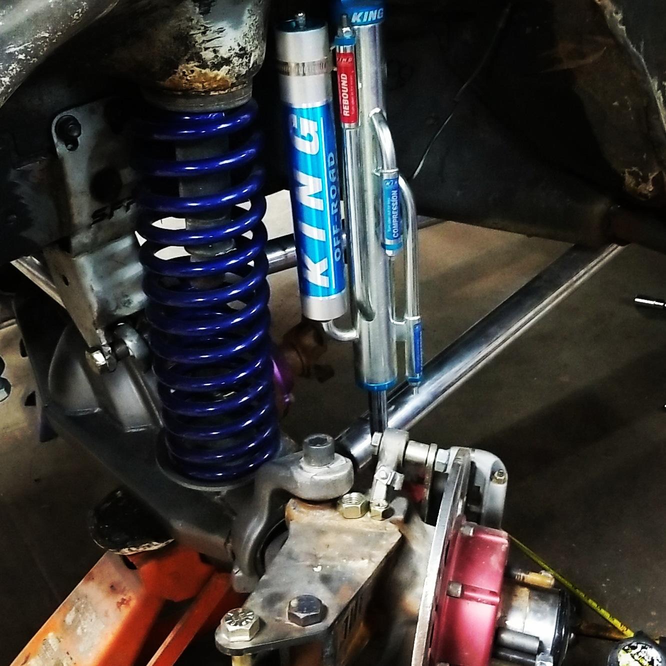

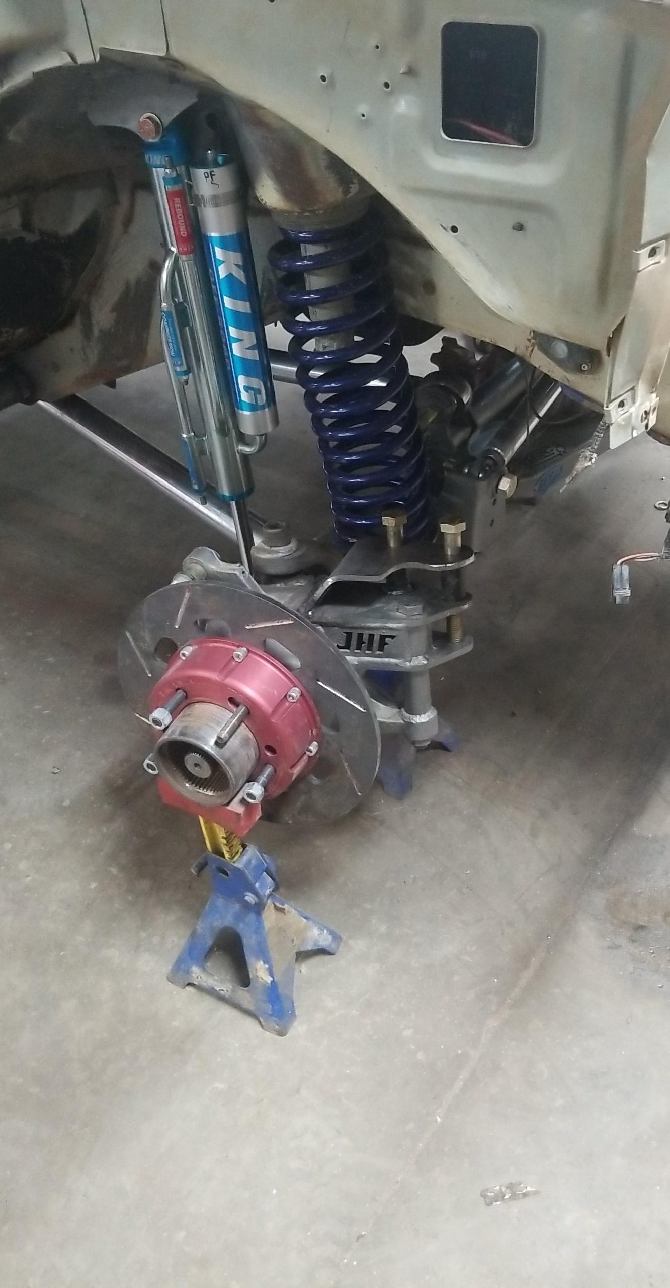

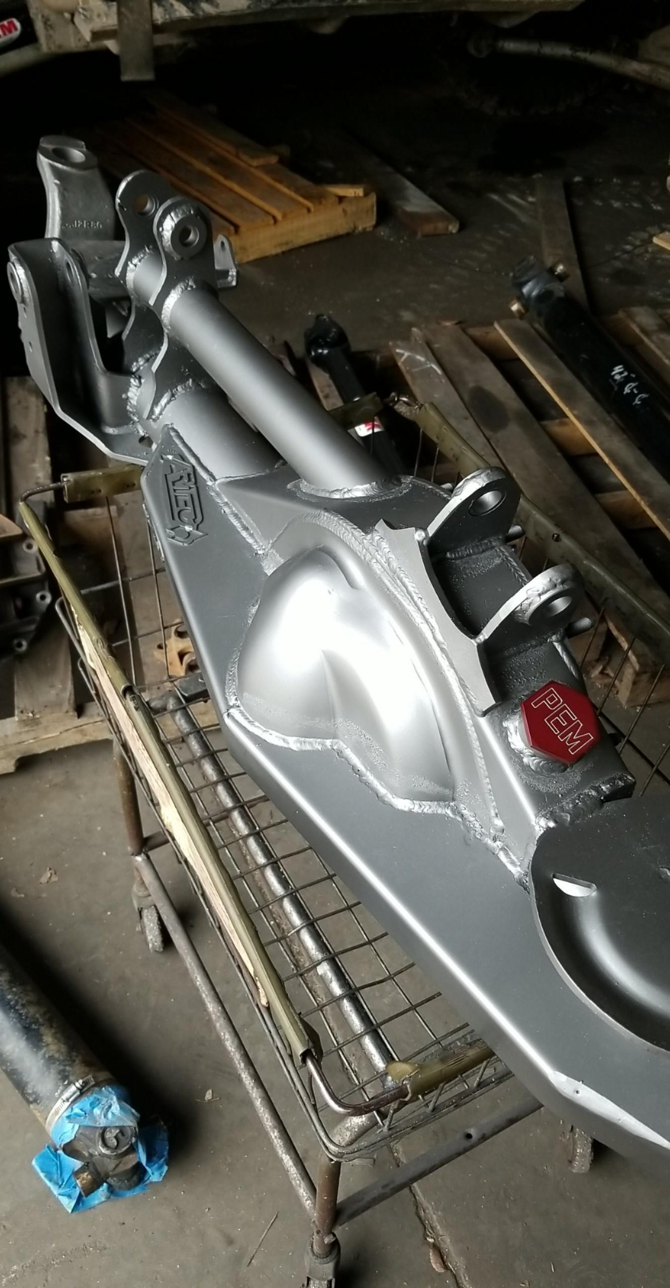

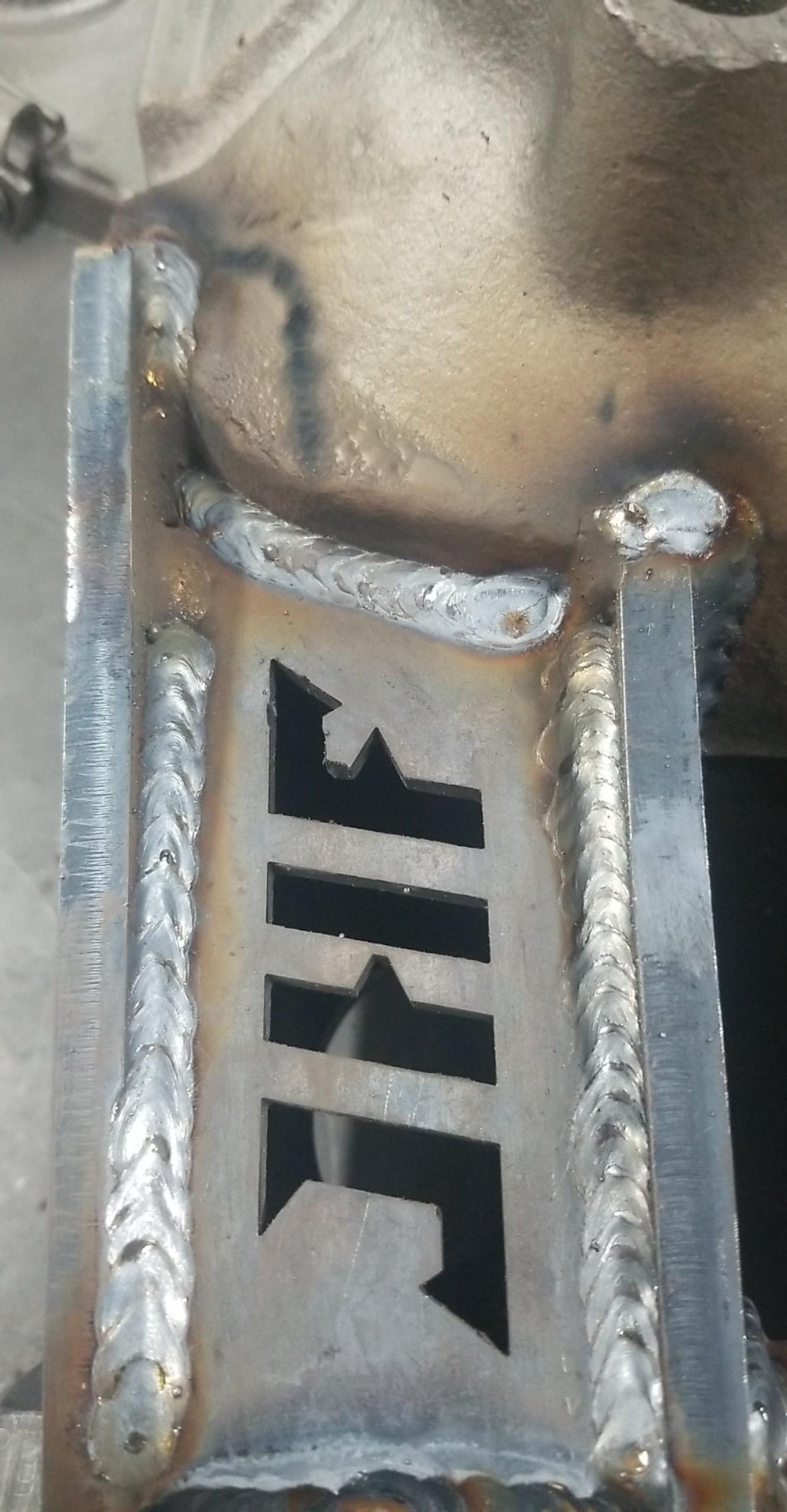

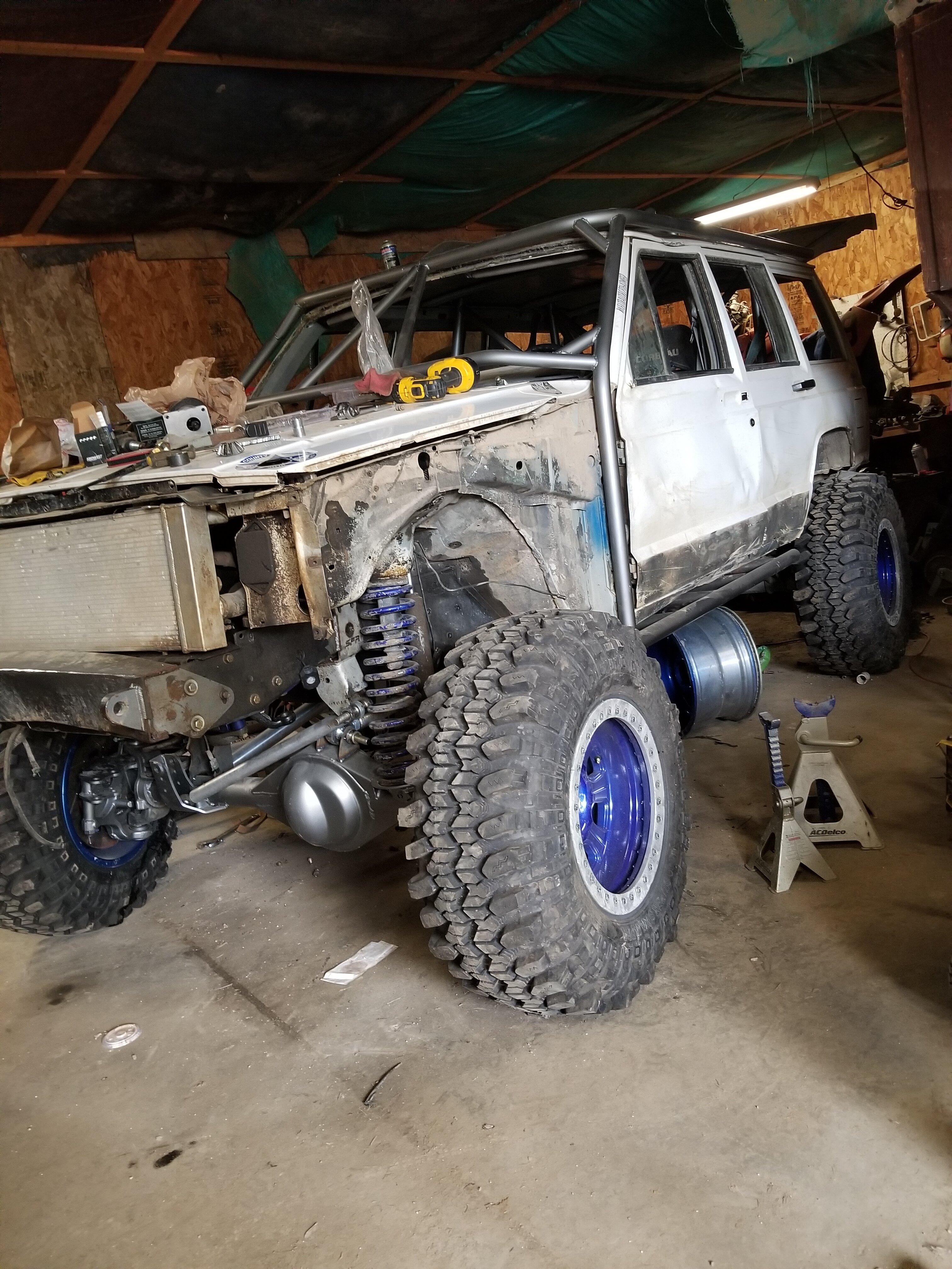

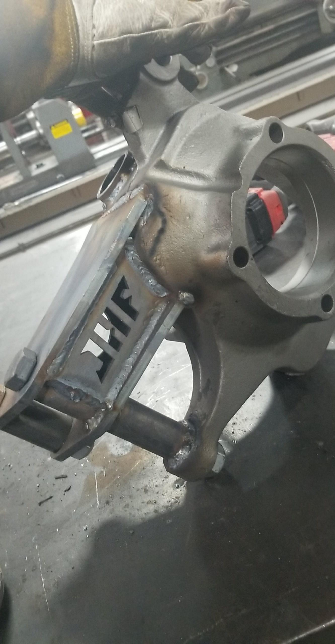

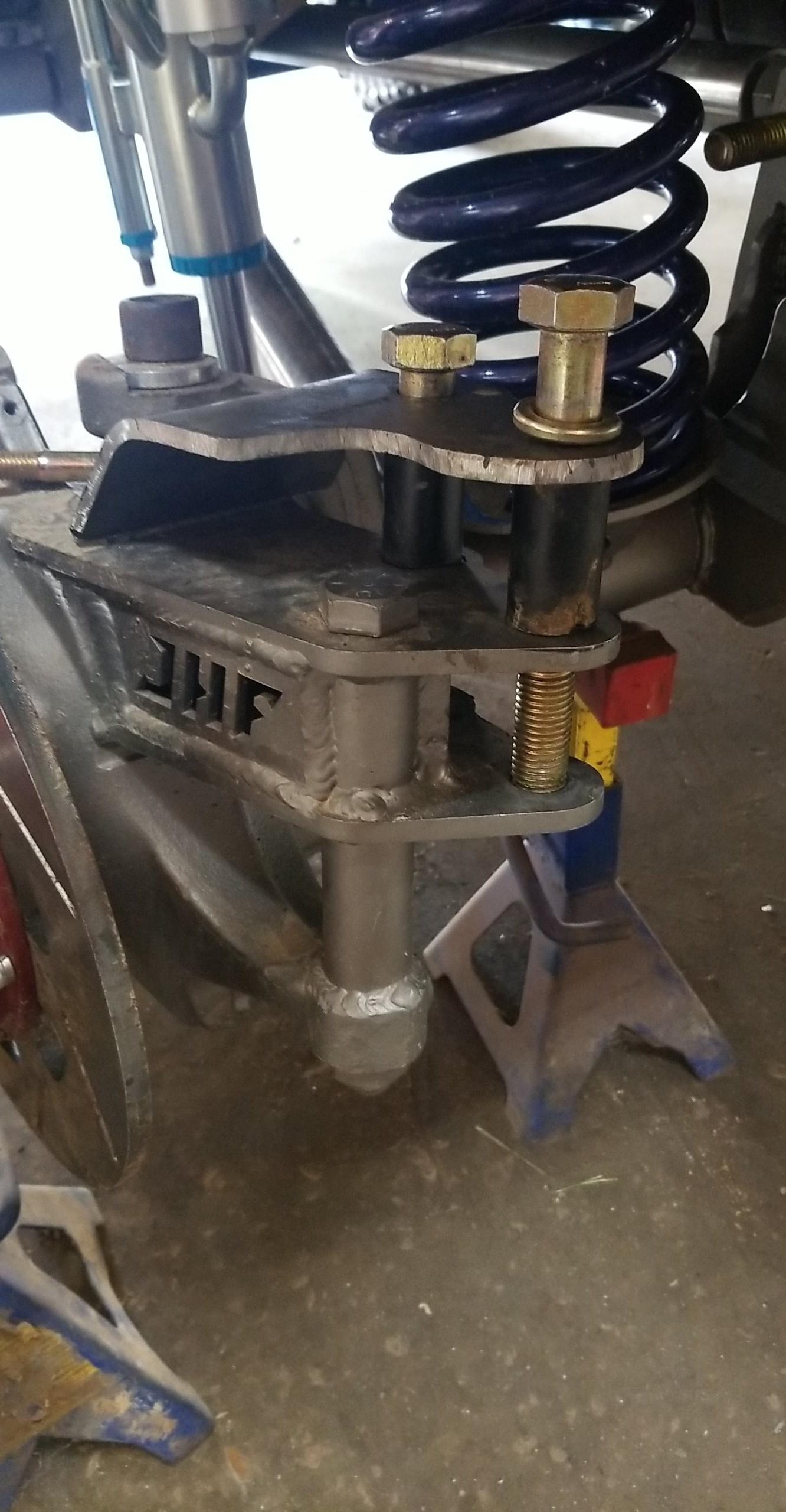

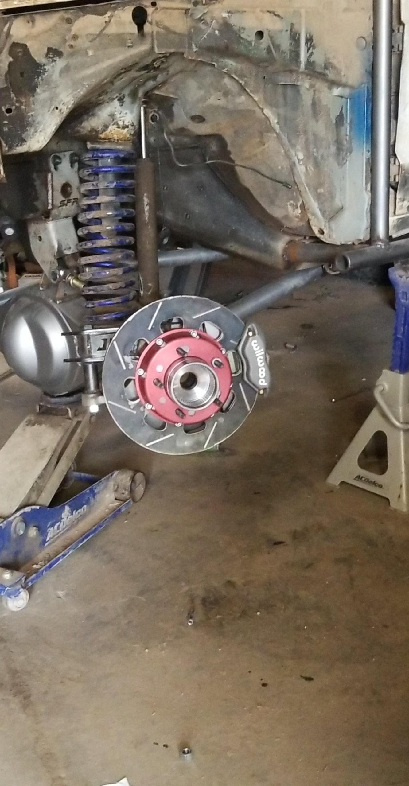

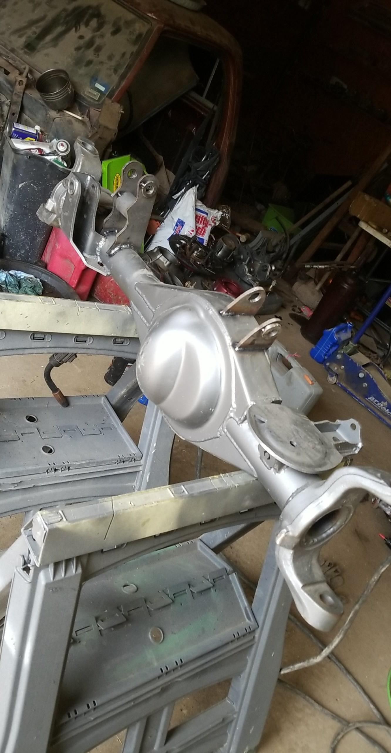

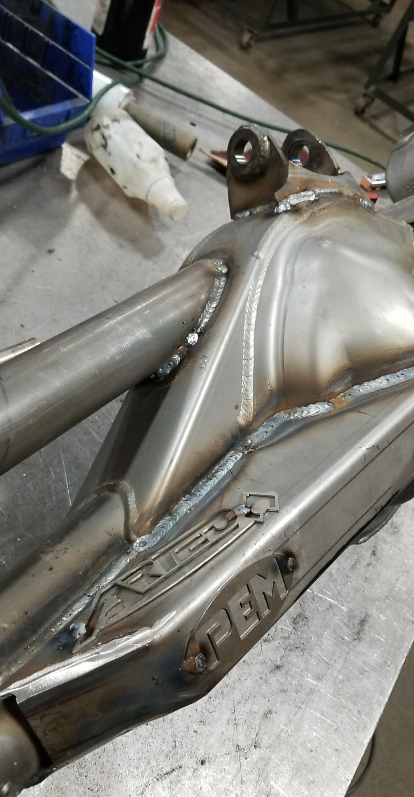

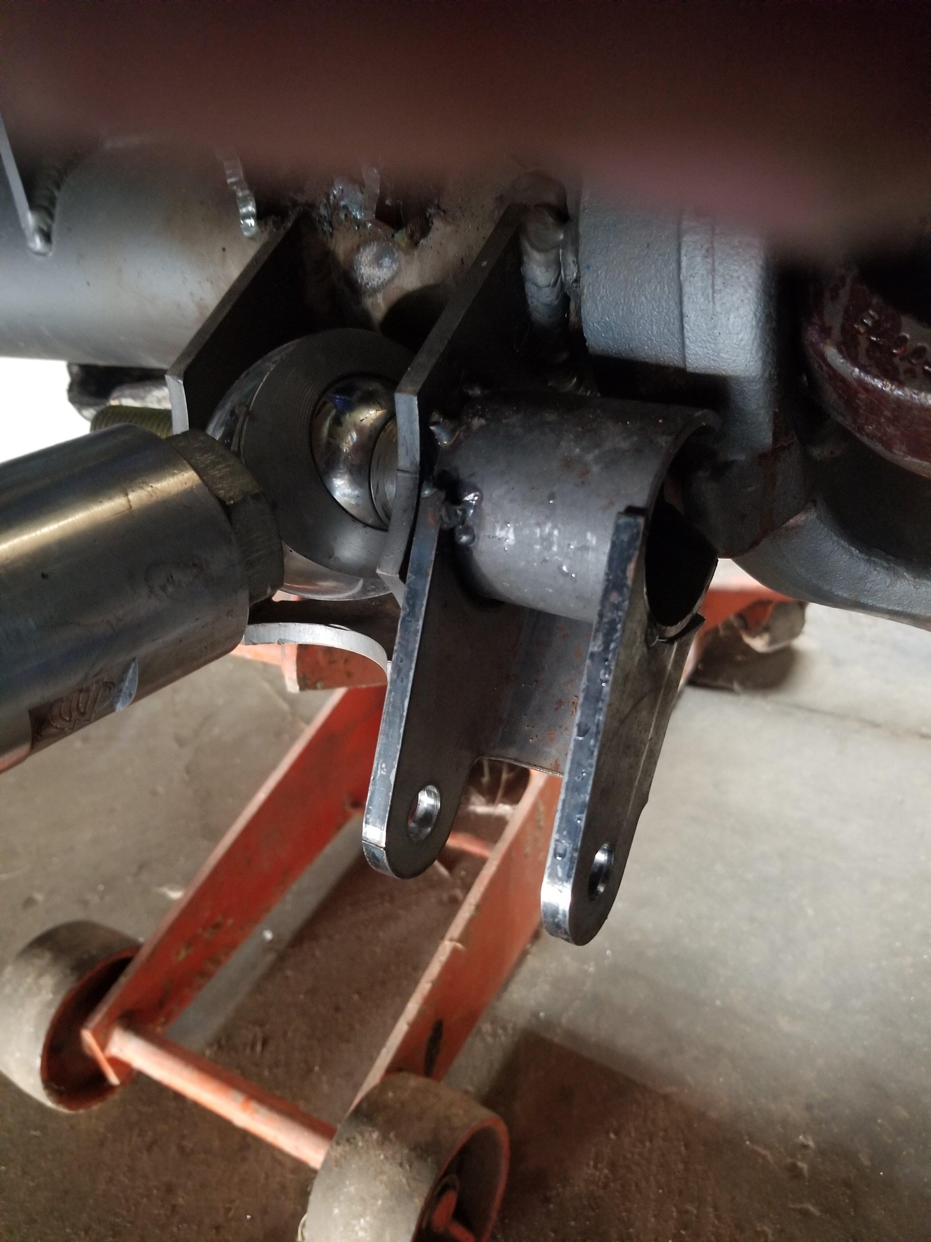

Got a little done this week.Parts still rolling in.Really waiting on the BJ eliminators.REM finished the gear to help with oiling and eliminate break in.Cut the driver side housing down for the coil bucket.Track bar welded and tacked in place and started on the knuckle for the JHF high steer kit.Really starting to look like it belongs in a xj.

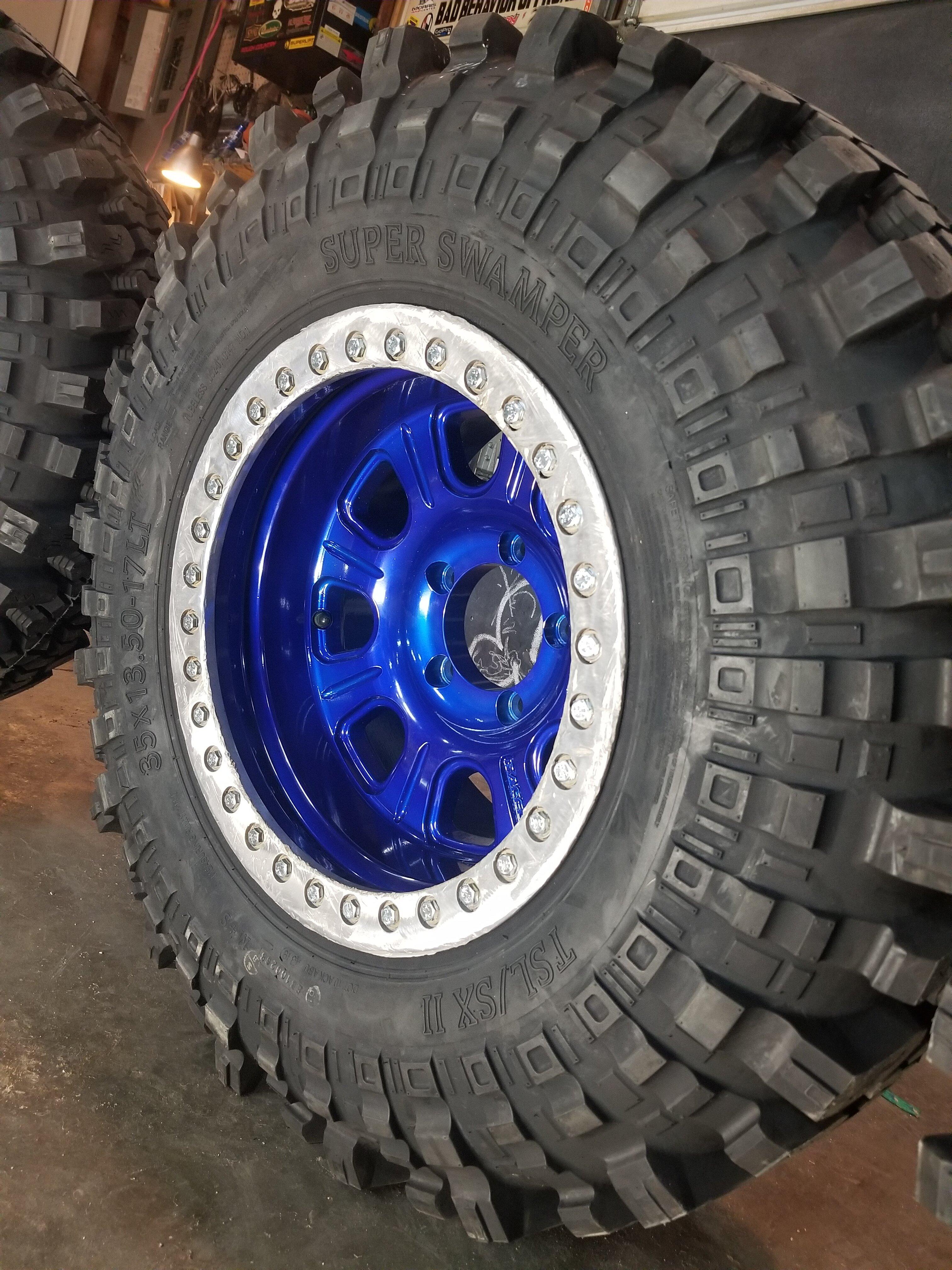

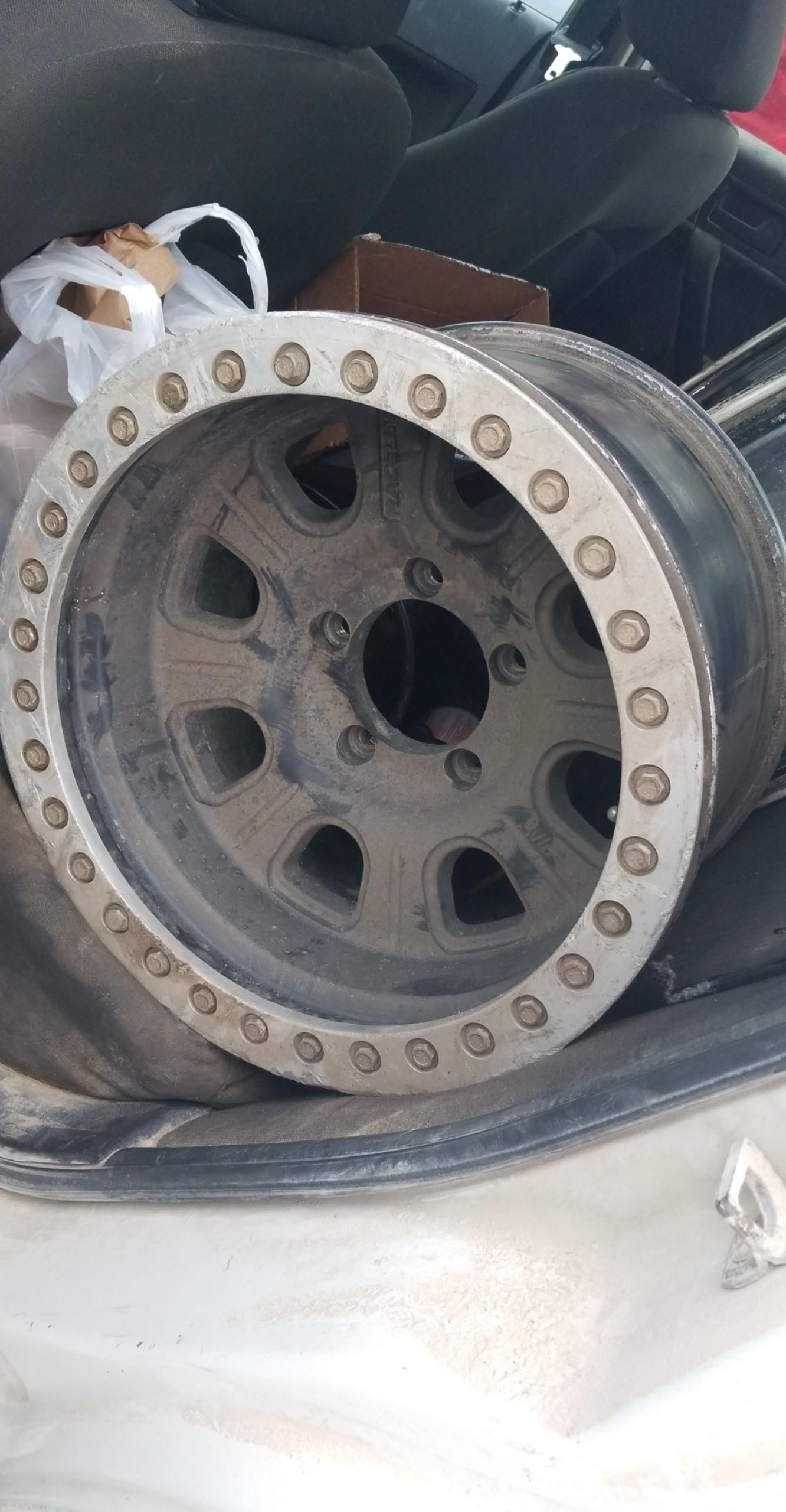

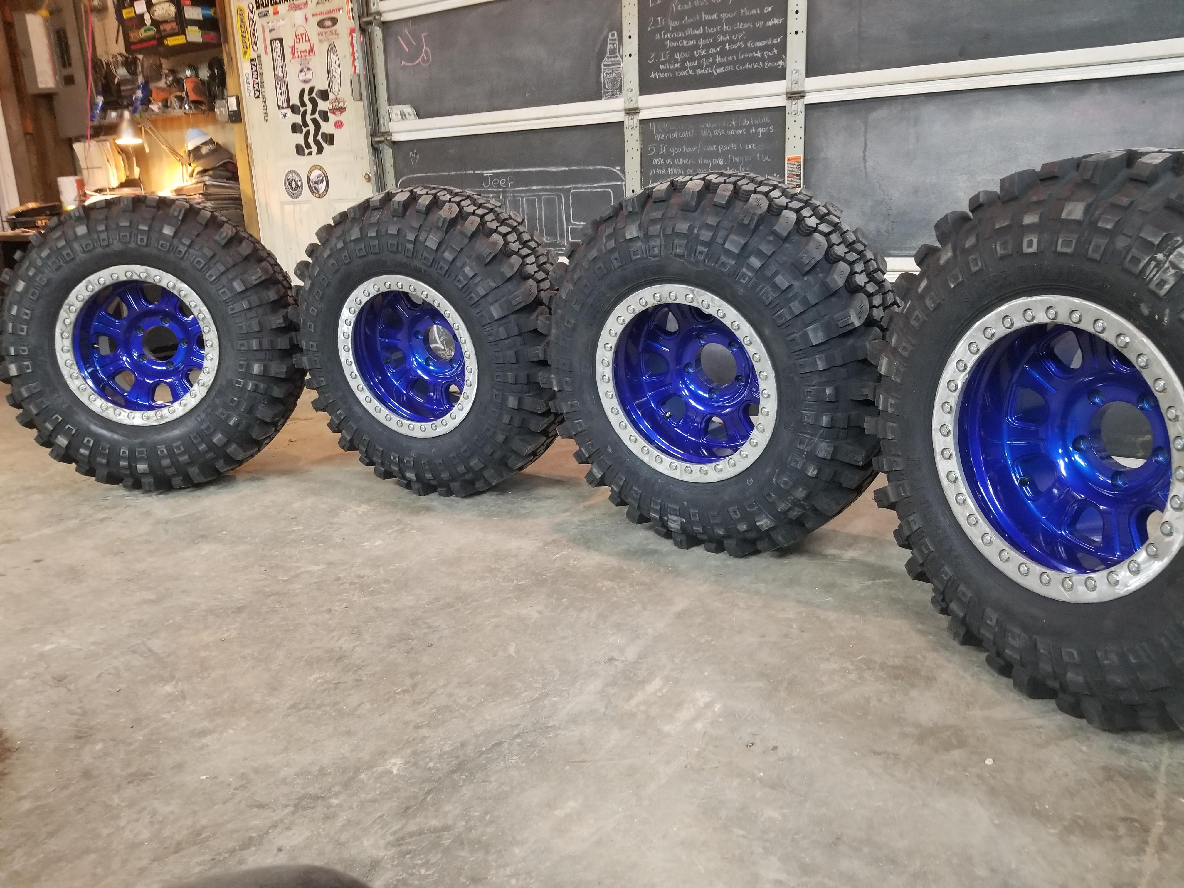

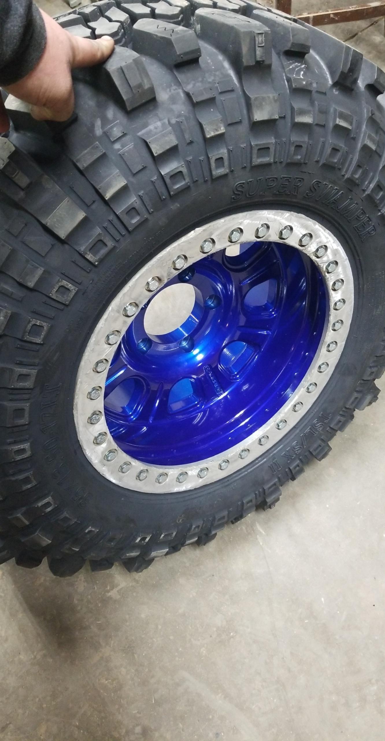

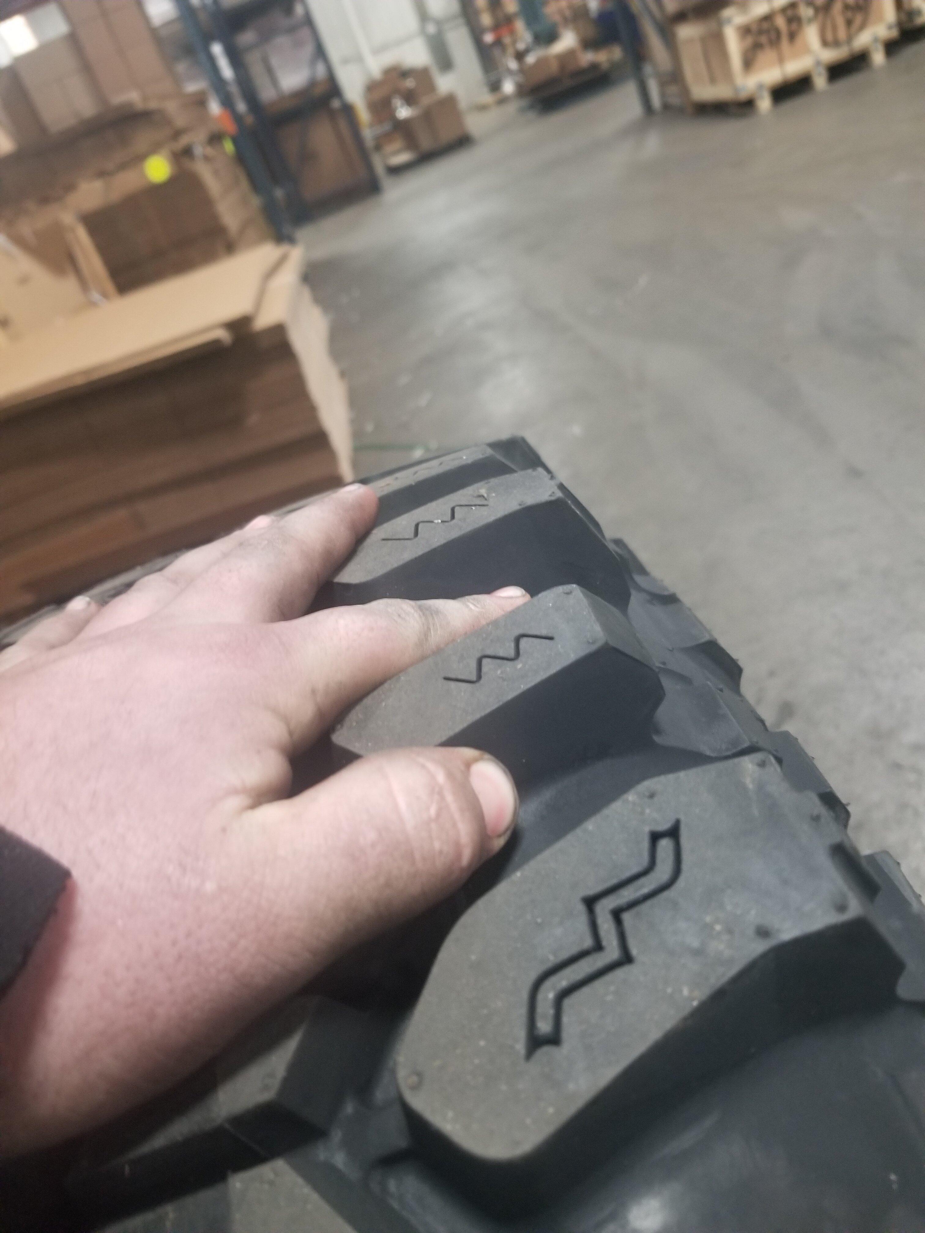

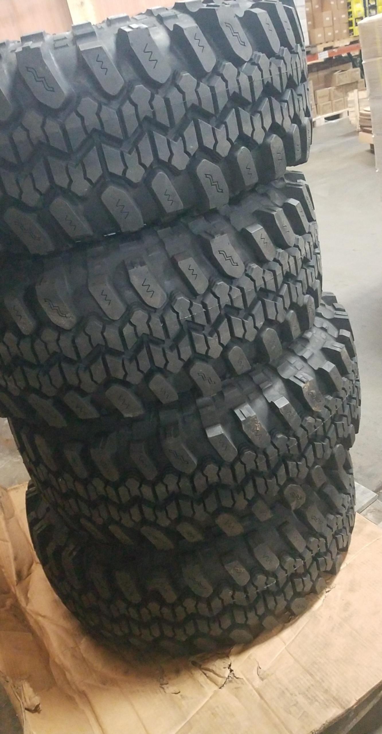

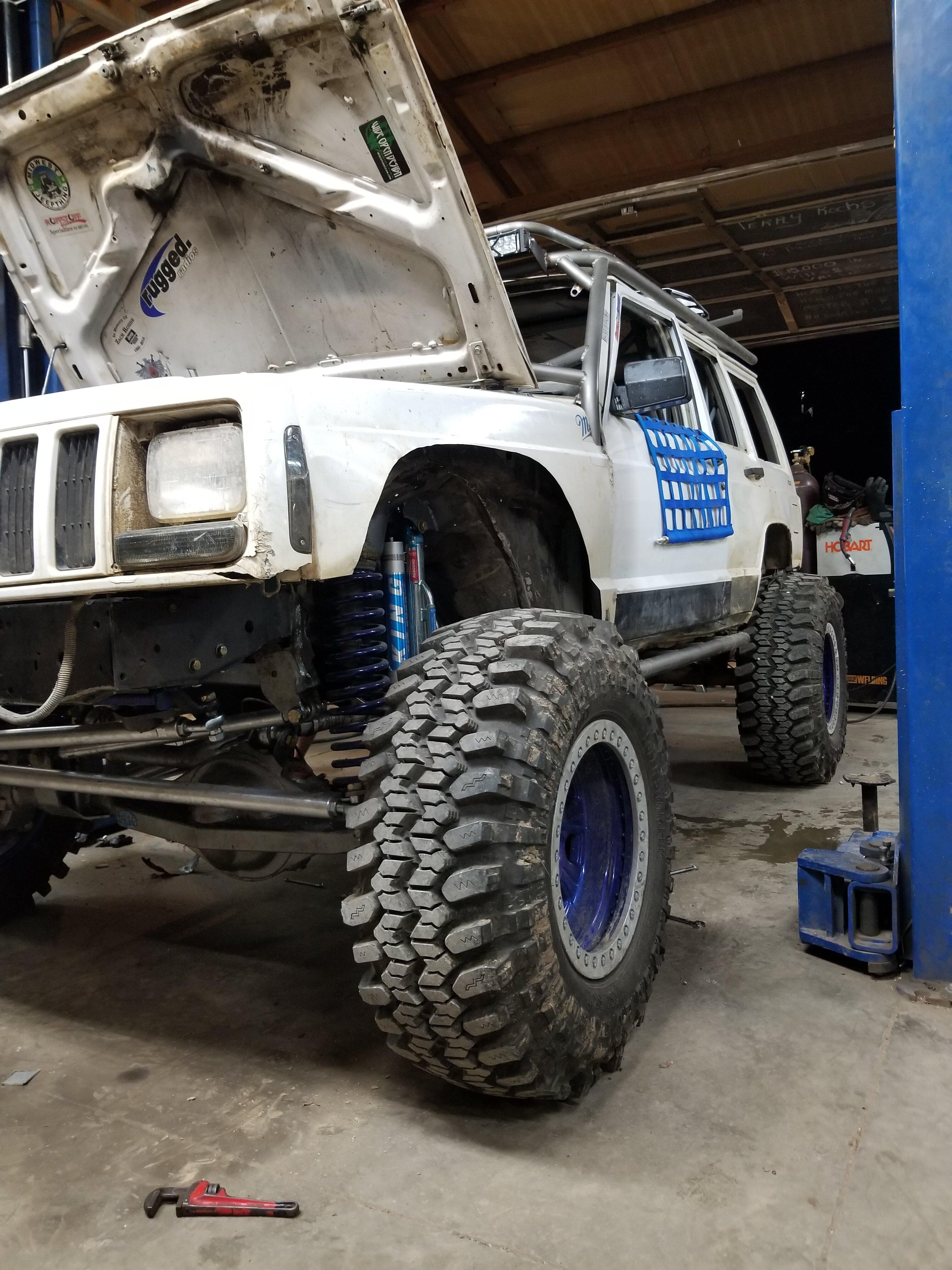

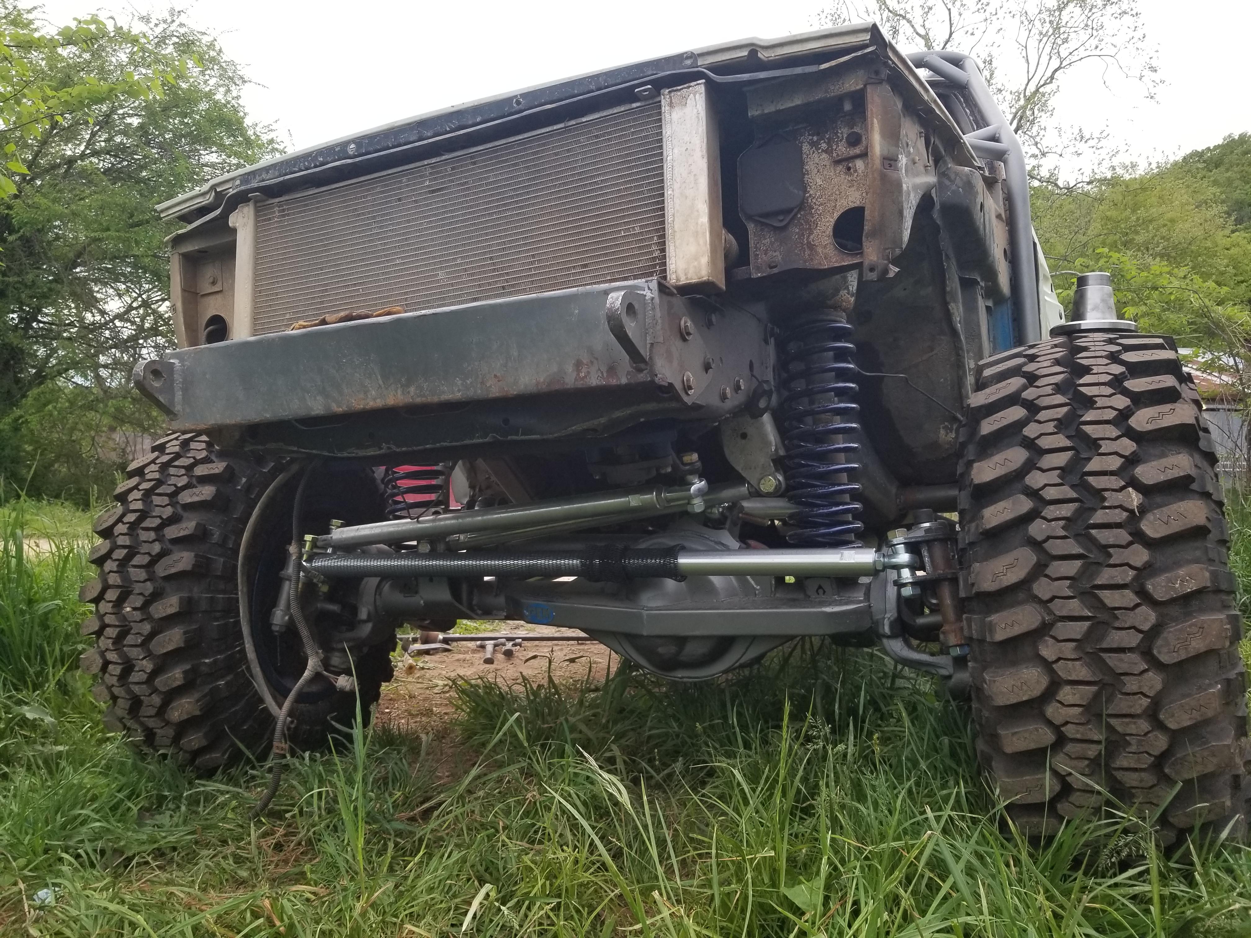

Tires came in today from interco.They released a new SX2 last week in a 35x13.50x17 and 16.And with a tip from them from a fb message asking for a part number was able to score 4 off the blem list $80 ea cheaper then retail. Being 35s I meet the pro rock tire limit and it dosen't get much better sidewall strength then an SX. They weight in at 86lbs each

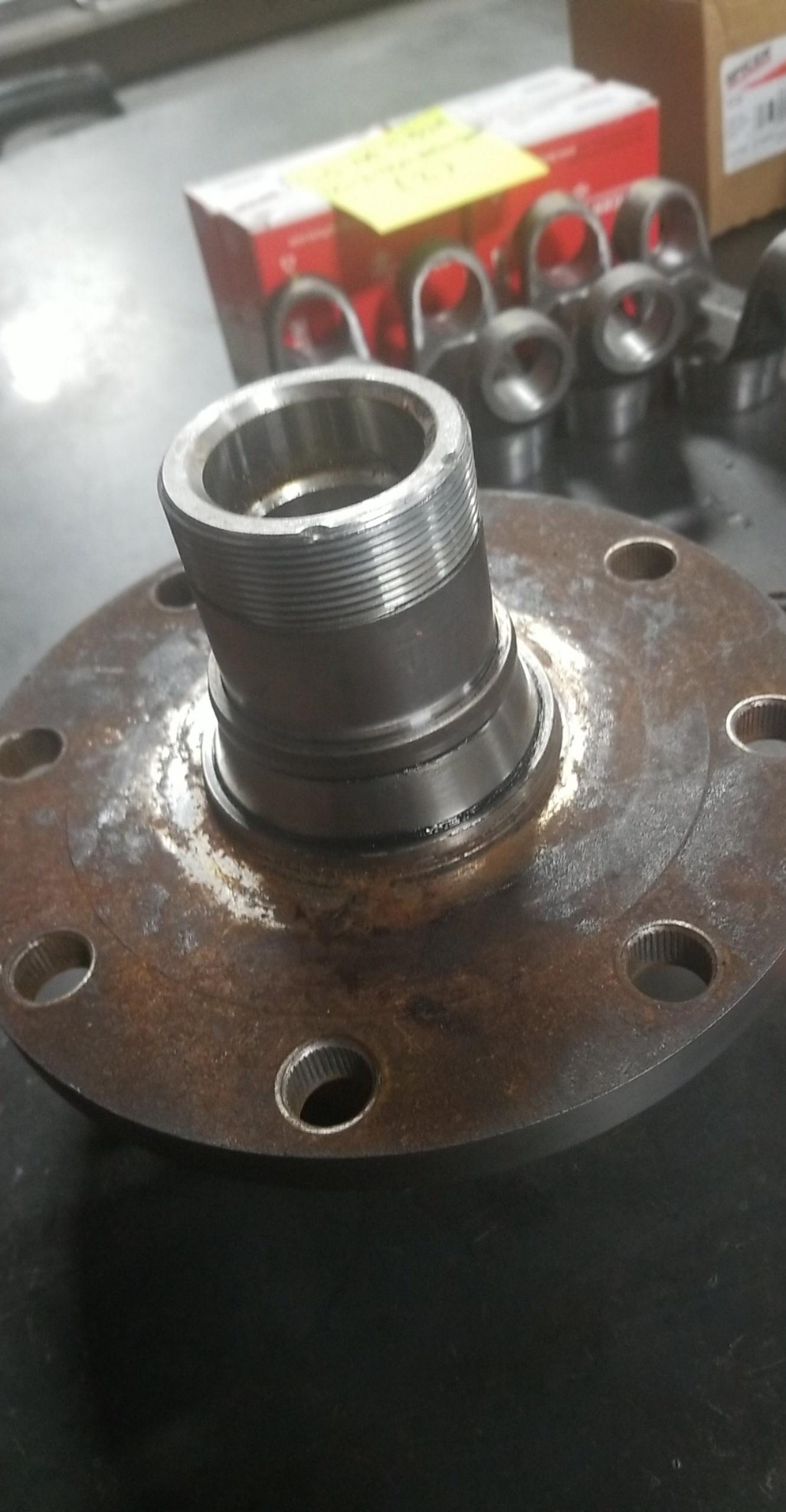

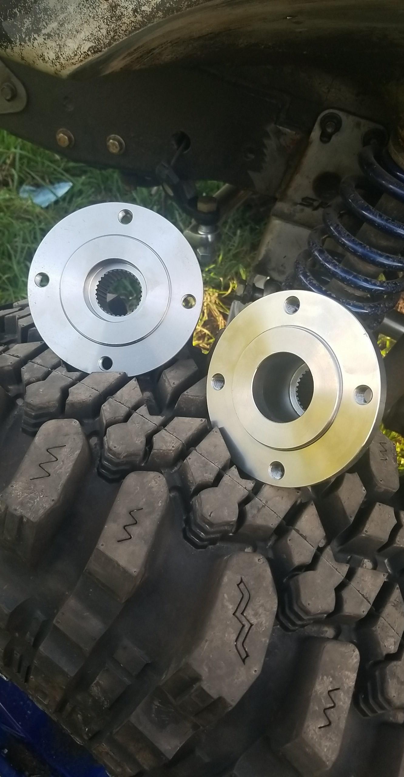

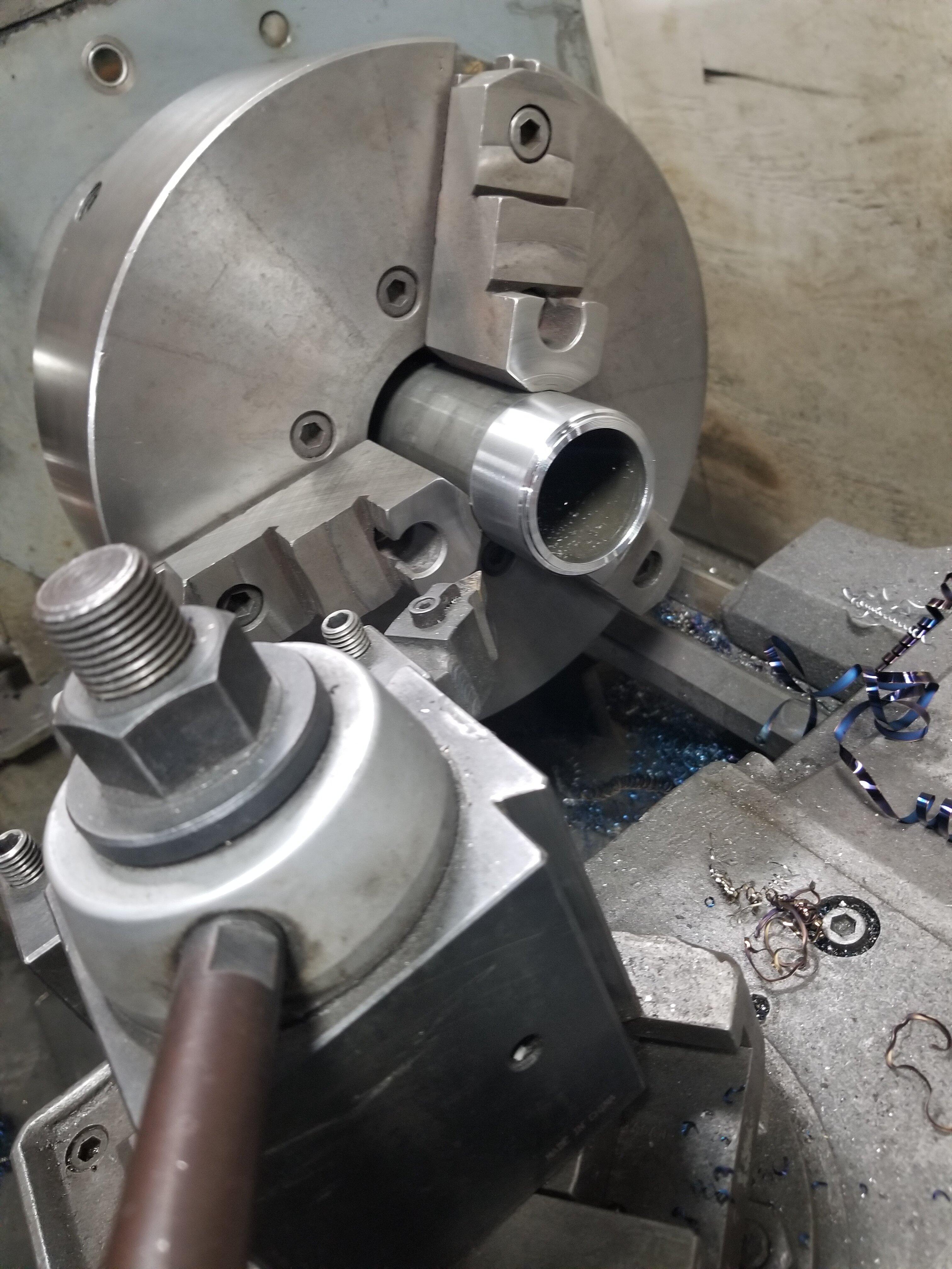

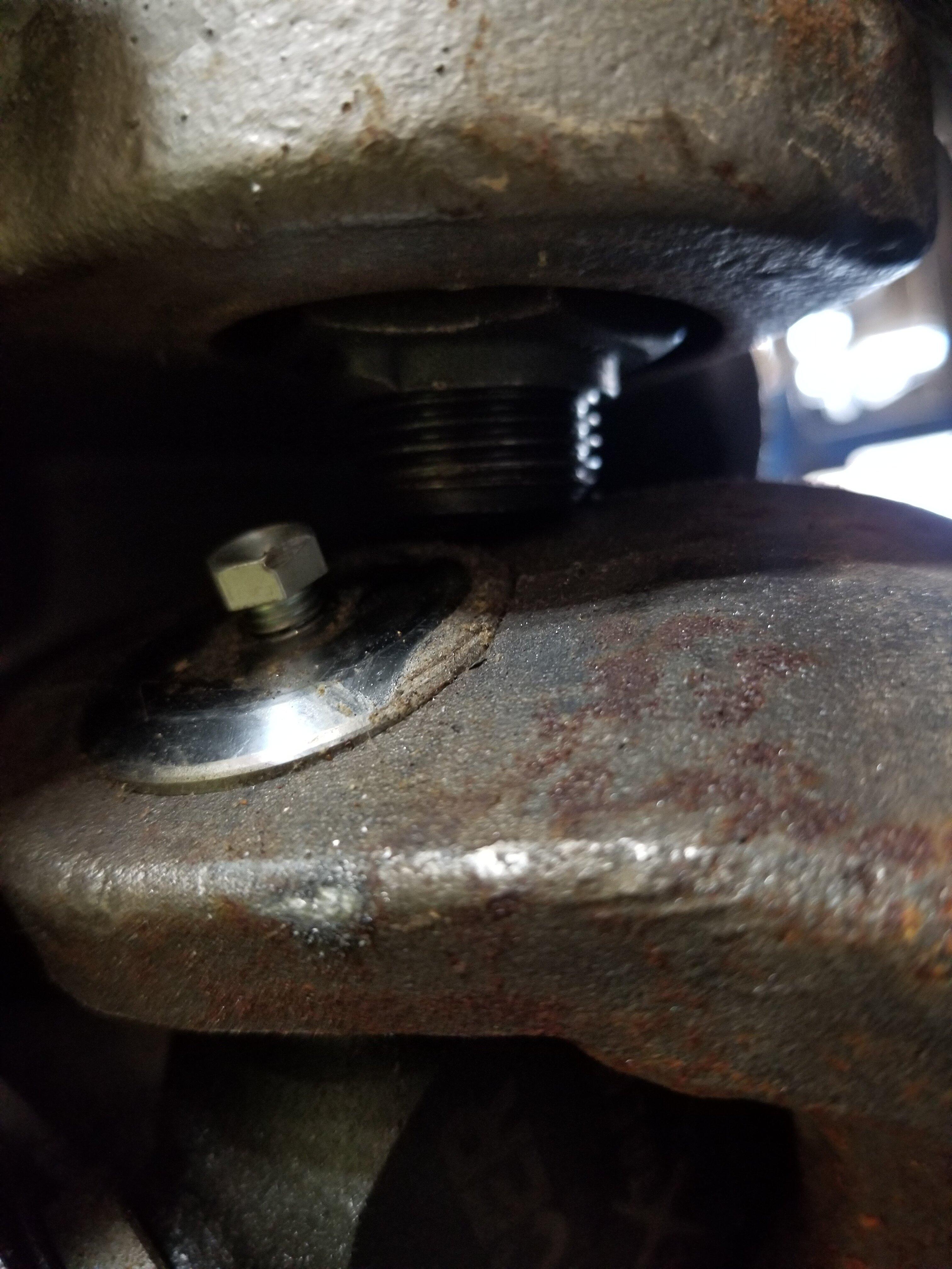

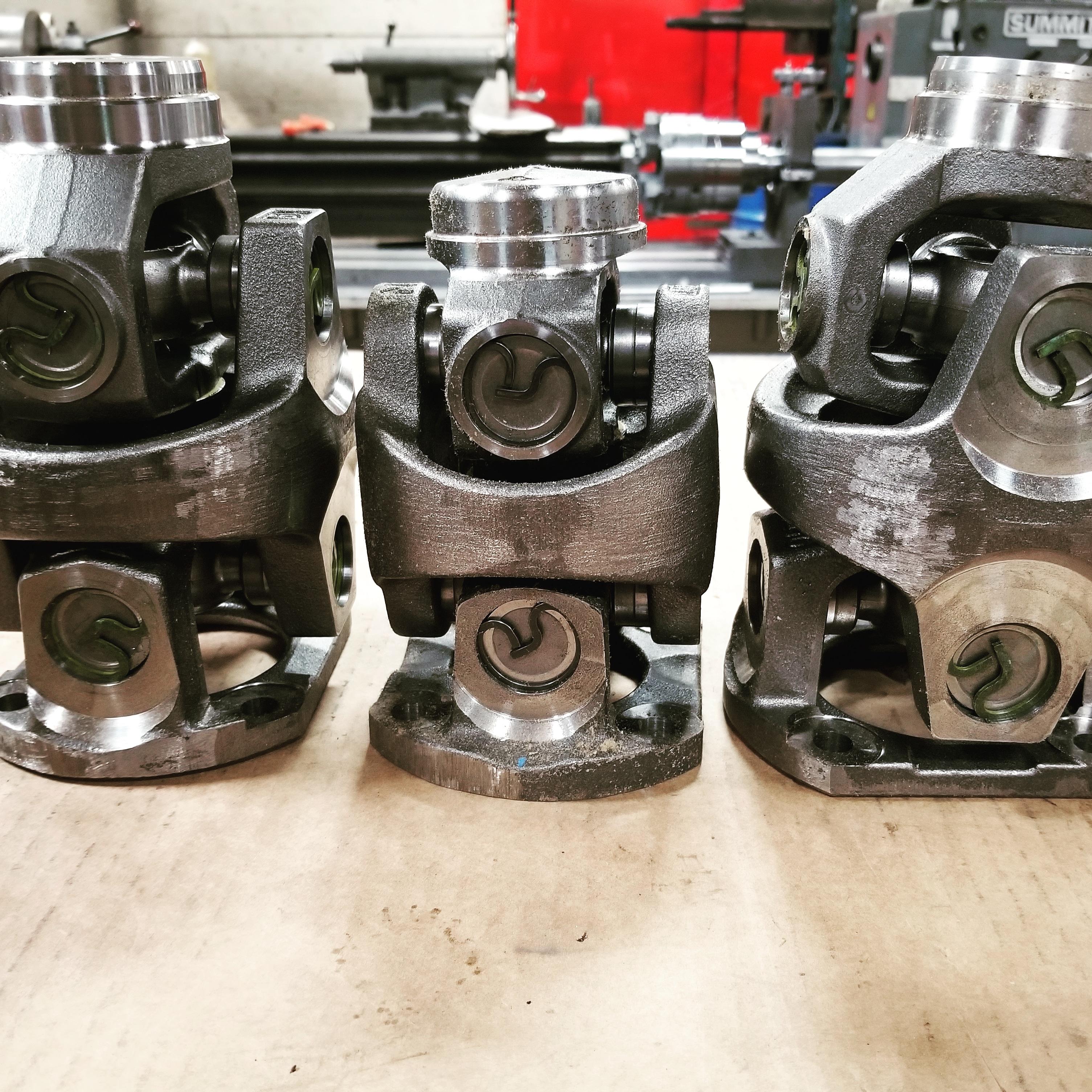

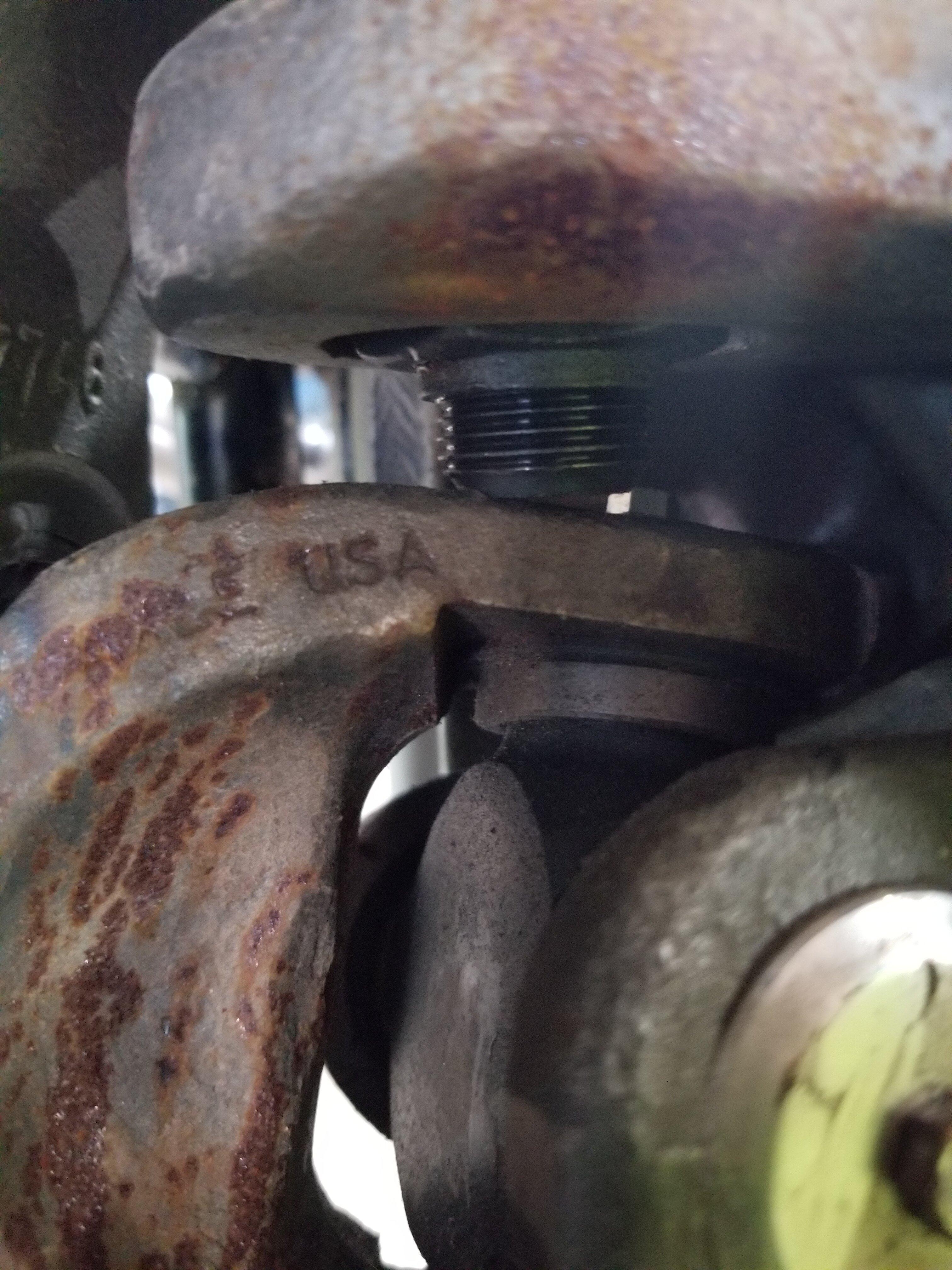

Well I tried to pull my UBs apart to machine and broke the inner race on one.Guess I'll try again on a new tinkem.
.Wish I could find a part number for the inner bearing.

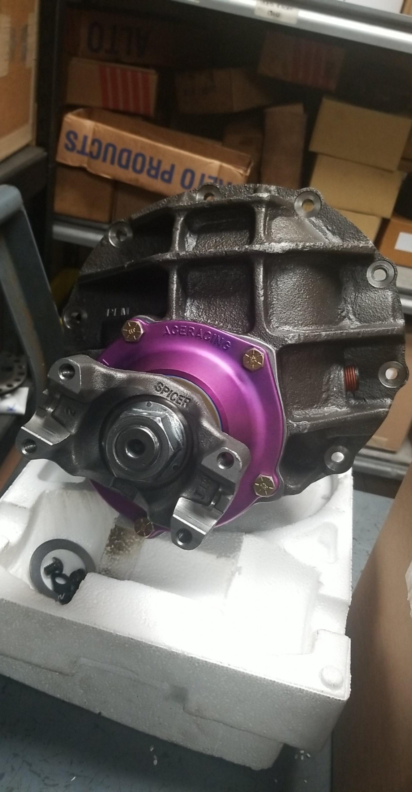

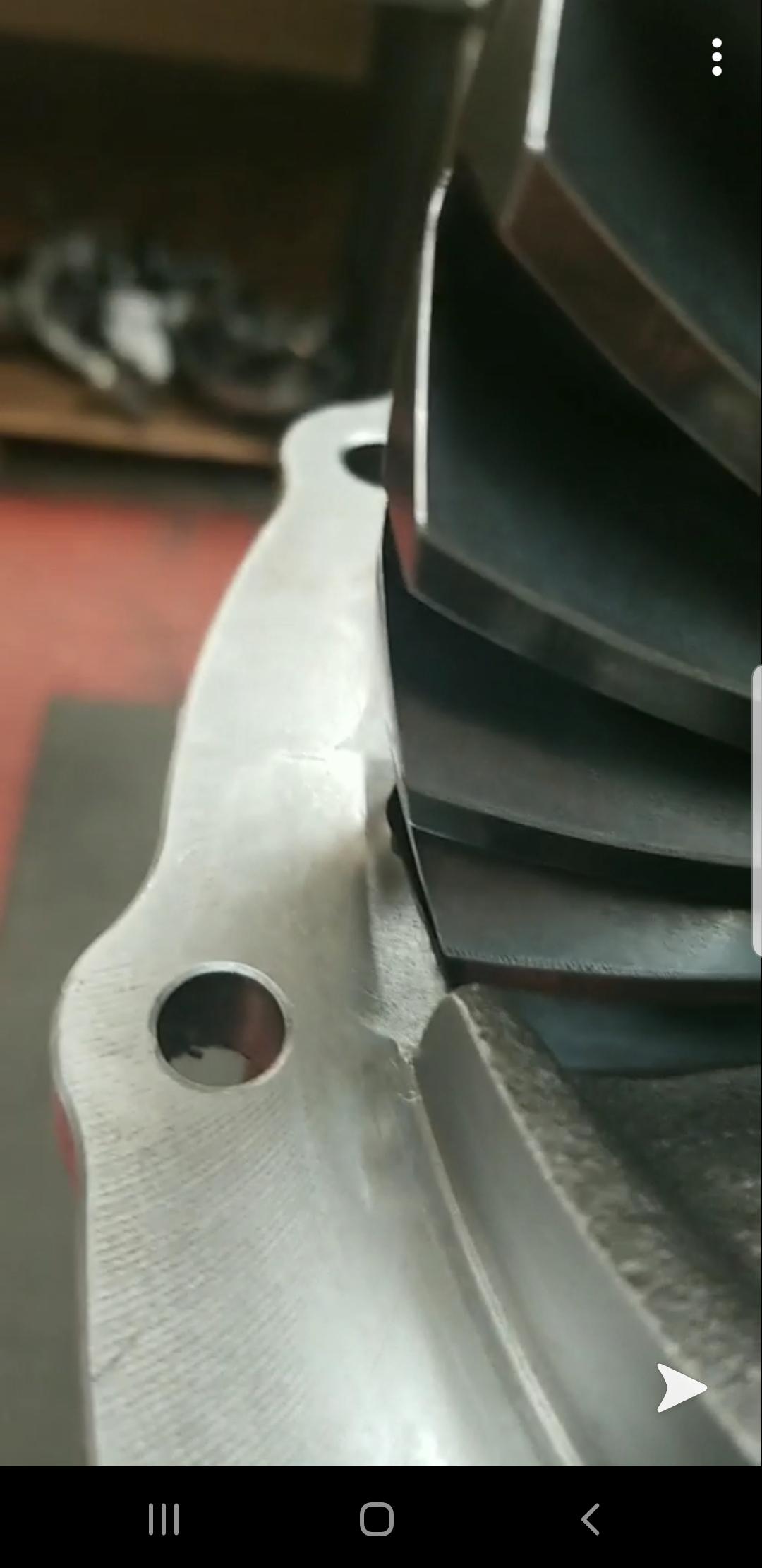

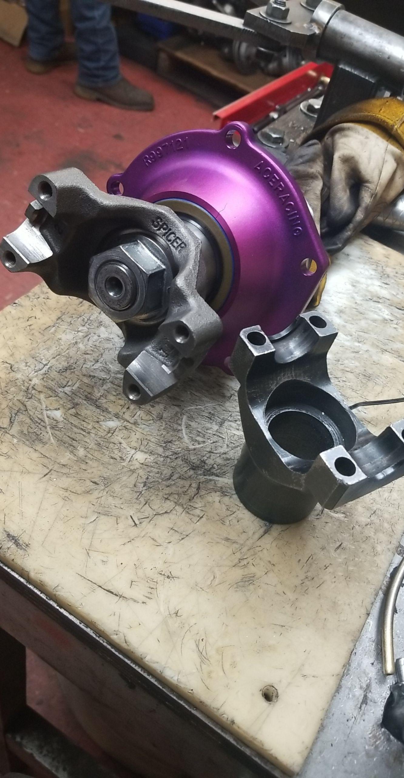

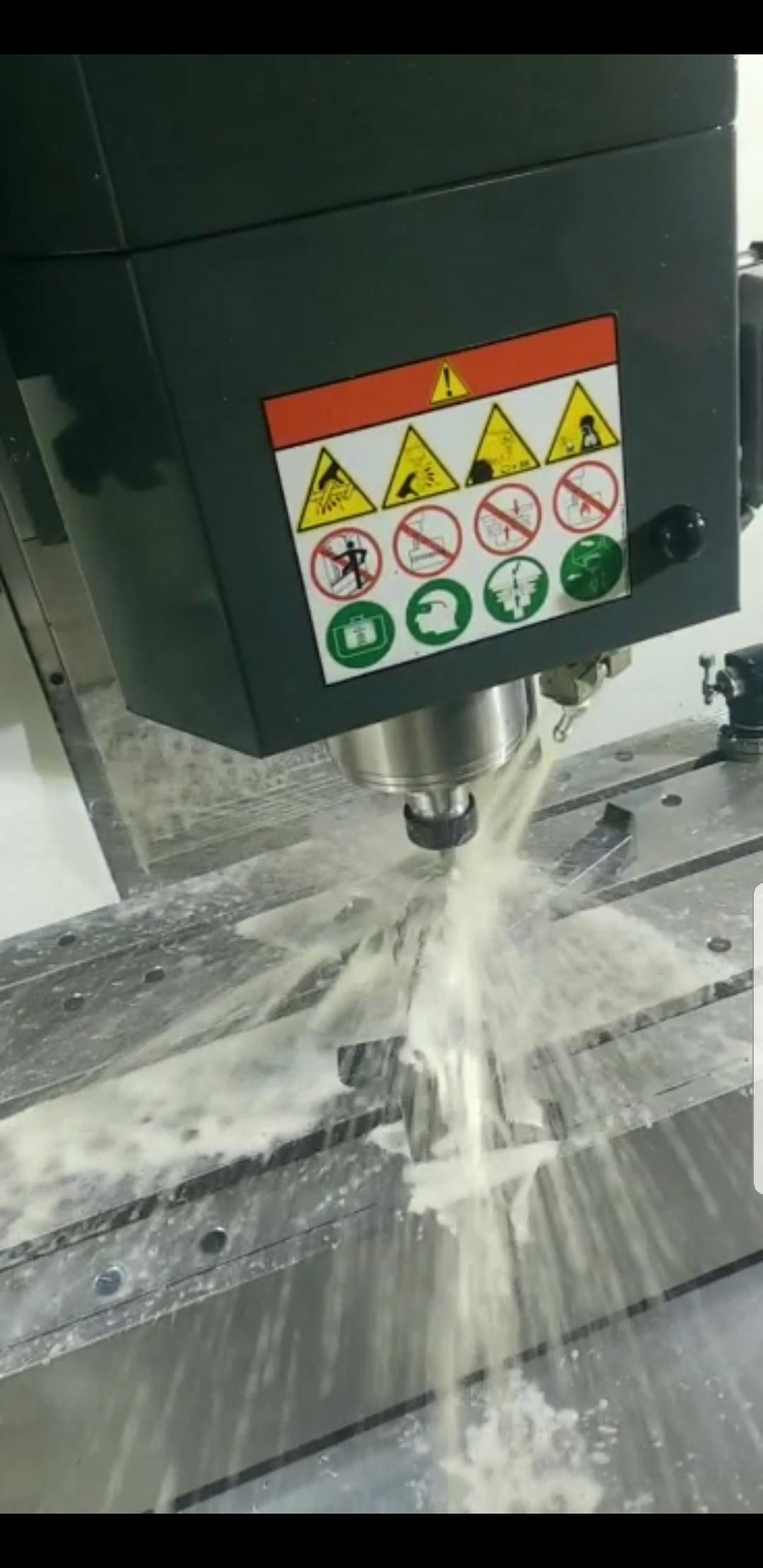

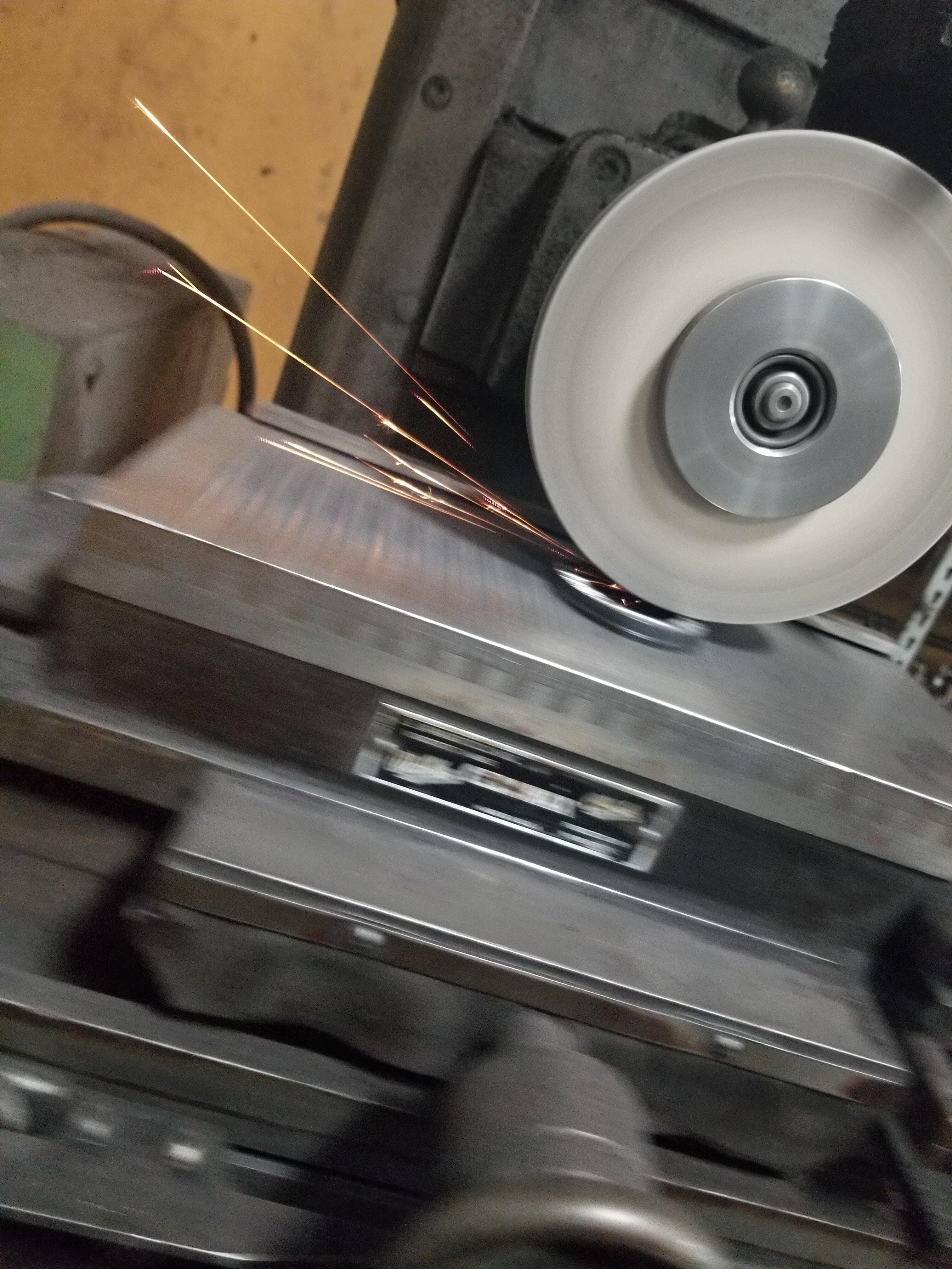

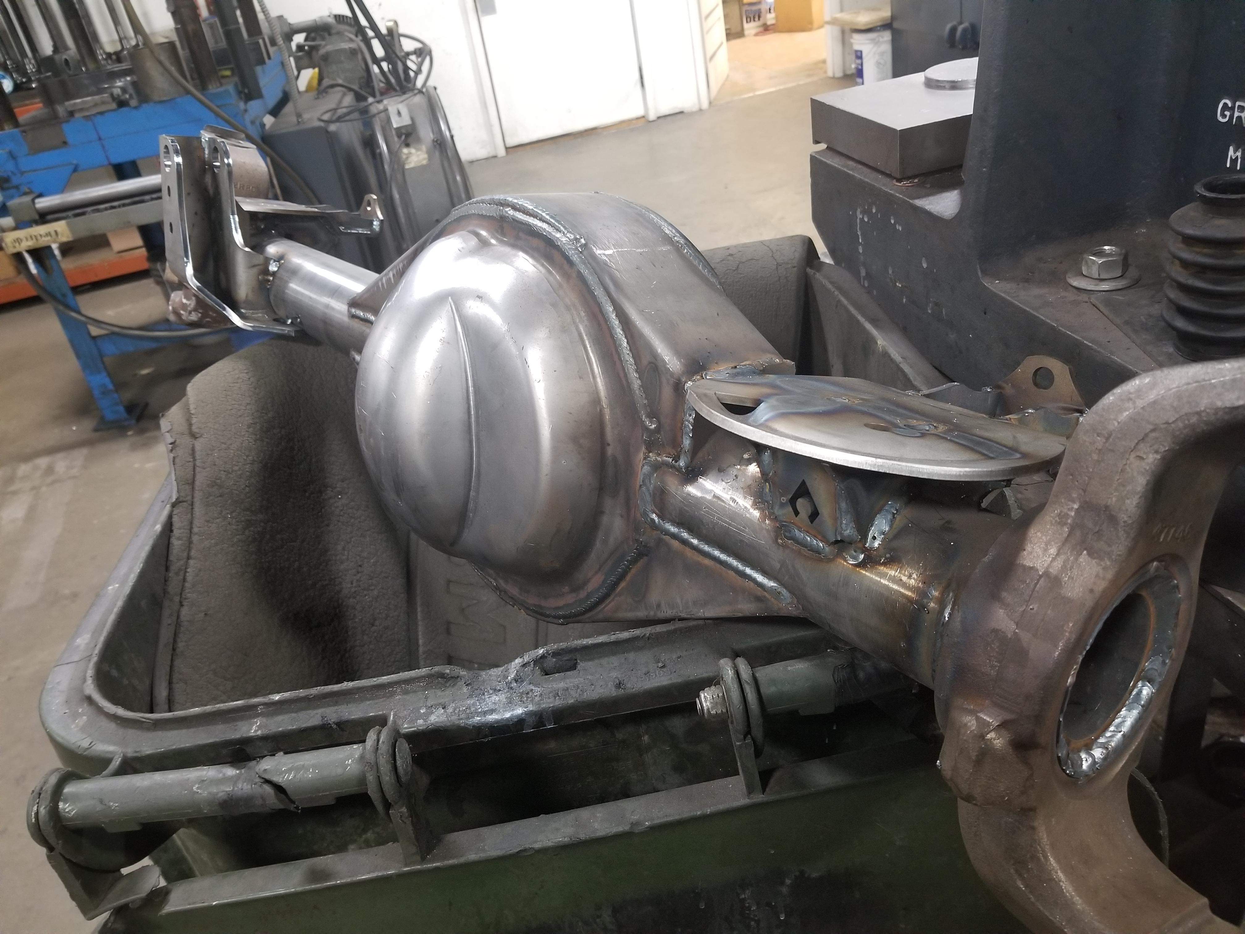

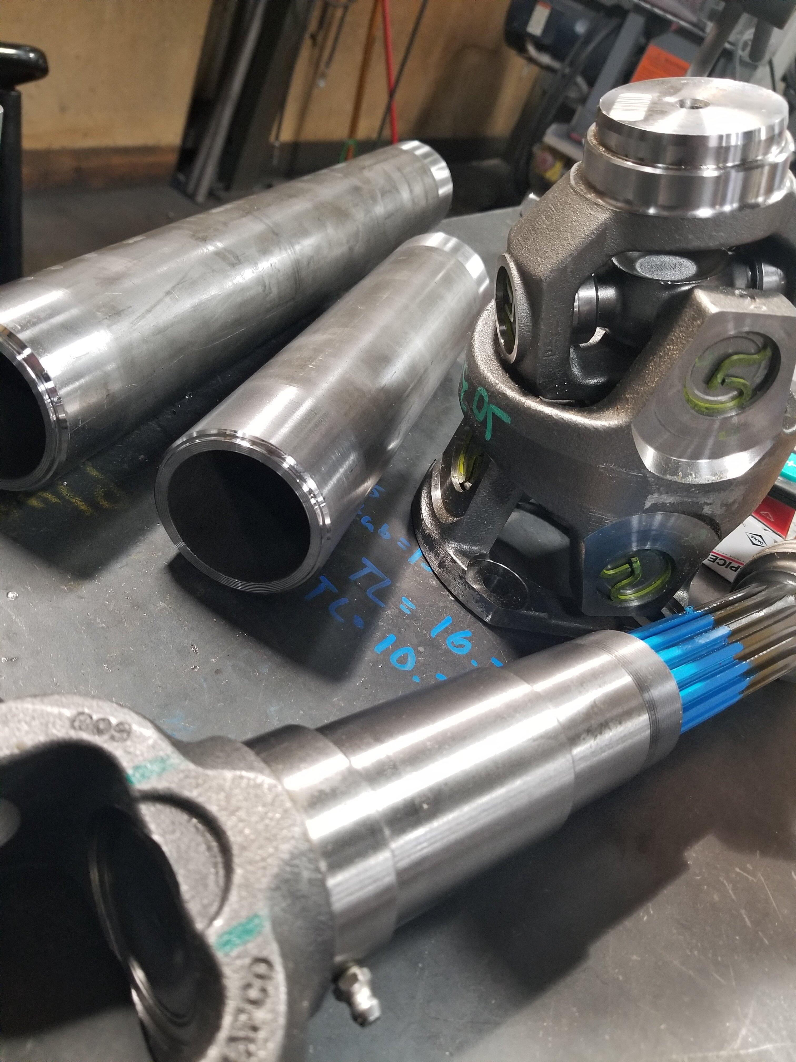

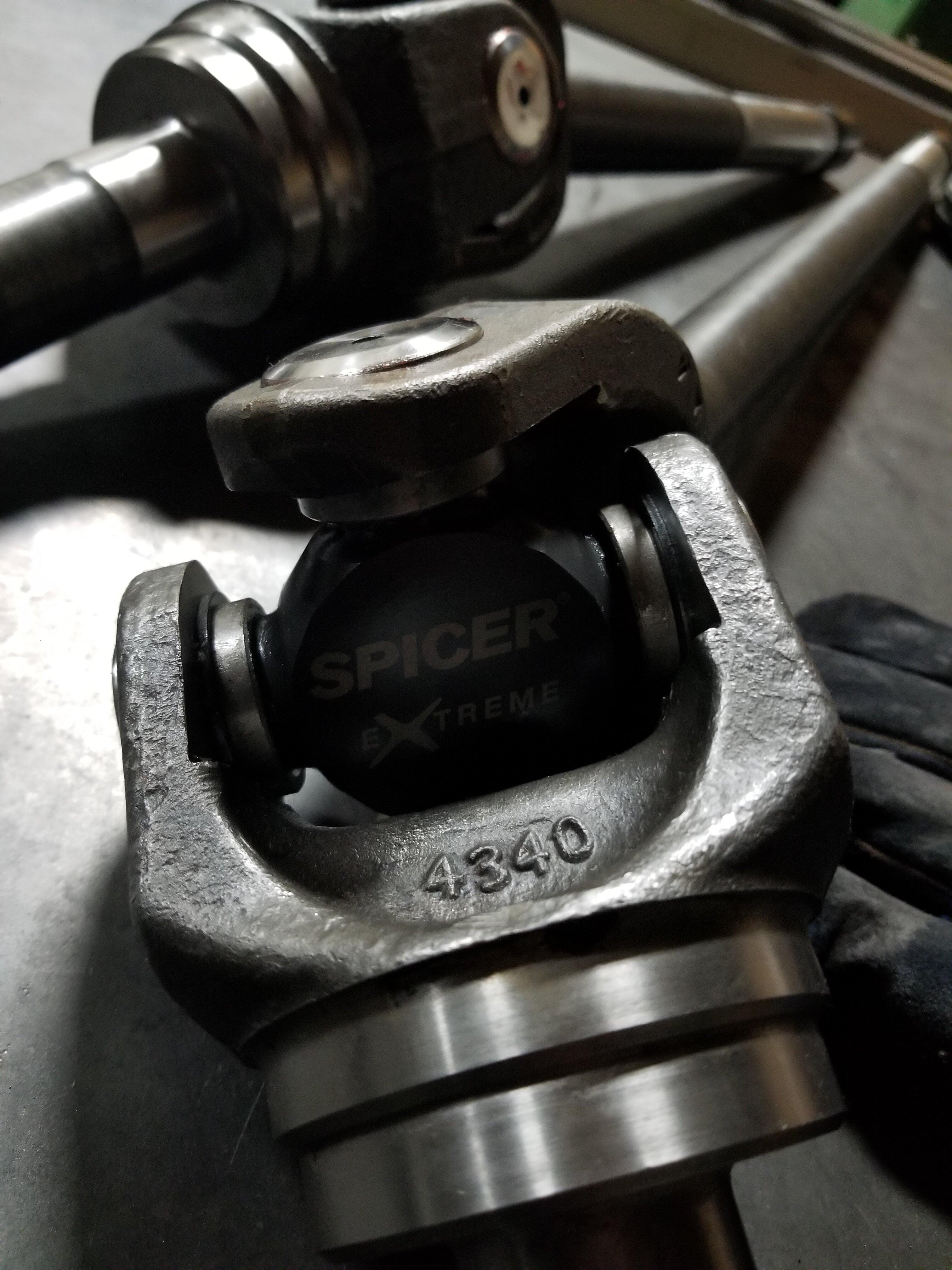

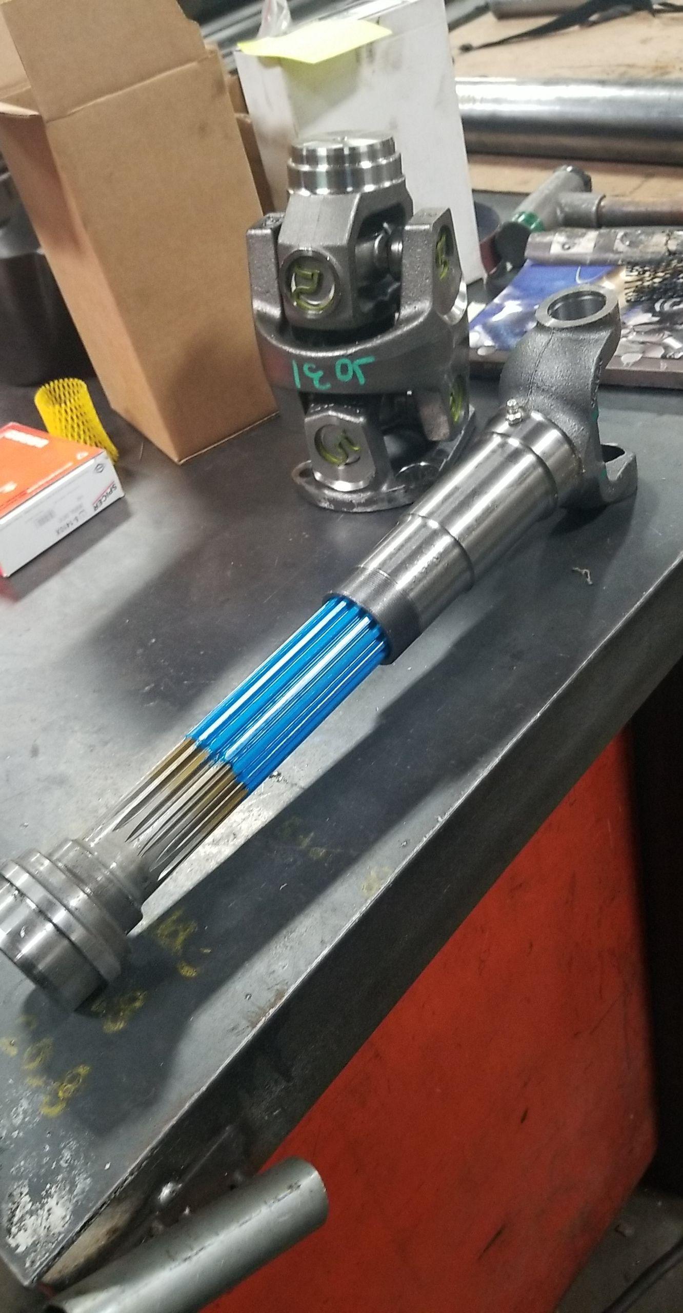

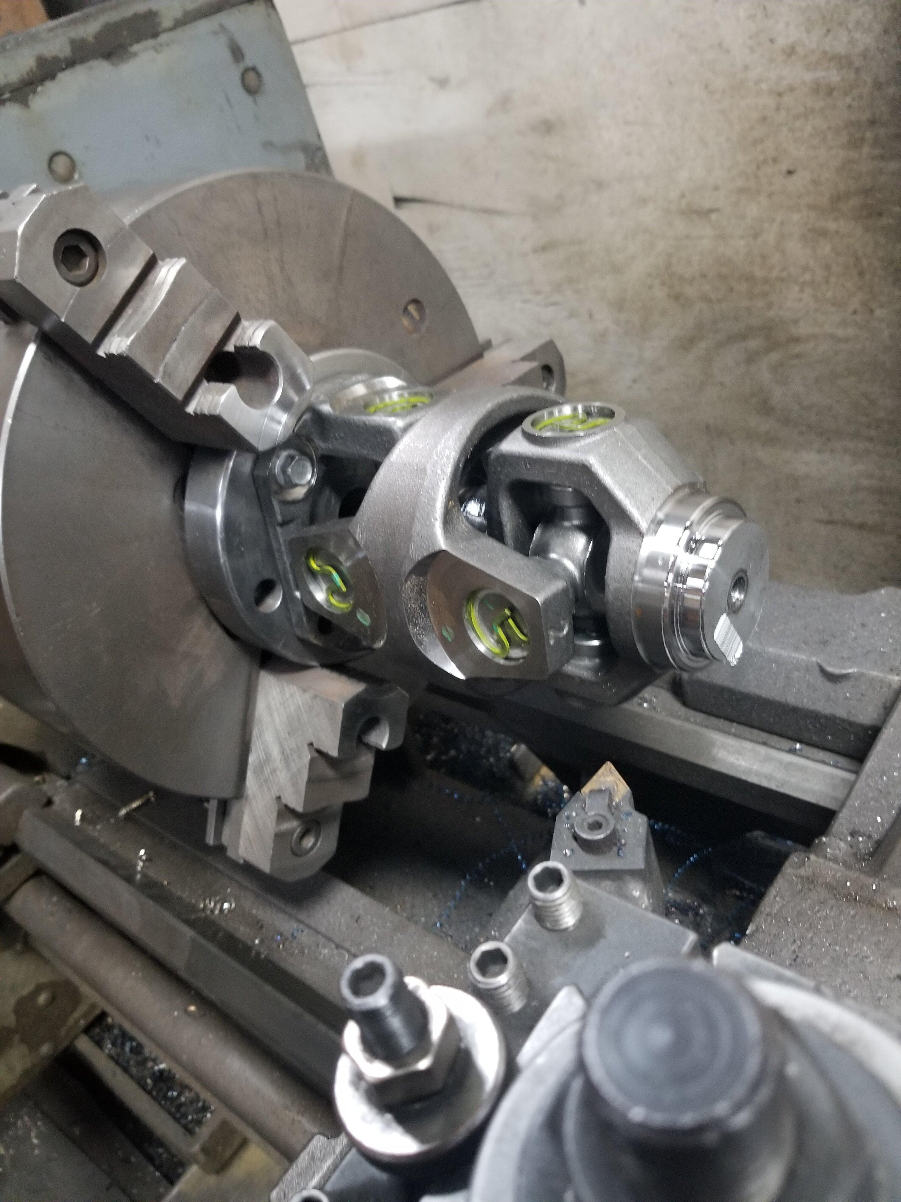

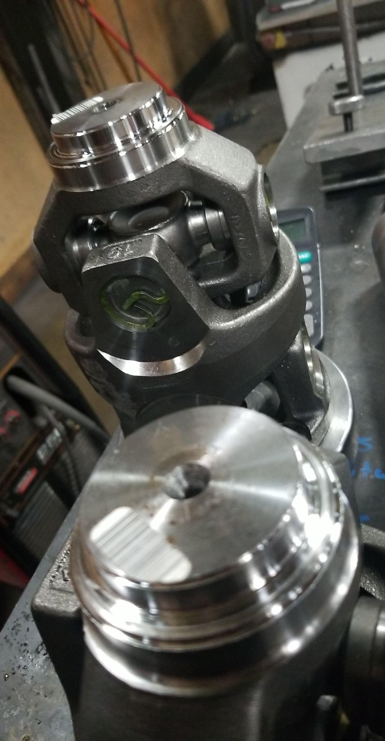

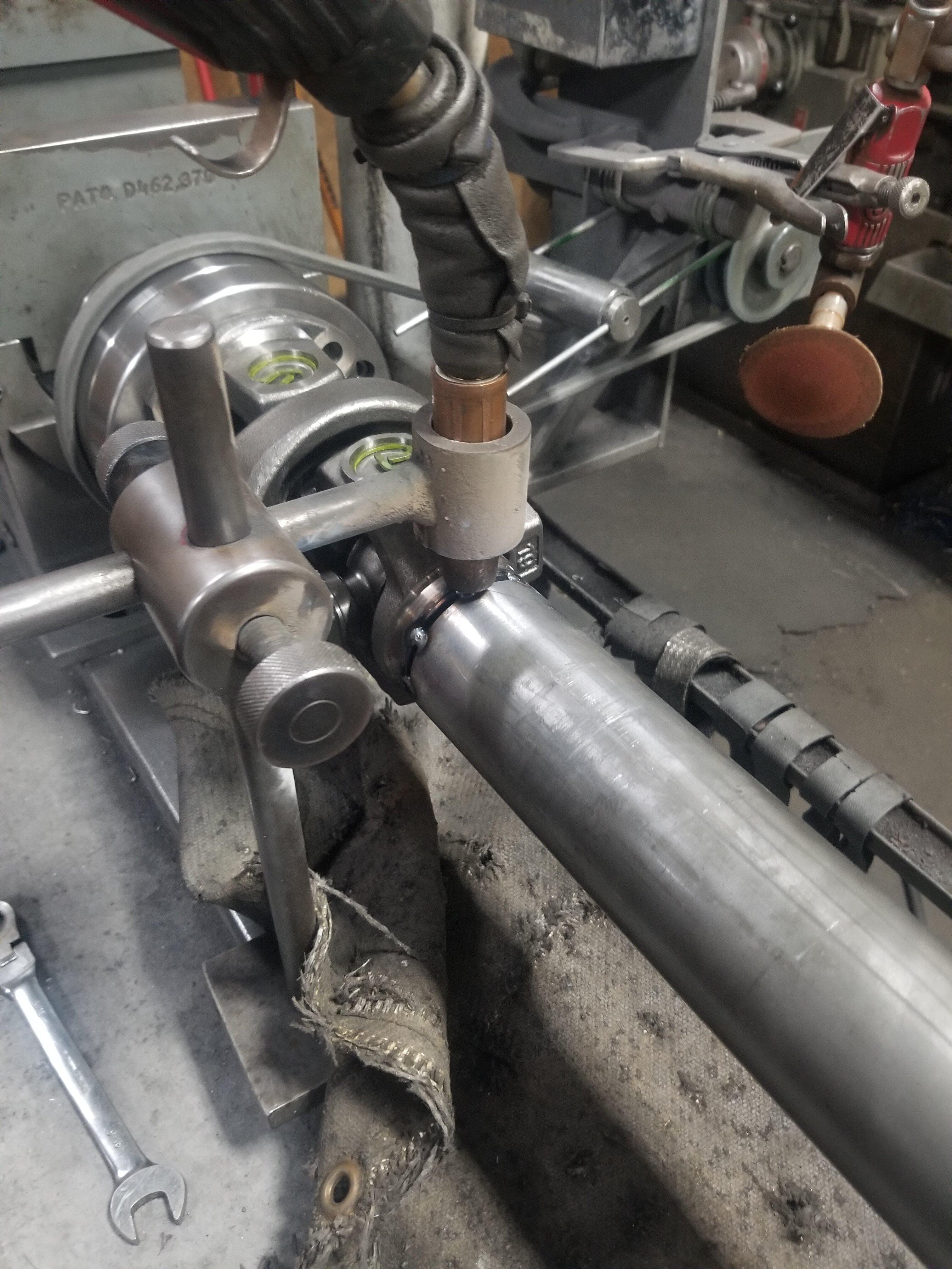

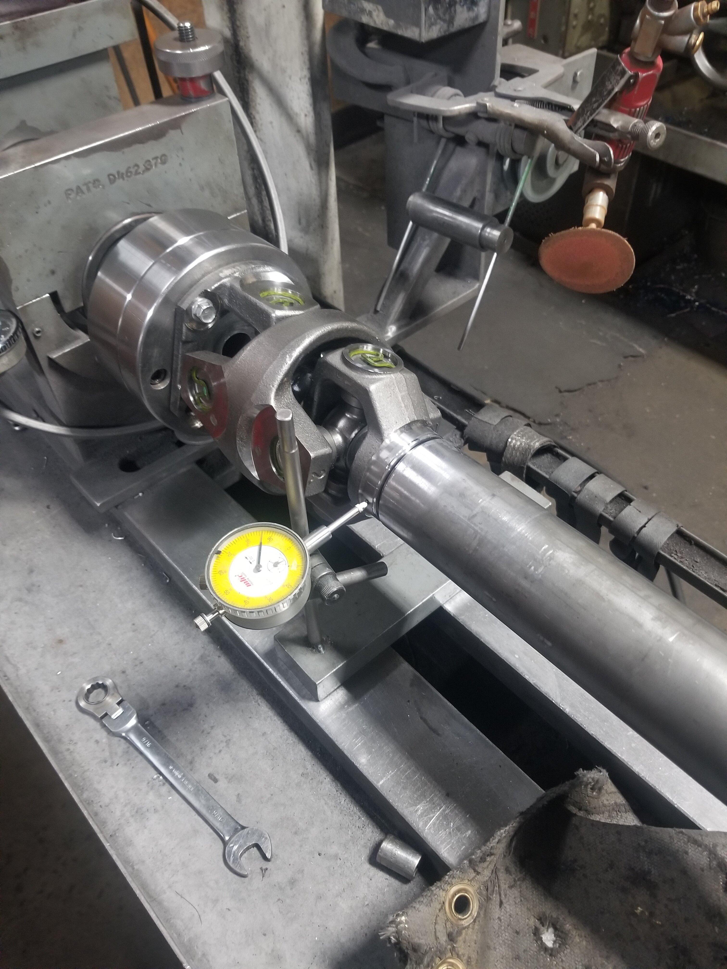

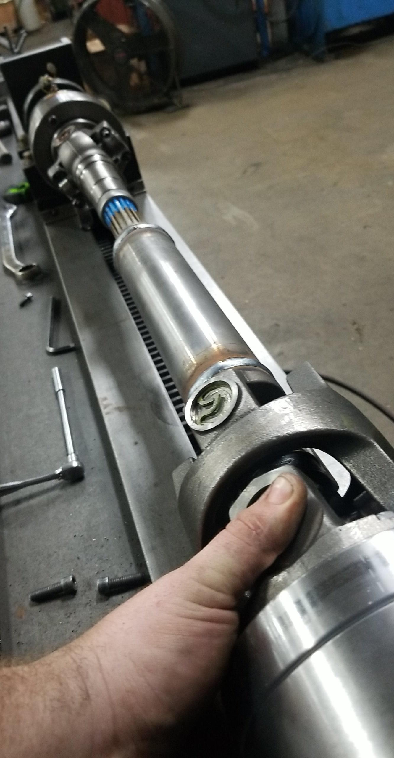

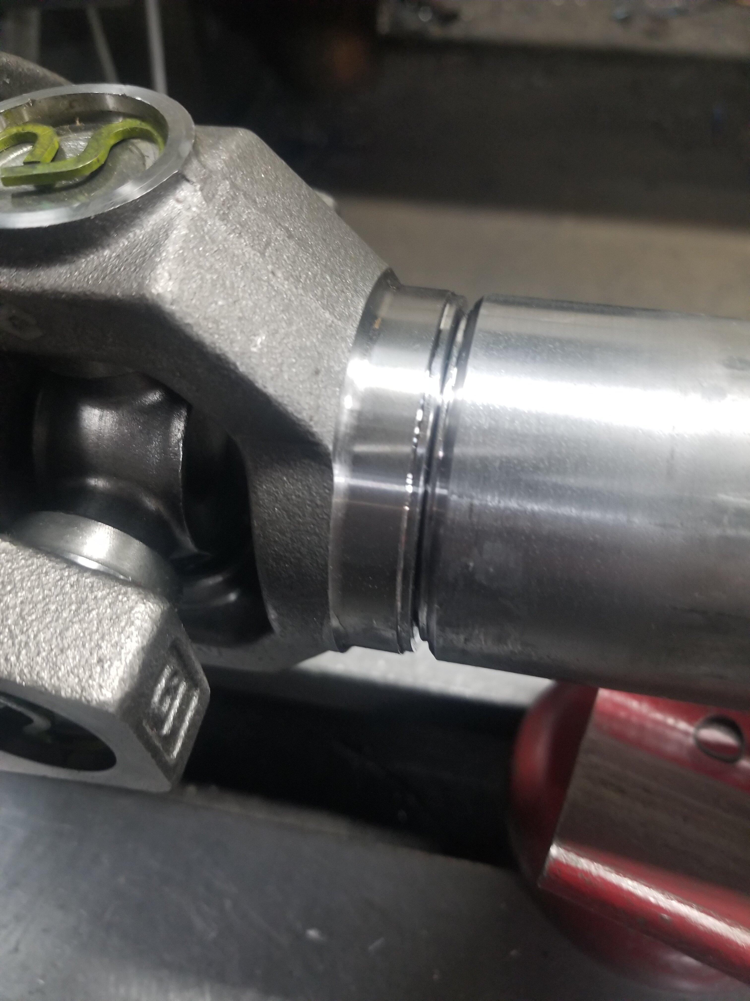

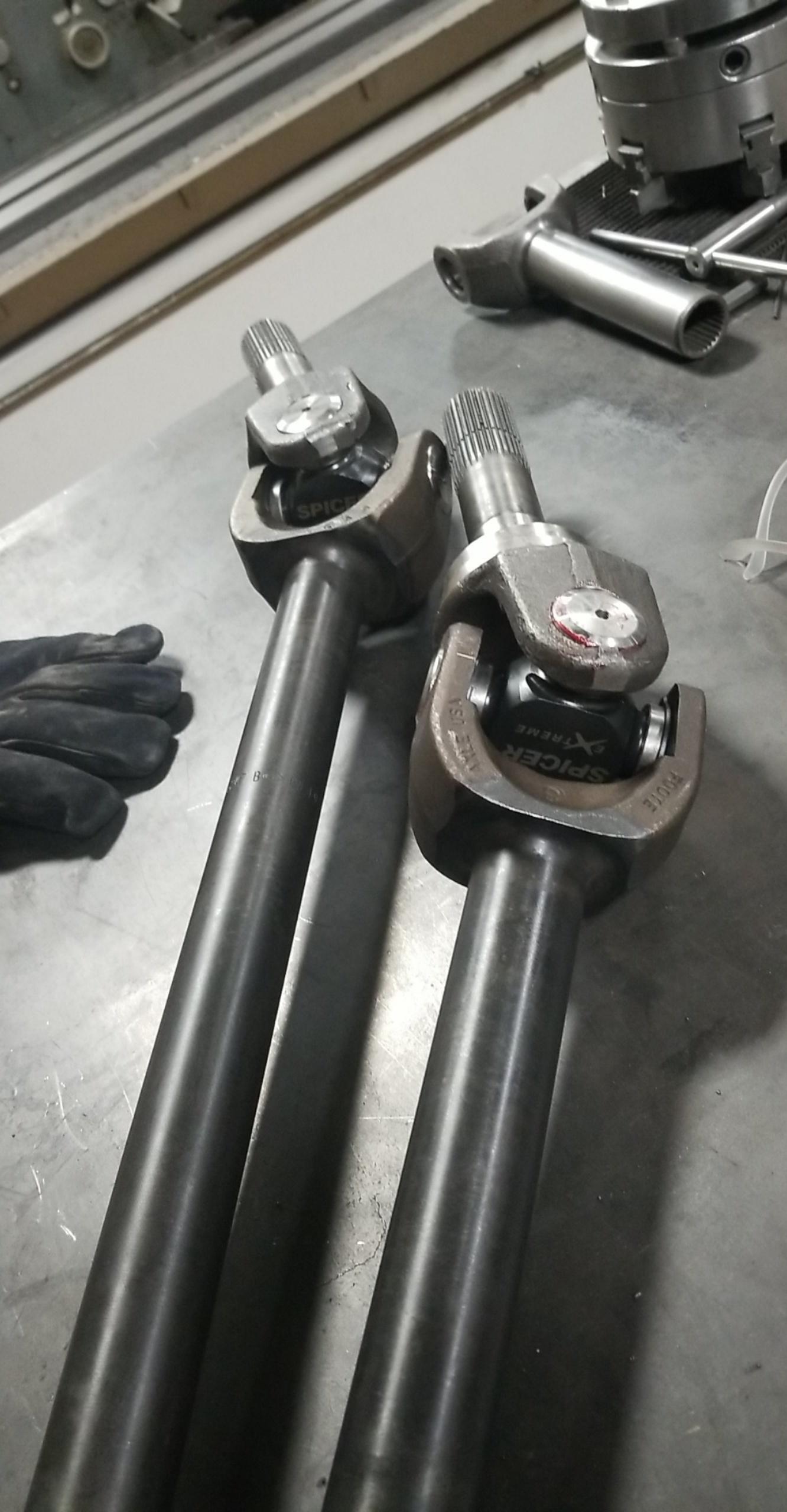

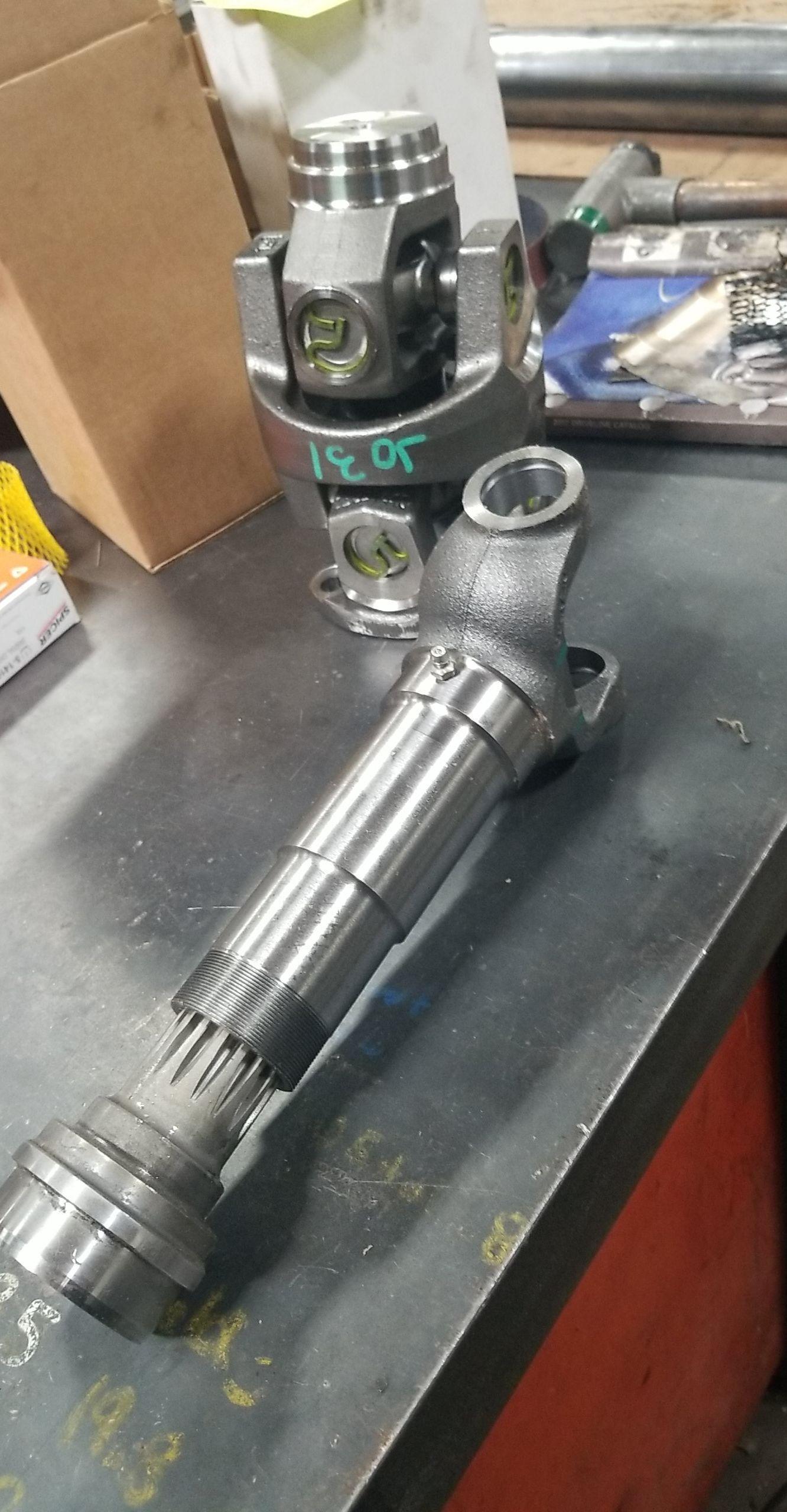

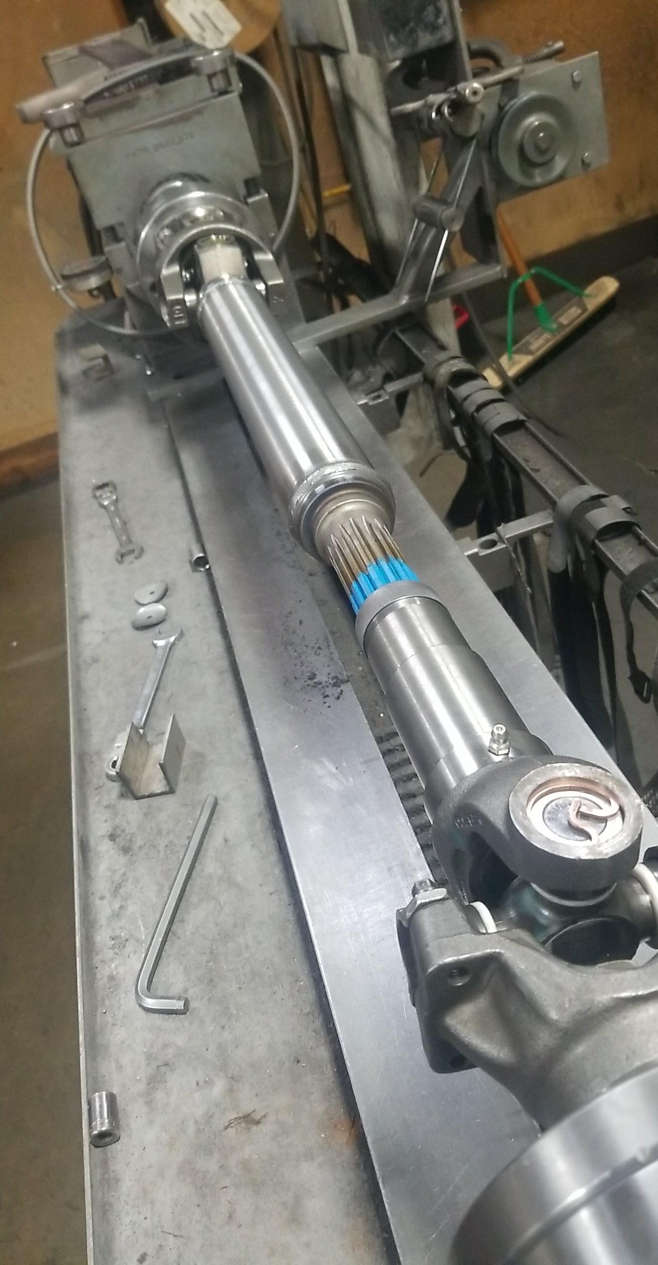

Figured I would get something productive done today so 3rd setup started. Next to see all these parts come together.Little grinding was needed to clear the 9.5in ring gear. Little surface grinding on the solid spacer and pinion group was set.Was able to find a 1410 35 spline yoke from Spicer.

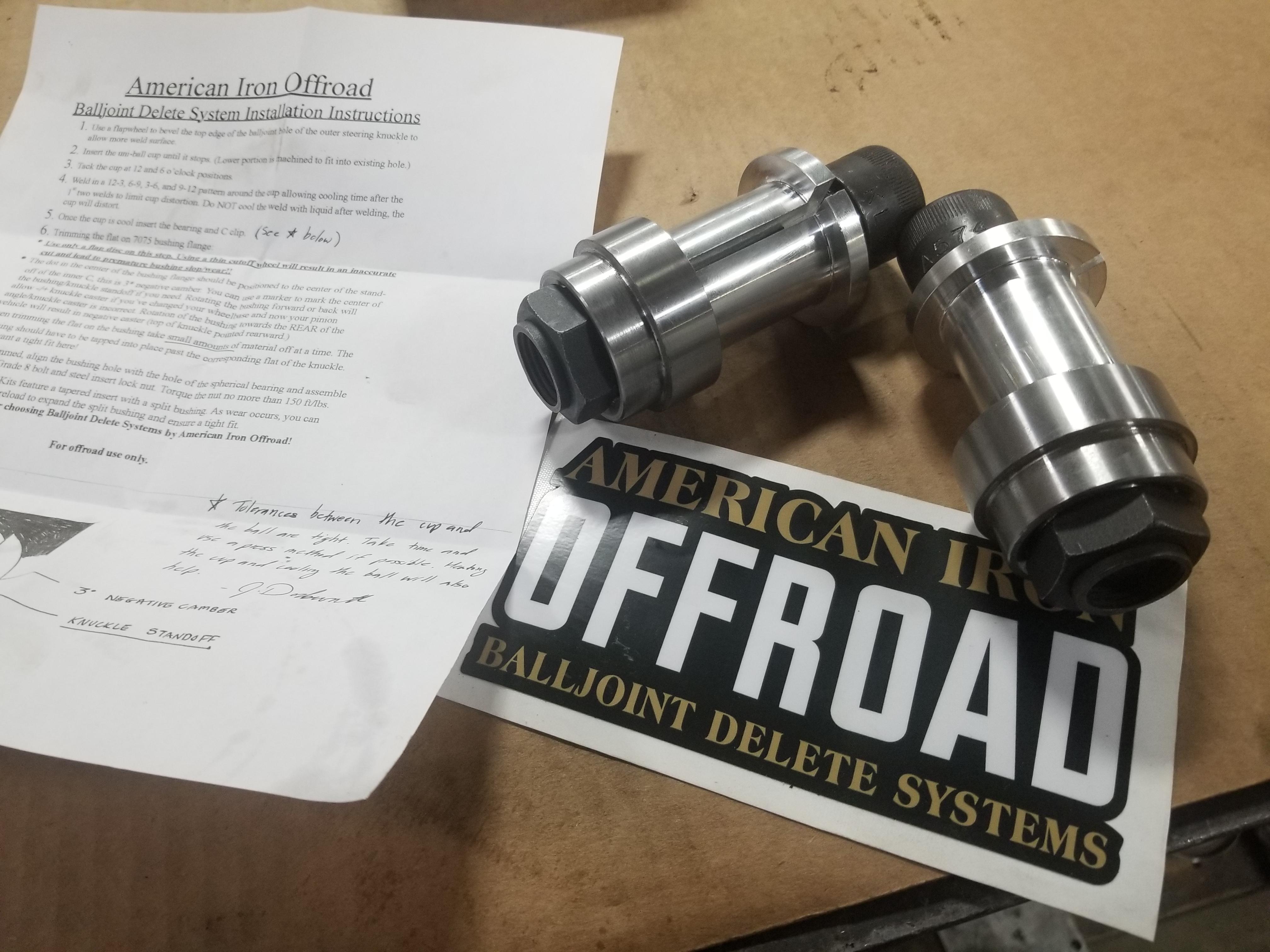

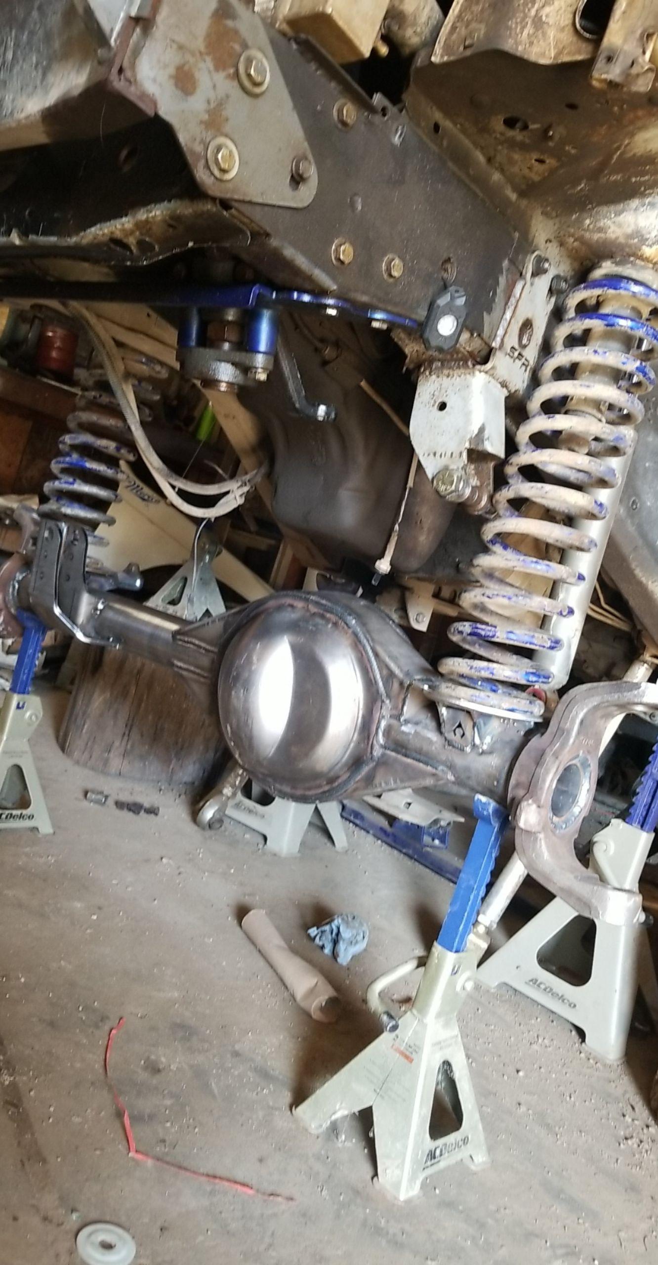

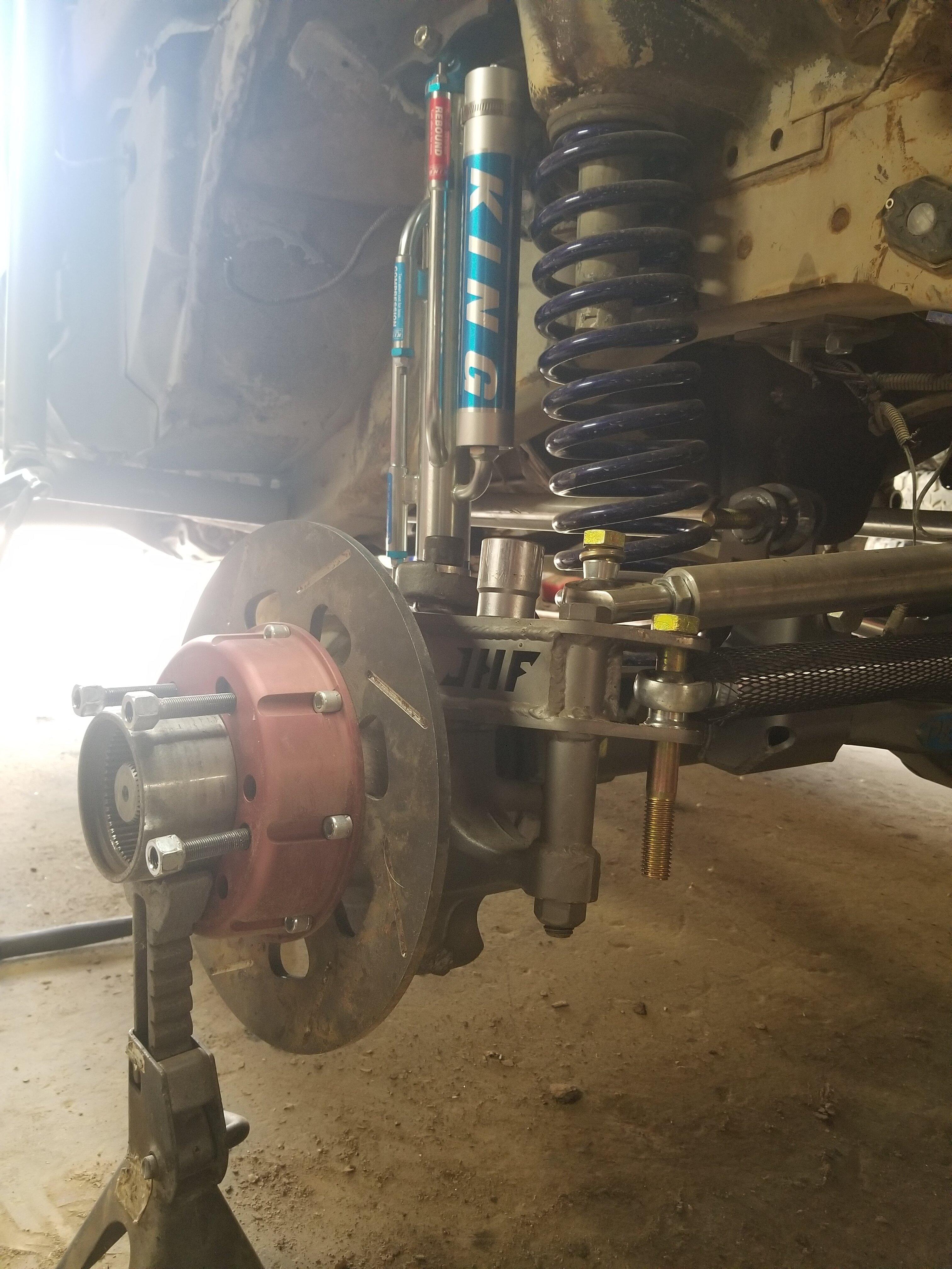

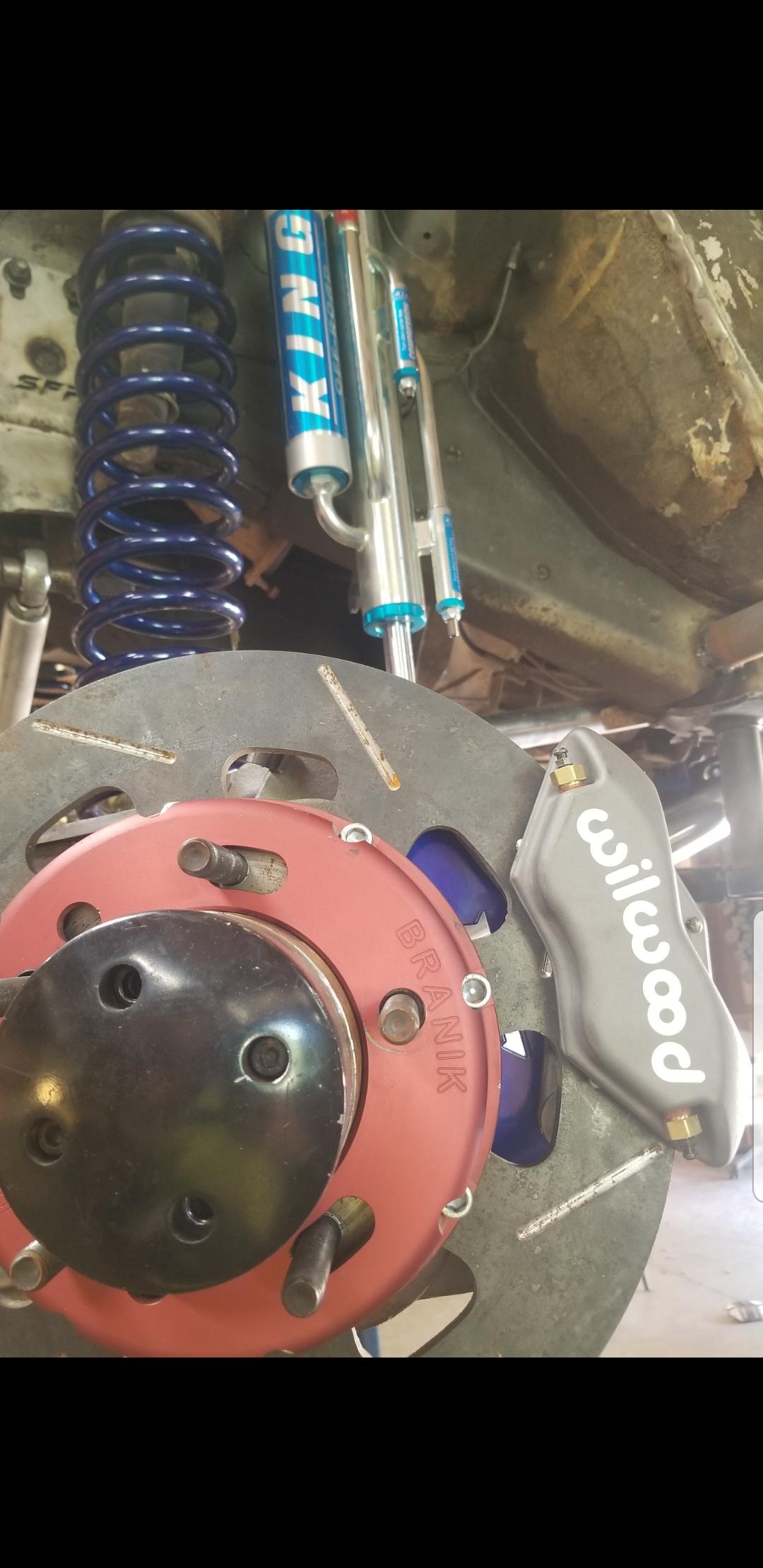

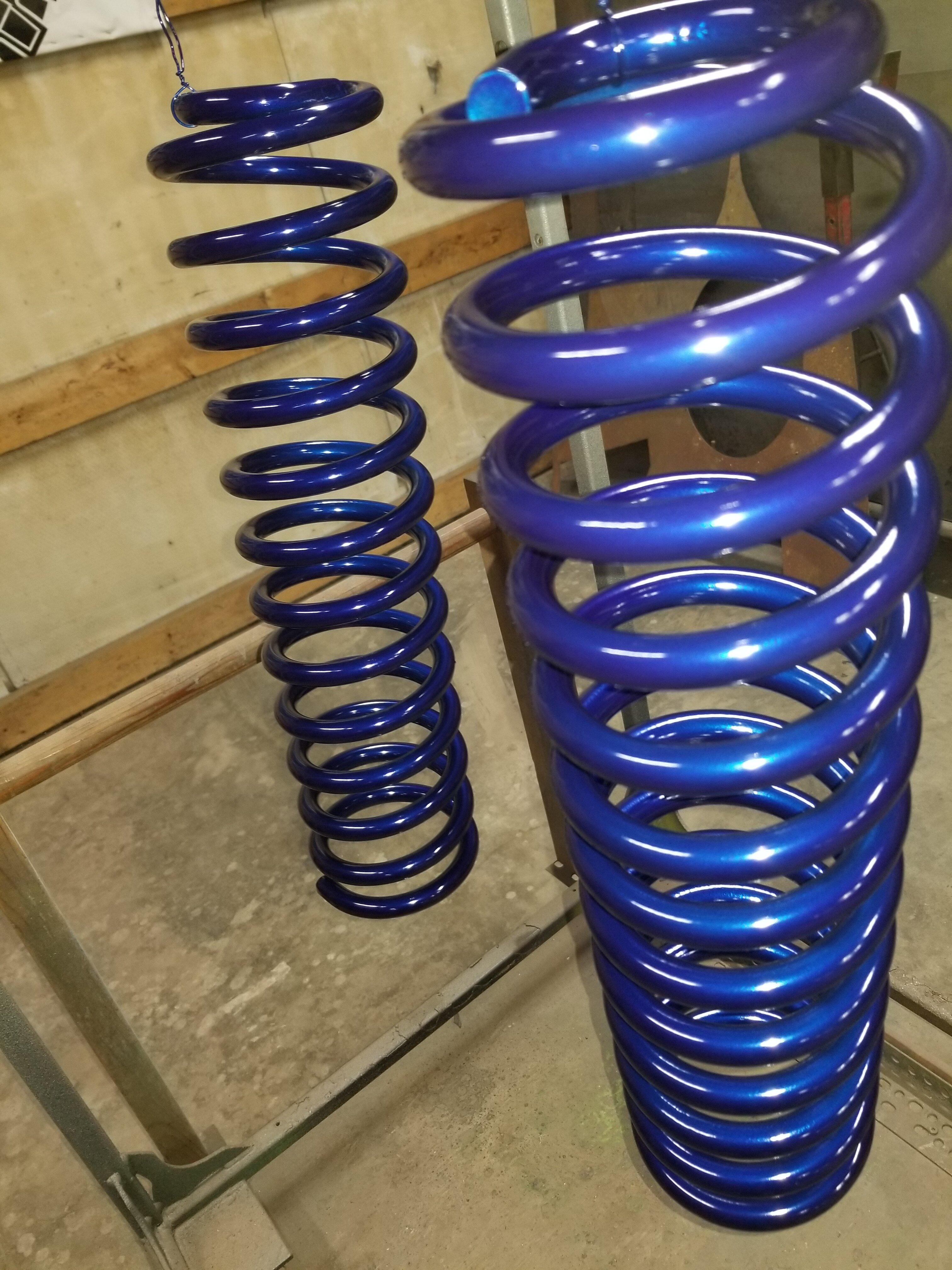

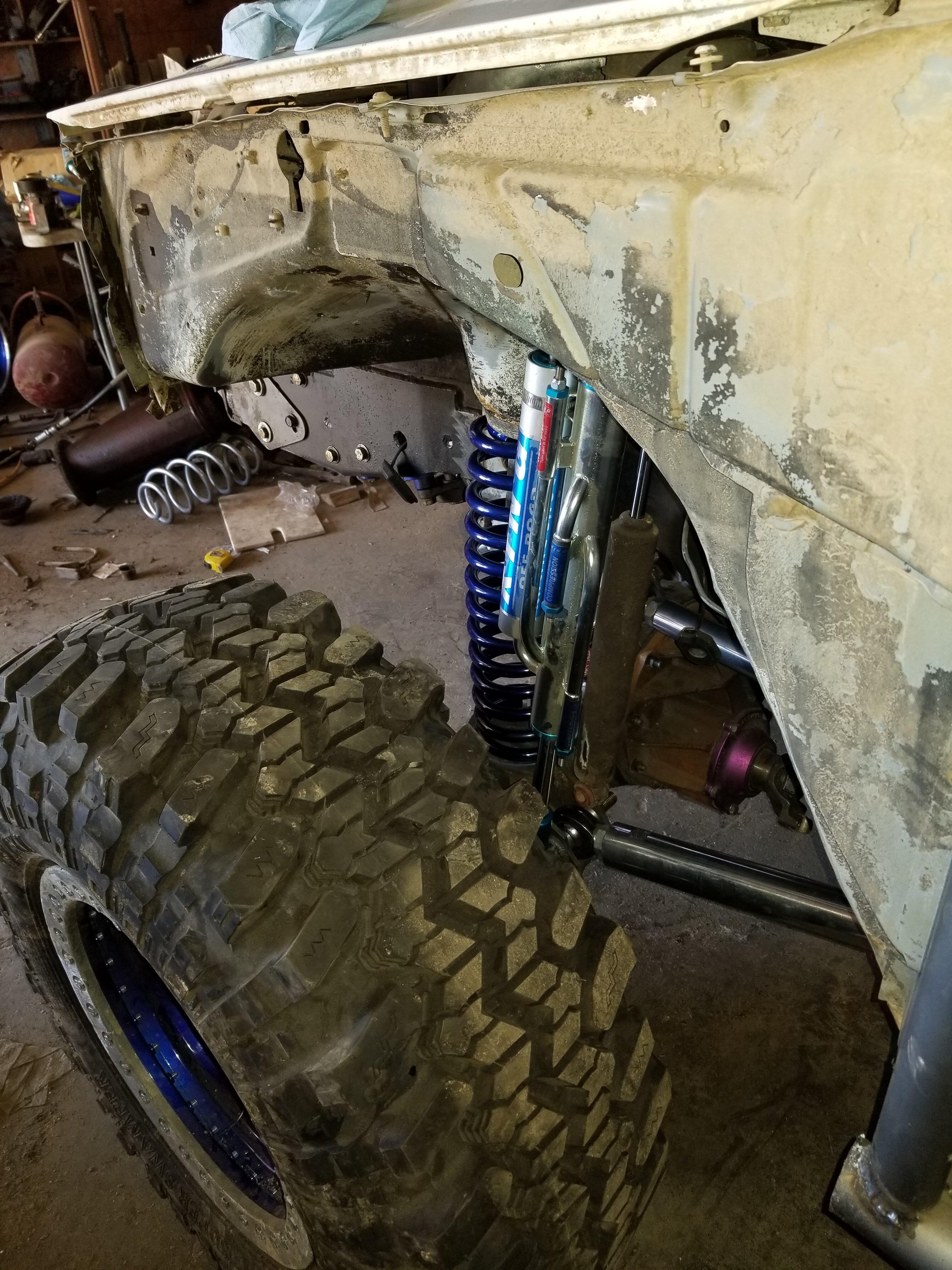

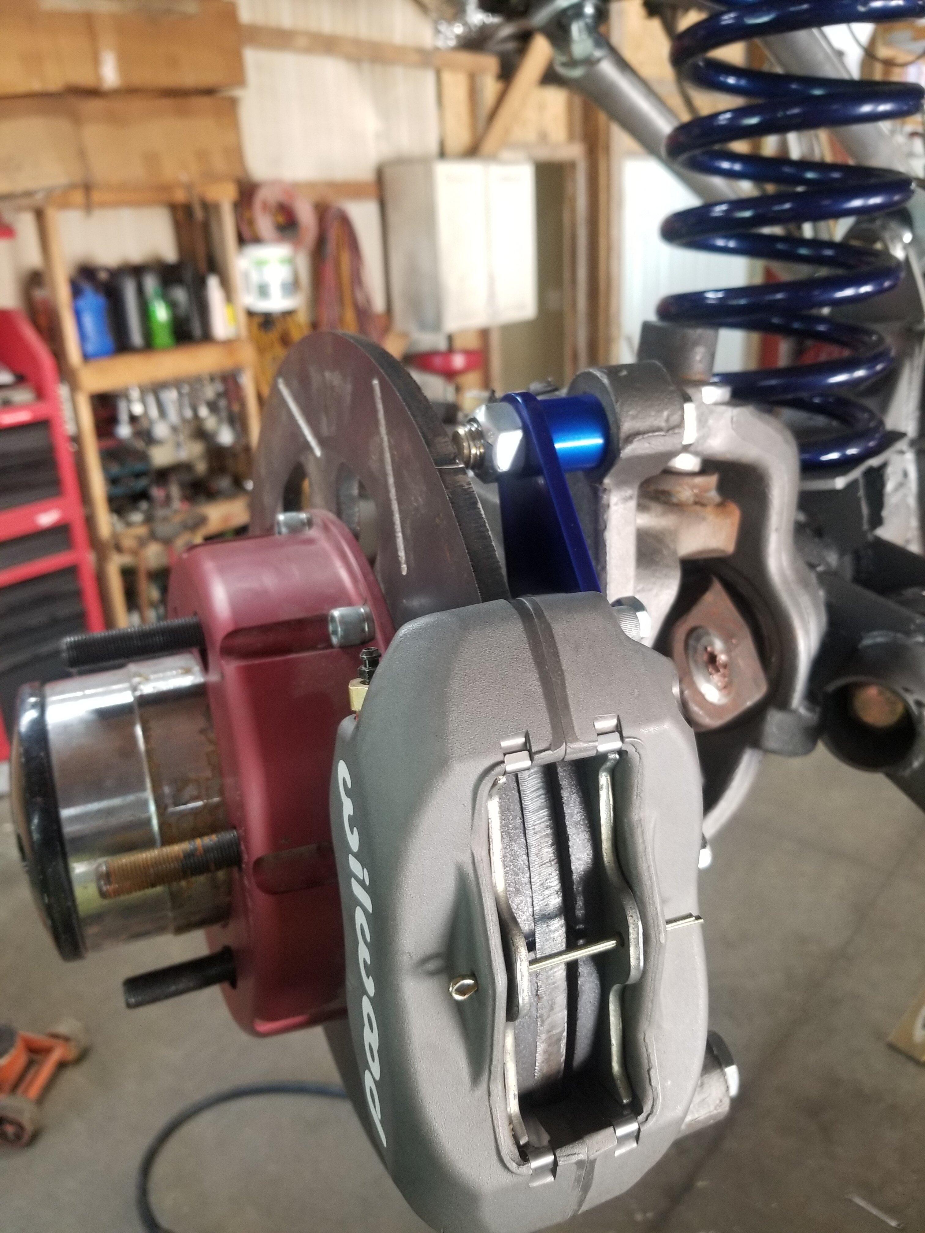

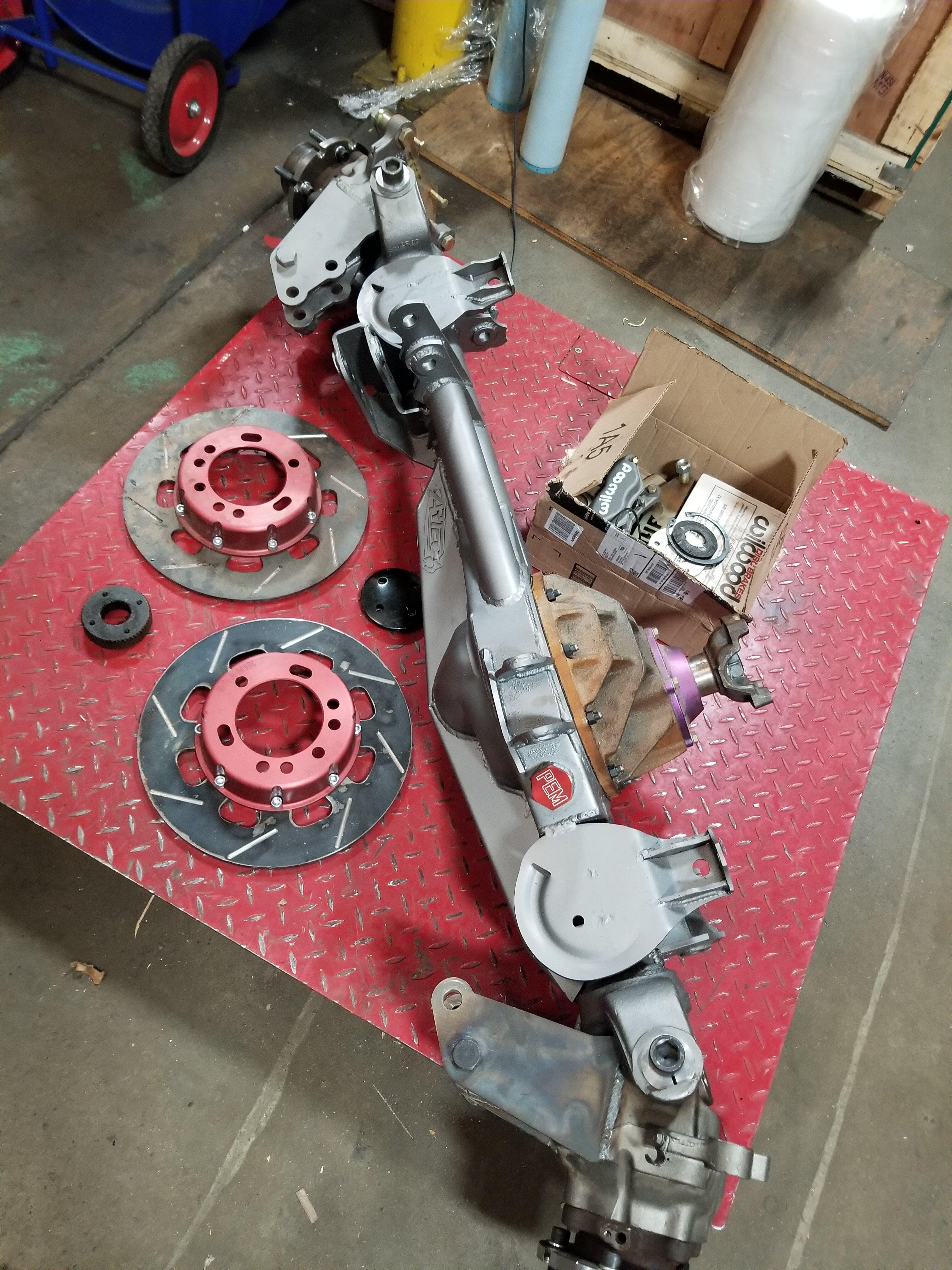

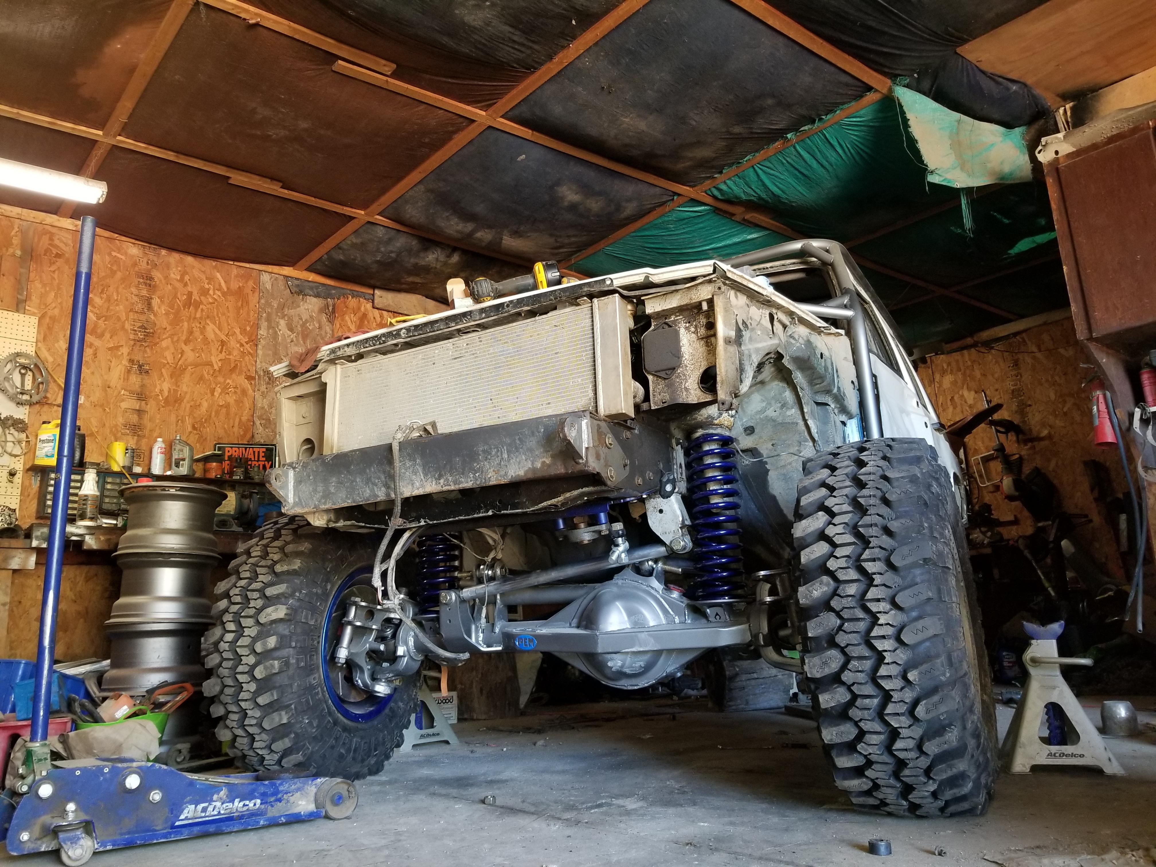

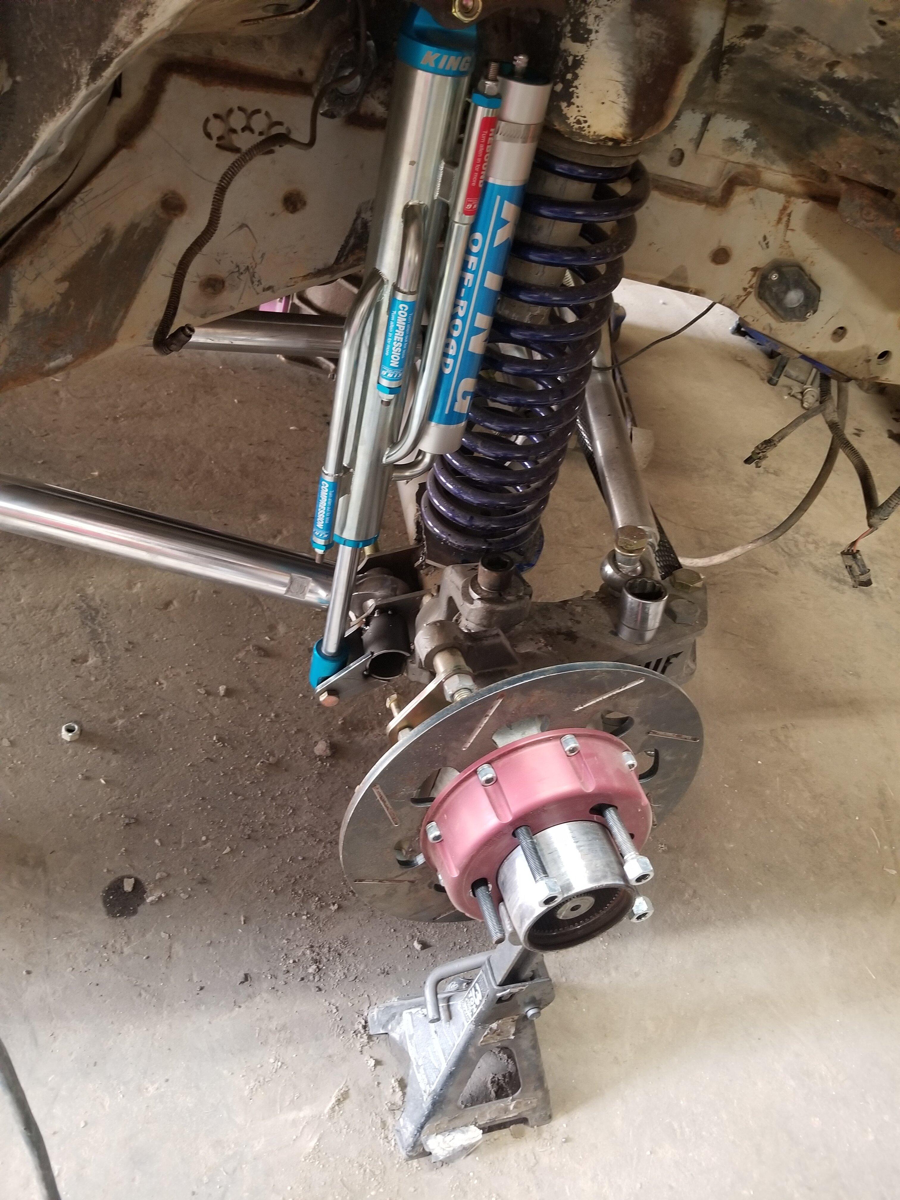

Finally got the axle to the shop from work.Little mock up and the coils are where they should be.Will be able to use my old track bar aswell with a little more adjustability. Friday my Ball joint eliminators came in from American Iron.Really happy with the product.
