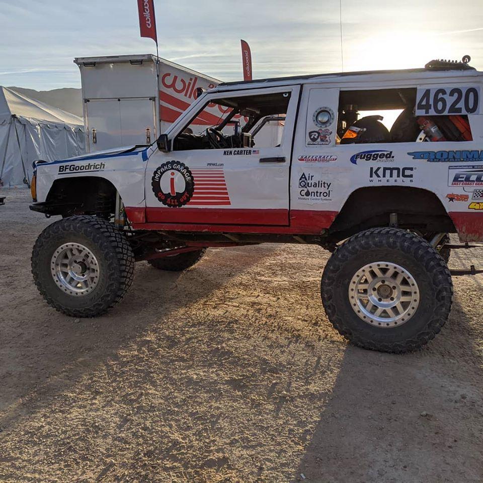

Will be tracking you and Bruiser (4620) on Wednesday for sure.
