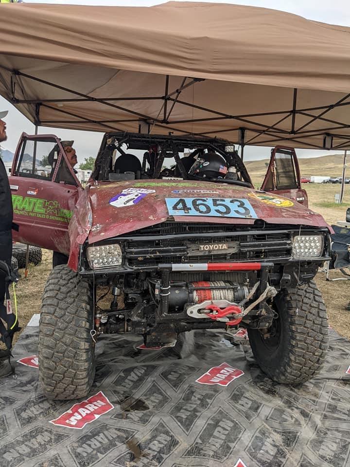

I got the AFM remounted in the correct orientation.
