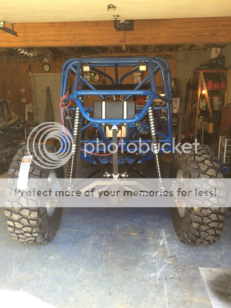

What are people doing about not being able to run rear bump stops with coilovers? I see a lot of people don't. Building a new chassis and not going to be able to run rear bumps. Thanks
Rjhoward32006 said:I thought about this for a while when i built mine. The chassis is so far away it would look like a donkey **** hanging down to run a bumpstop. I have about 6-7" of shaft at ride height and have never felt them bottom out hard. I ran air bumps uf front so i can really hit stuff hard. But so far no bumps in the rear have worked for me
Rjhoward32006 said:that was before the suspension was ever really built. i dont even run those springs anymore
