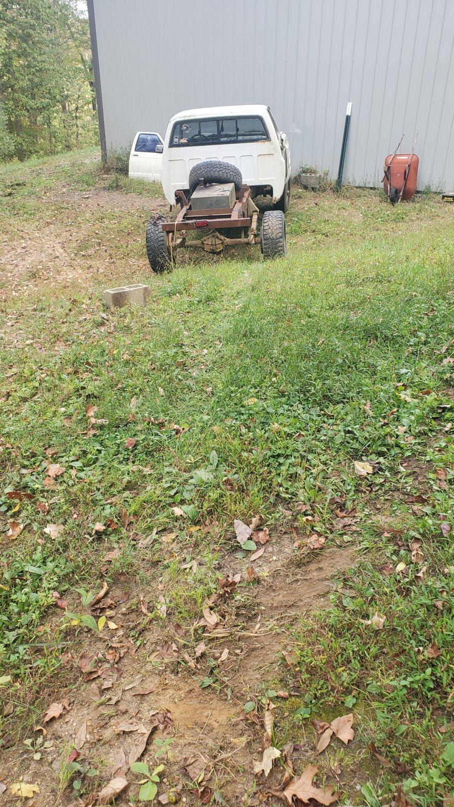

Trying to find a color close to the truck in the top of pic. Cheap brush or roll on worthy. For the cab an dog house. All other metal work is Massey Ferguson gray.

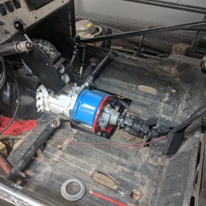

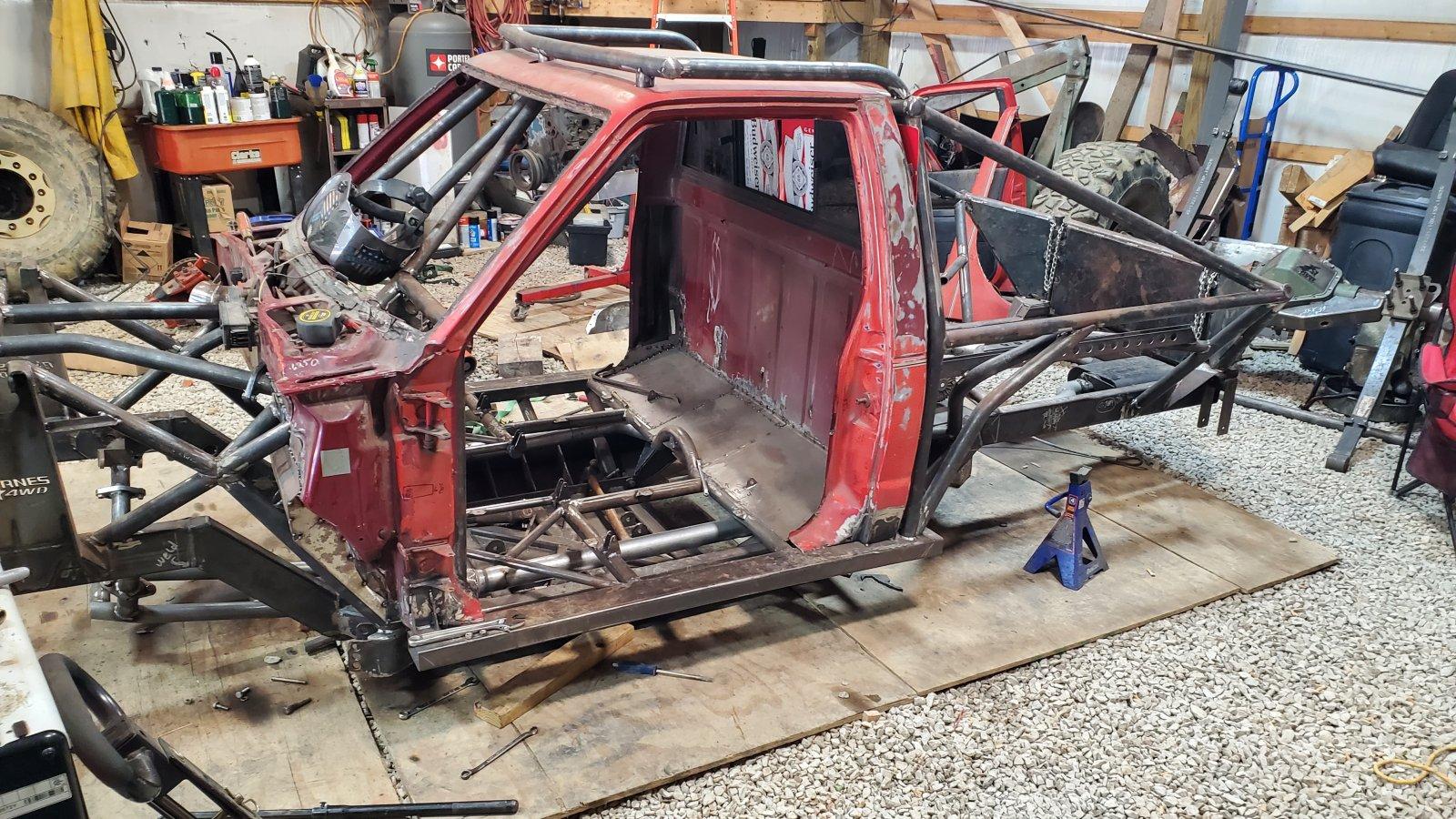

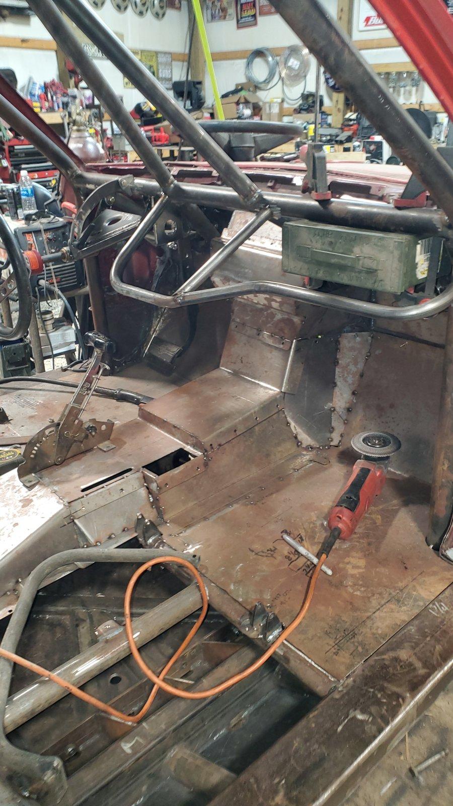

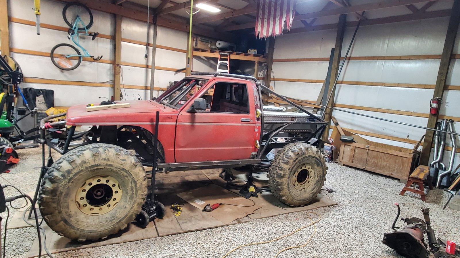

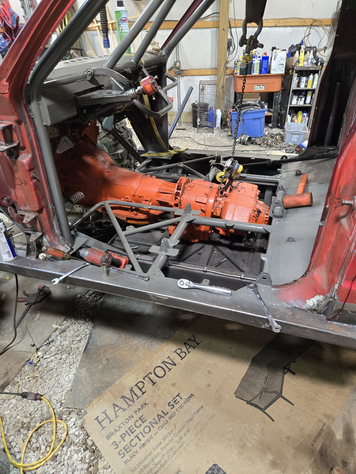

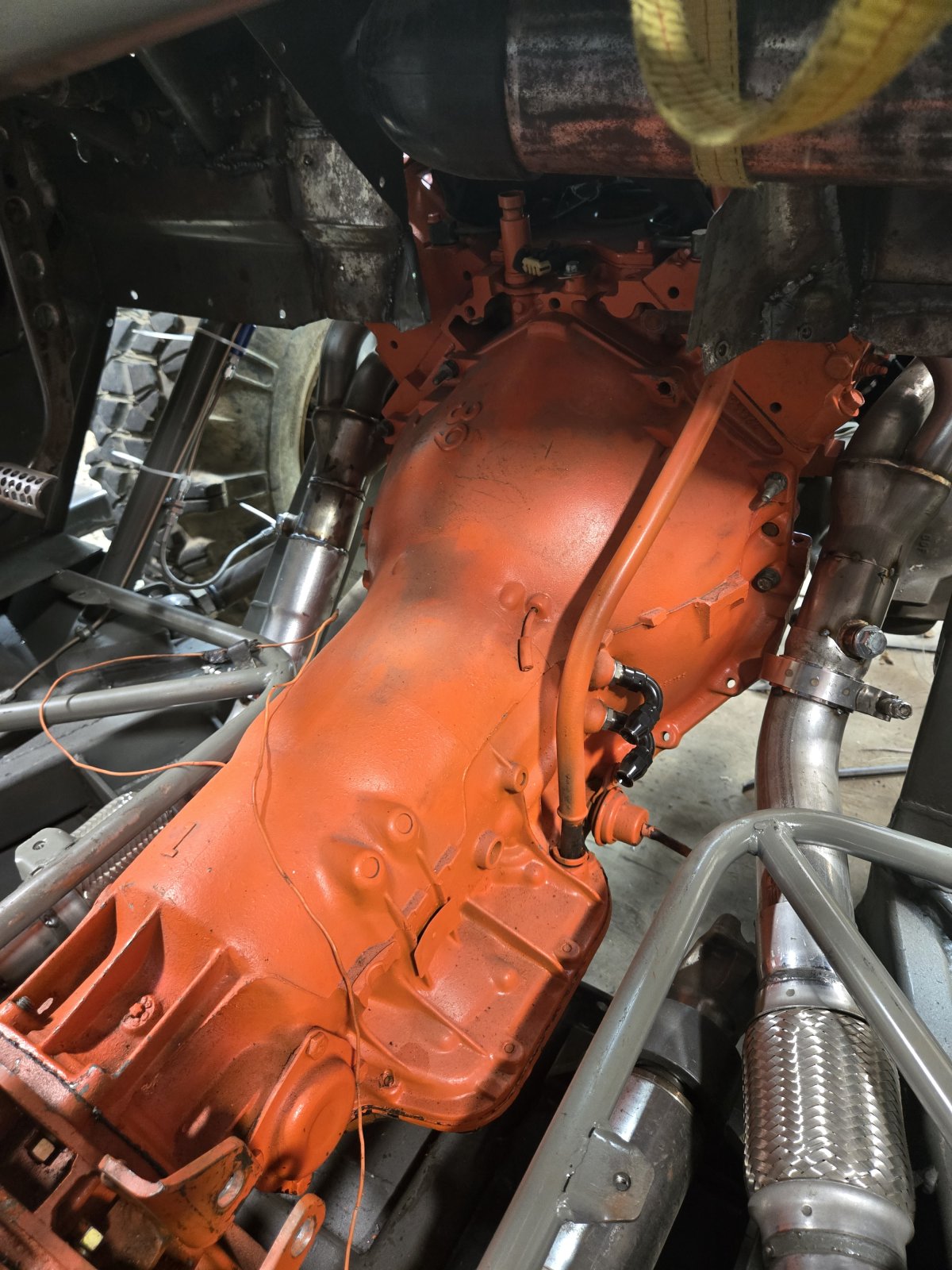

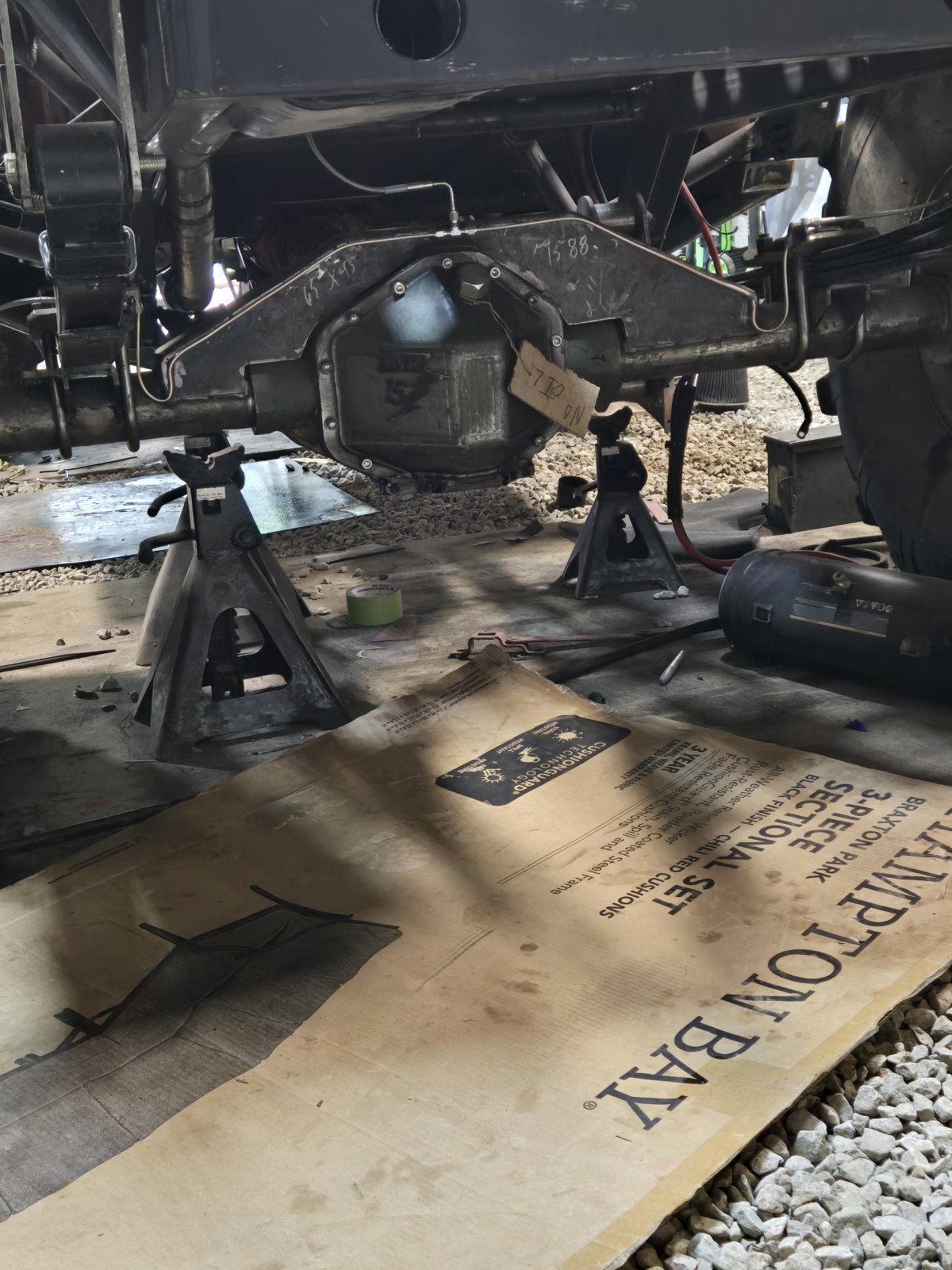

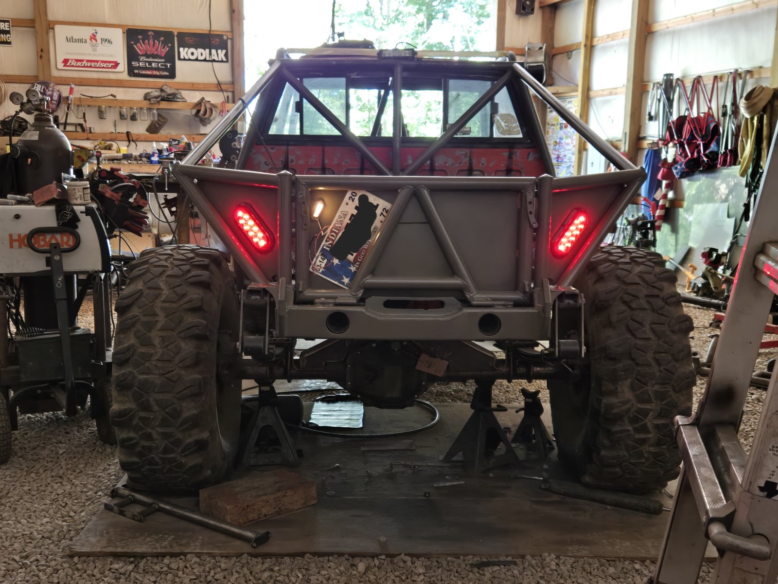

She is going back together, had 4 day weekend so ive sweat my balls off to get drive train in.
Forgot that the transfercase has to go in, in a certain order started to cuss the engineer, remember it was me :rolf:

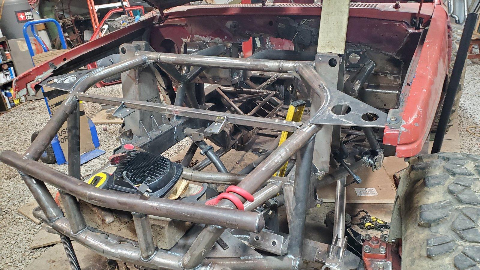

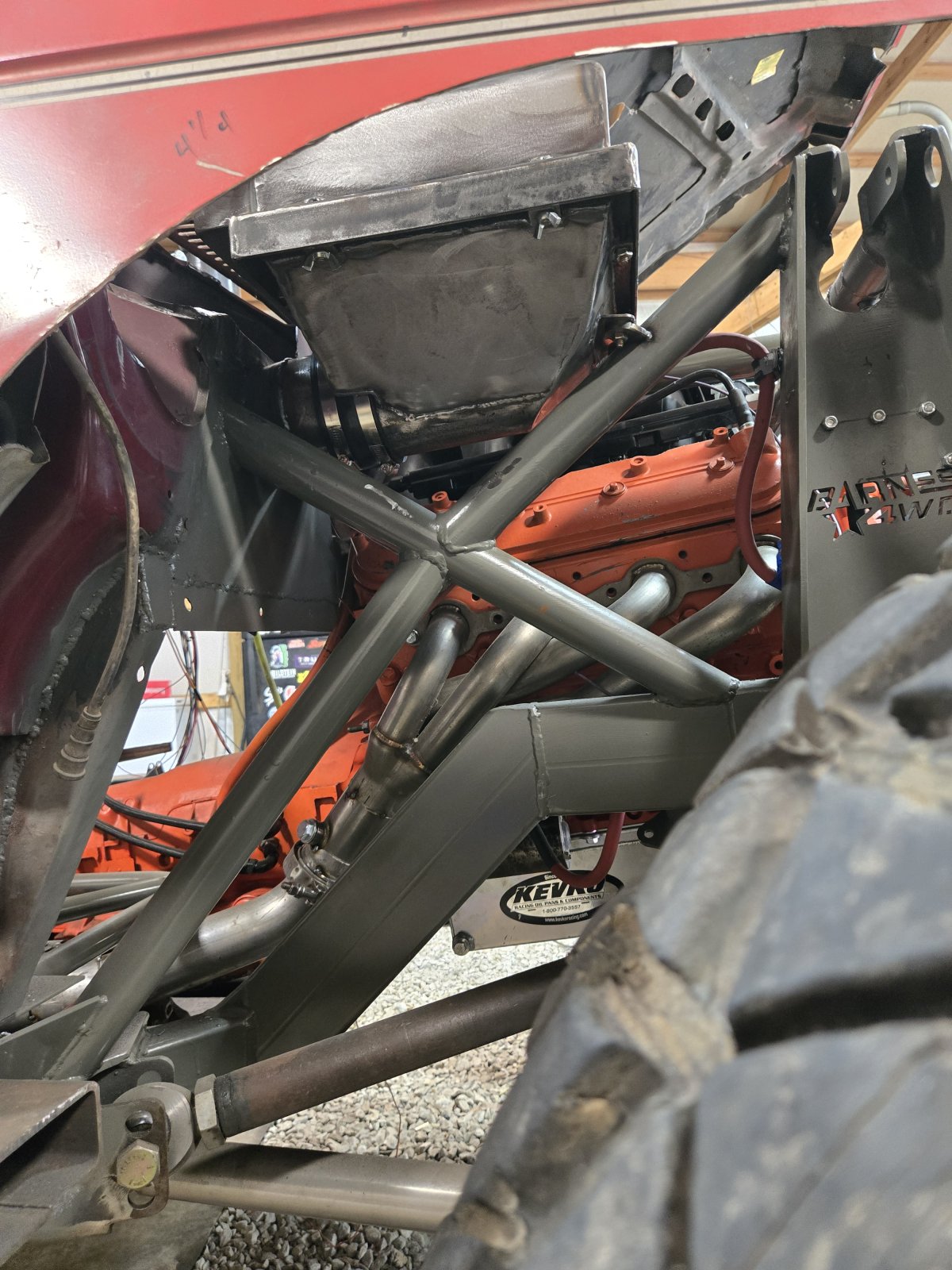

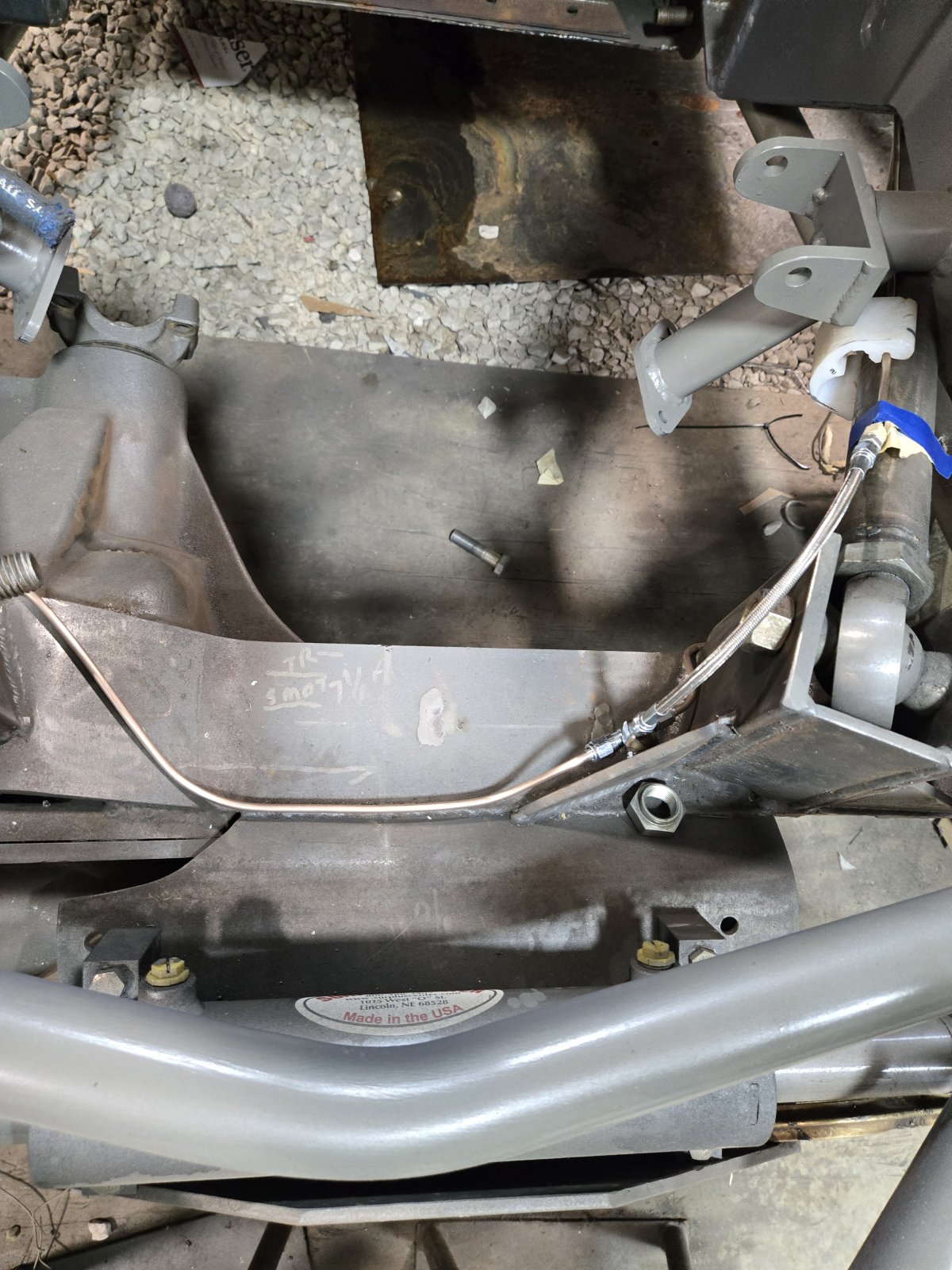

Started reworking the exhaust, deleted the 3 bolt header flange collectors. Gonna have to rework the pass side a little bit and added O2 bung, next step will be plumbing, and wireing.

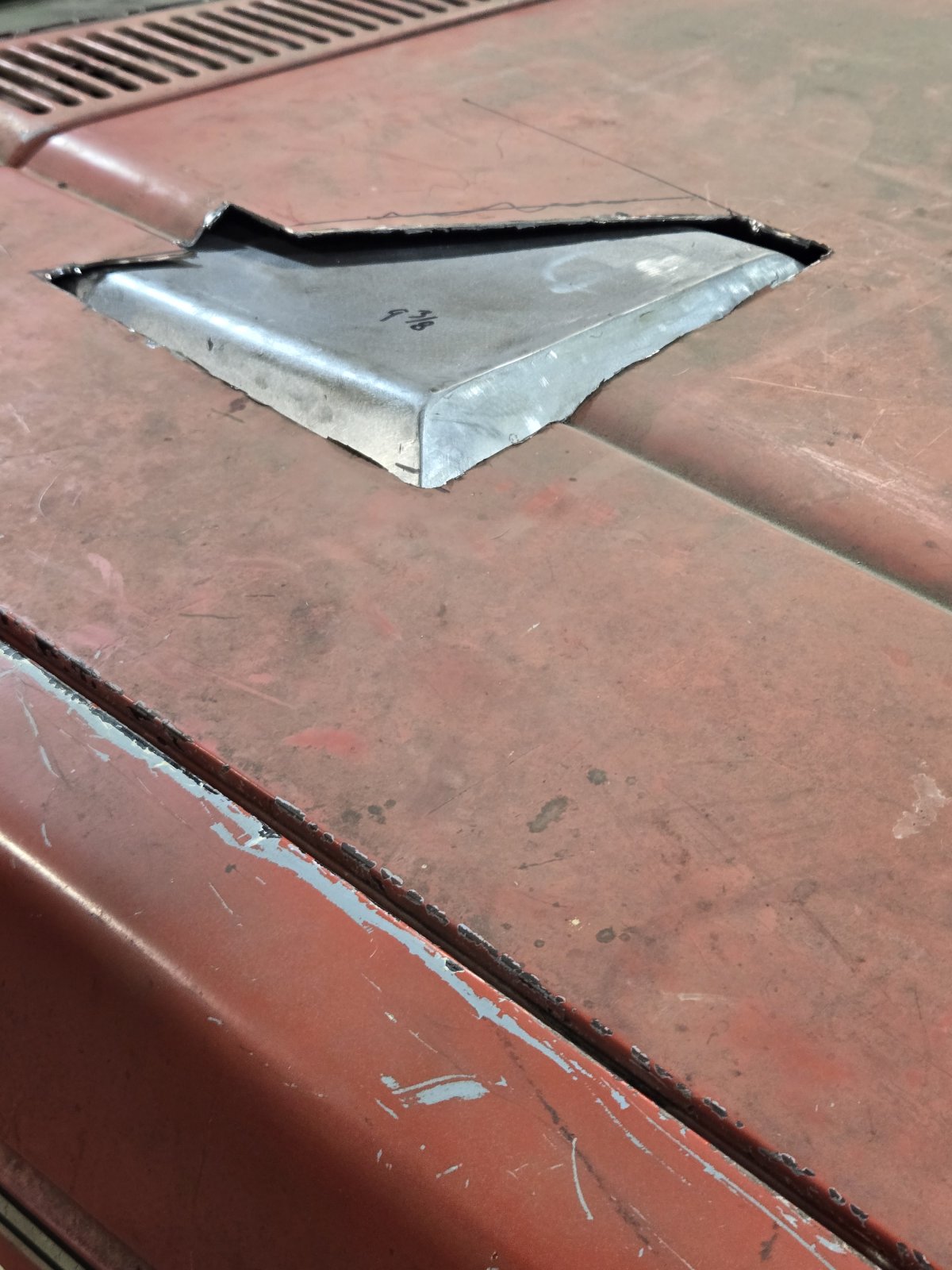

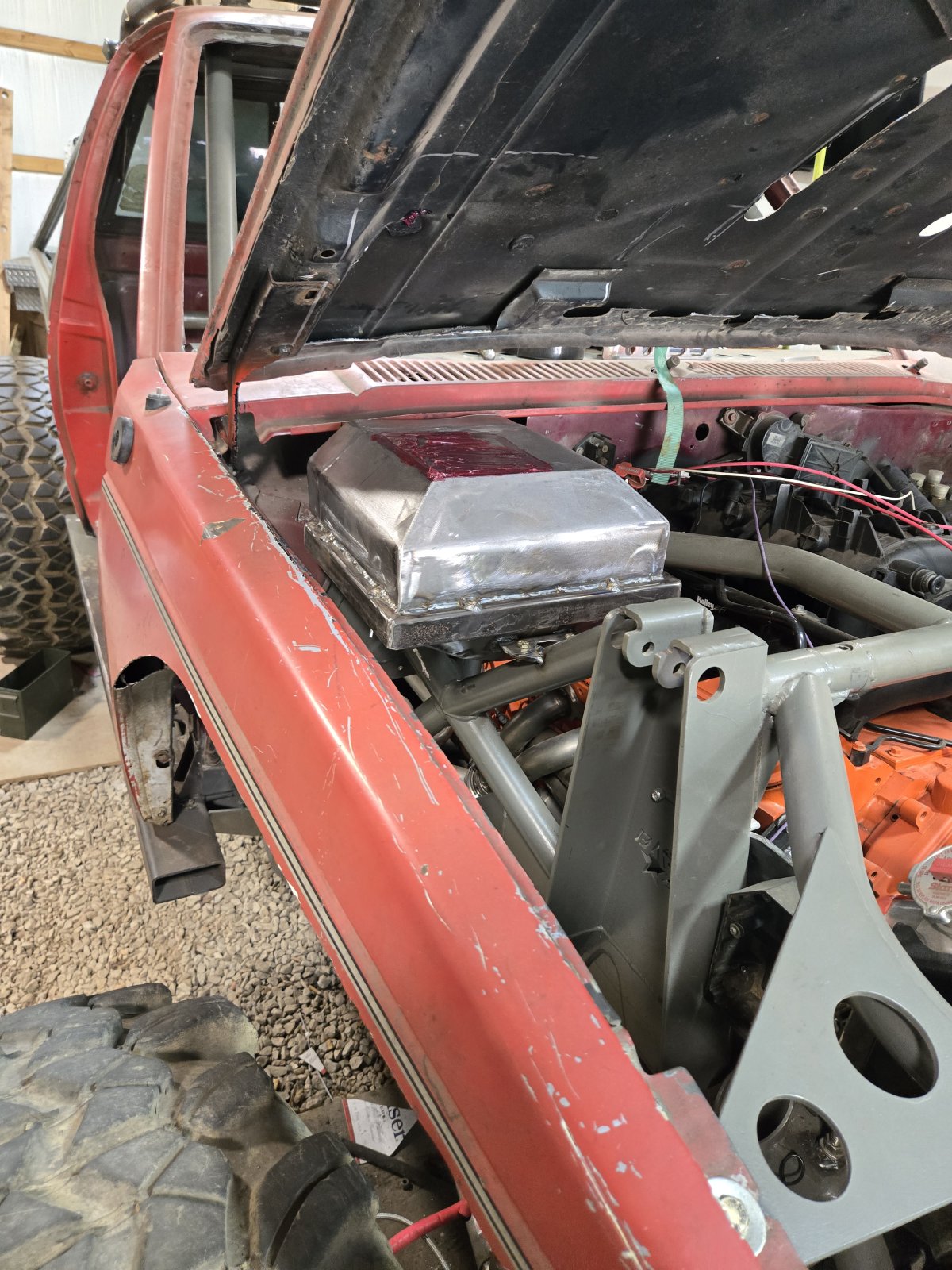

Got started on wireing awhile back and realized i needed to find a place for the MAF.
Took me awhile when i had time to figure out how i wanted to run my engine air filter.
Bought a couple different style stock paper filters, decided on a filter that matches my tow rig a, '14 2500 HD gas, lid removes from top with 8 1/4-20 nuts bolts welded ti lid.
Option is over fo future snorkel/or if it runs like **** and box is the cause
View attachment 217540View attachment 217541
MAf, will be in the firewall intake tube guess i shoulve had siad that.
