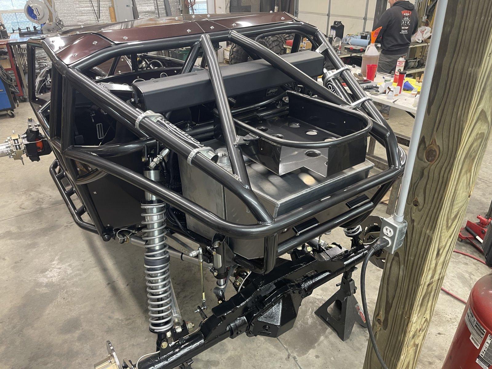

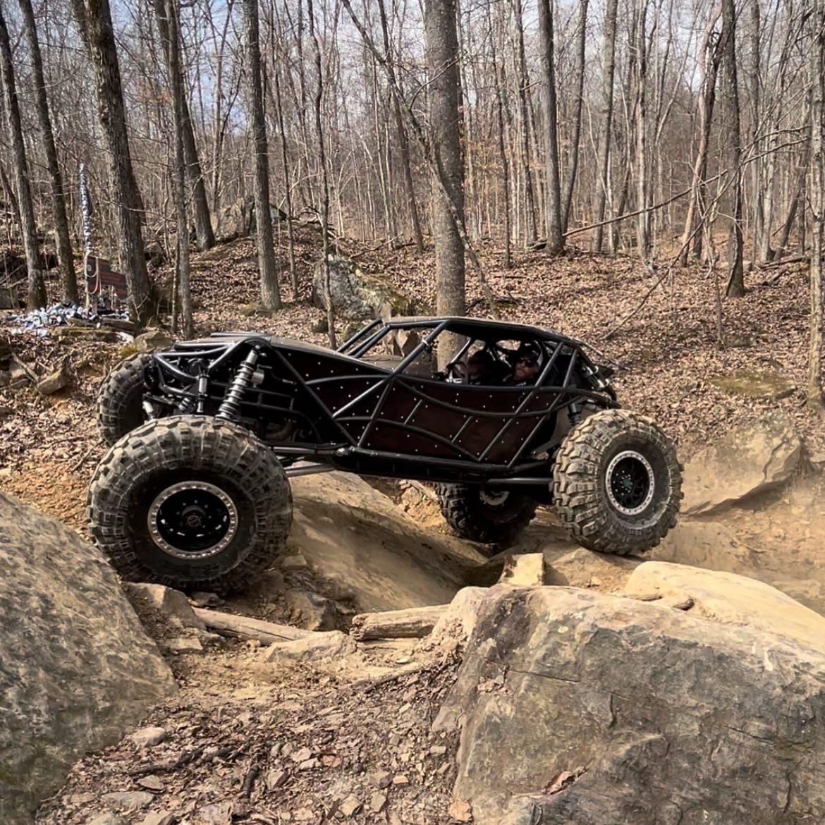

Buggy is looking good for sure. One question though, what is up with the short springs on top? I am sure the shock guru has something up his sleeve....
thank you
all shock and shock accessories were left up to east coast baby shock Jesus
if we need to make any adjustments or fine tune them down the road we can
It's standard set up. Rear has 14/16 b/c its a 14" shock. Front has 12/14 b/c its a 12" shock. Rear is soo light it's using 100/100 springs. Both ends have 1.5" of pre-load currently.

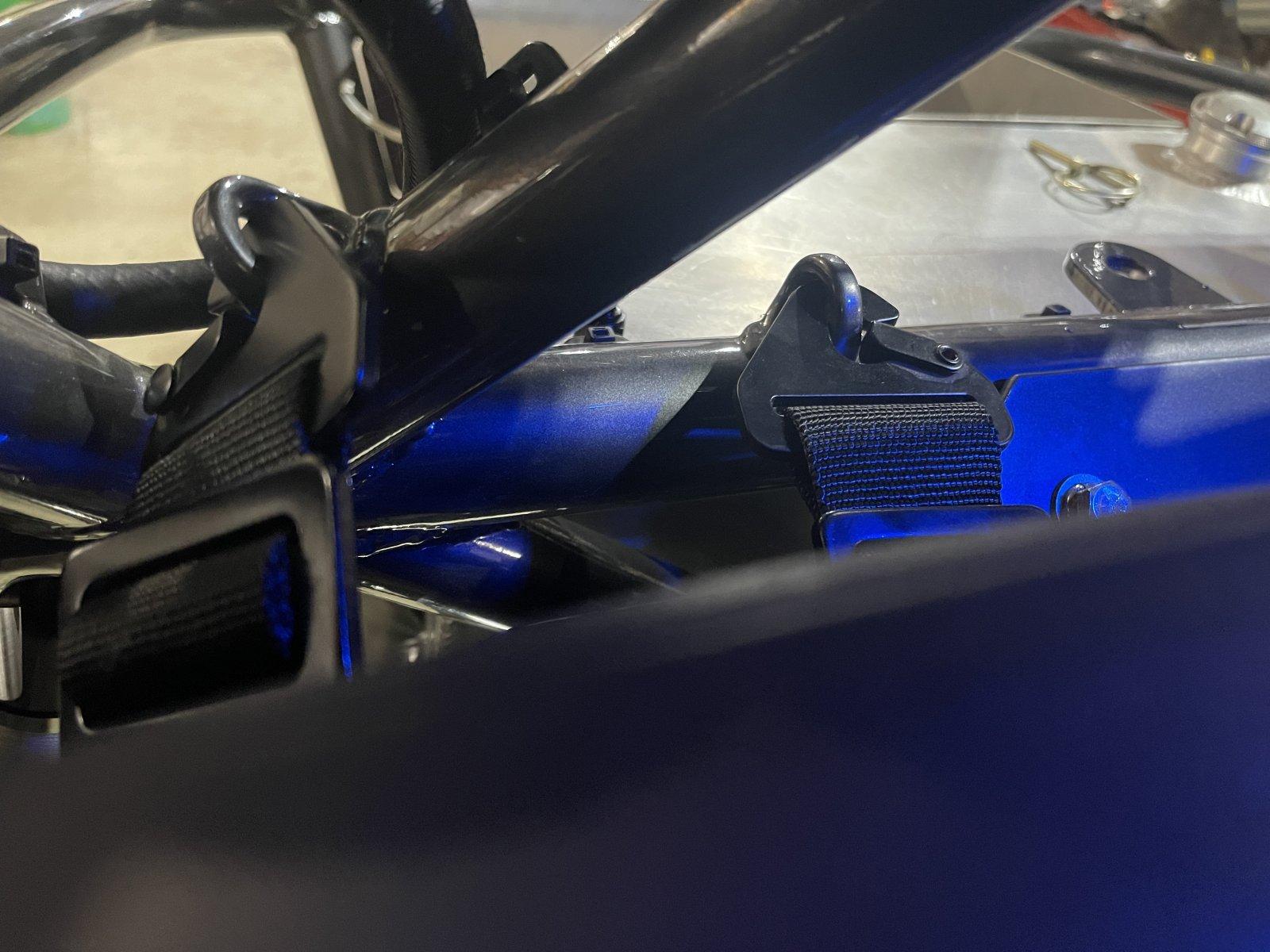

I’m really digging these clips for easy harness removal & cleaning.
