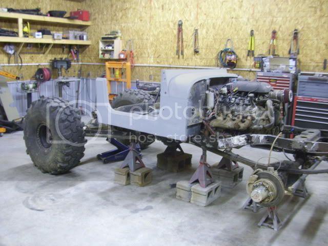

Tan Bullet remake...

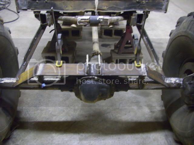

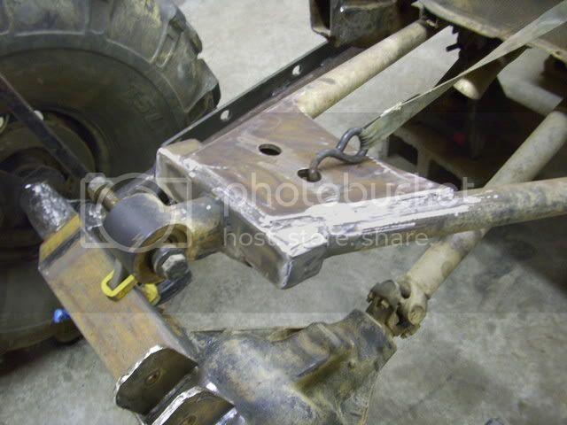

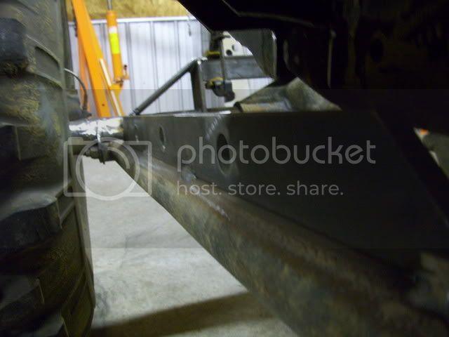

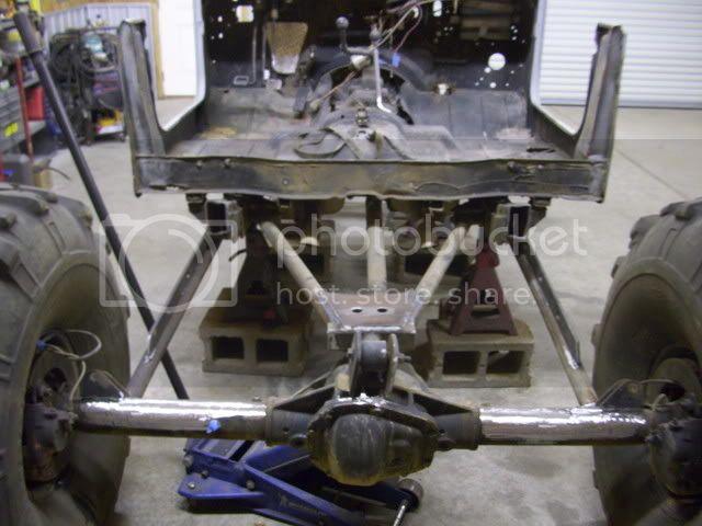

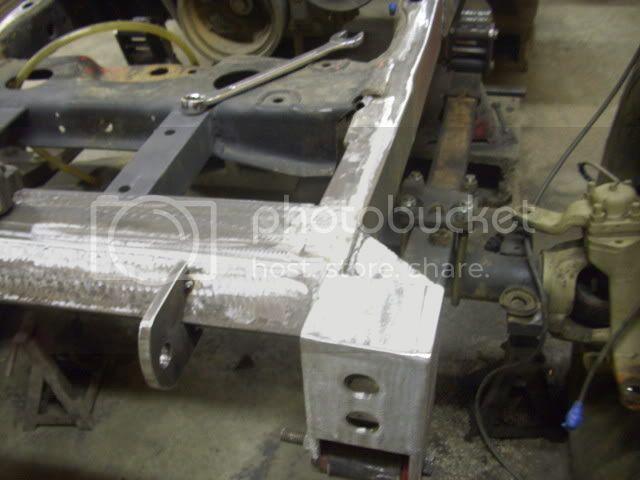

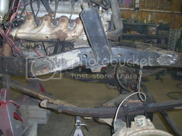

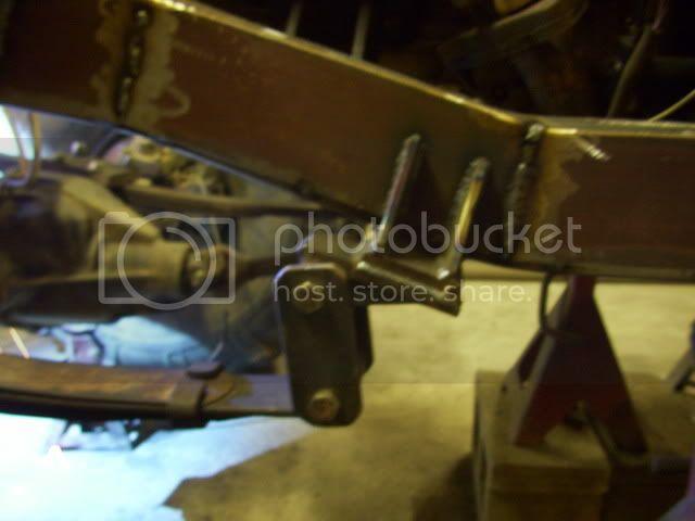

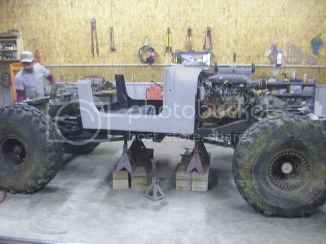

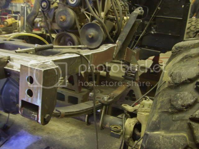

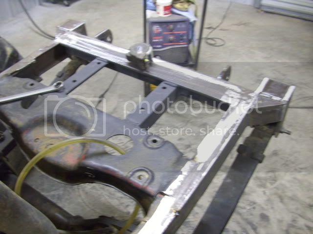

The jeep is rolling again.. Frame is plated. Lack alil bit of welding still in the front before we move on the finish the rear.
Im picking up my airshocks this weekend and hopfully by the end of next week... cage chould be taking form. :driving: :driving:

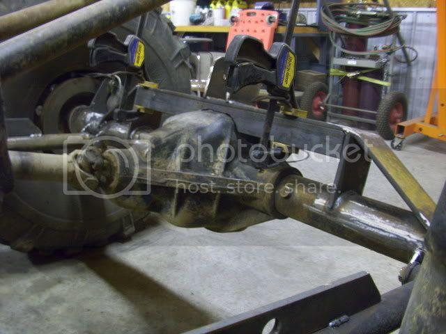

Still got alil bit of welding to do.... Picked up airshocks, disconnect steering, and getn my grill tomorrow. :woot: :woot:
