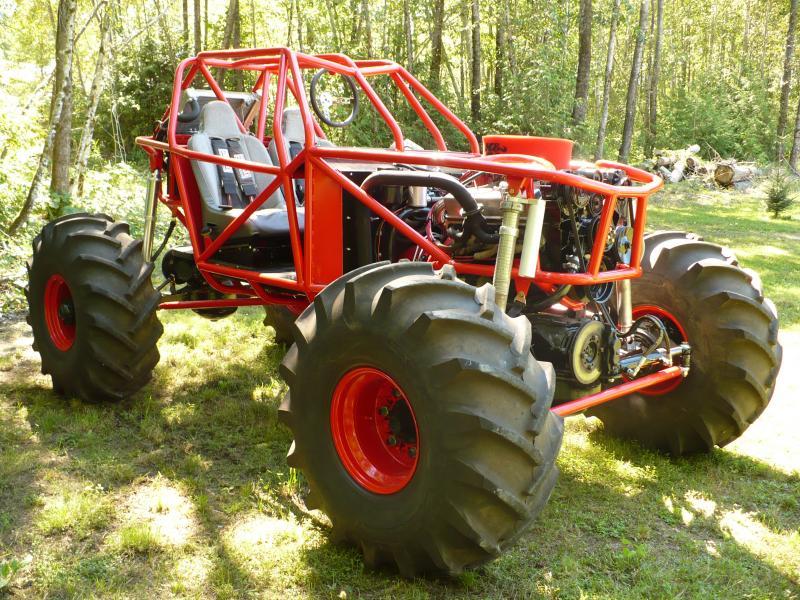

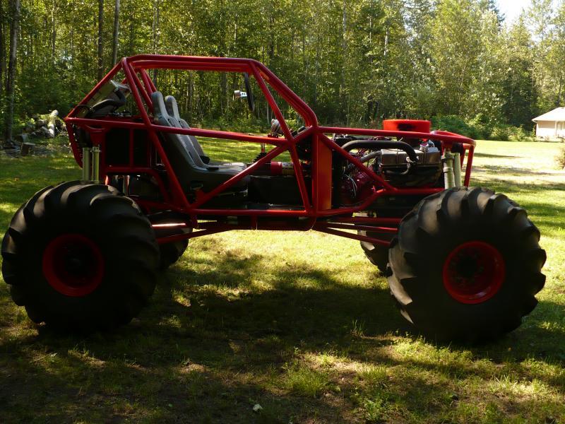

I finally got it running but not with efi, I put the carb back on it temporarily because there were too many wiring issues to deal with while working out the bugs with the chassis. I will get the efi going over the winter. It freaking screams now that it weight 2000 lbs less than the old rig. I do however have heat issues. I think the heat can be solved with a bigger radiator and a fan shroud. All in all I'm thrilled with how its turned out, now I just need to put springs on the shocks and a new radiator and wheel it!!!:D

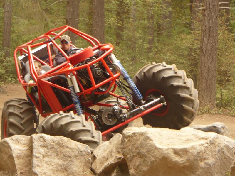

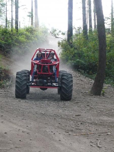

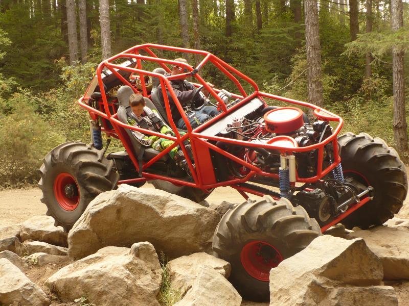

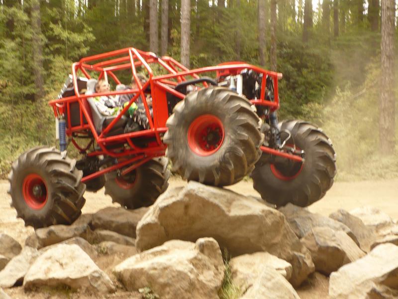

Saw you out at Tahuya yesterday. I was in the silver TJ on 40's, waved at yah a few times. I saw you rumble all over the place but never saw you actually hit anything. How did it work?
It went pretty good for a shake down run. Had some overheating issues thanks to a faulty electric fan relay. Rediscovered why carbs suck so much for actual trail riding:mad:, I have to get my efi working and I really need to add a rear sway bar. All in all it was a great time, met lots of good people out havin a great time. Kinda slacked on the pics but here are a couple.:beer:
