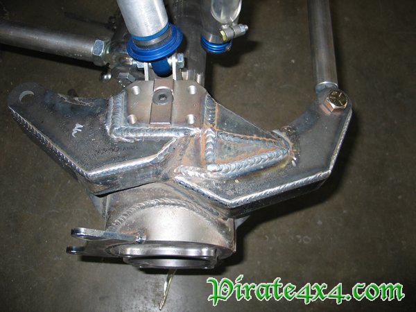

Sarg how far from the kingpin/bearing thingy's on your C's is your tierod mounted? Mines pushing 10" to the center of the hiem to get the tierod to clear the front pumpkin. Can't run real highsteer do to the radiator and frame at full stuff.
I think mine is 6 but it clears the top of my nine just barely and thats with high steer.
Yeah I'm not sure if I like how long the arms are but its either that or bend the tierod which seems to be a real dumb thing to do.
My gut feeling is it will be ok with the arms and when I tie it into the stock steering holes....especially be ok once I get the new fab'd knuckles done.

Looking at the 60deg steering stuff TC is doing I'm guessing they built the forward arm pretty close to the same as what mine is.

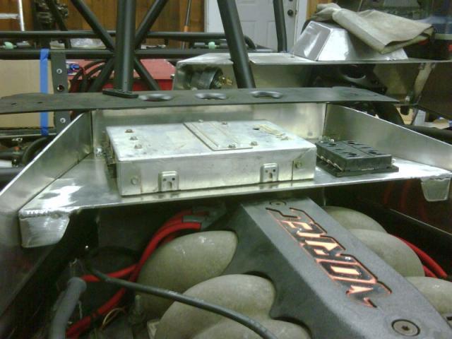

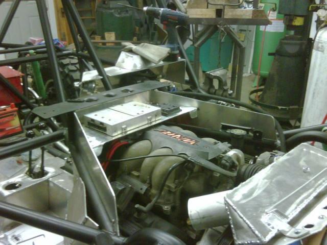

Spent a bit of time on it. Can't decide were to mount the wiring and the computer. Trying to keep it tucked out of the way.
Thinking something like this will do the trick.

That should be good for the ECU, but what about getting at the distributor? Is it easy to move that peice? Did you insulate the mounts w/ rubber to reduce shock/vibration?
4 bolts and its out. ECU is just sitting there right now, still need to work on its mounting.
Once the distributor is set you don't touch anymore except to change caps/rotors and wires, so it shouldn't be a big deal to have it up there. I'm a bit worried about heat so I might wall it off from the engine and and some air holes from the sides and through the back fire wall.
hmmmm... How sealed is it going to be around the computer pook? My one concern is heat. Thos ecm's are gennerally in a hot area but not directly in a heated area. There is going to a TON of heat coming off that plenum and up onto the computer...

Make sure its finned top and bottom...
Yeah I'll probably ditch the tray thats in there and make more of a tab setup or put it on rubber spacers.
I am also thinking that the new box might allow it to be attached in the interior out in the open since it will be in a sealed box barely any bigger than the stock tin one
ANother thing to think about and you meantioned it. Those series of ECM's have never been known to take alot of vibrations (early ones in cars VERY BAD) and have been known to break solder joints and fail... So if you can damped the vibrations the better off you are..... Granted some guys have just thrown screws in them and been ok, But I have seen them fail...
