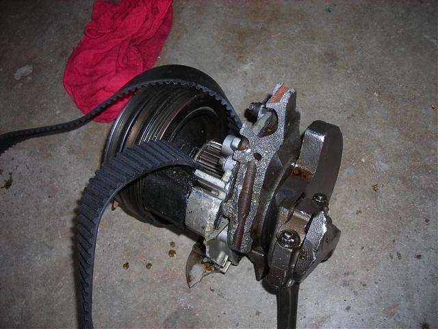

That pic you have there shows some serious neglect. That doesn't happen like " I was sitting at the stop light in my well taken care of 3.0 and boom"
No that story usually is preceded by "I pulled RIGHT over" :rolleyes:
