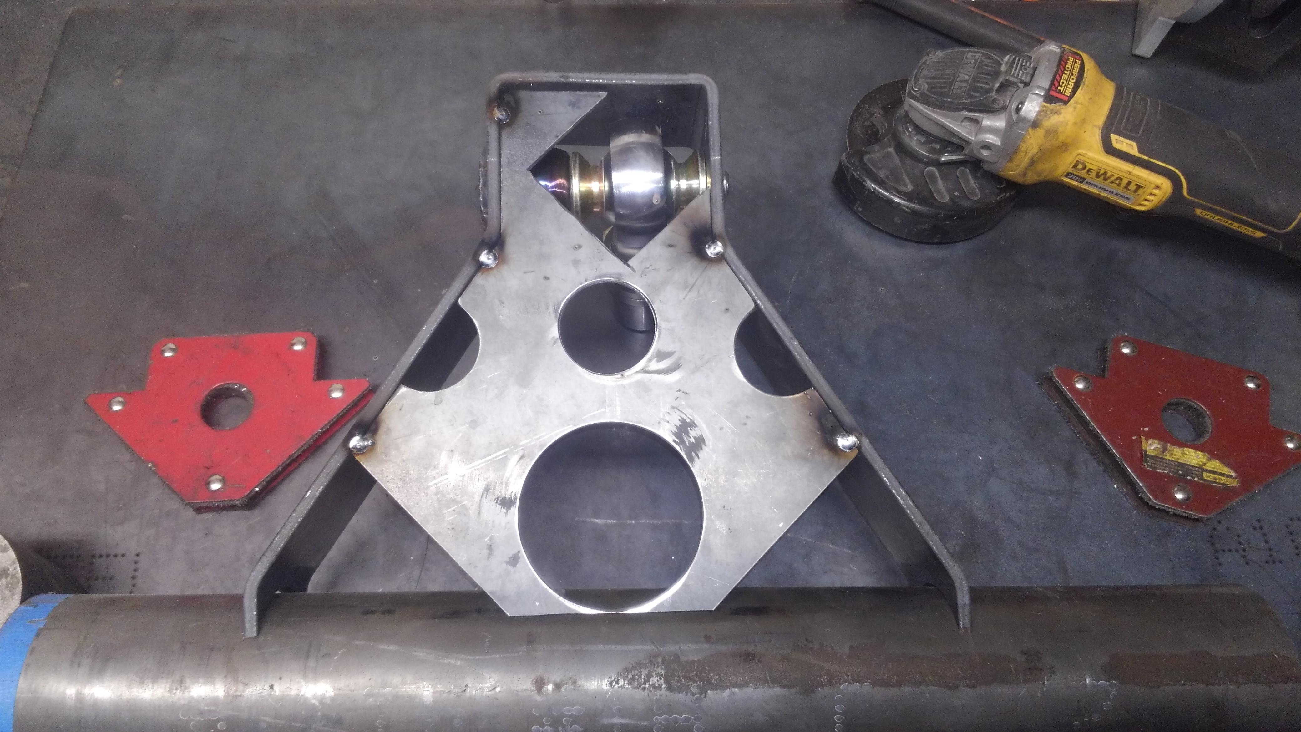

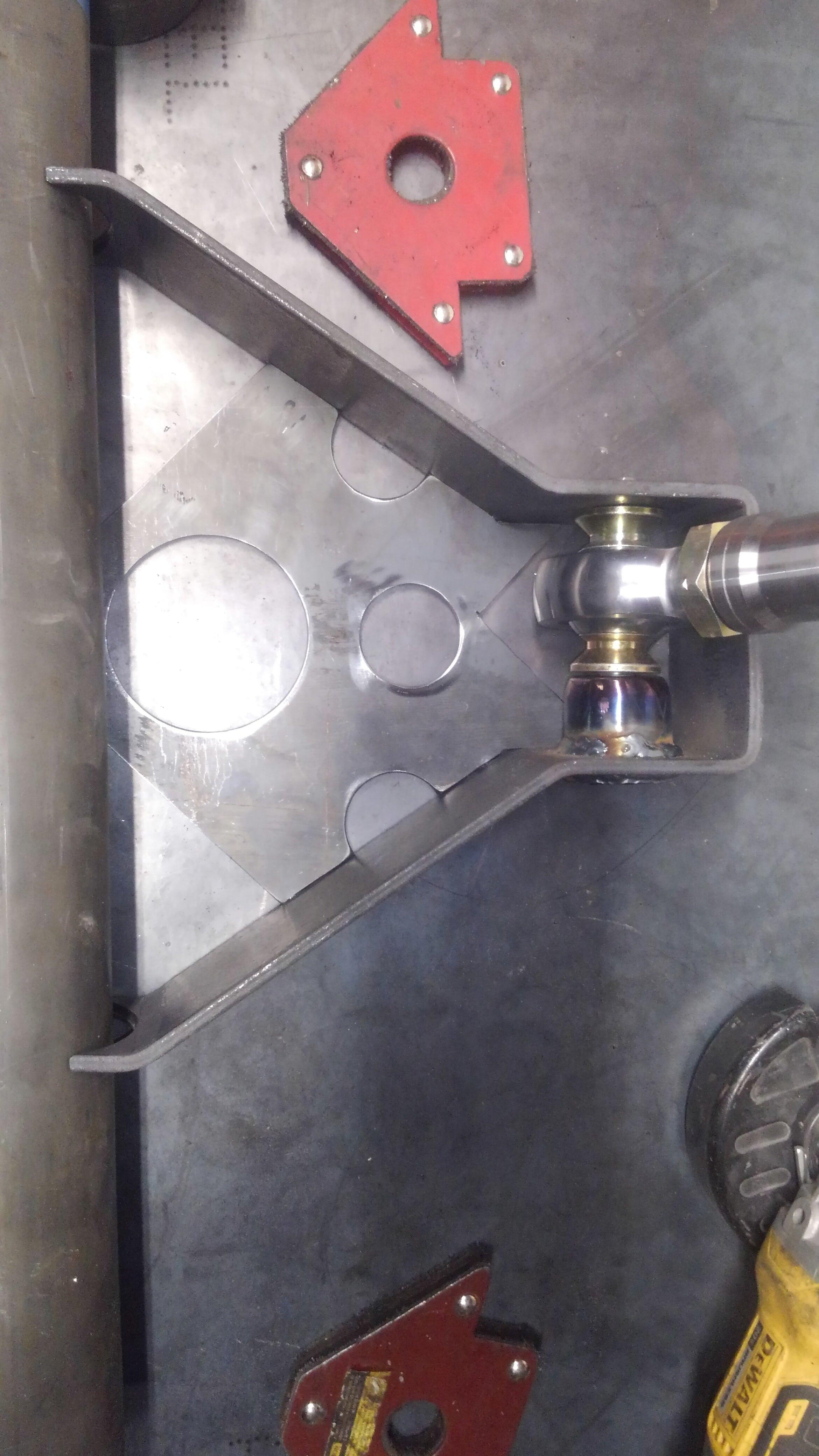

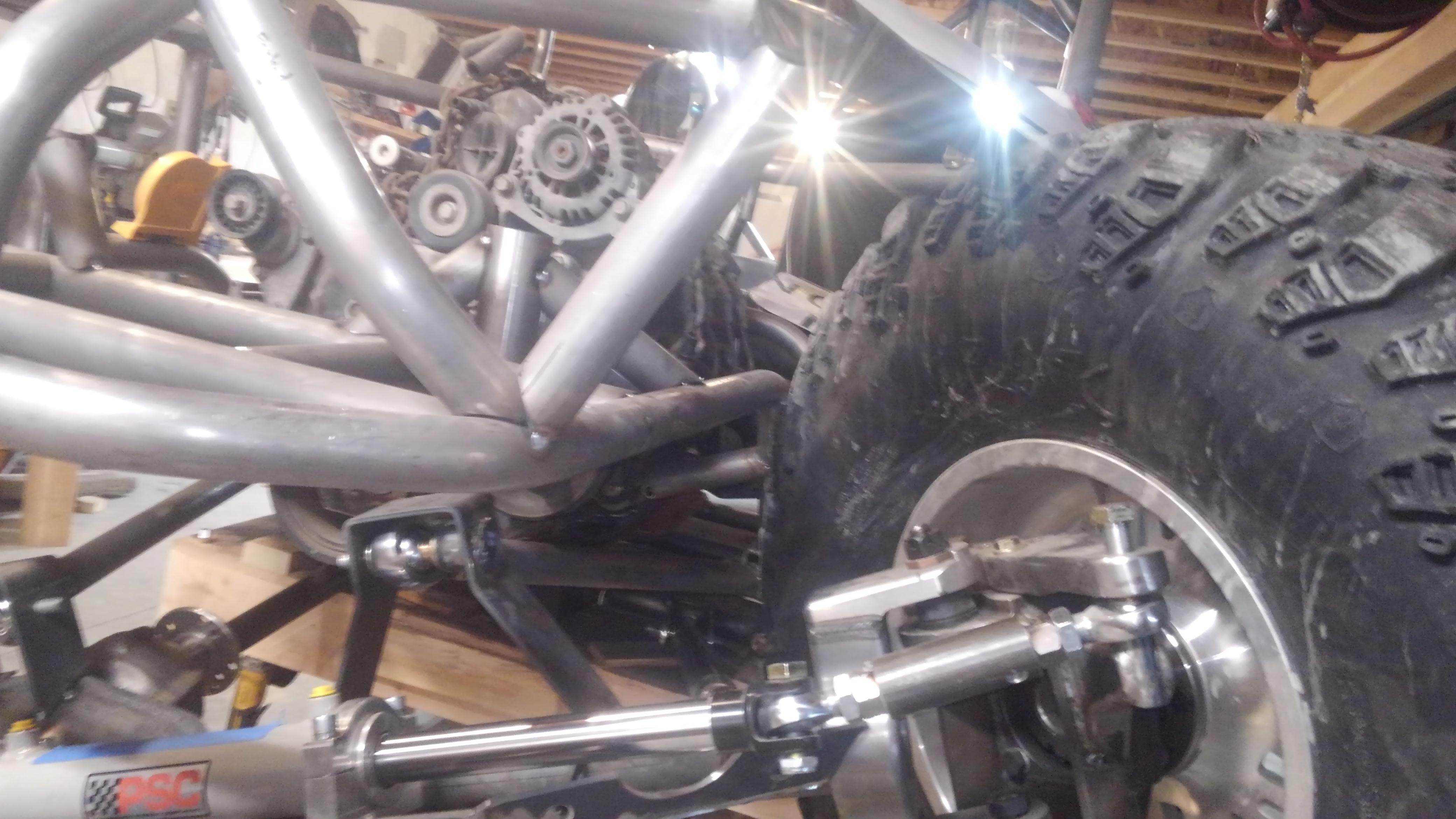

One of the front axle link mounts, will have panels on both sides, bump stop pad on top. Overkill or should I add some bracing somewhere?

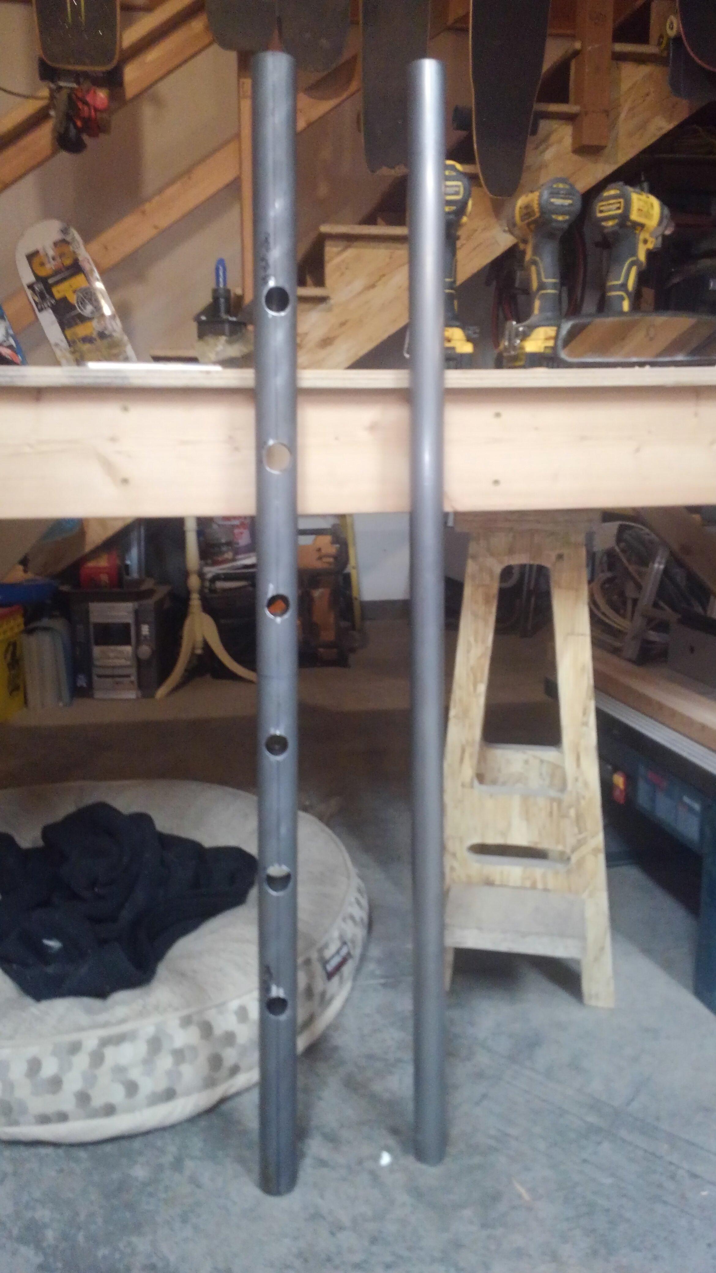

That plate with huge swiss cheese holes in it is not really doing much anymore.
I'd put an internal web of something a bit more substantial if you're using it for bump pads and you're a frequent flyer.

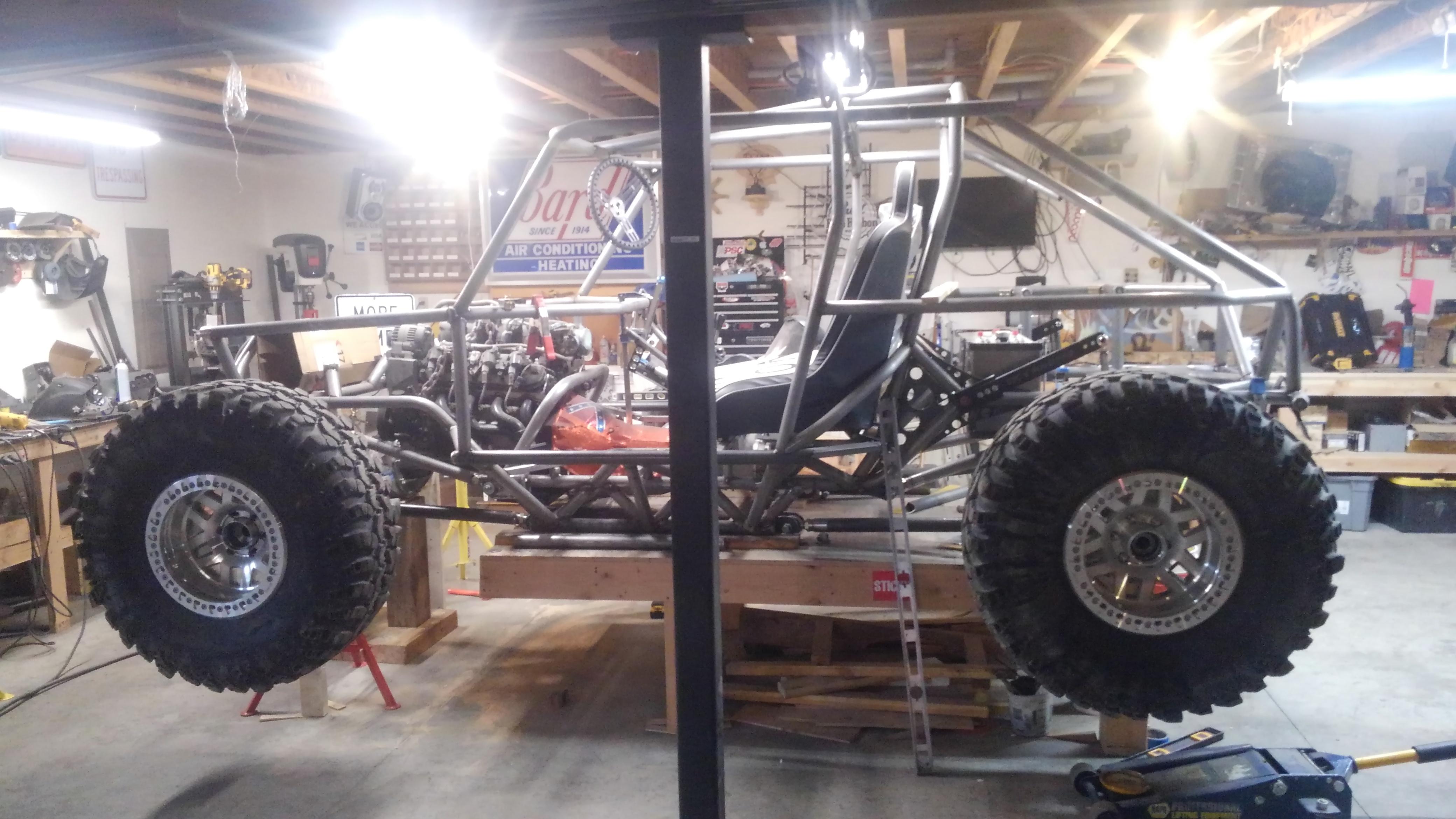

but stuffed I'm getting into the fender and the upper bar, I think I can lower my bumpstops an inch and a half with 4 inches uptravel and be ok. We'll see this week
