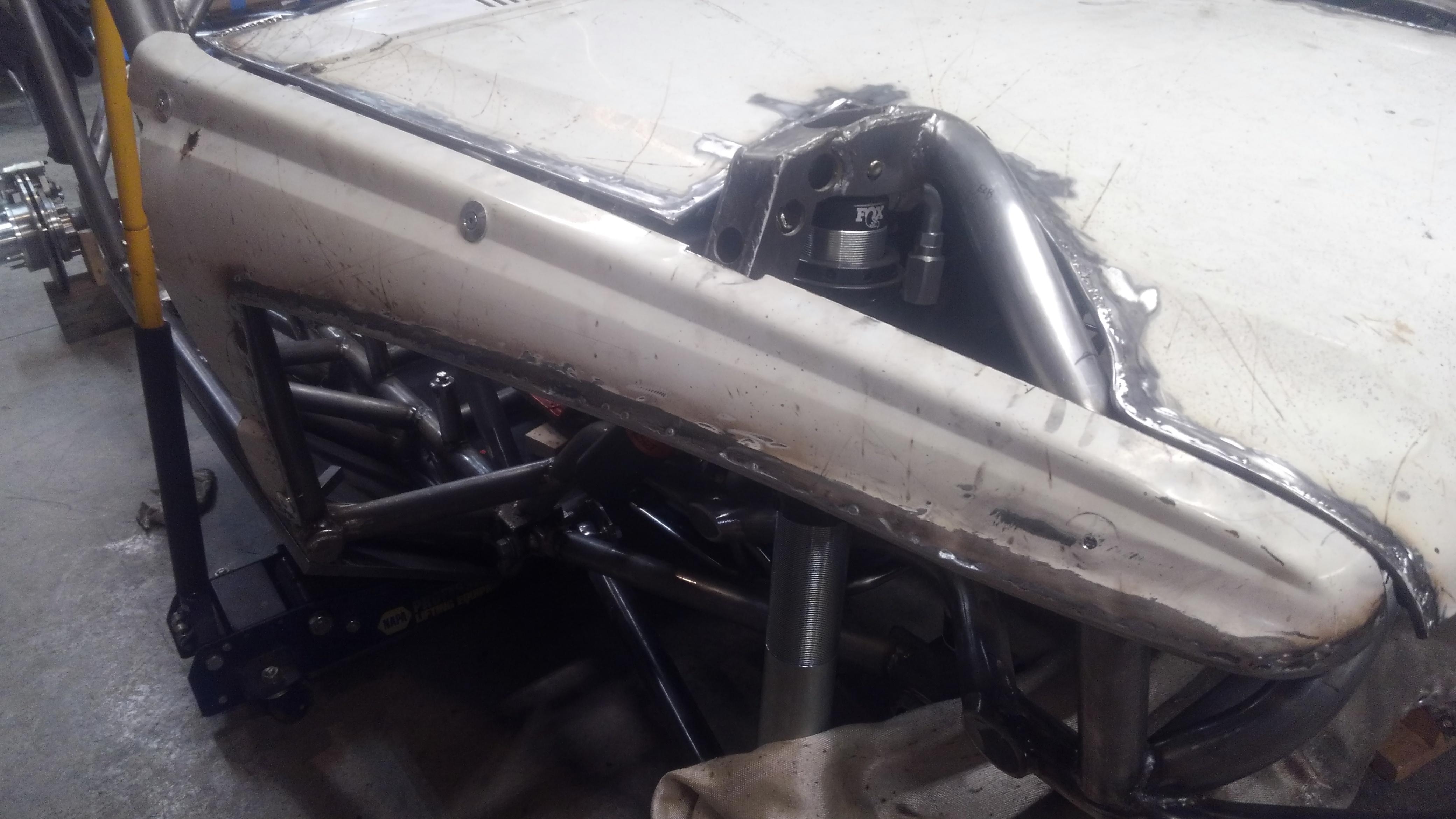

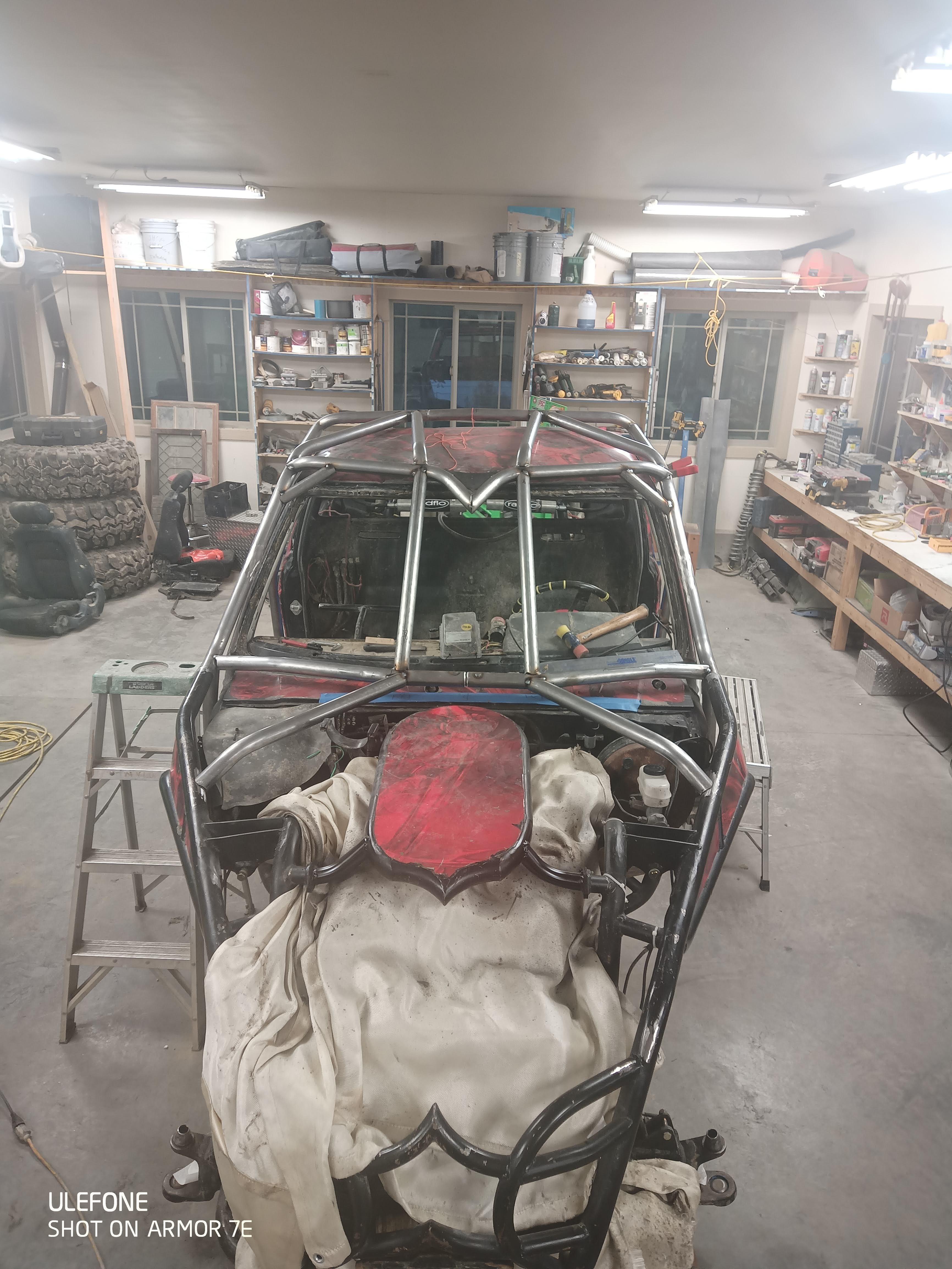

Waiting on the new flexplate to show up that I overlooked, so I decided to trim out the fenders and hood. After having a hood with sharp edges and no reinforcement forever, on this one I wanted to trim out all my cut edges. I centered 1/4" rod to the sheet and tack and tacked and tacked and tacked..... You get it. I'll clean it all up with some metal filler at some point

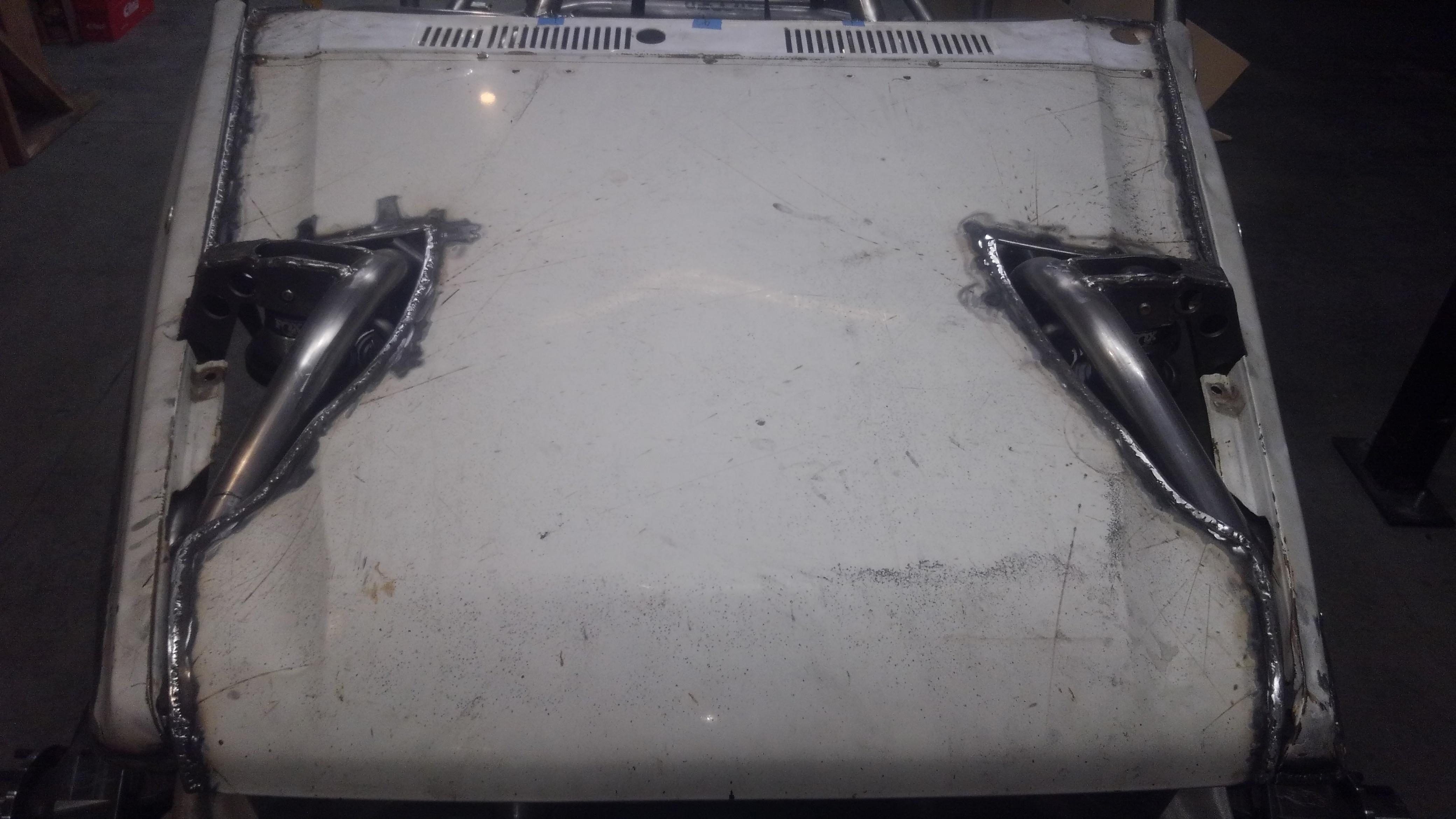

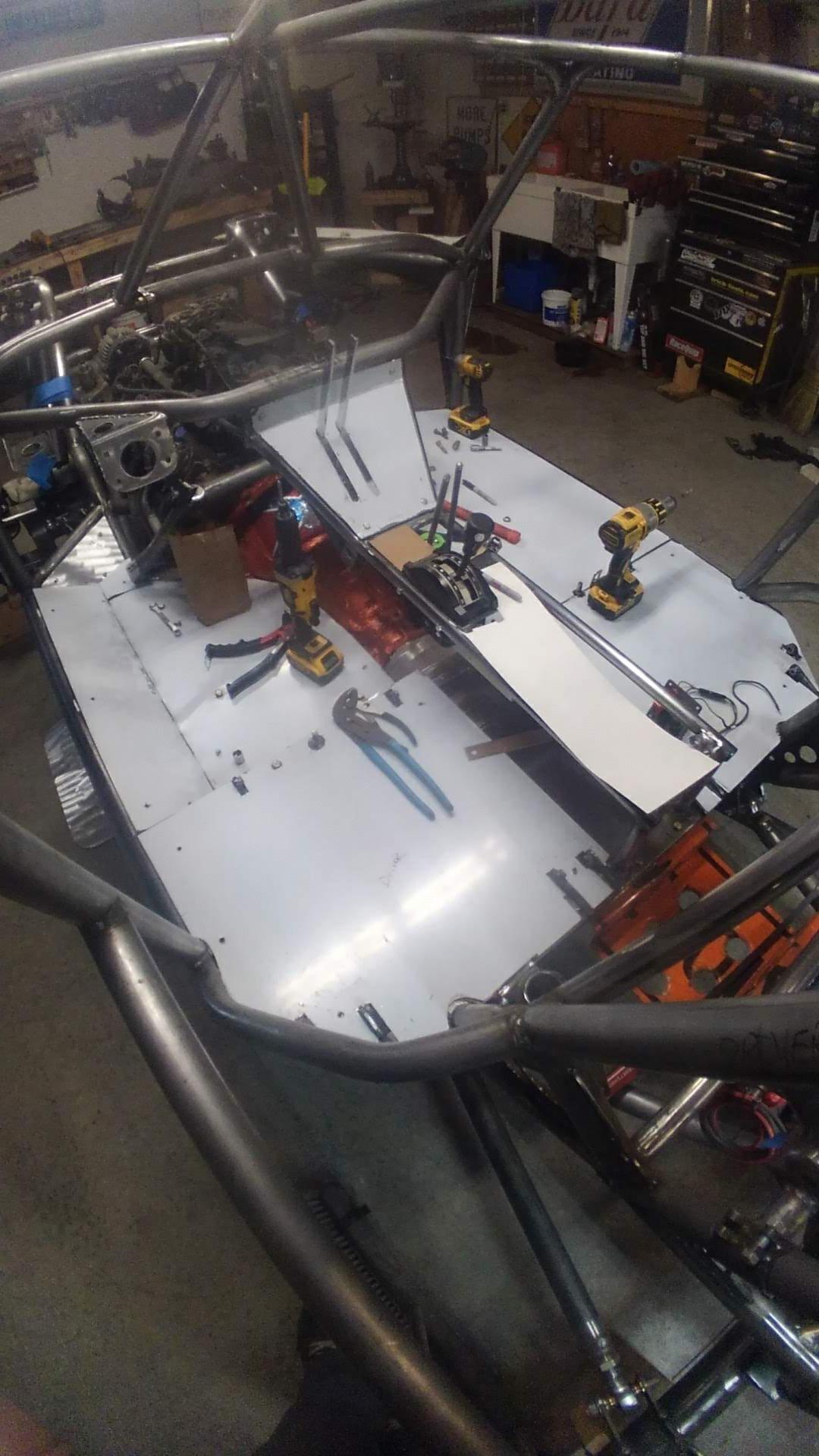

Don't know how I missed the hood pictures from the end of December, but the hood and floorplans look like super fun projects.
