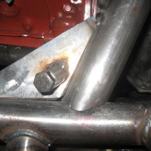

I'm not sure if you want or need to. But I took off quite a bit more of that radius arm mount then you when I cleaned up my chunk. Took off the rest of that mount on the top, pretty much bringing it back to looking like a normal chunk and it still seems plenty beefy. I'm doing the same thing except going +width with 550 knuckles HOPEFULLY, I'm broke and can't get the ones from Pat yet :'(

My thought is leaving that section of the casting will add strength to the housing........maybe, maybe not. If my Truss interferes, it will have to go. We shall see.

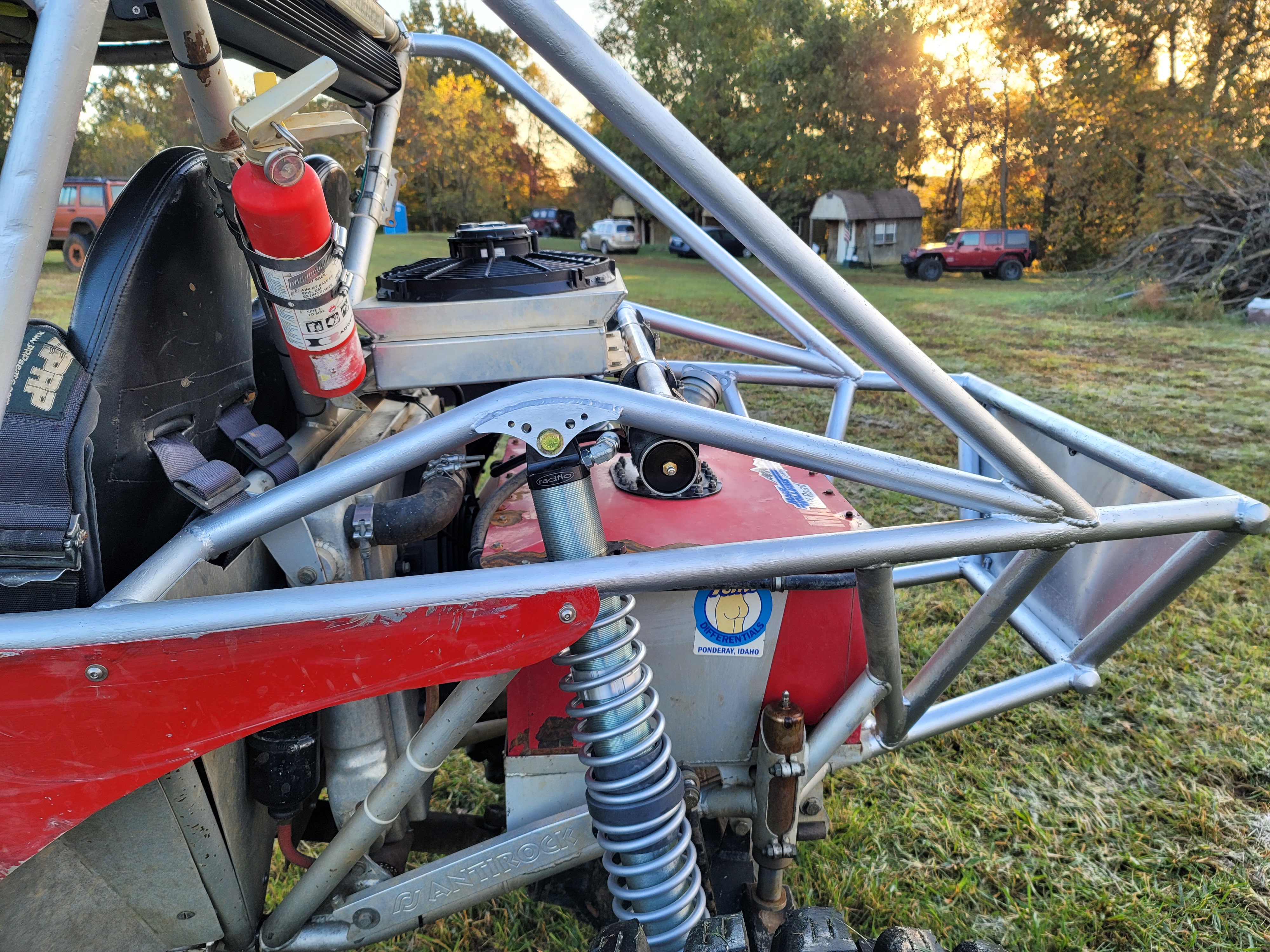

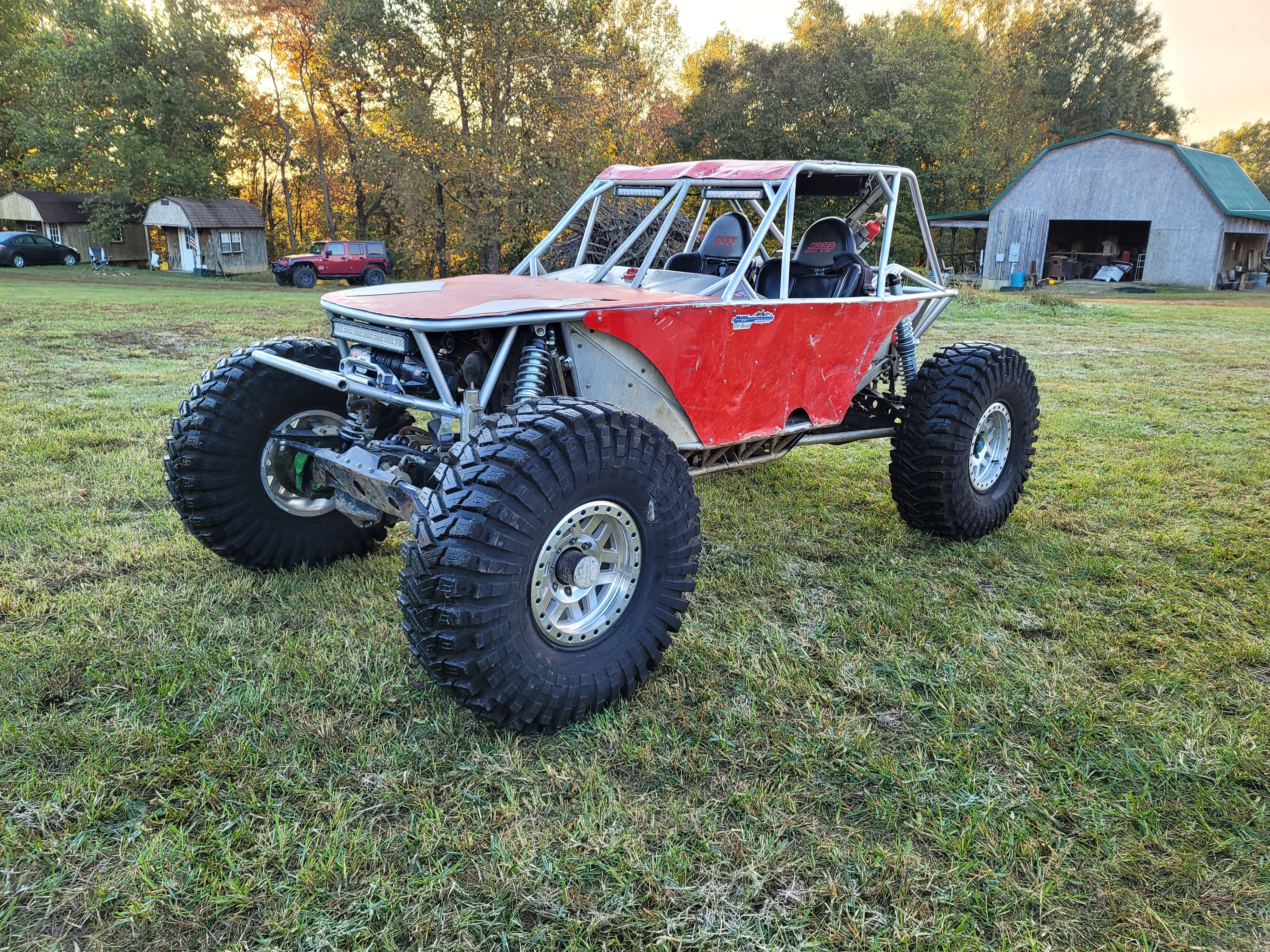

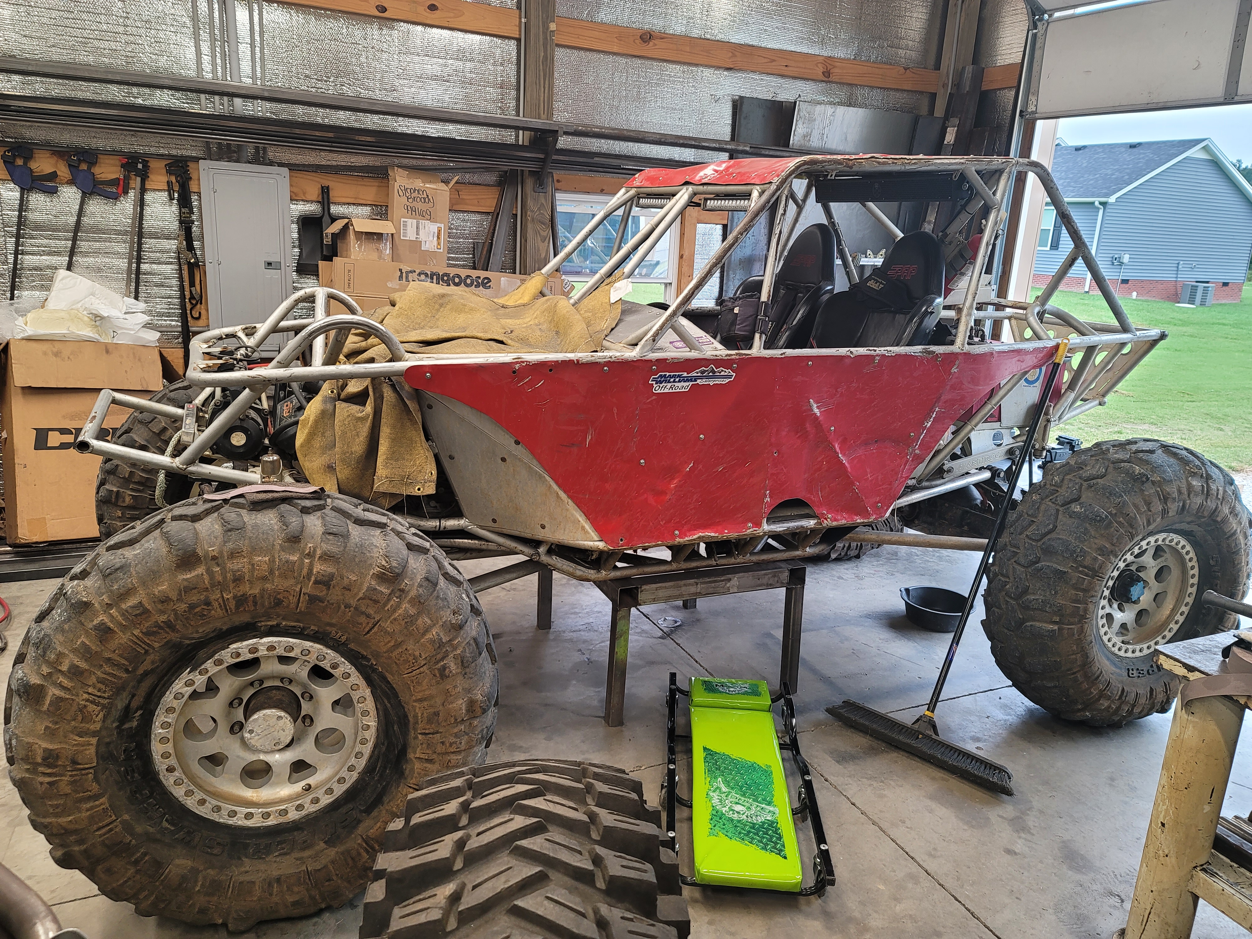

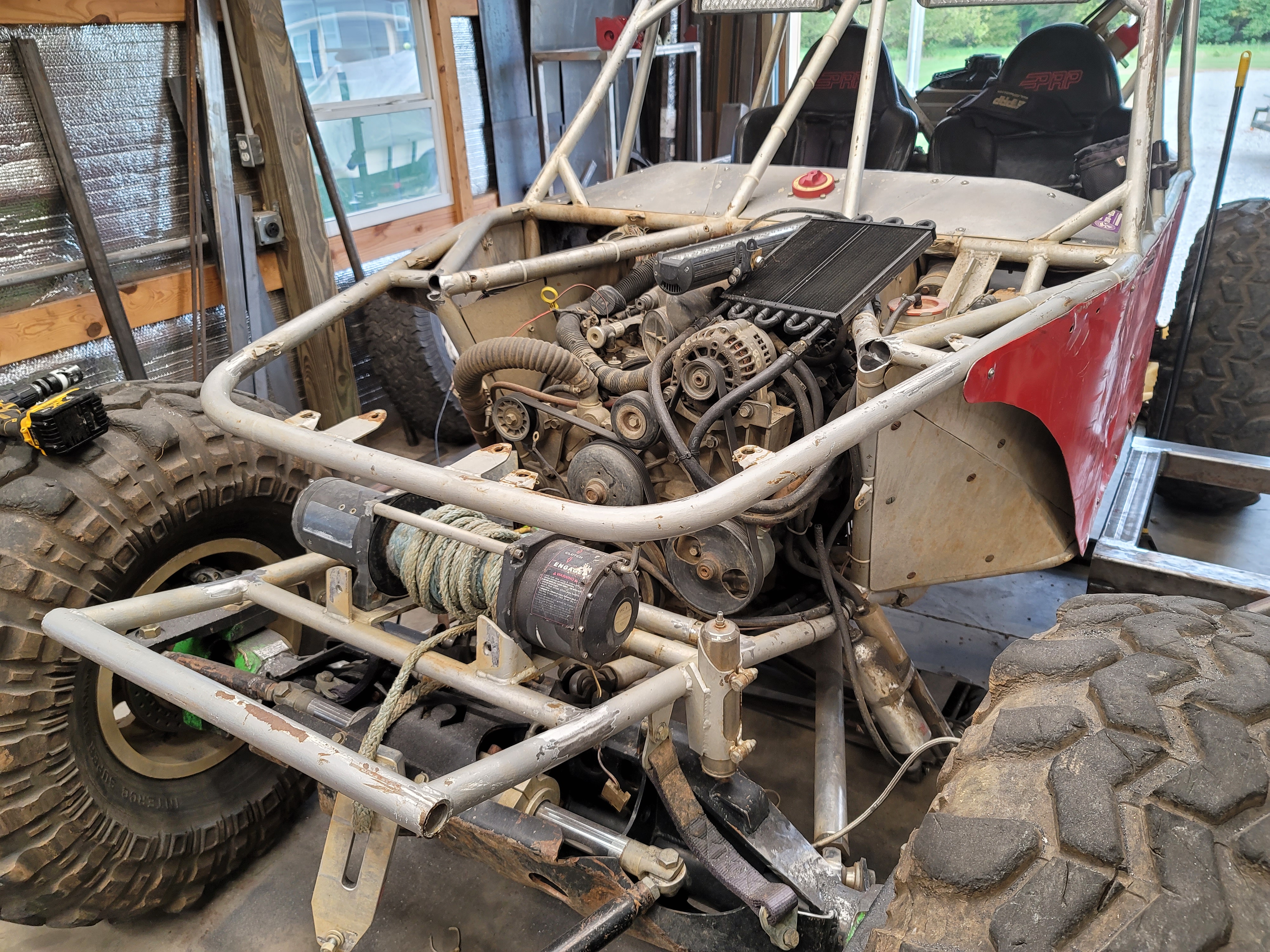

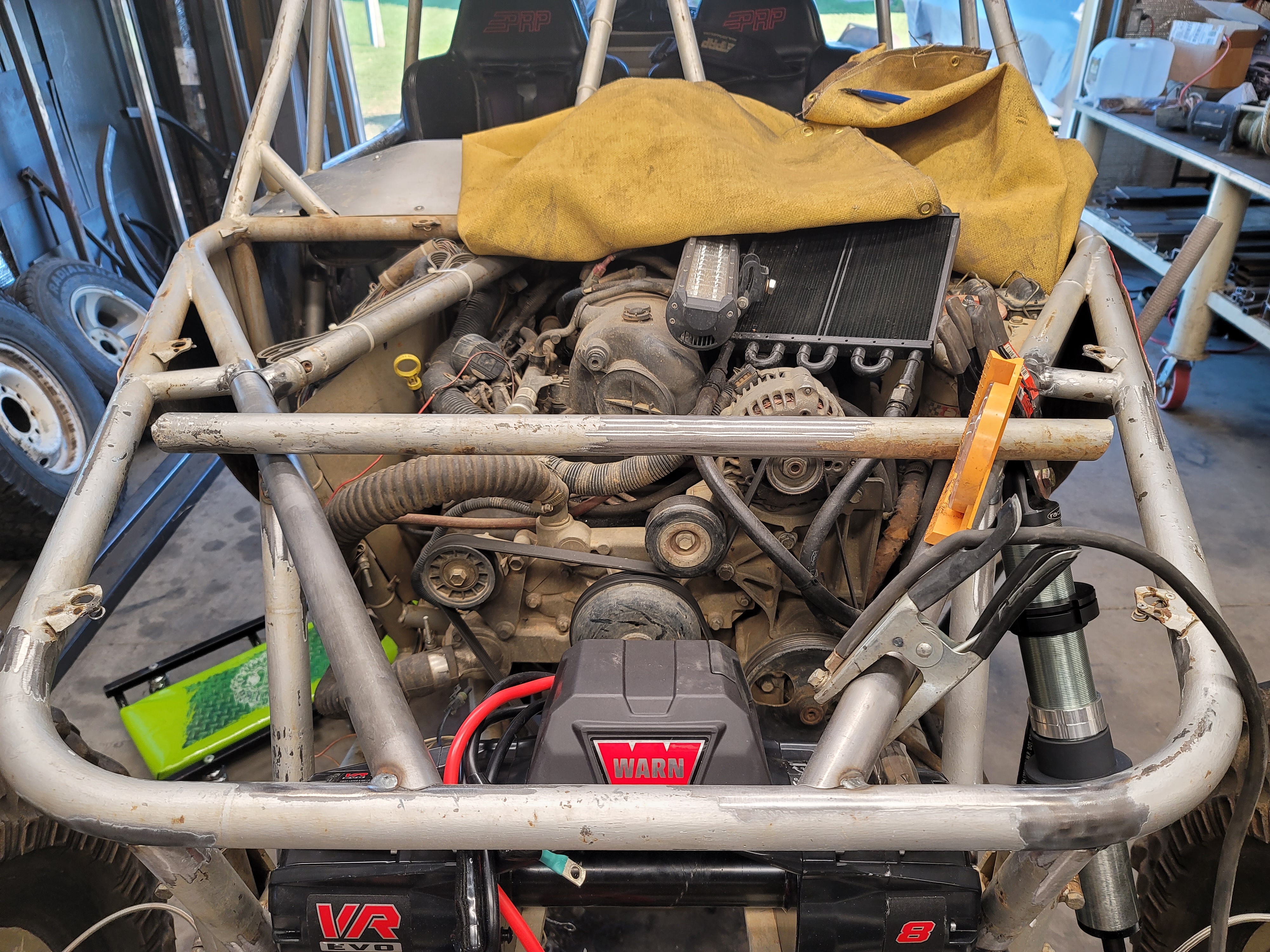

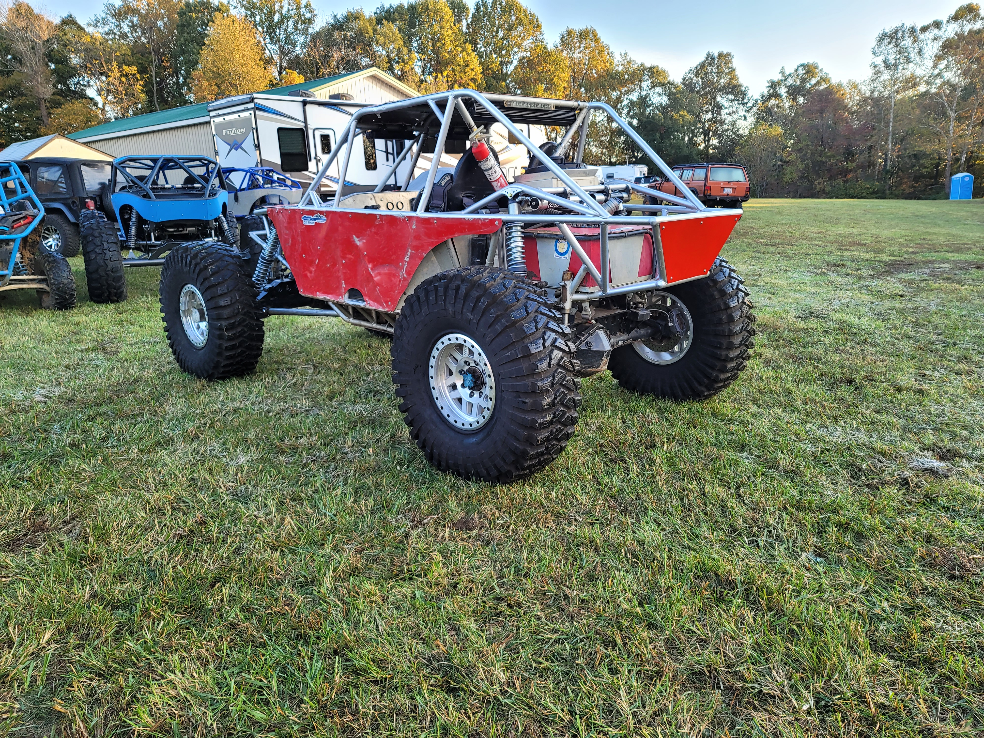

Haven't kept up with this thread. Lost a ton of pics bc of photo bucket taking a ****. Anyhow, recently sold the buggy to @smbroady82 . Did some upgrades as part of our agreement. So I'll share those.

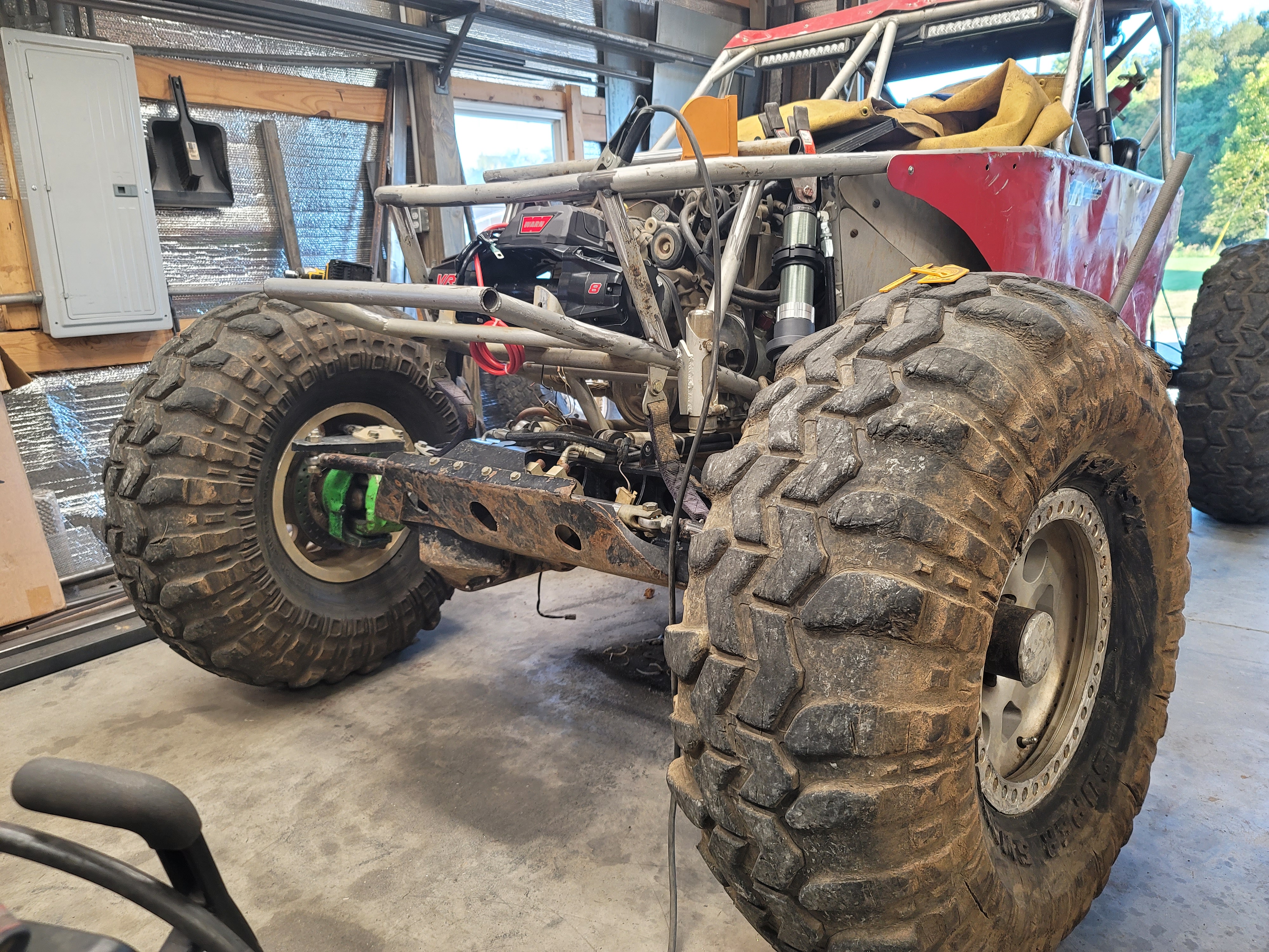

In surgery, this gives you an idea of how things were before. Main change was adding 2.5 radflo coilovers.
