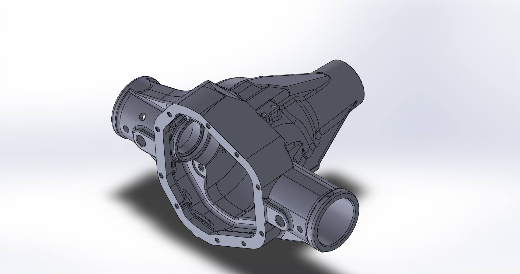

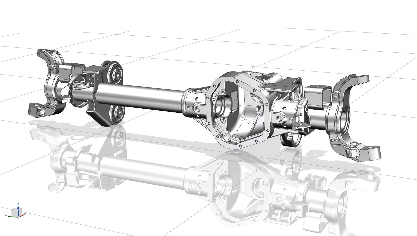

Dunno what your plans are for a truss, but we have OEM cad data for that axle, it would be super easy to whip out some profiled plates and you fill in the rest.
