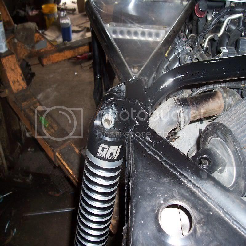

Lookin damn good man, that thing is a rockstar !!
I drool at that pillowblock, I need one of those so I can straighten out my front 2pc and get some more wheel travel one day outta the front end drool
Re: 555 repair report
you know how well spray paint goes on chrome. that's what was funny, in the pics you can see the paint flaking off the chrome pillow block. need to polish that part back up. wyatt, all we need to do for lubing is drill a hole and tap to 1/8" NPT and put a zerk in it. just need to line the hold up with the grease ring on the outside race of the bearing. :woody:
