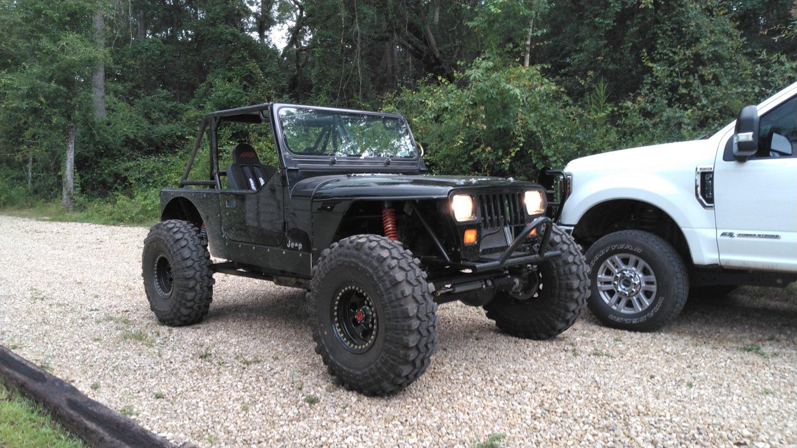

Finally got around to getting it weighed today at the local landfill. Not certain if the scales are certified on a regular basis, but I drove onto the scale twice and the weight came back the same.
Did some research on the internet and based on the information I found, my Jeep (1995 YJ, 2.5L, RH30 (904), soft top, no A/C) from the factory should have weighed at 3197 pounds. If you have read through my build you will know that I was trying to keep weight at a minimum. I removed the heater core assembly, all the evap crap, ditched the tailgate, ditched the fenders and hood for a fiberglass hood, trimmed a bunch of sheet metal in the rear, etc.. I have the same drivetrain combo but I added an Atlas II, three link front, 4 link rear, 14" coil overs,38" SX on Allied beadlocks, etc...
Based on the scale reading..... my Jeep weighed in at 3440 pounds. While it's not the target weight I was shooting for, if you do the math you will find I only added 243 pounds. I guess to get to low weight numbers you really need to go with a chassis.
Quick shout out to Ryan @Accutune....Dude, the setup / tune you did on my coilovers is awesome. Took the Jeep on a 50 mile cruise through some of the local back roads that have quite a few sharp corners. Hit all of the corners fairly hard...very little body roll. Currently not running any sway bars. Next big test will be middle of October at the Swamp. Hopefully I will be meeting up with 1TonyJ and Flatland FSJ to see how it does.

Pretty sure your tires and wheels make up for more than the added 243 pounds.
I'd say it's "lighter" than a stock YJ.
Just looked it up, your tires are 82lb each. stock 215/75r15 tires that came on the wrangler are ~25lb each. So there is 228lbs...
Then one of your beadlocks weighs as much as all 4 stock wrangler wheels :cool:

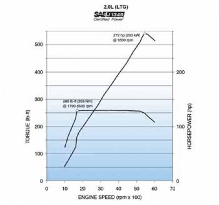

2.0 LTG from the ats/malibu/camaro is the only 4cyl I would swap to. Almost 300 hp stock and capable of dam near 500 with some stuff from ZZP. Quite a few adapters out there, its the go to for the werock buggies and was the go to for sandrail stuff for a loooong time.

Look at that stock torque curve (line? plateau?)

Well... never knew about these motors or the popularity of them. Definitely will do some research on these. I would be happy with a stock motor if it is capable of near 300 numbers.

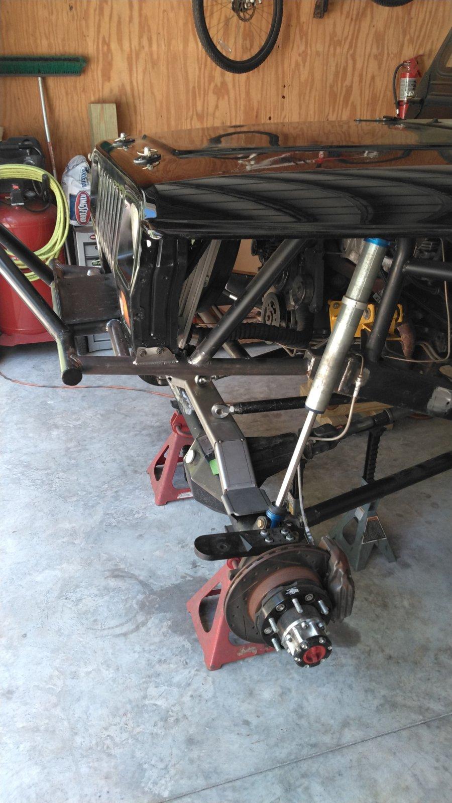

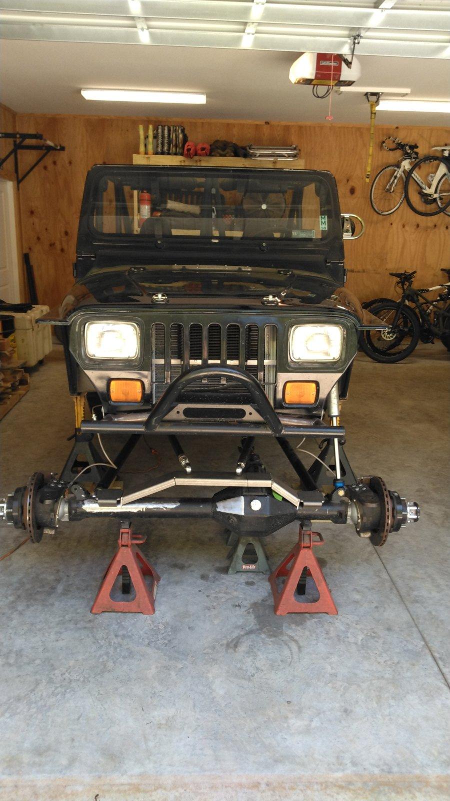

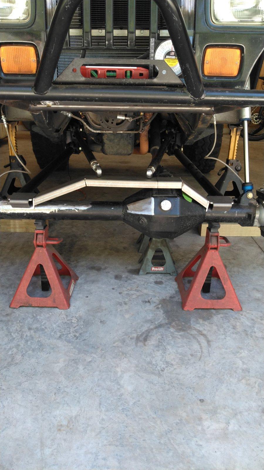

Currently re-doing the front end... changing from a 3 link to a 4 link, pushing the front axle forward 3 inches and going full hydro with a DE ram. I will get some pics up later today.

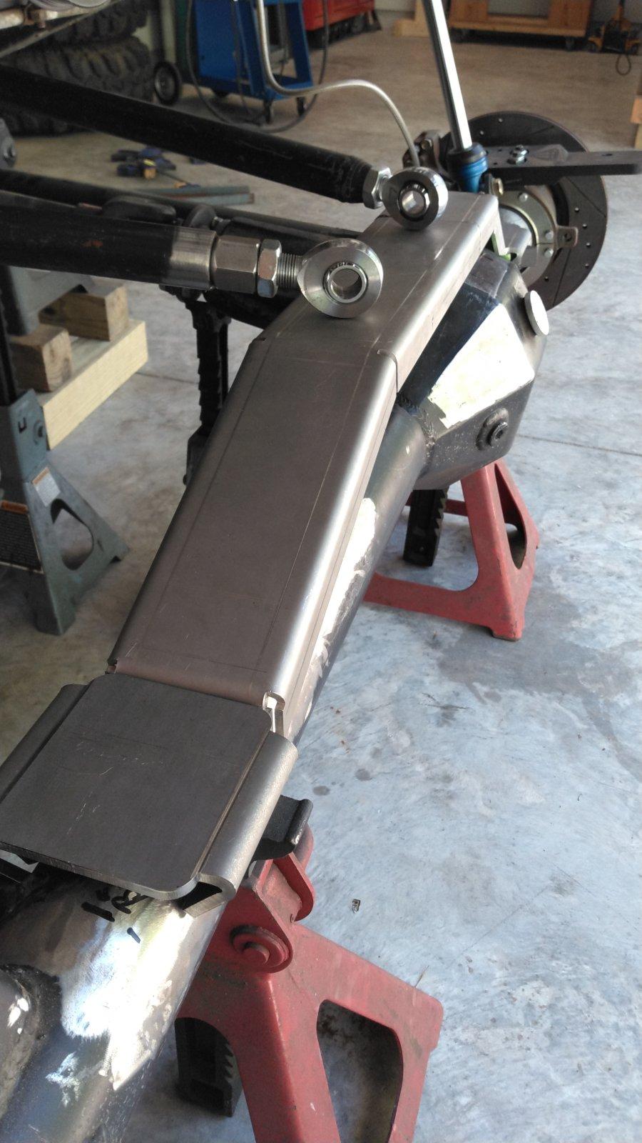

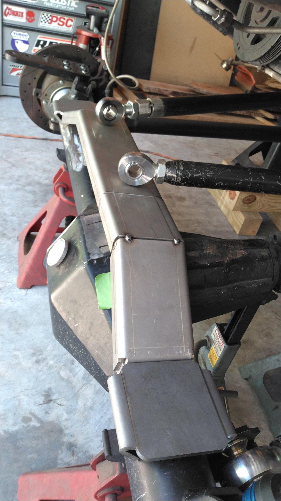

Got the truss fitted today along with the landing pads for the bump stops. Truss still has to be plated on the front and backside ...
