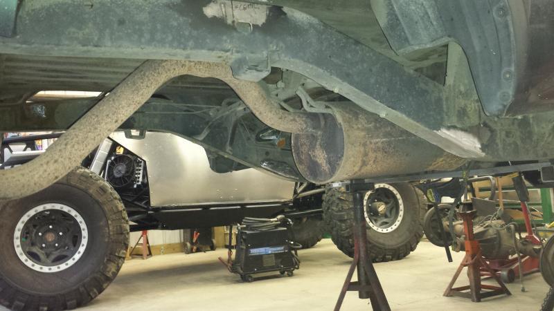

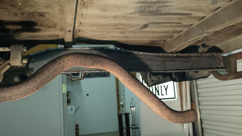

So with the kit you also must toss the stock rear crossmember(bolted in) that used to hold the spare tire. Way back when I built the rear bumper I added a receiver and tied it into the crossmember. Well thats gotta change.

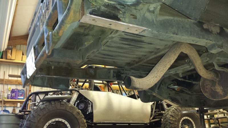

For ease of removal I cut the member out in 3 pieces. For the center I lopped off the top of the receiver. Worked like a champ.

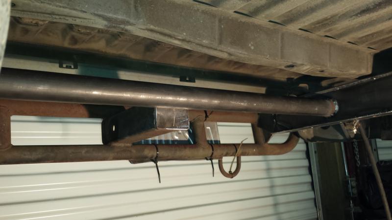

The kit comes with 2 pieces of 1.5" to add a cross member back where the old one was and the front will be for shock mounts. I simply tied the reciever into it--now its super strong.

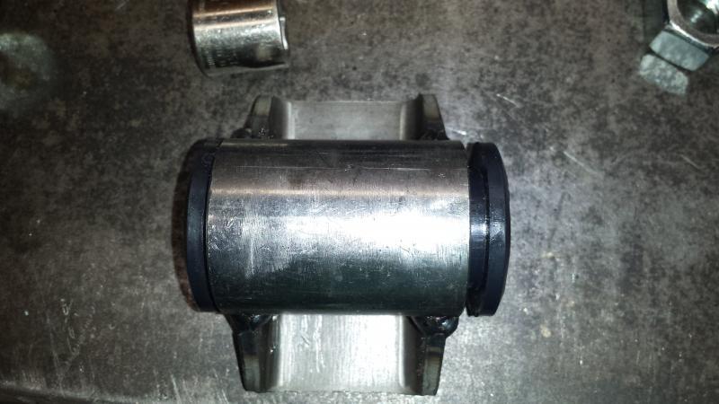

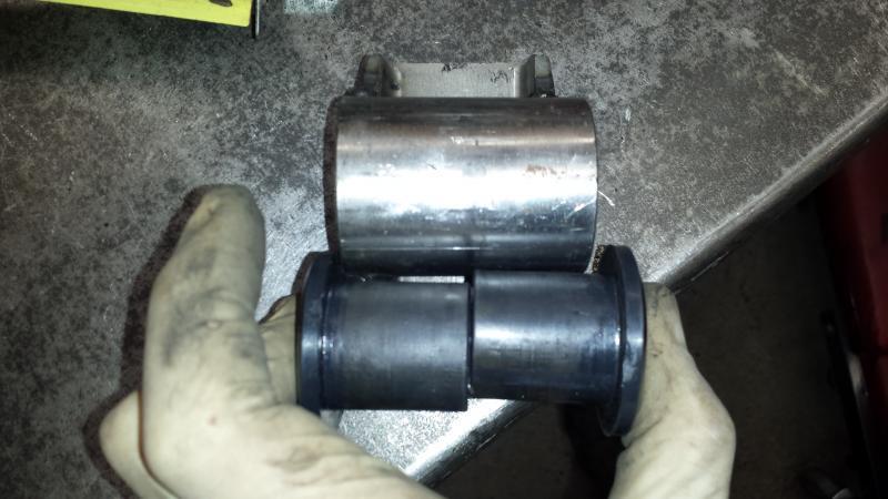

Something I found was the bushings too long for the shackle mount. I just shaved down one side to get a perfect fit.

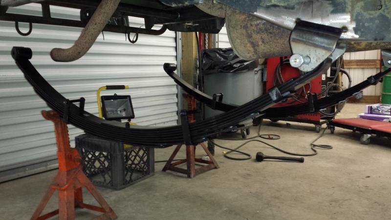

Working on getting the rear end setup.
They called for 90 degree shackles but I ran them at 10 degrees.

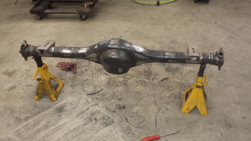

Perches burned in and I stripped the housing of all brackets... Love doing it to where ya never knew anything was attached to it.
