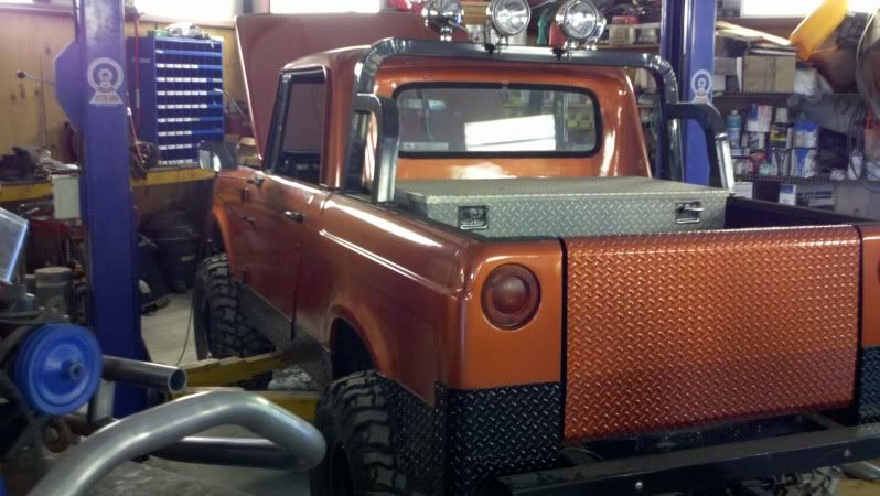

Ive been helping Labronn out at CSC Fab on the side. A local guy from my hometown works for Zach Brown and asked if we would put power steering on his Scout.
After searching for kits and custom parts, we decided to use a kit from scoutparts.com. It was suposed to be a bolt on kit, but it never turns out to be just a bolt on kit.

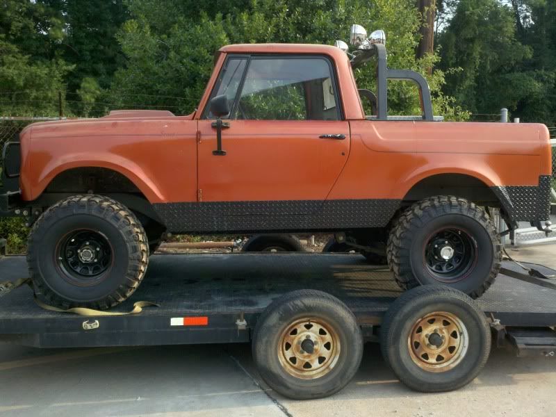

I went to his farm in Peachtree City to pick it up. Its a 66 Half Cab truck with a 80-90 horse 4cyl.

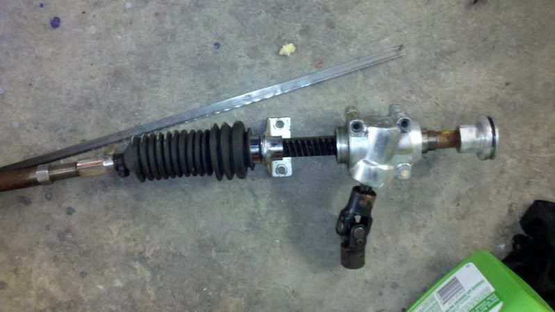

This is what someone used for steering...
It looks like a manual rack for a small hot rod or something

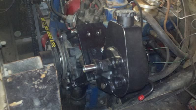

With the old steering rack out and the column removed, its time to put on the new parts

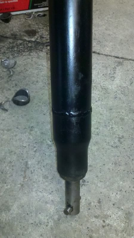

4 inches had to be cut out of the steering coliumn and rod
All welded back up and painted
Most of it is all put back together, I will post completed pics next week
