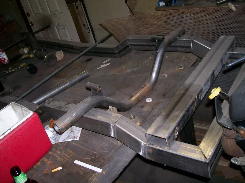

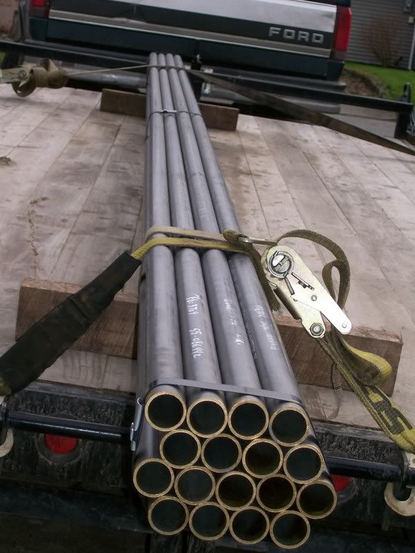

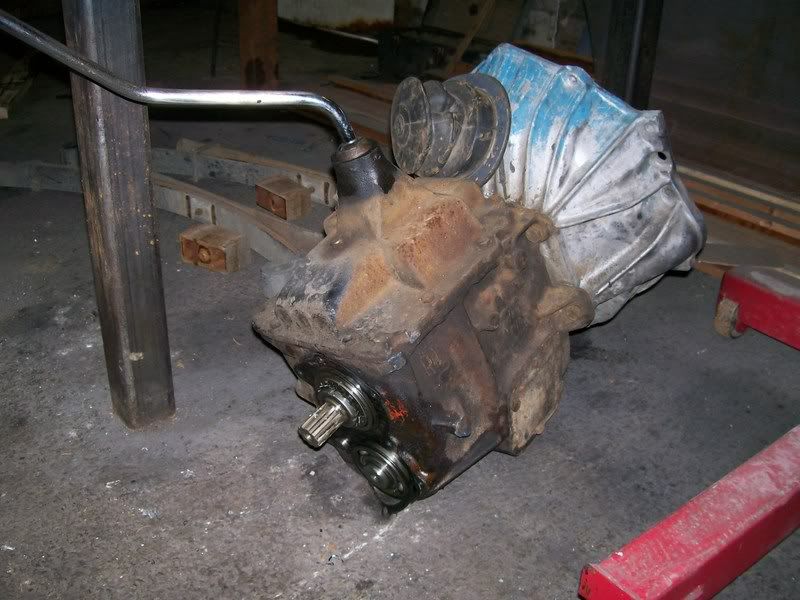

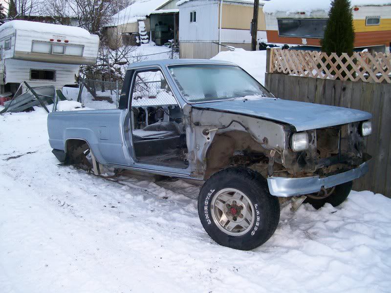

Alright anyone who's been waiting for this buildup thread, my much anticipated (to me ) 4 ruggy buggy is sorta kina underway. I still have some (ok, a lot) of parts to source/scrounge but I'm close to actualy start making it look like something. First off it's a "4 ruggy buggy" because I dont know if it quite clasifies as a truggy because I'm not using any stock frame, but I'm not calling it a full buggy because I am using a couple lil' pieces of a 89 4 runner. The basic build Idea is this. Square tube frame with much tube going all over in a asteticly pleasing and structural fasion. 4.3vortec, 465 trans, STaK4x4 2 speed case, f/r d60's, fox 2.0 coilovers all around because I broke 12 leafsprings last year. And the only reason I can come up with for buying another rig to start with instead of just building everything myself is I wanted a title
So here we go!
So here we go!
