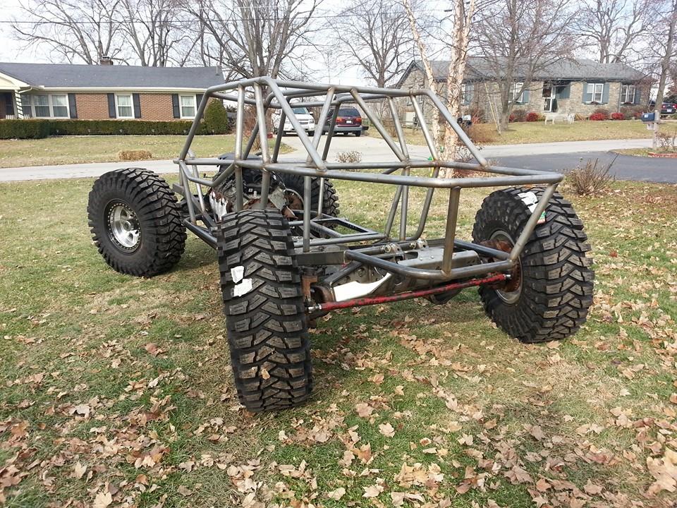

I actually did a little to it today... Bolted all the mile long drivetrain together and set the frame over it. Mainly to make it take up less floor space.
Looks like the exhaust will clear fine.

Re: Re: 4WS Trail-Buggy Build - Bent Fab EVO2
TBItoy said:
I assume you ground down or cut off the mounting "hump" on the 205?
How much where you able to take off, couple inches?
Yeah i think it was like an inch or so from the corner

I also tinkered on the axles a bit and figured out how to retain the stub shafts in the unit bearing, as the chromo stubs do not have snap ring grooves. I'm using 1.5" split shaft collars in behind the drive slugs to hold the stub in place. Since the stub will not spin separate of the inner hub, it'll work fine.
