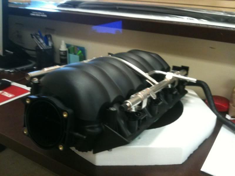

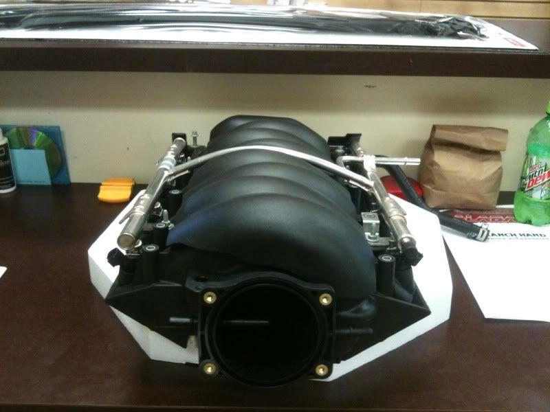

I know somebody wants this ;D
LS3 Intake, Fuel rails and Injectors
payne97 said:
is it better than a truck intake and how much lower is it than a truck intake
Not sure if it's better than the truck intake, but it is a lot lower than the truck intake. It's the same height as the ls1 intake that I have on my buggy now. I can't run the truck intake because it is to tall and hits the hood.
