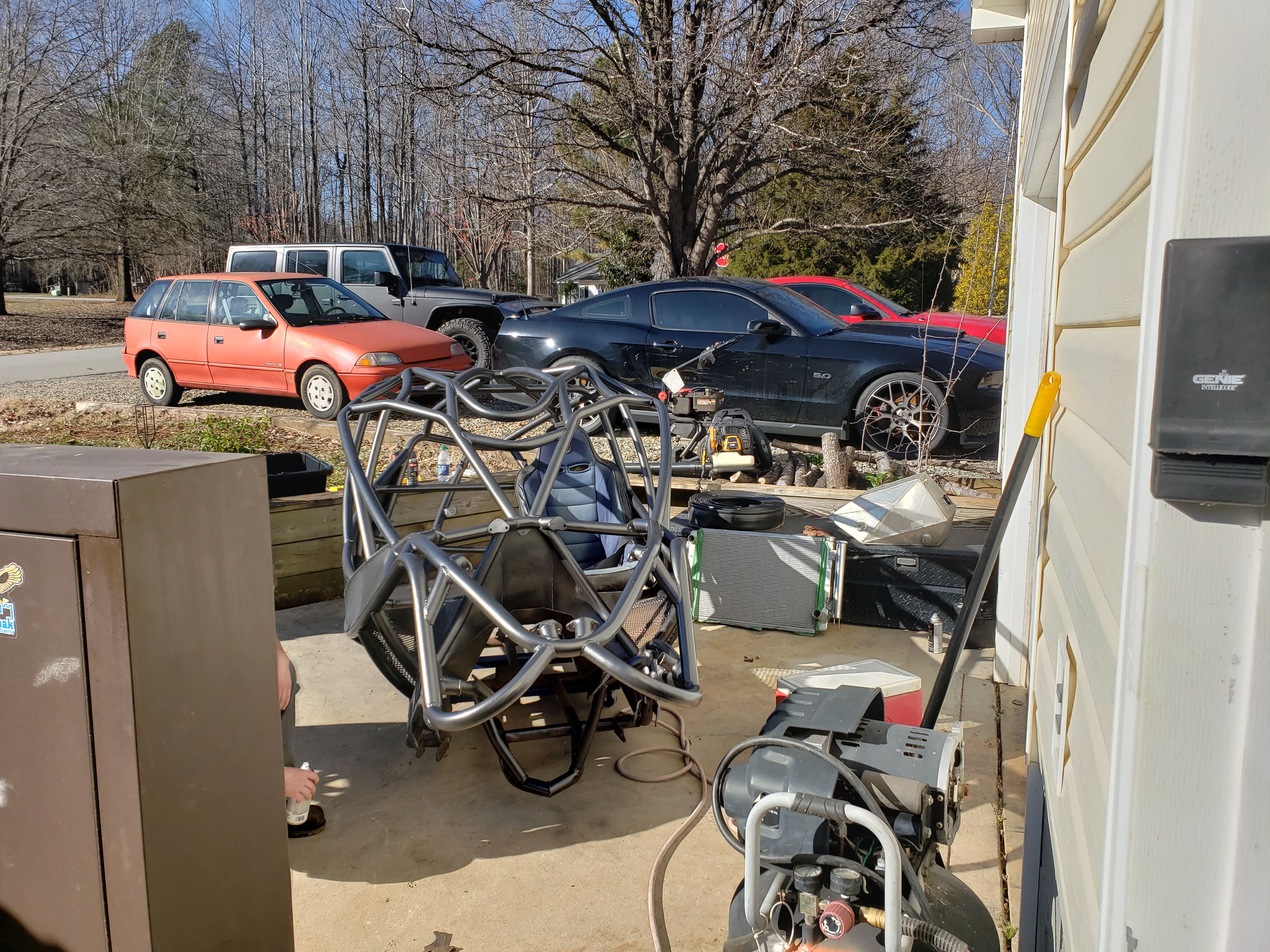

Picked up my angryfab chassis from george on the 22nd of december. It was a chassis that he built in 2016 that the customer went in a different direction.
5.3 Stock rotating, tick stg 2 blower cam, lsa blower.
4l80e fti 2800 converter
05+ sd 60 stock 17+ shafts (1550) 14 bolt stock
atlas 4.3
14/16 oris
43 stickums

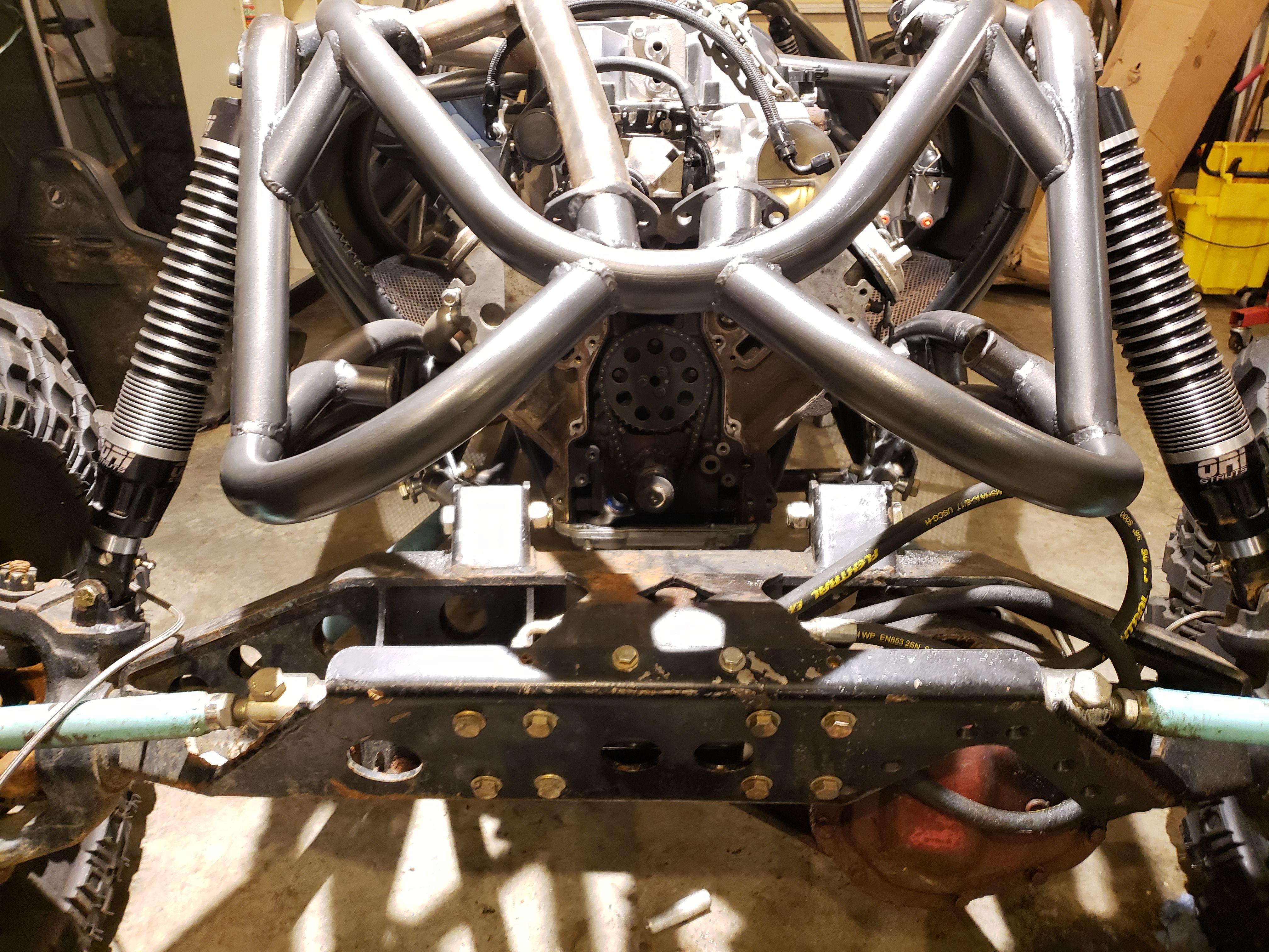

setting up links and chassis front links will be shorter than im used to at ~31 inches for lower and ~26 upper. dont really want the front thrown out to much more

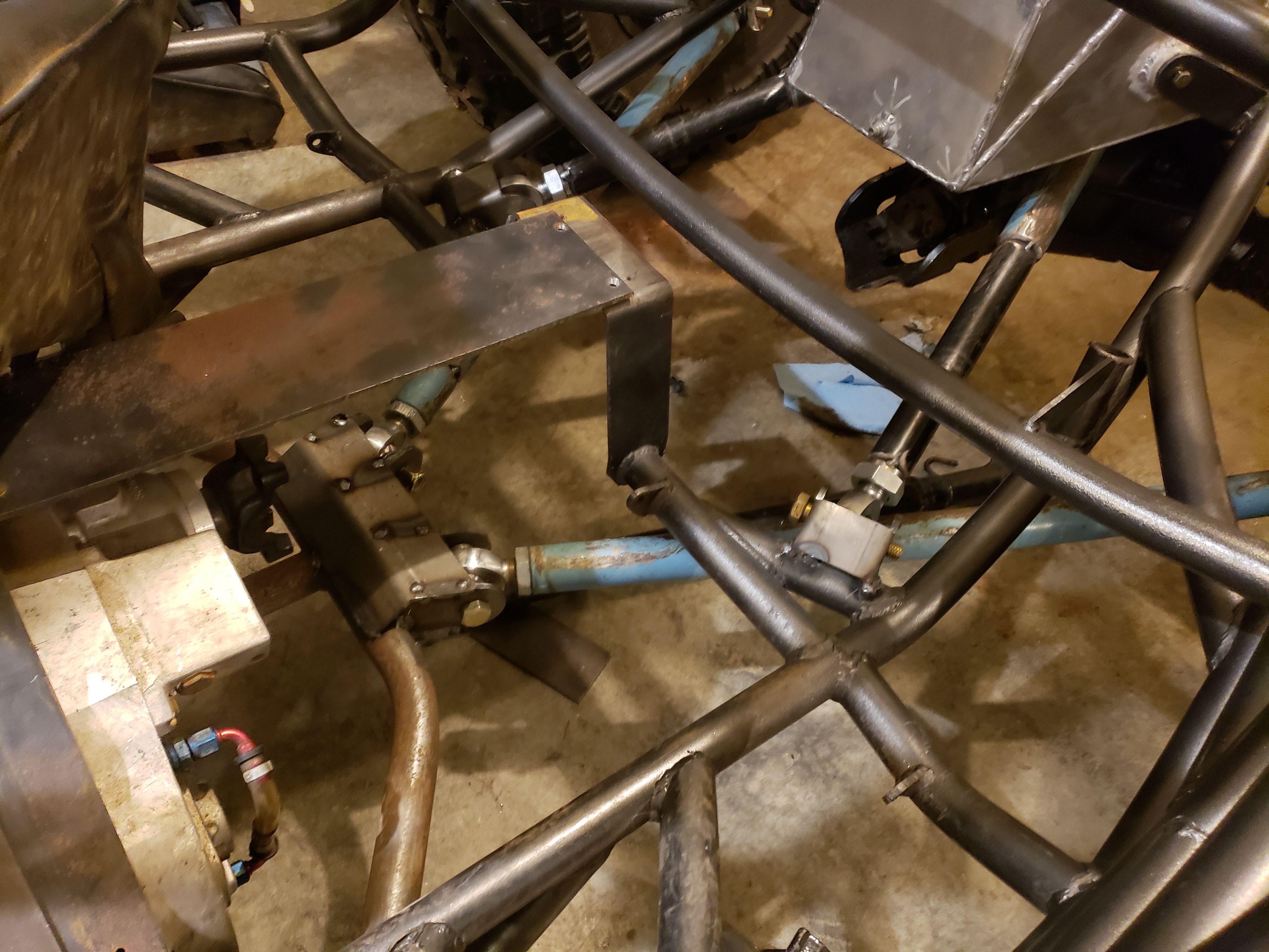

Got the chassis a roller now, I have to figure out how the hell im going to fit my accessories. the blower makes it tricky i guess.
was set up for 400 and pass drop but i got it to fit perfectly with little changes
next up is the carrier bearing mount and seat mounts.

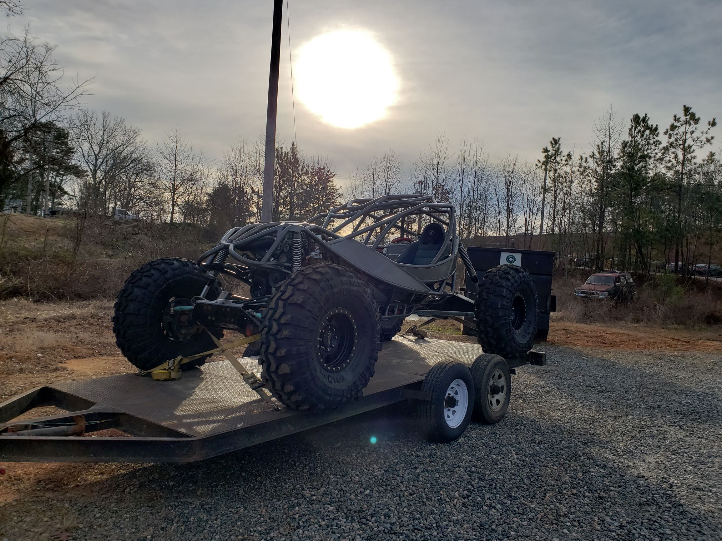

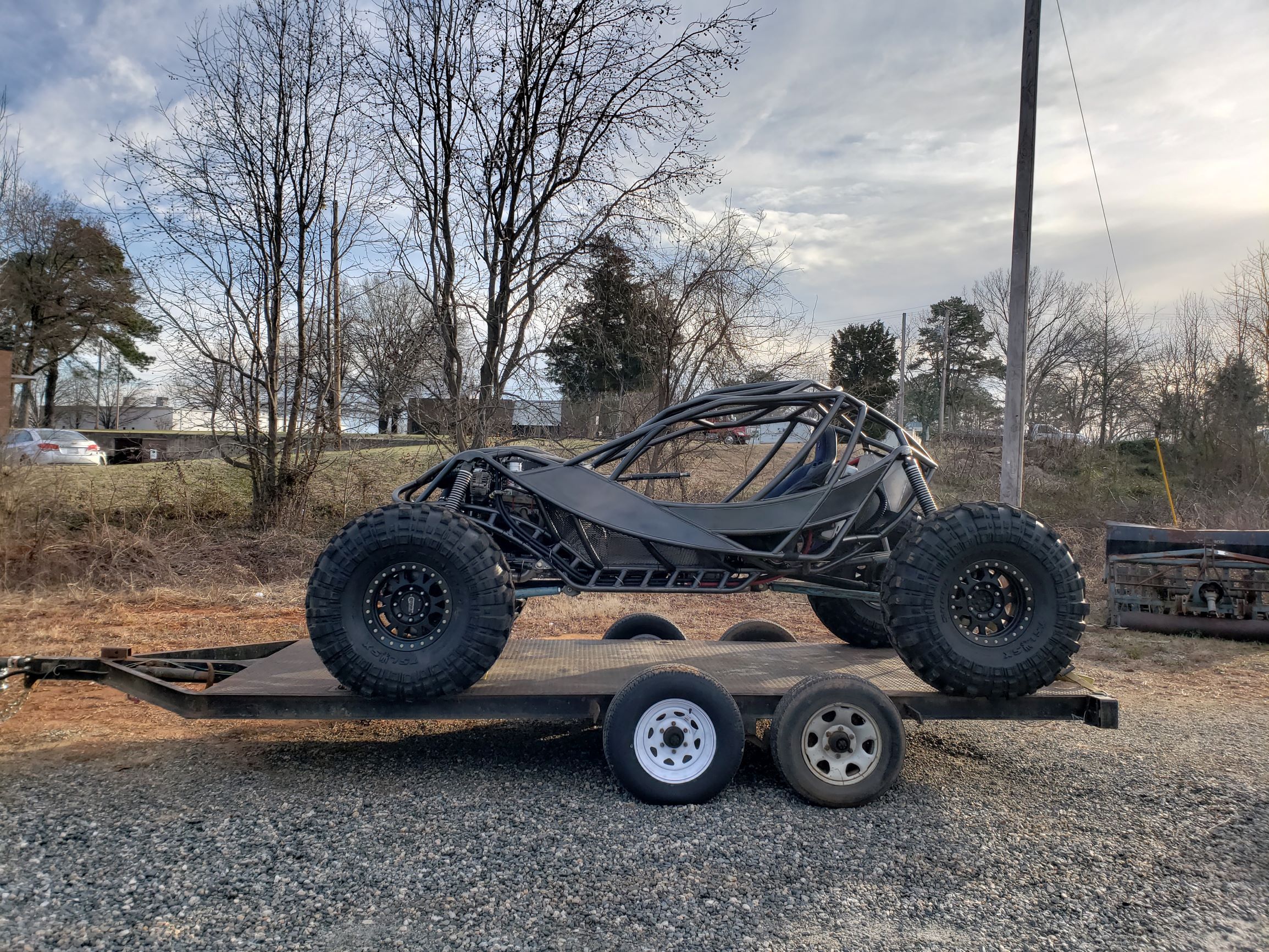

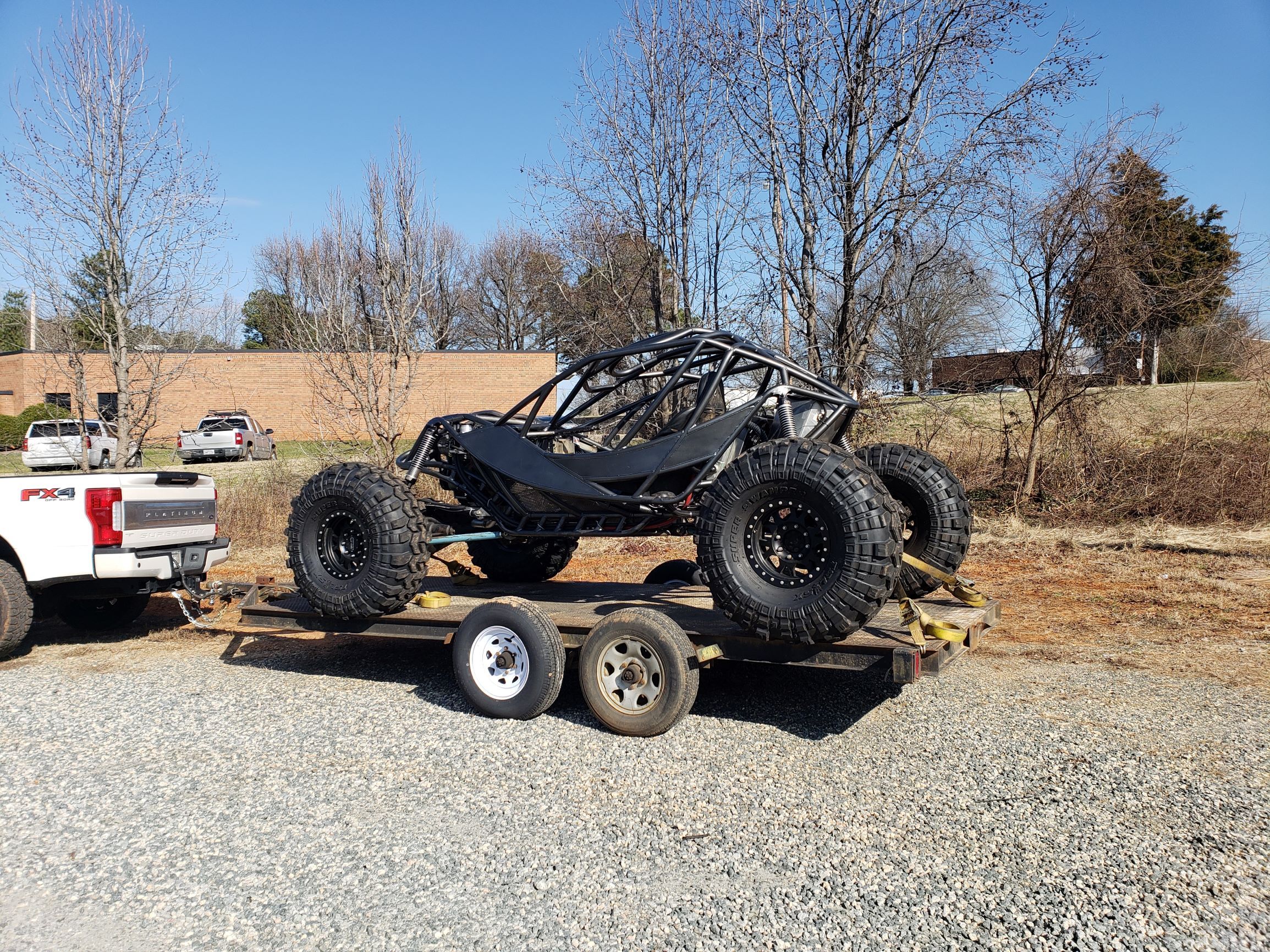

Well i just had this long post of what i have been busy on... but there was a server error and it got deleted... so here's the not so detailed version.
Its on the trailer going to the tuner tonight.
When I get it back i need to make the front driveshaft, make skidplate, mount passenger seat and tidy up some of the wiring here and there. Roof skins would be nice.
Getting closer and closer to getting this thing on a trail.

Very nice! I like the lines of the chassis on the side shot. What wheels are those? They look good.
