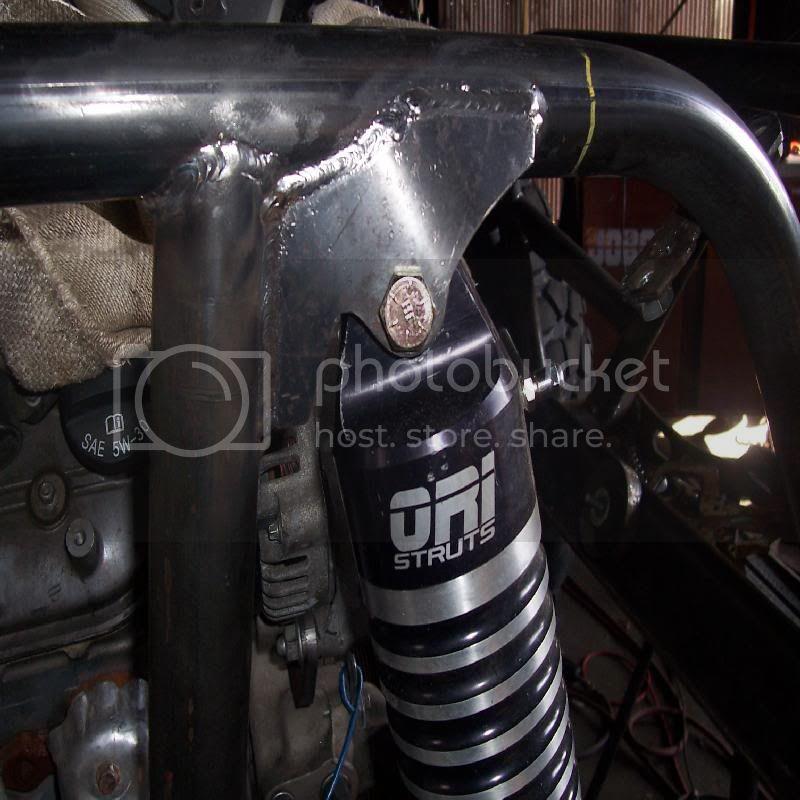

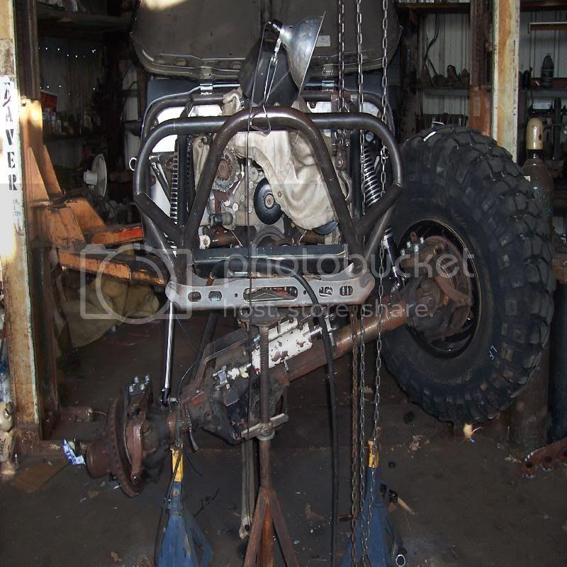

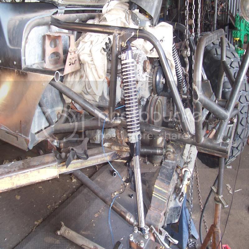

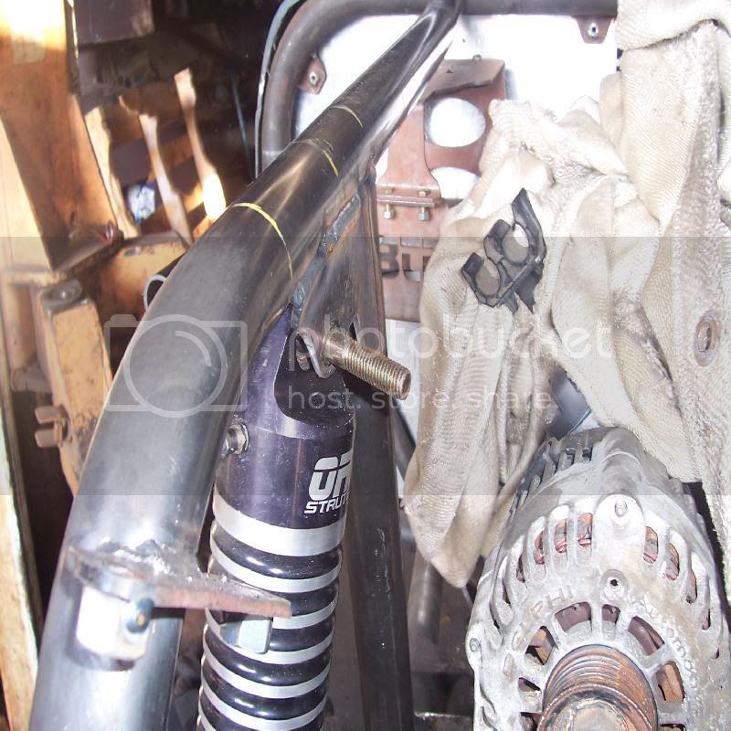

I got the front shocks mounted and sweeps braced down to the triangulated node in the front of the chassis. I might brace one more back to the dash to windshield x bars node. Removable would be trick there. Also going to go shock mount to shock mount removable across the top of the engine.

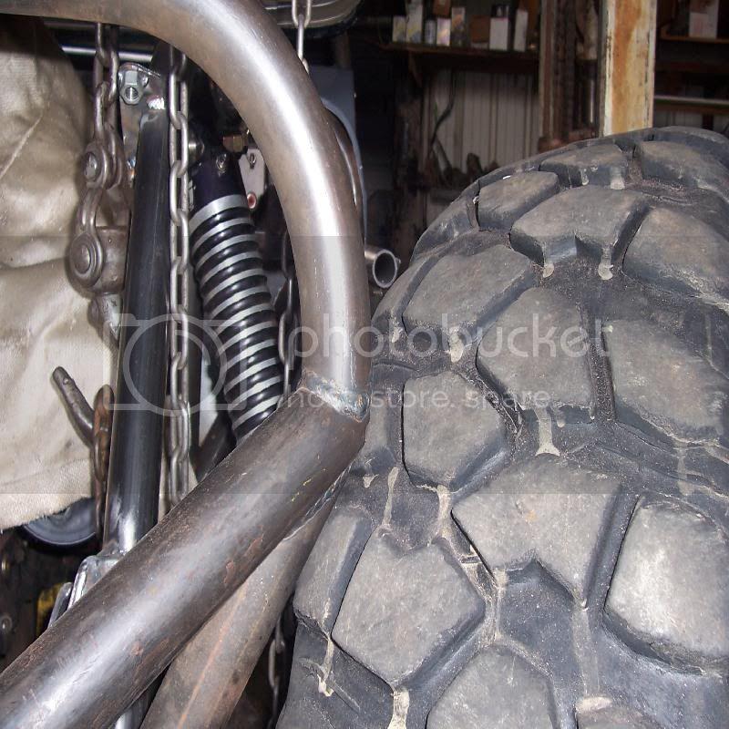

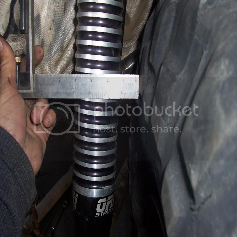

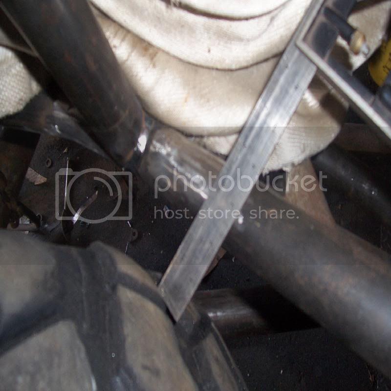

flexed it out and stuffed the other side and turned to 43* both ways with the 40's.

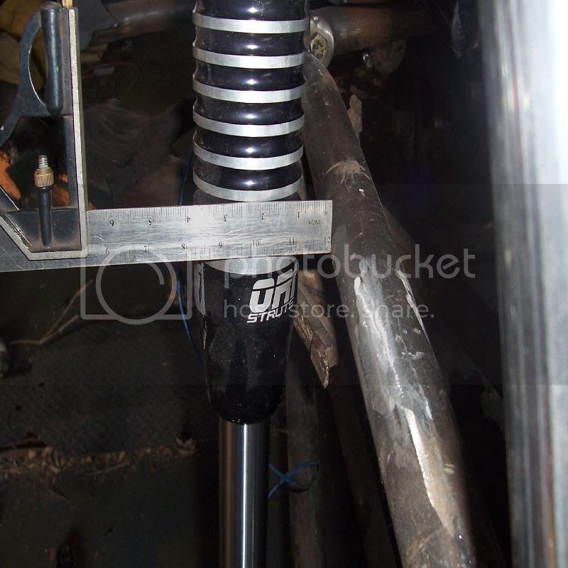

1" at the droop side to chassis rail (ok, maybe 3/4")

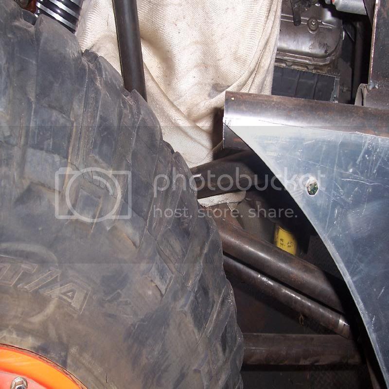

tire has enough at tightest point
fender bar will follow the tire up and over at this angle

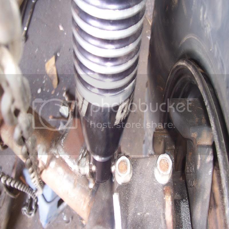

tire clears chassis, 44 should clear. this is at 43*, it will be stopped at 39*

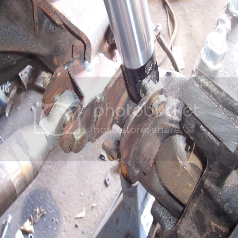

whacked the back of the high steer arms off, they now clear the shock body, and will be cleaned up as well

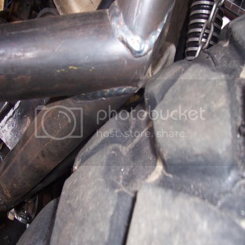

at the front, where I cut the old fender bar off it is the tightest. It clears now, and will rub when I put a tube and bigger tars in there

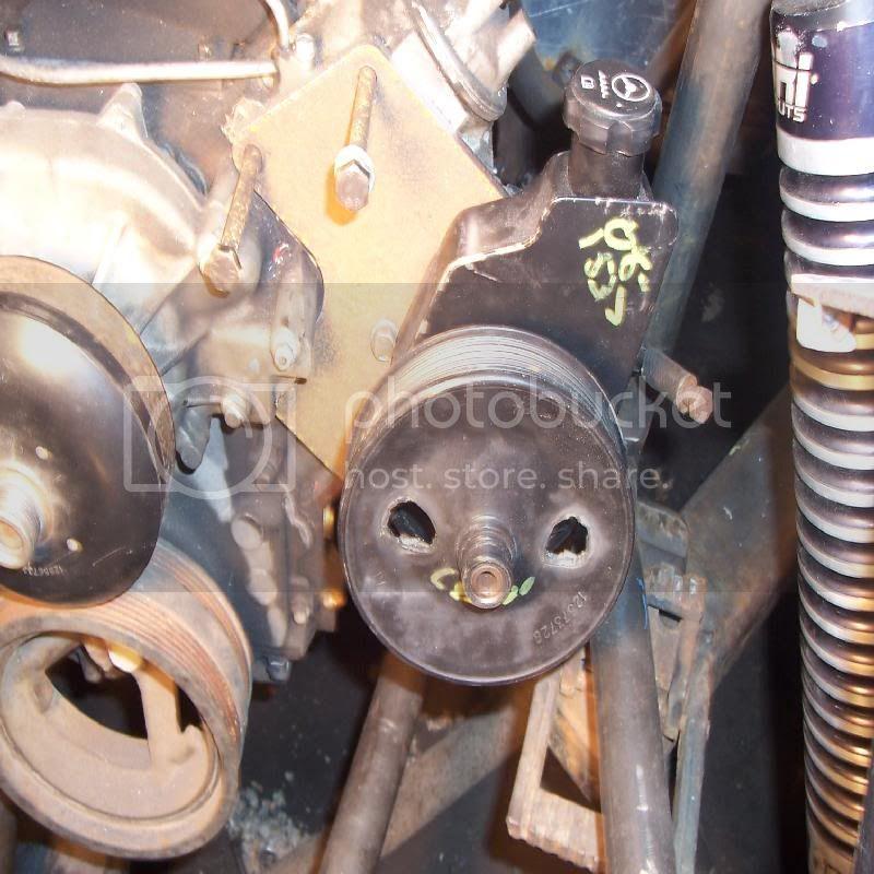

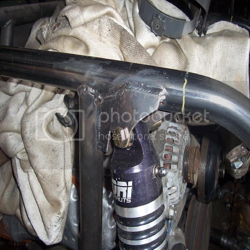

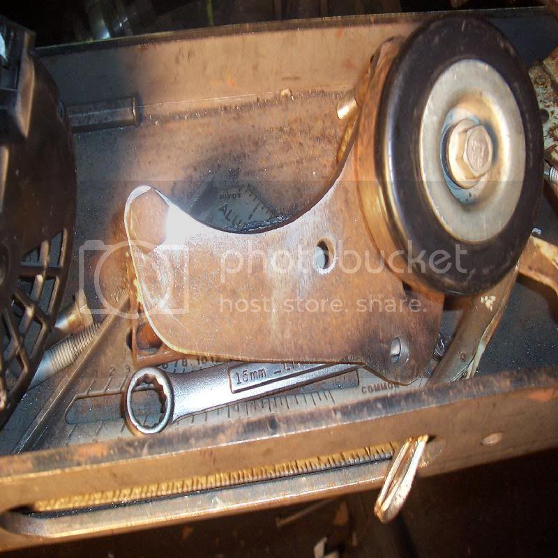

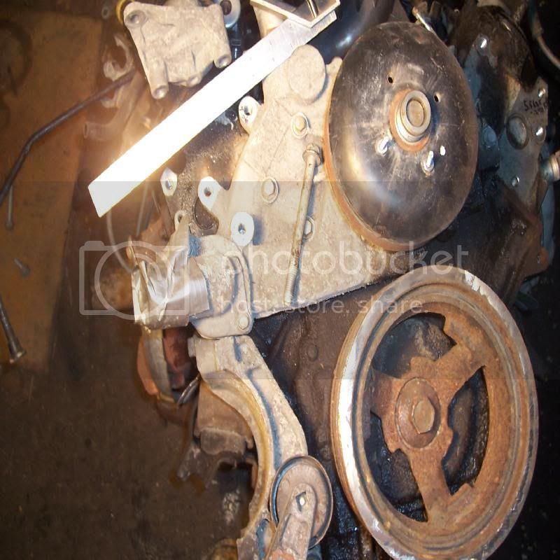

So I started on brackets. Moving the PS pump up, the alt over and the tensioner around was necessitated by the extra uptravel I'm throwing in the mix.
The alt will be on the WP where the spring tensioner used to be, and braced to the head to not fatigue the water pump or stress it and loosen the bolts or make the gasket leak. It is 2 pieces of 3/8" plate, and the old backside idler is now a backside tensioner in a slotted hole that makes the belt drop straight down to the damper (because the links are above the front pulley at full stuff.)

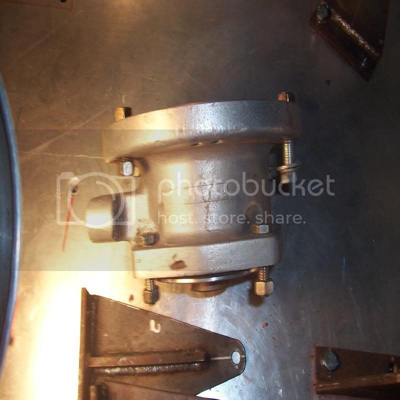

Got my atlas, it doesn't fit. Yep, ordered brand new direct from AA, told Vic I was putting it on a stock chevy 208/241 adapter, and wanted it flat. They are ADVANCED adapters, thought they might know where the holes were. Like, if someone were to have an 81-90 chevy of either body style in a 3/4 ton, wants to ditch the 208 or 241, and wants the tcase flat, what would they do? Why order an Atlas. Weird, he lined the 6 allen head bolts that hold the front seal/bearing retainer/clocking plate on directly up with the 6 holes on the adapter I need to use. There are 3 choices as to where he could have put them, he put them when I need holes. I told him I was using this adapter. "The guys at S&N were using those, and had broke a few."
Ok, I'm solid mounted with rear and side support, I'm ok
"Well, we recommend our adapter that's $265, plus the spacer ring that's $75"
No ****, but I'll try mine first
So he put the bolts right in the way. Maybe he doesn't know that the holes on the most common adapter to ever come on the back of a 4wd 400 has holes straight up and down, and on the evens (12, 2, 4, 6, 8, 10 oclock) ::)
So now I have to buy their adapter and wait for it, or drill and tap the face of my brand new couple thousand dollar case. ****ers

I now have a pile of AL chips on the floor, the front of the case is retapped with the right clocking on it ::)
cleaning now and getting ready to make a gasket for it. **** its cold in the shop.

Reason for mounting both ends of the ORI perpendicular to the axle top and bottom? Will they bind?
Lookin good man, that shop is hell this time of year, quit *****ing and get back to it. :flipoff1:
1.6" wide spacers and 9/16" Radius tabs with the 1/2" bolts, it would take another 4" of travel to make them bind. They are so not even close.
