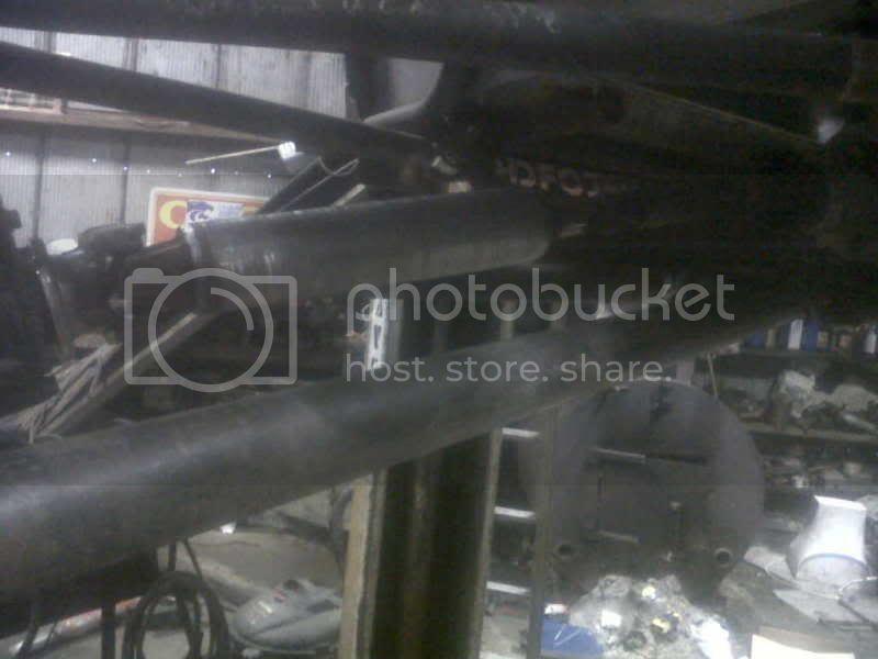

I've mounted the brain, made the tie rods, finished tcase mounting with supports at the adapter, rear output and a plate going under it and capturing 4 of the access cover bolts under the front output. It should be isolated, and none of the mounts or braces go anywhere near the belly pan or link crossmembers (personal pet peeve of mine, that **** moves)
I also mounted the orbital last night and am moving on to driveshafts and exhaust so I can start on the front engine skid and and bracing after.

I've made a whole driveshaft this week :gay: I've worked on a guy's logsplitter a lot, fed some cows, moved some **** around, babysat for a day, burned some ****, etc, but got a whole driveshaft made other than that ::) It is totally sweet too, I didn't have any heavy wall tube laying around, so I wetn and grabbed an old SF 14 I had laying around, cut the tubes off, whacked the axle shafts too. I cut the perches and shock mounts off and put it in the lathe. It was a little crooked from the welding and cutting so I lathed the OD of the tube and ID of the far end out to the pilot of the driveshaft. Then I flipped it around, chucked back up, spun the rest of the OD square to the first part I turned and turned the ID out and welded the splined stub in. Flipped it back and put the weld yoke in. what a pain in the ass over using new tube of the right size, but I'm poor laughing1 You want pics of a driveshaft? :flipgotcha: It is 5/16" wall at its thickest (it was only warped a long 1/16th" at its worst)
I guess I also made the lower rear axle end shock tabs and was in the middle of the uppers when the wife said I have to drive the Step daughter 1.5 hrs south to her dad's. Fun.
there
