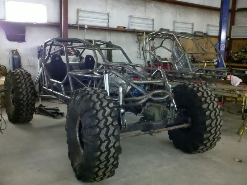

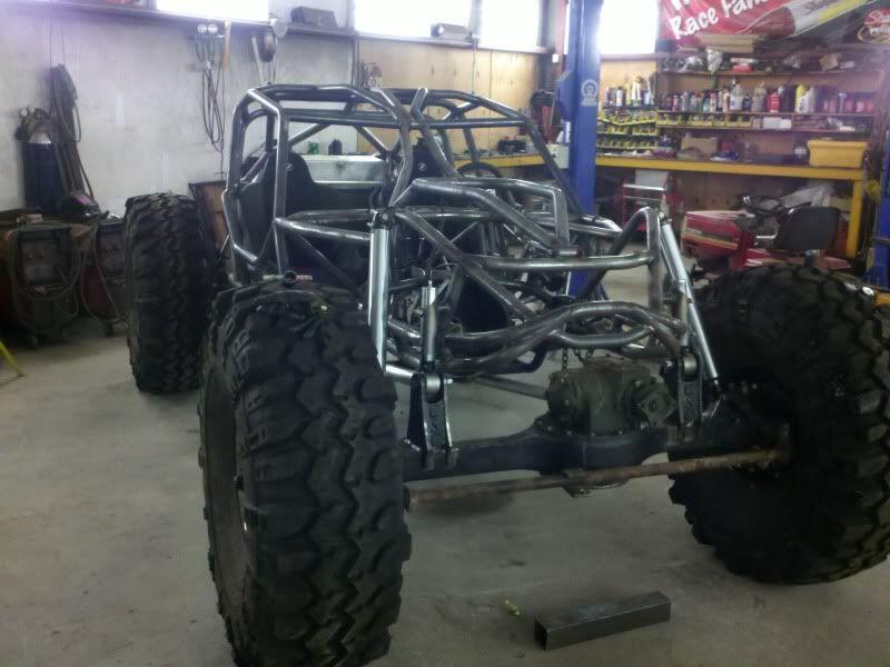

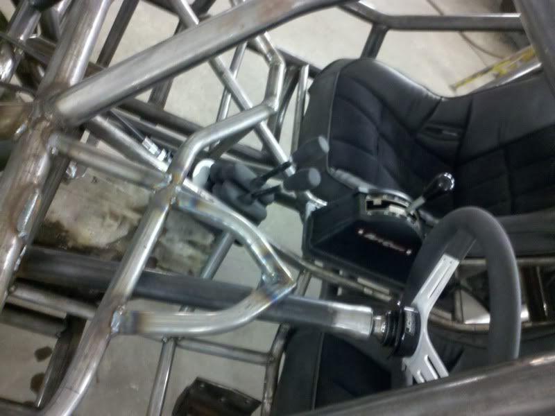

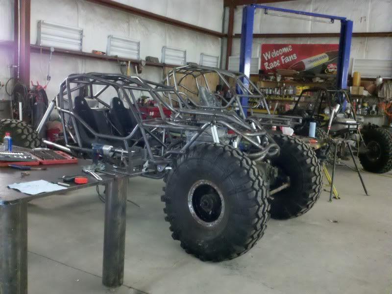

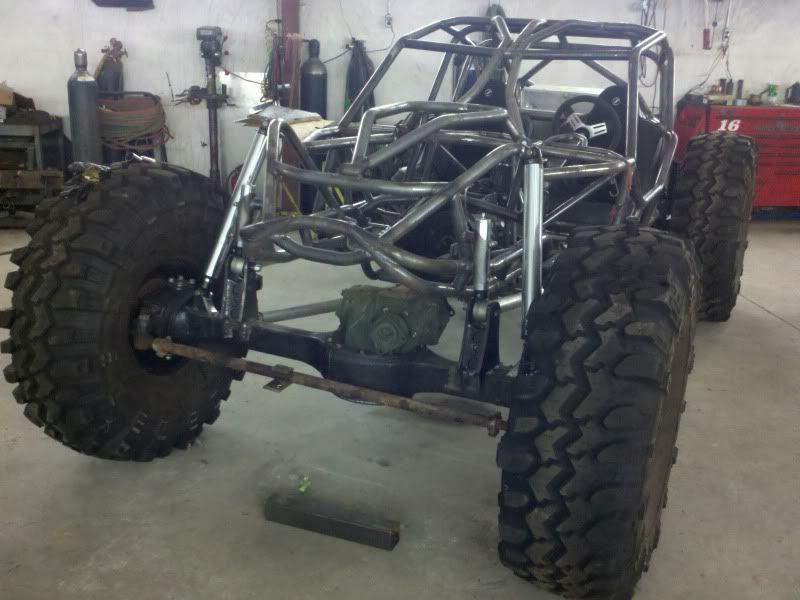

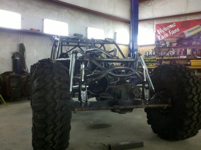

put it all back together, getting ready for wireing, plumbing, and powdercoat.
jtrogers83 said:whats a roller like this cost im very interested

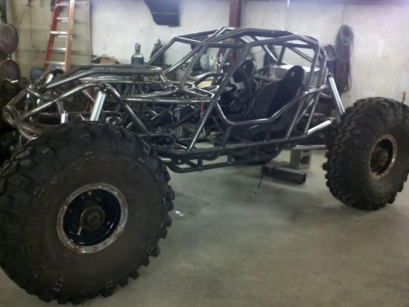

it was originally gonna have 350 with 1 tons, but i decided to use the 408 stroker motor from my race car. Its a 351w stroked to 408. Nothin special.jojo said:Wat kind of motor is in this rig that's a ford in the pix but it say 350 at the start of the thread
Now I have an excuse to buy new parts. Thanks Coleworx.COLEWORX said:hey labronn if the customer is gonna be hard on it he needs to go 1 1/4 hyms and 1'' bolts w / rocks we broke jonny joints and the bolts pretty easy with rockwells. lookn good
