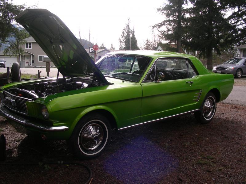

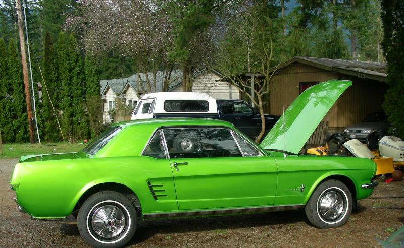

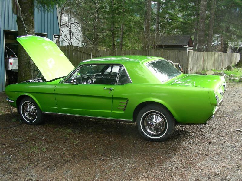

here's some pics I took tonight after Michael took it for a drive and washed it. :awesomework:
