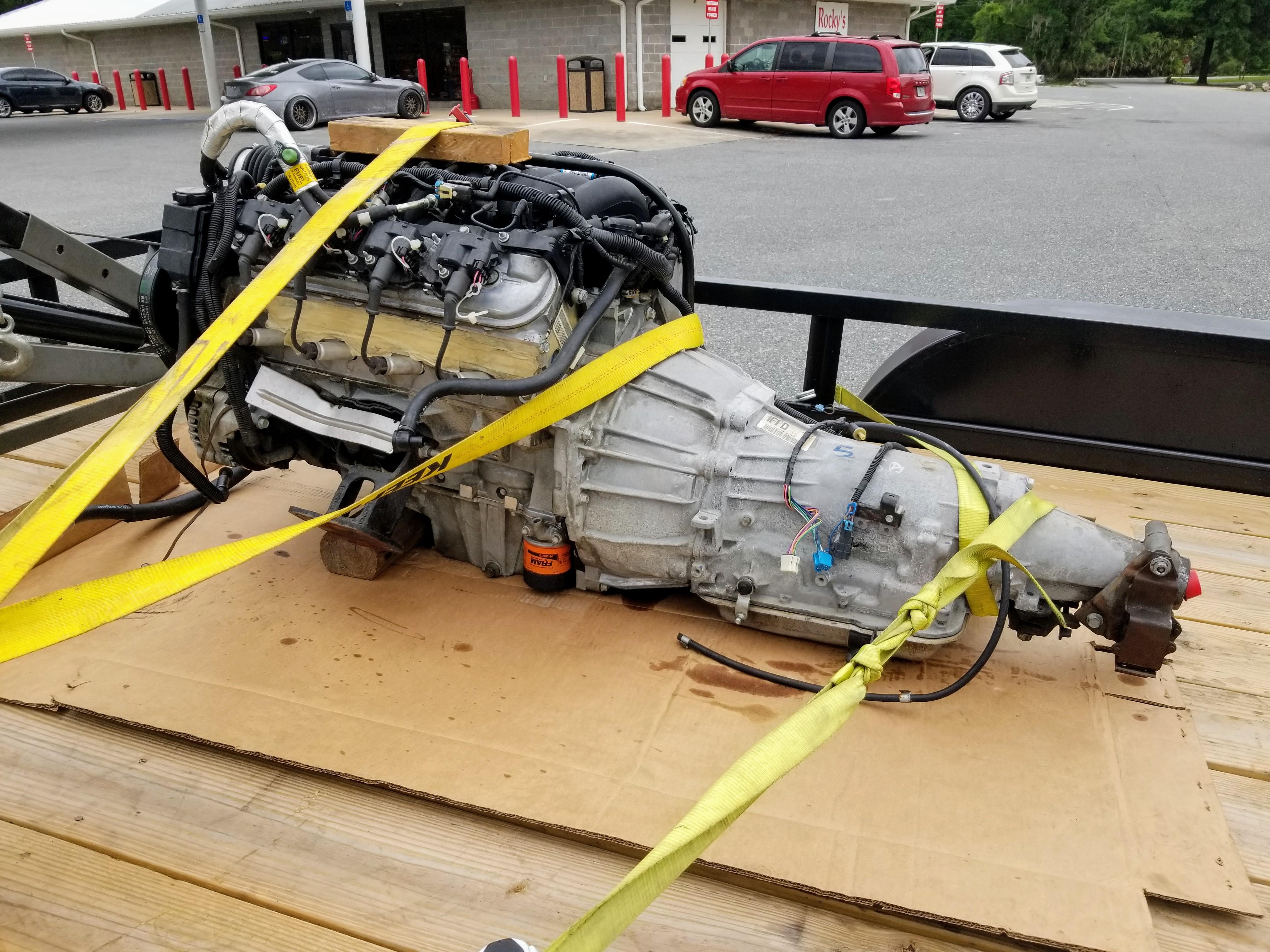

So I found another pull out from a 2001 Firebird Firehawk that only had 58k miles on it and looked really clean. Unfortunately the motor was out when I bought it so I didnt get to hear it run.....last time I will ever do that. We put the motor in the buggy and after 15mins of run time you could hear the bearings in it squealing. Pulled the motor out, tore it down and sure enough the cam bearings were toast and there was evidence that the motor had been super hot in the past.

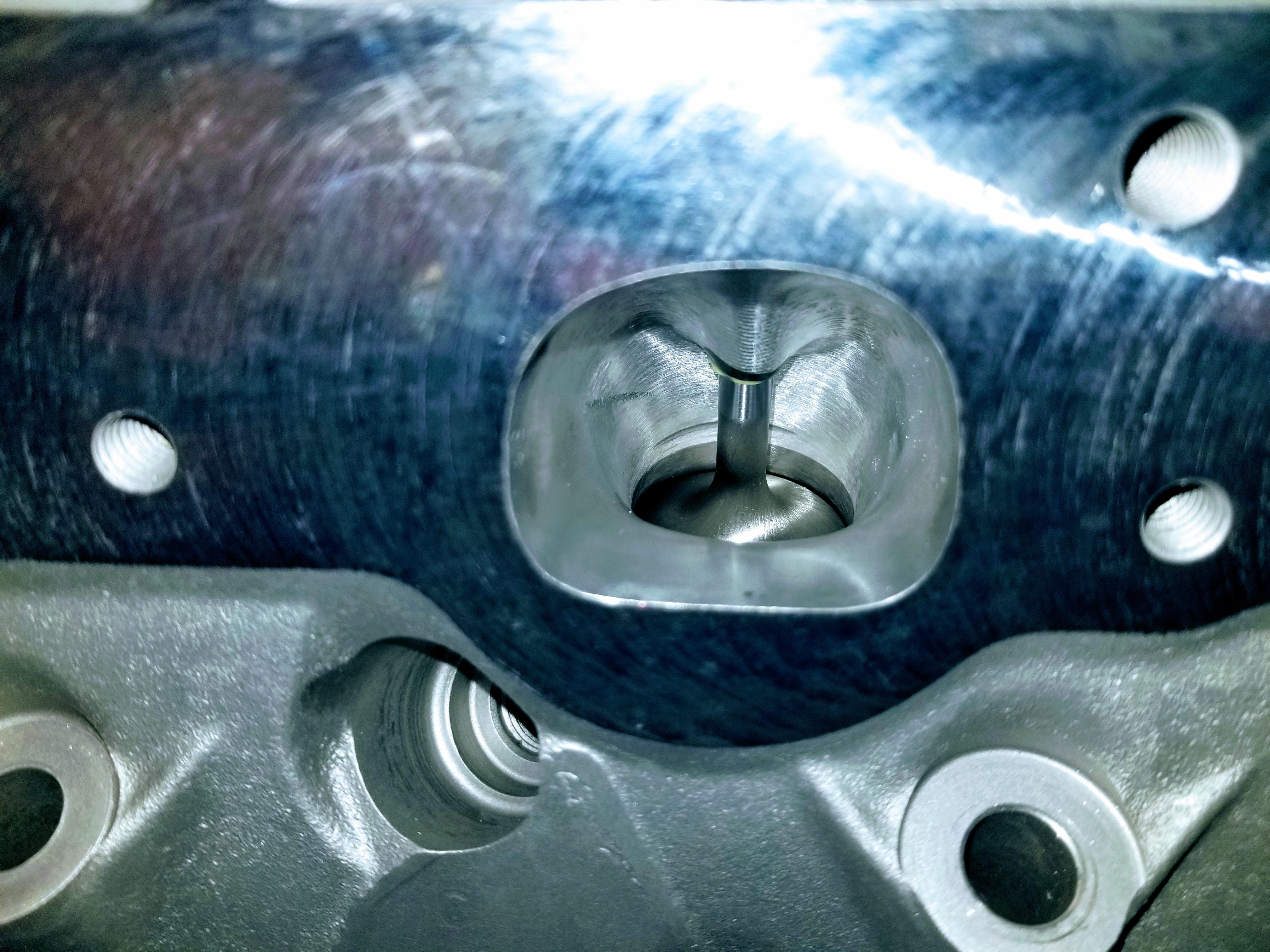

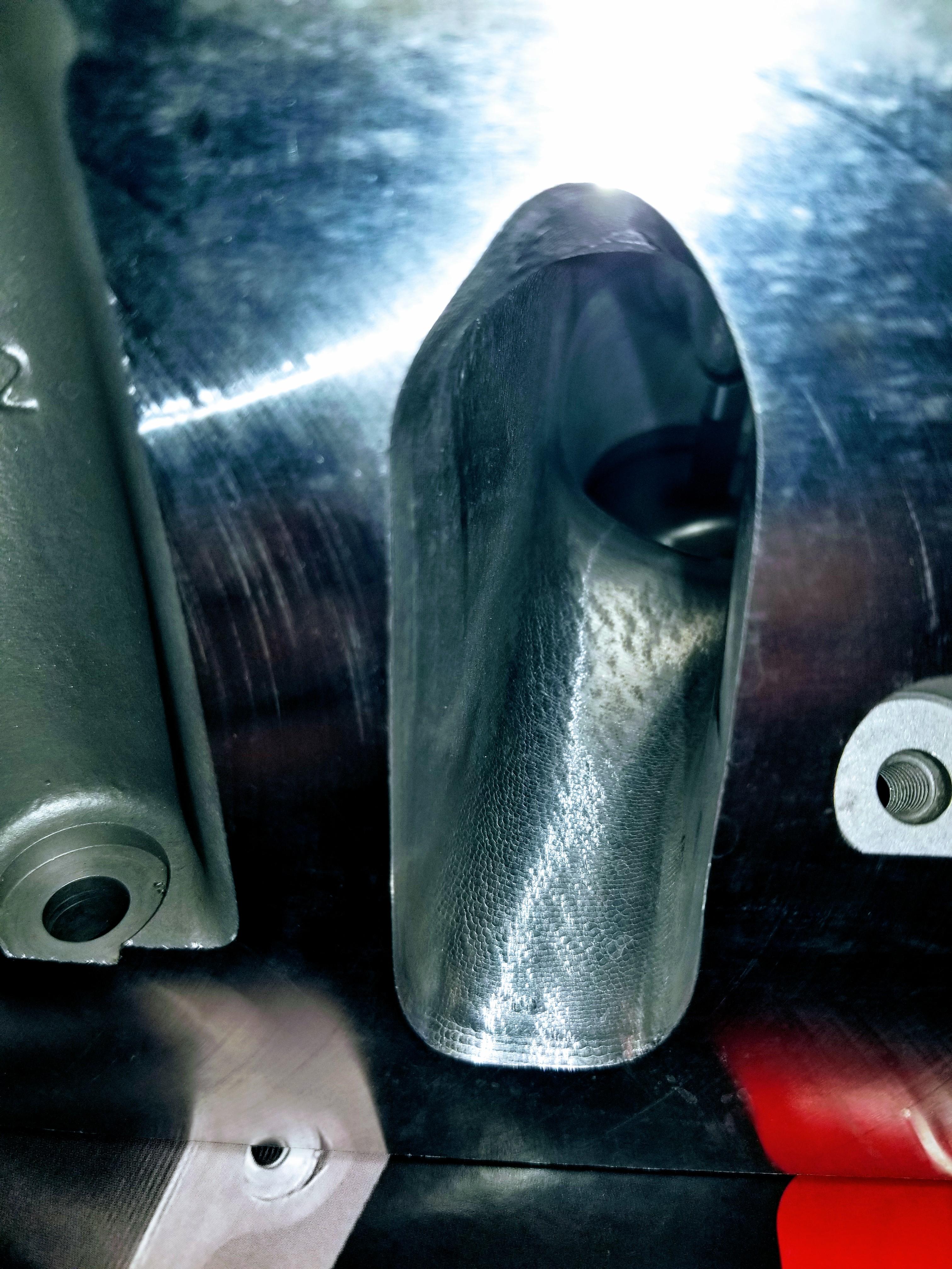

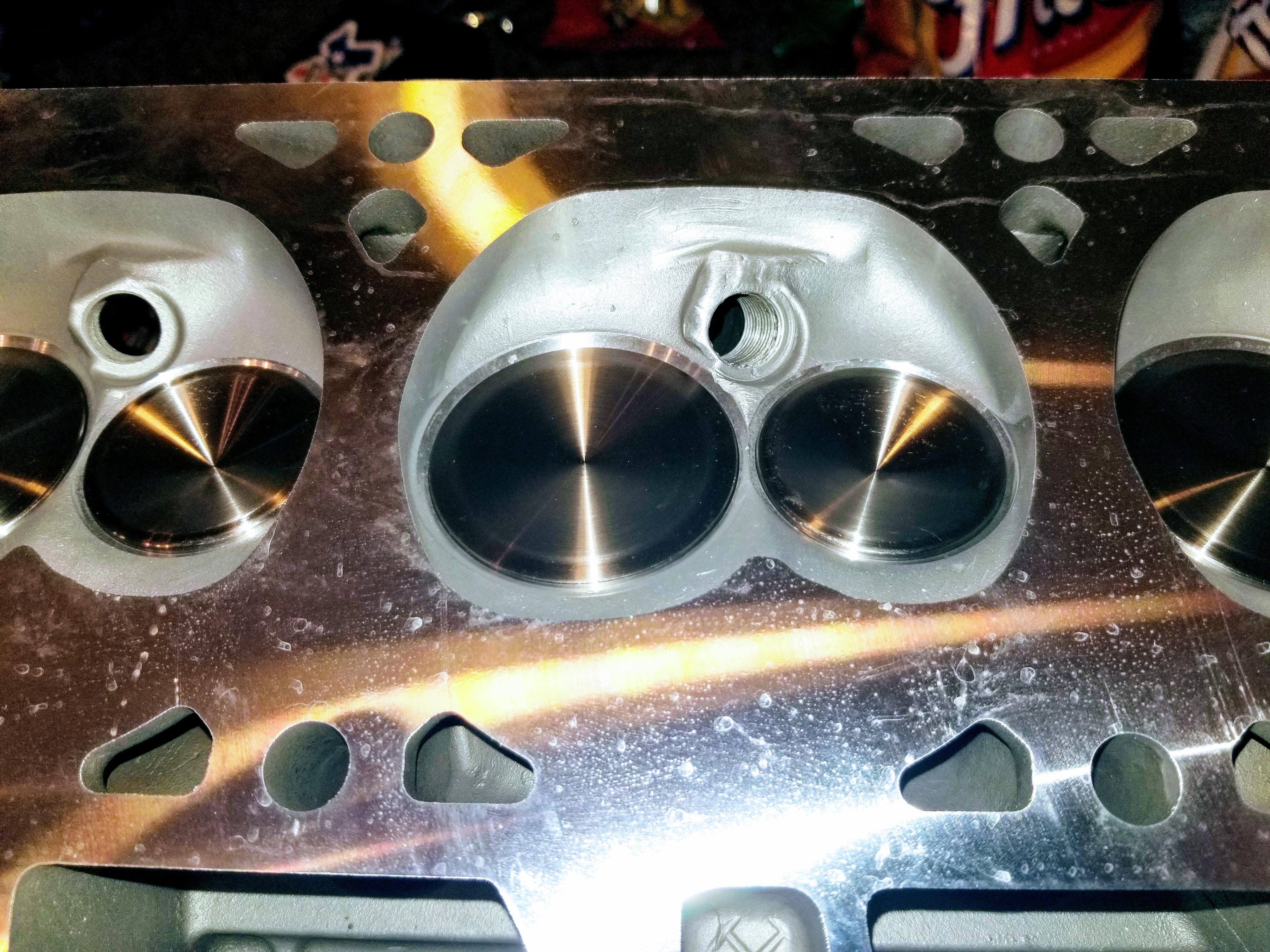

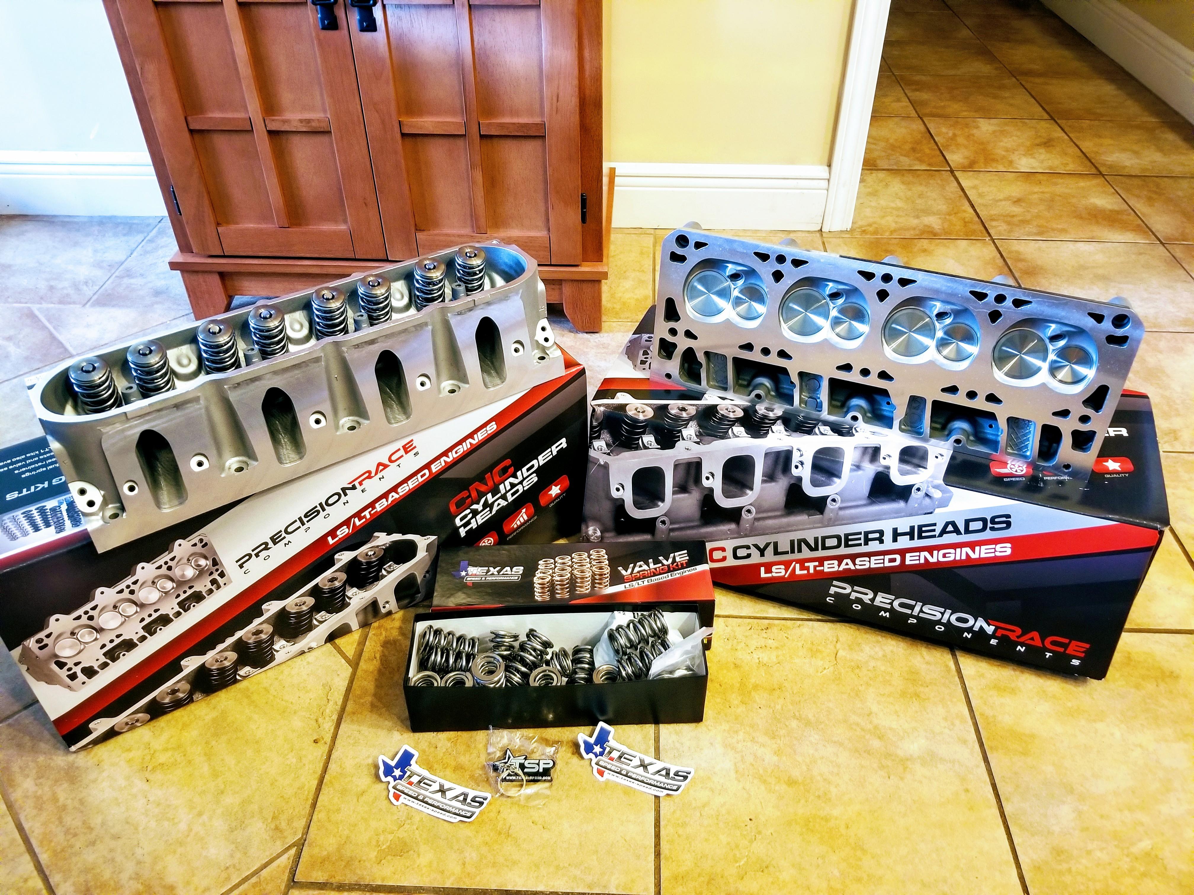

So at this point Im pretty exhausted with it and just decided to have it built all brand new. The motor went to the builder and the only thing we re-used was the block and the crank... my 243 heads went to Texas Speed for their 2.5 CNC port job and bigger valves. I should get the motor back this week so I hope to have a report soon.

TSP heads milled .015 with dual springs and chromo rods

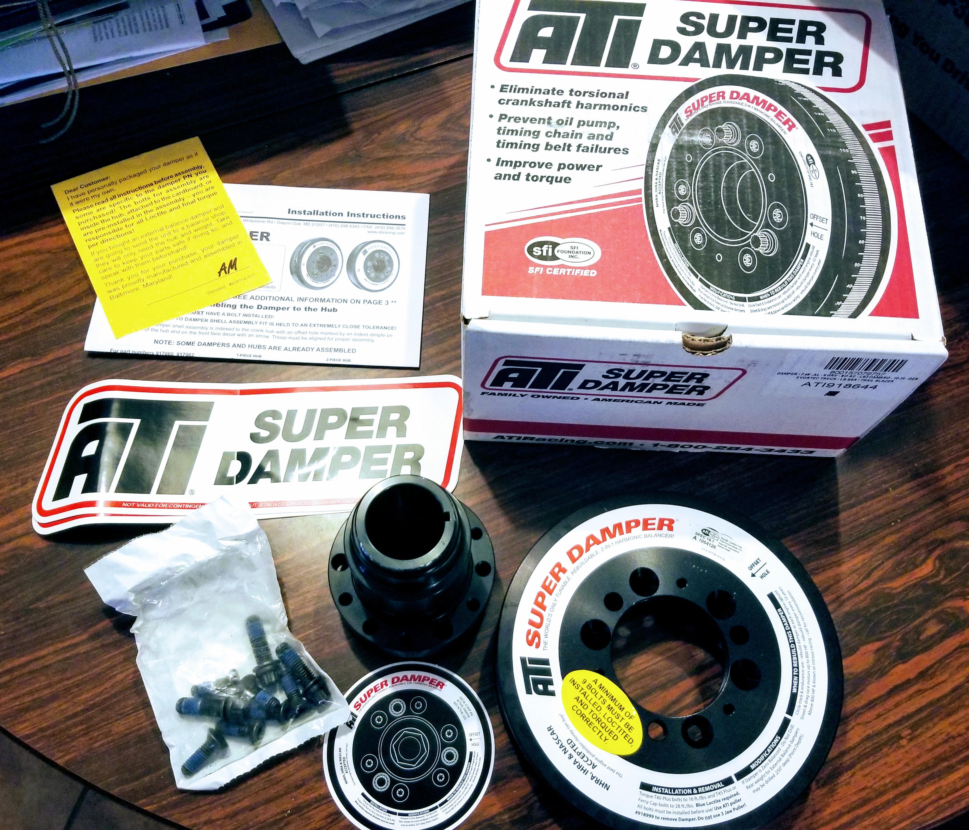

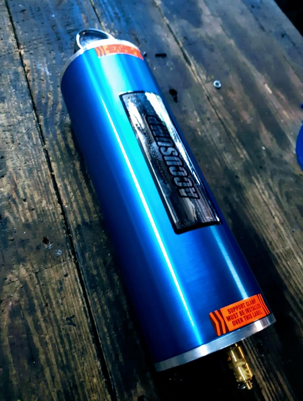

To help keep this motor alive we also figured we better put in an Accusump system....I went with the 20-25psi automatic electric valve. I've never had one of these in a buggy before so curious to see if it helps.

I have ran these since i put a ls in. Never had an oiling problem. I dont know if they help,but they dont hurt.

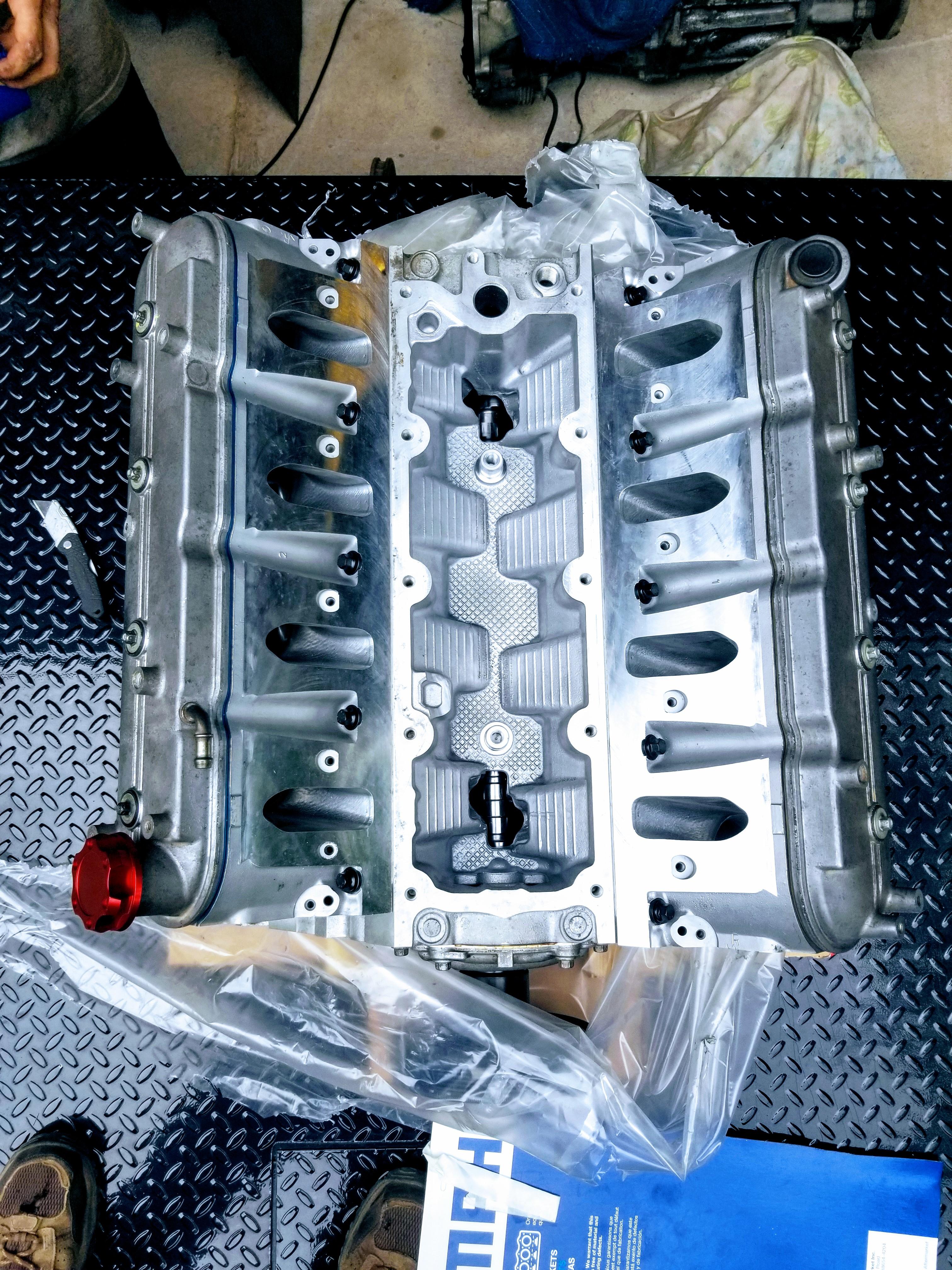

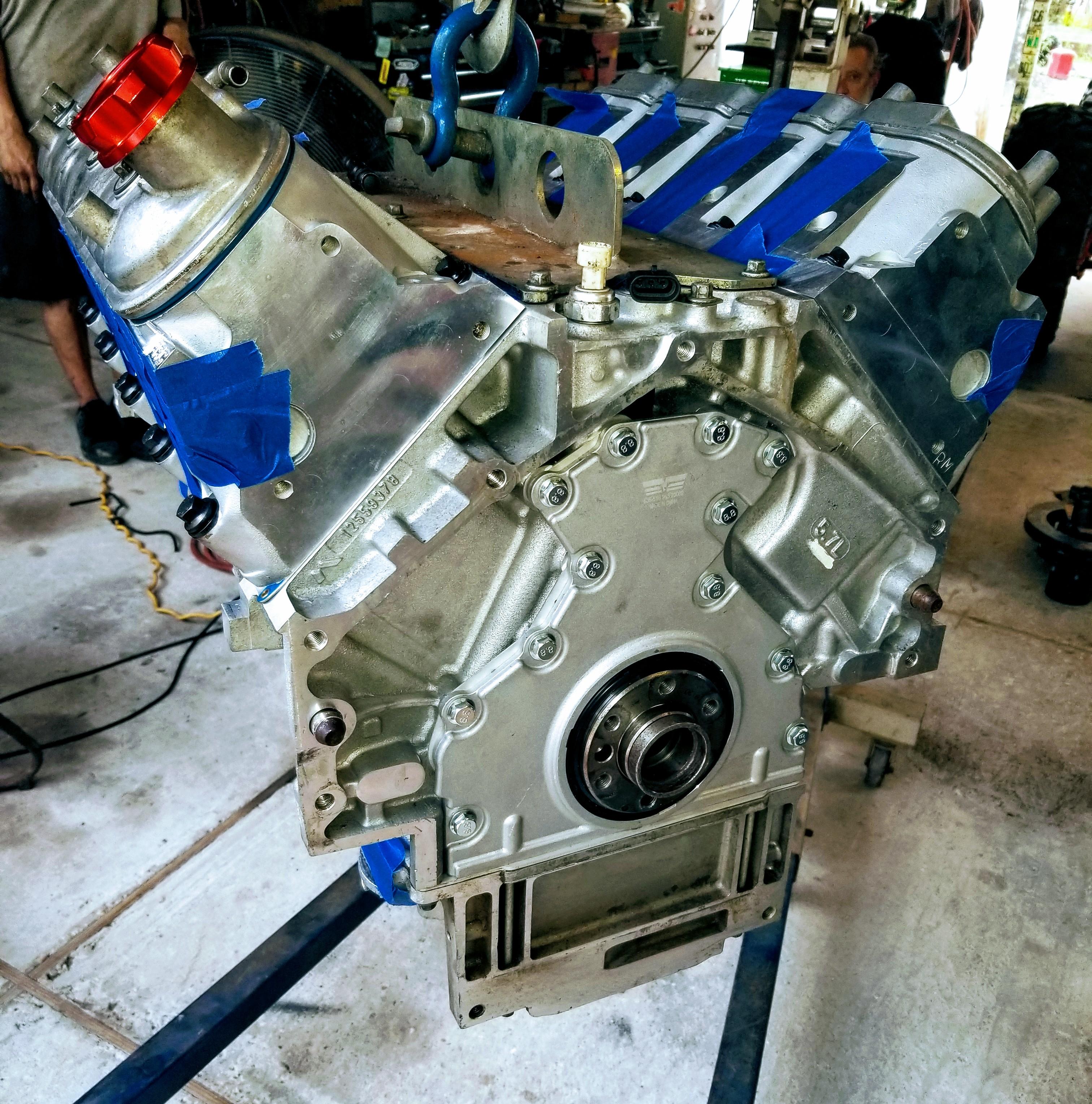

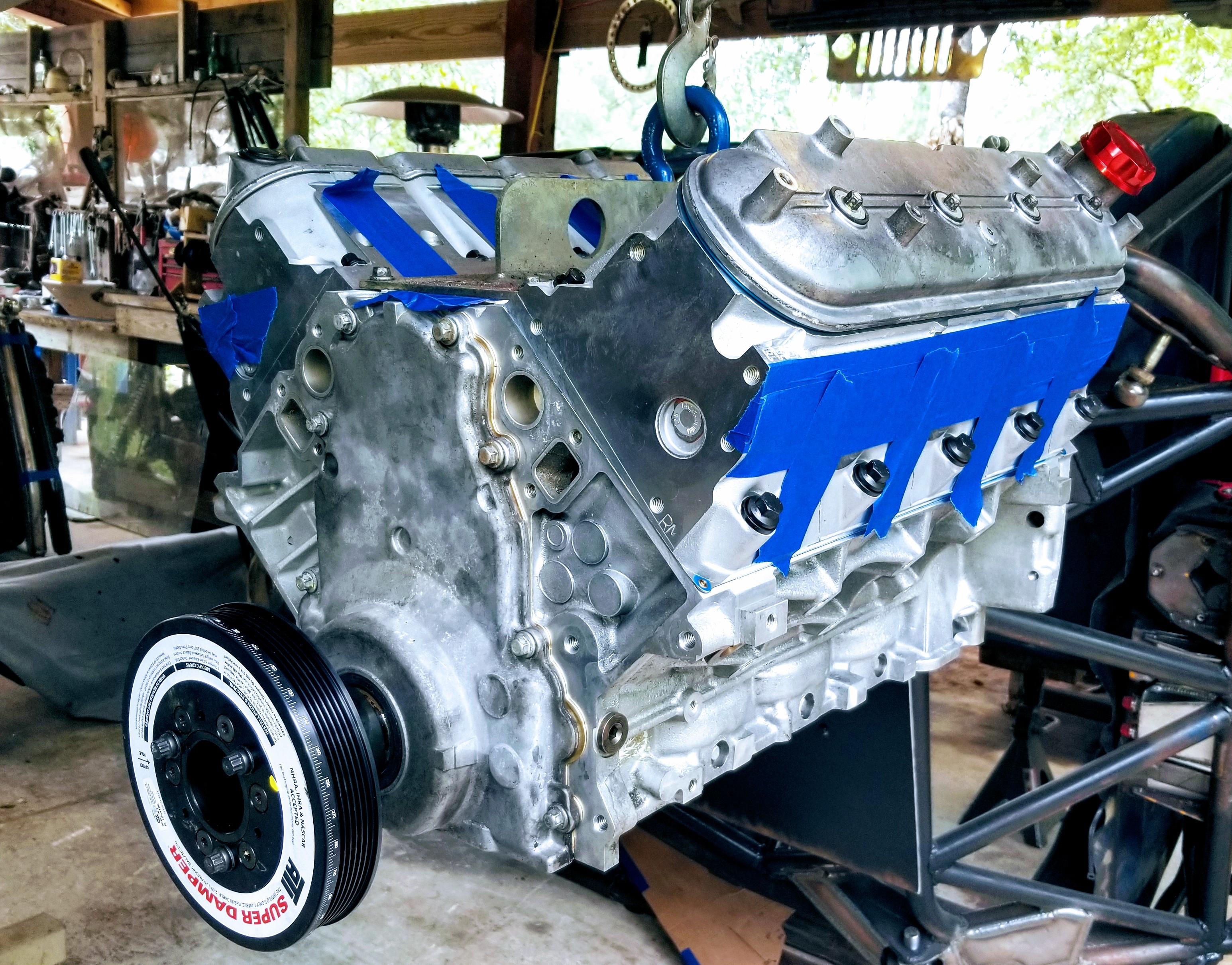

Motor is back at Dillons ....wont be long now

Also, on the oil accumulator, I think I need to do the electric valve too. I have one on a manual valve that I mean to open when I plan to get a little rowdy but forget half the time or its unplanned.
I always thought the accumulators were to prevent dry starts. Maybe I misunderstood? Do the electronic valve versions open and dump extra oil in if pressure drops below a set psi?
Dillion is wiring mine so when I turn power on to the ignition it automatically dumps to help with dry starts....and then when your running as long as your have oil pressure that's above the spec on your valve the sump will refill....should your oil pressure drop below that spec at anytime such as when your layed over on your side the sump will automatically dump oil again back into your motor. The valve I purchased will dump when oil pressure drops below 25 psi.
So you were right on both accounts lol.
Oh, that's pretty cool. Might have to stick that on the list of things to add later on.
