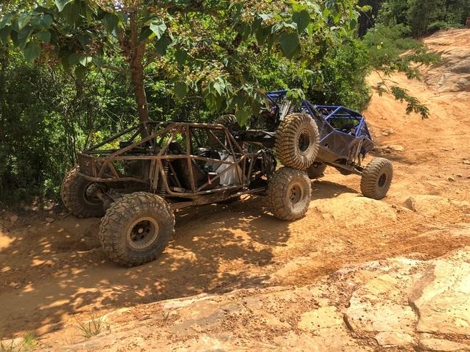

Is that the same ledge that the Matt's did on the Cheap Jeep Challenge series(somewhere around the 22 min mark)?
Found the video of the ledge, with super slowmo haha

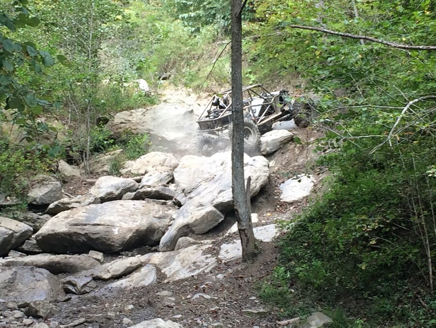

And just for fun, getting stuck on Little Mule. I went back around and made it up no problem afterwards. Just lil driver error...

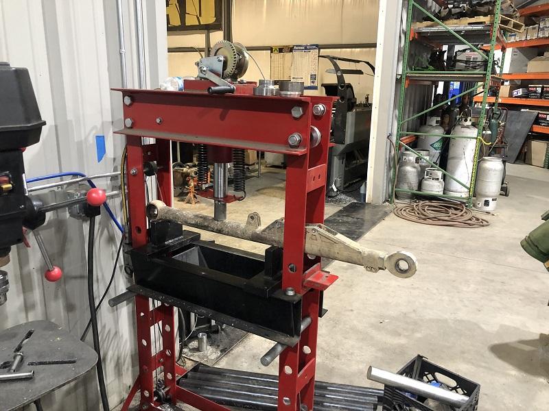

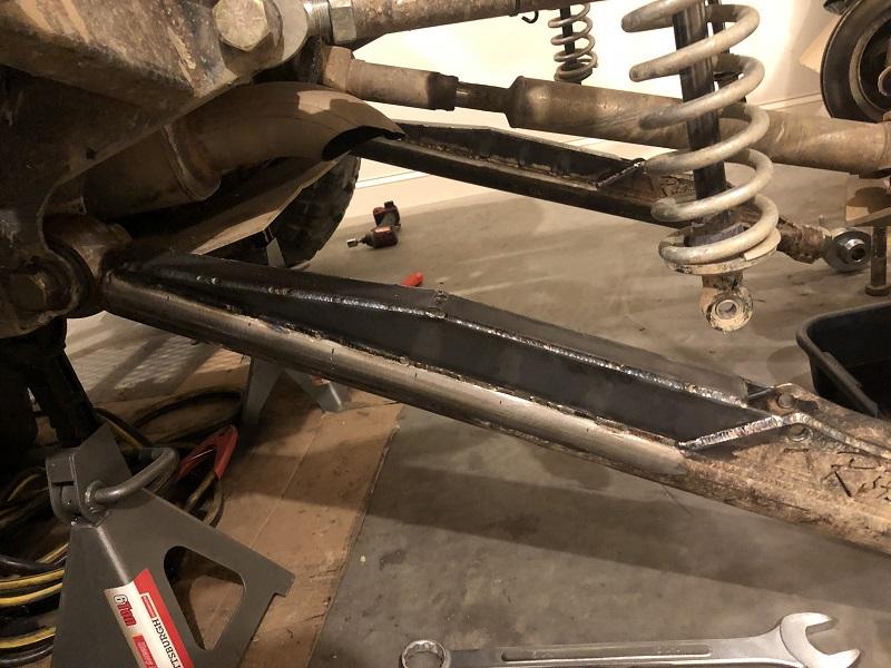

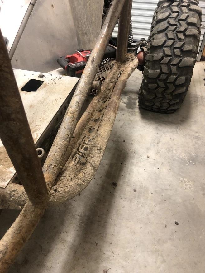

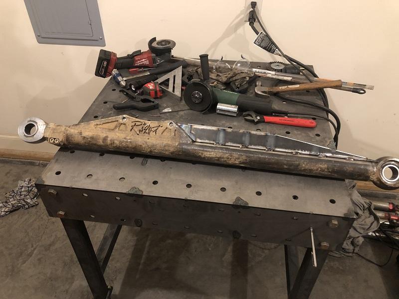

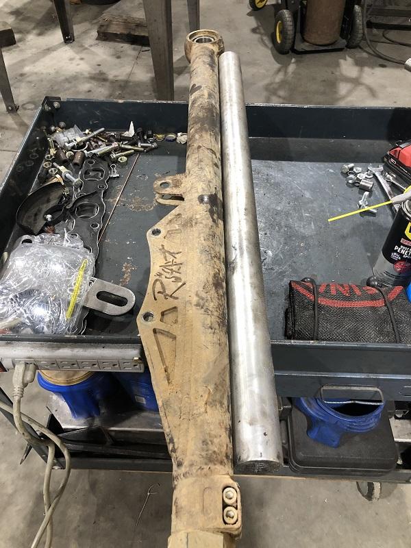

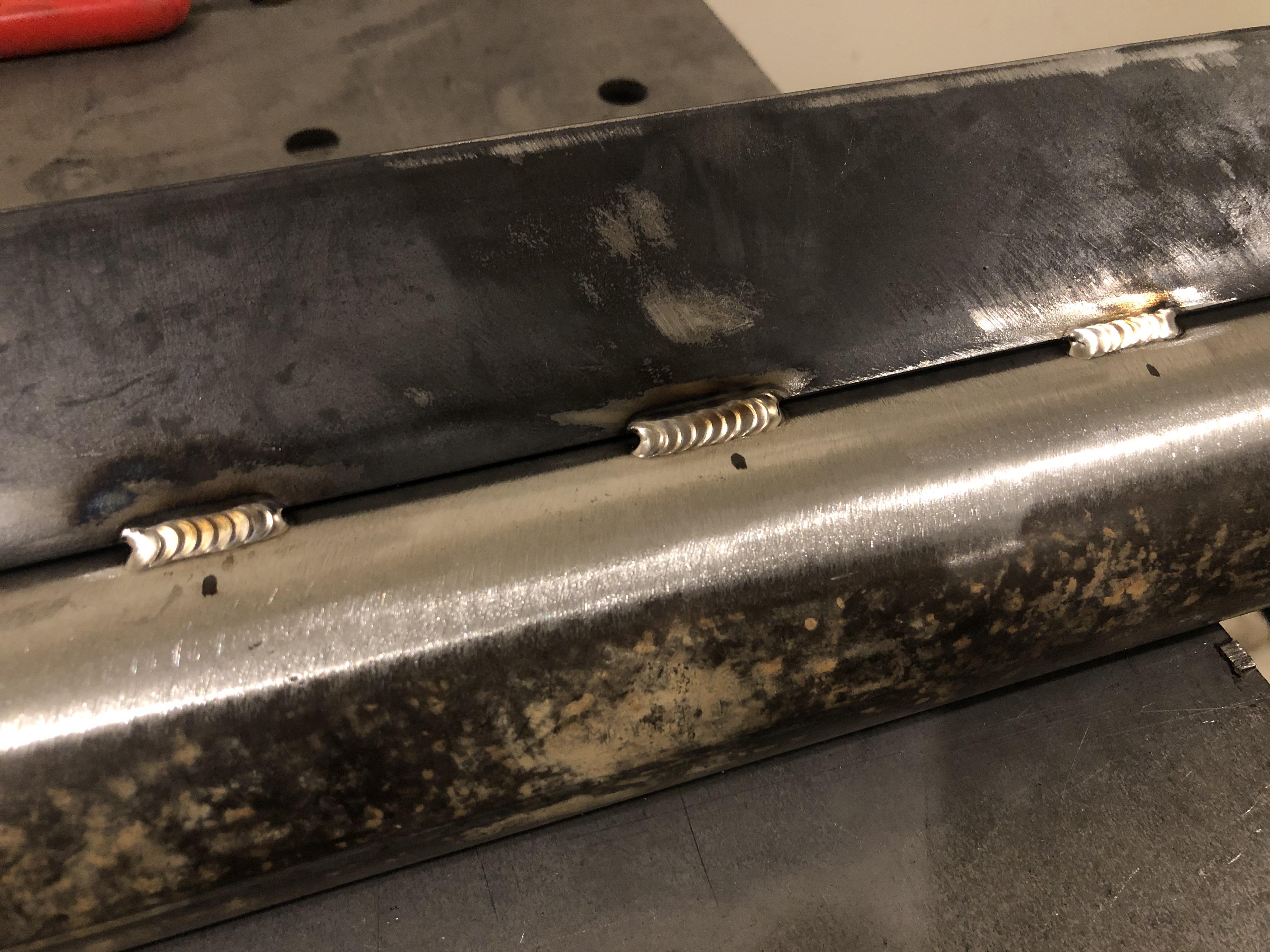

When going over everything after the last ride, I realized my fancy trailing arm weren't real happy...
Turns out I managed to bend both of them, which I think is pretty impressive... They are 2.5x.250 DOM with a full 2" 7075 AL slug inside.
After discussion with Jake, it turns out I welded the shock mounts backwards which left a long unsupported piece of tubing. Oops...
BKOR let me borrow the big press to try to straighten them back and it took all she had to do so.
I did as good of a job as I could.
Massive thanks to Jake to let me use his equipment, I couldn't have done it with the stuff I have at home.

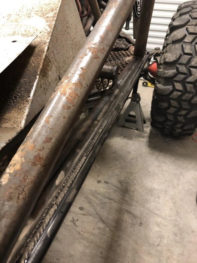

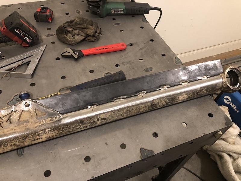

Then I started trussing/boxing so I don't have the same problem again.

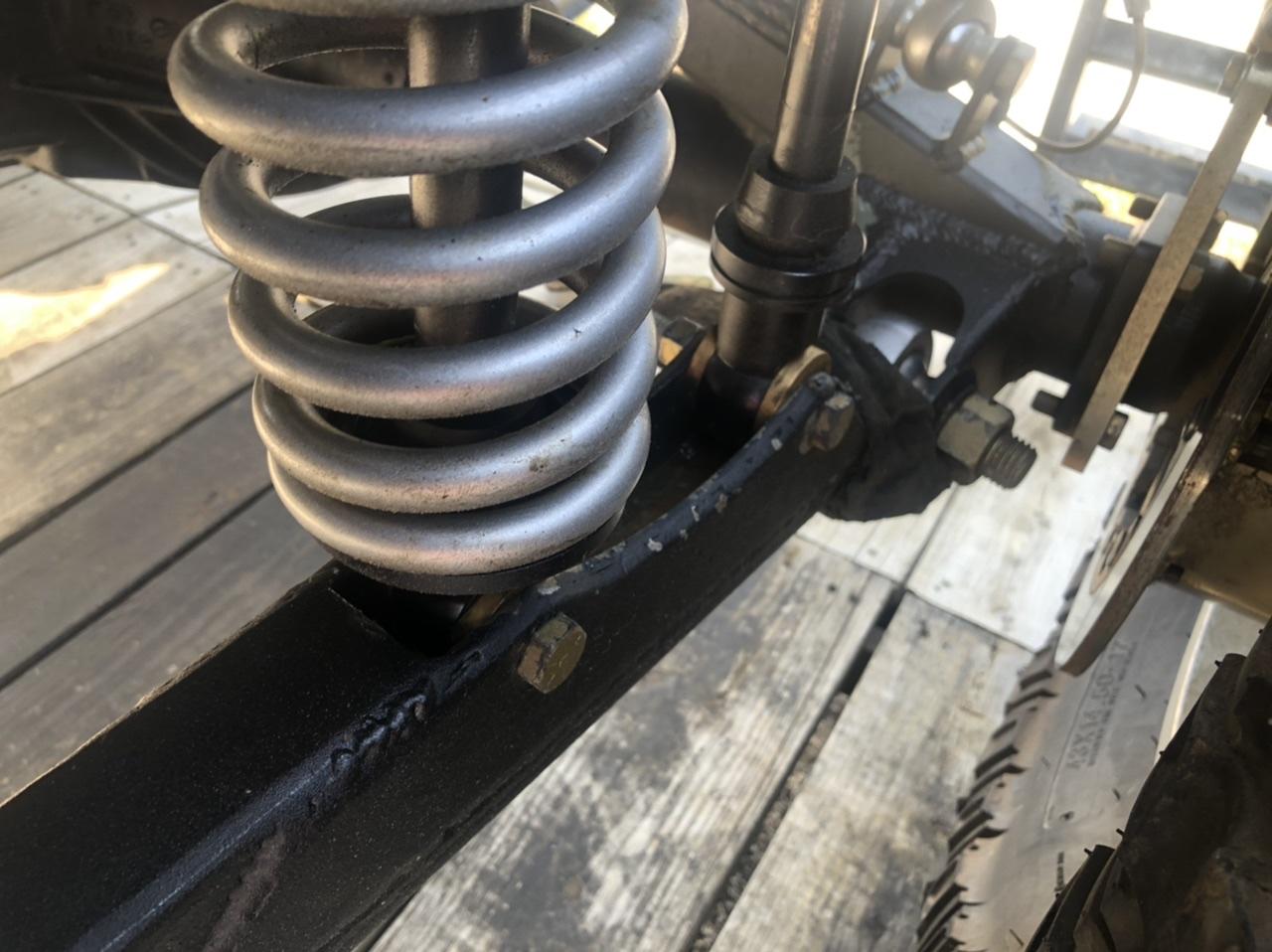

TIG welded everything for the heck of it. Took me wayyyyy too long but I enjoy the process.
Nice weld pic below, I didn't post the crappy ones but they're here :LOL:
What the arm looks like after reinforcement. You can see the HAZ from the inside welds of the structure.
Done and installed.

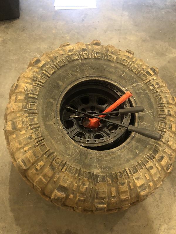

Outside of wheeling, I also managed to locate a good used 43 sticky tire so I could mount it on my extra wheel and finally have a spare.
A million thanks to Lori for it !

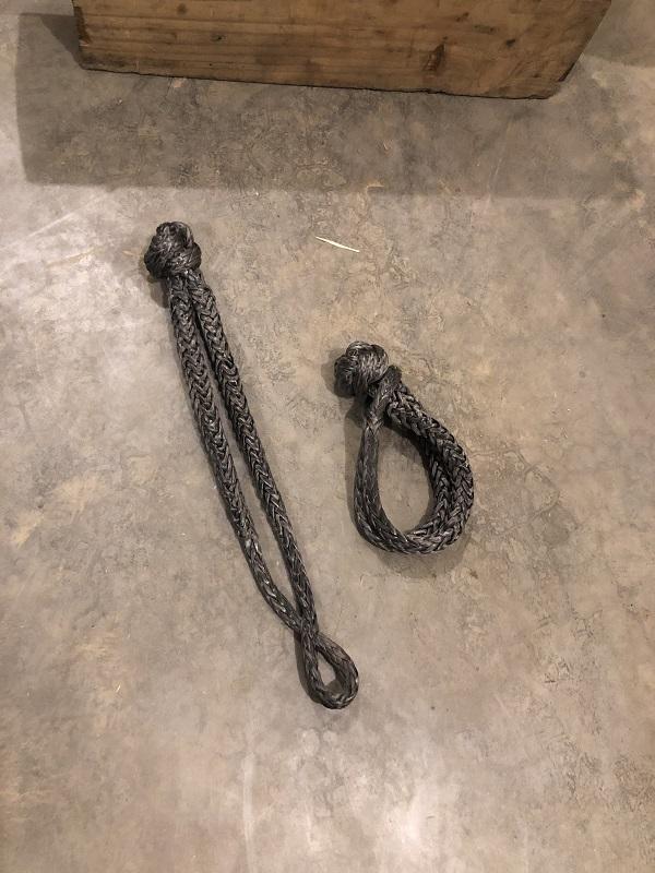

And made some more soft shackles, it's a good time burner and a very useful thing to have.
Unfortunately, bending trailing arms with your previous shock mount design is all too common. Even with the slugged aluminum it's just not enough for the added stress. It wouldn't have mattered which way you had that mount set up.
Running a full length "back bone" is a must IMO. Glad to see that it was an easy fix.
Thanks Chris, I'm glad I was able to bring them back and fix them.
For the next ones I'll look into HT 4130 material and definitely have a back bone from the start.
I'm also not a huge fan of the TMR wobble stoppers that are cureently on my arms and would go back to regular heims on the chassis side and use some shock eye spacers as a wobble control method..

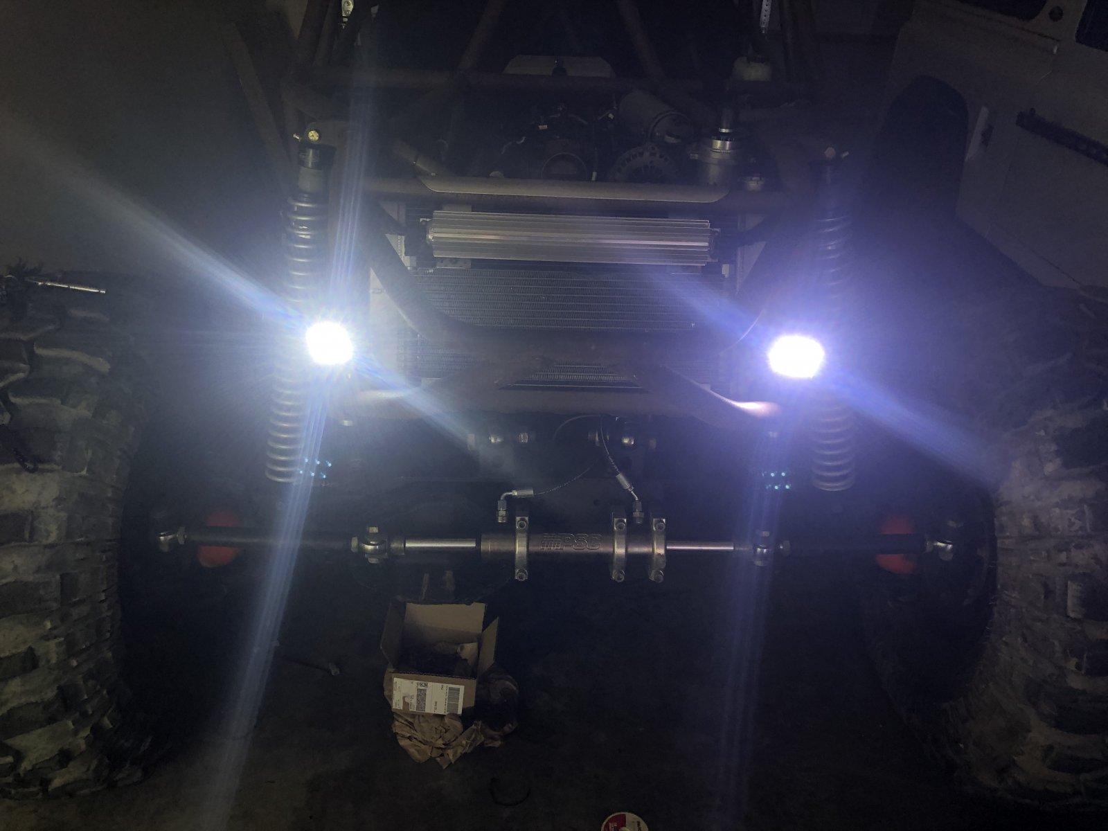

Bent the light bar a few rides ago. Had to drive out of Tackett Creek with no light which was a lil sketch.
Removed it and swapped it for some pods. As much as I loved the big bar and the look it gave it, it also turned me into “that asshole” every time I’d turn it on and blind everybody around.
I’m hoping the pods will be more protected and the light output will be enough for what we do around here.
Everything is done with half decent wire and Deutsch connectors as usual.

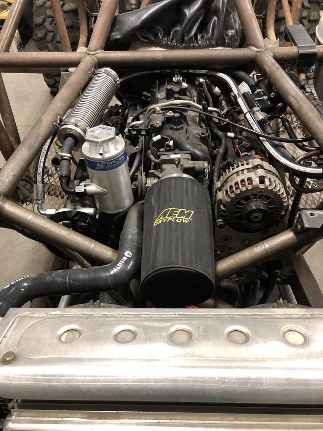

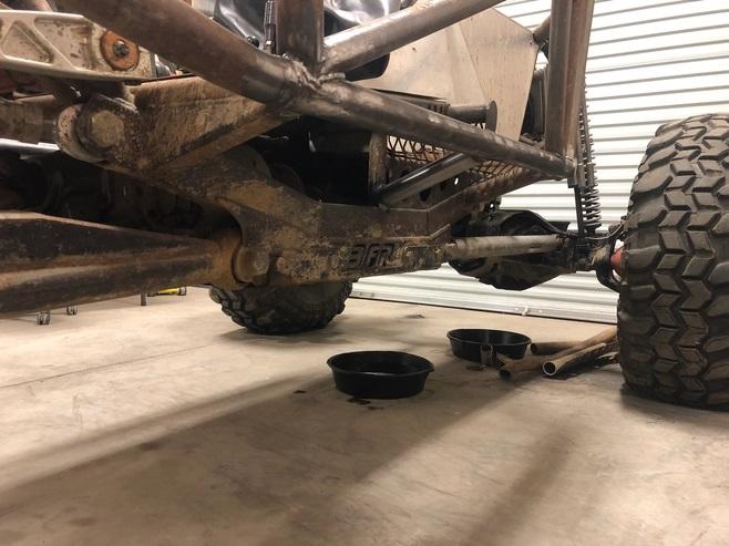

Replaced my P-Pump that died last ride with a new RD steering system (CB-X pump, filter and fancy resi). Moved the pump to pass side, way higher than previous setup. Everything is located the way it is in order for maintenance to be easy.
I chopped the steps that were bent to **** and replaced them with a 4ft piece of solid rod to help distributing the impacts and hopefully let it slide better on the rocks. I also added a .188 wall kicker going to belly.

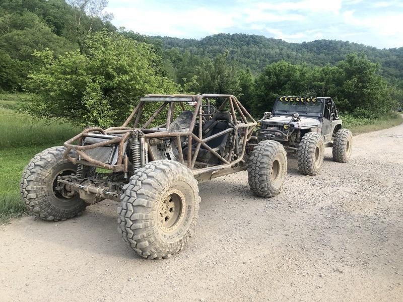

Went to Stony Lonesome for testing last weekend. Rode with Jake Burkey and the BK crew.
Didn't have to turn a wrench once. This rig impressed all day and made everything his biotch.
RD setup delivers ! (I'll write a more detailed report about that in the future). My face had a **** eating grin all the way back home.
