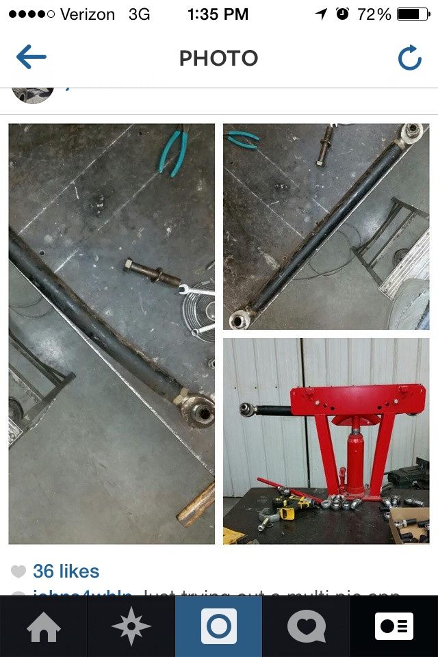

This picture shows it setup as a brake. This was the first lower die. The one I have now is same length as clearance between the vertical brackets of the bender frame. This was I can bend as wide as I can fit in the bender. The small legs are to keep the lower die centered in the frame, this is also why the c clamp is on the top. That keeps the top die stationary to the frame.
I flip the top die over, remove the angle iron from the bottom and this gives me a flat surface to dimple with.
The picture with the dimple dies was long before I added the angle iron.
