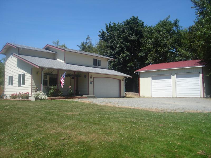

Dude, on the door thing....I presume the peak is going across the length. Speaking from experience I would go 12x12 doors if you can (12Hx10W minimum)!!! On my old shop that I built new, I went 10x10's and **** was tight getting a trailer in...doable but tight!!!...
It's a 26Dx30W with 12' to the truss...My hoist was in the right side, and you can't see it, but I have poked more than a few antennas thru the door insulation lifting a rig with the roll-up open!:haha: Also, when they hang the doors, tell them you want the doors to follow the pitch up the roof, don't hang 'em horizontal....Helps with lighting, and clearance....:;

Well, if you're stuck w/ the door size, at least look into having them run up the pitch of the roof, and not horizontal....the very slight added cost will be well worth it, trust me!!!:D

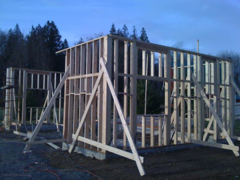

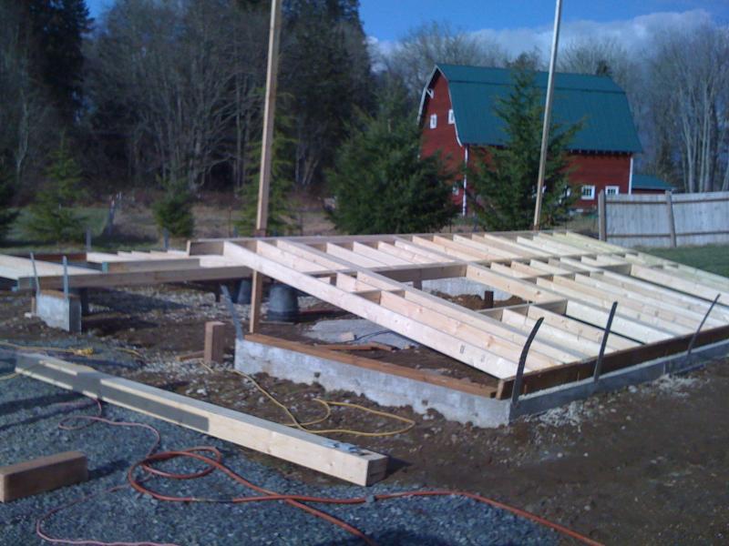

Progress has started happening after we got home from KOH. Here are some pics, more to come later.
I also resolved the 12' limit in wall hight. I ordered all my trusses to be valted up 2' so I will have 14' of head room for a lift some day. Also ordered roll up doors not the slide up doors. The roll up doors only take up a 2'x2' area just above the door opening.

A pic from last night.. its starting to look like a shop!! :cheer:
