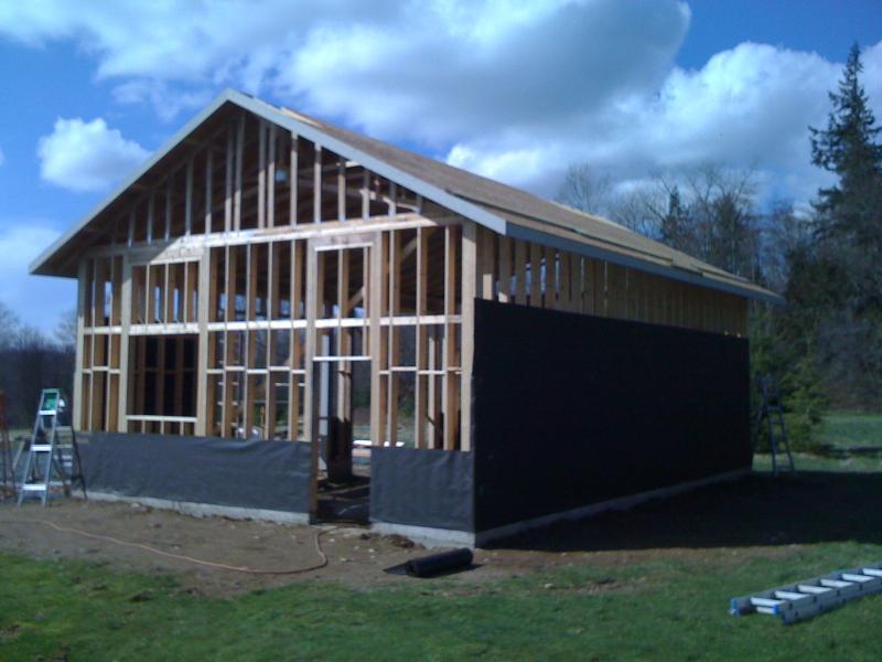

Did lots of paper work this weekend and started on the siding, got the front wall almost all done and started on the back wall. Roof should be going on tomorrow.
I am interested in laying the tubing in the slab for now and want to have an in-floor heat guy come out and take a look at my building and help me lay out the zones and select the right tubing for the job so maybe one day I can have a heated floor. Is there anyone on here that can help?

If you lay out the tubing...... If you do this before you get inspected for your concrete your going to be required to have all of the insulation up to code. Or if they even see the tubes sticking out the inspector is going to ask questions.
On another note. It cant hurt to put in a couple of extra footings in the work area of the floor with anchors in them so you have the ability to pull down or at least be able to tie something down while lifting.

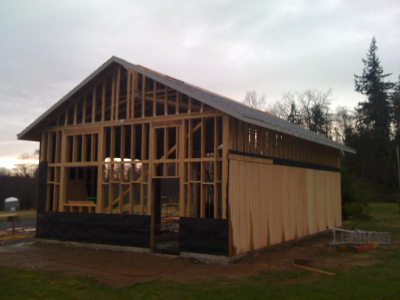

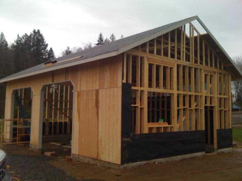

Some more siding went up last night... Can't do much more right now cause we are waiting on windows. The roof is getting done either today or tomorrow.

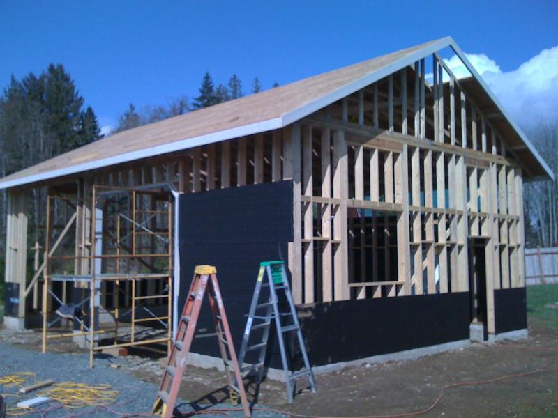

Got the roof done last night and went and got some nice shop lights. :cheer:

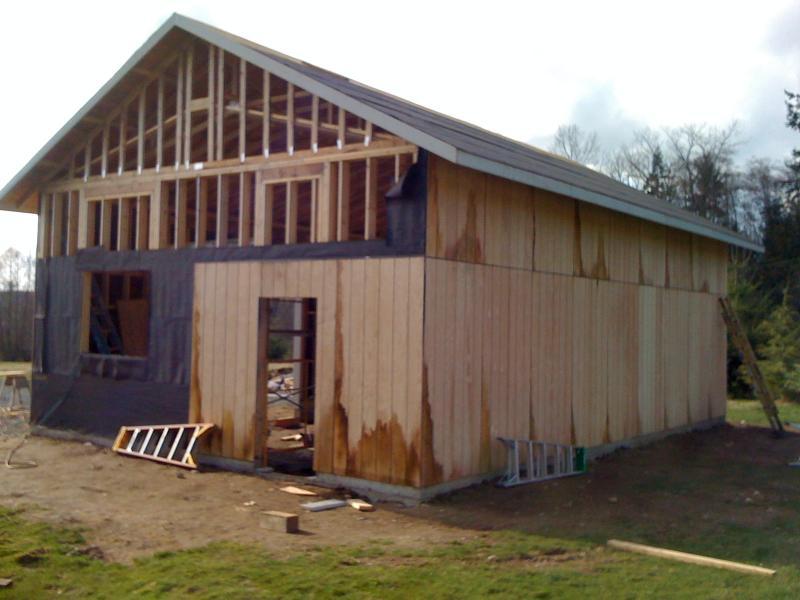

Thought I would post some final pics of all the wood work. Its looking really good.
Next on my plate is working on doing some painting, gutters, trenching for power and water and bringing in some fill for under the slab. Also the garage doors are should be here next month.
