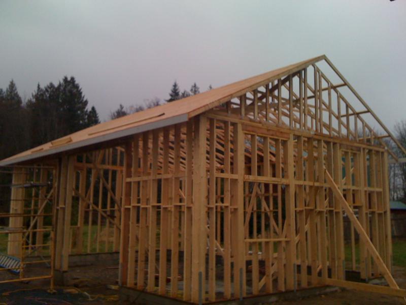

More progress last night... got all the trusses up and started sheeting the roof. More to come after today.
Its really getting exciting now, I can start seeing where I want to put my tools and stuff like that. :awesomework:

More roof sheeting done.. not too exciting today but it keeps getting closer.
