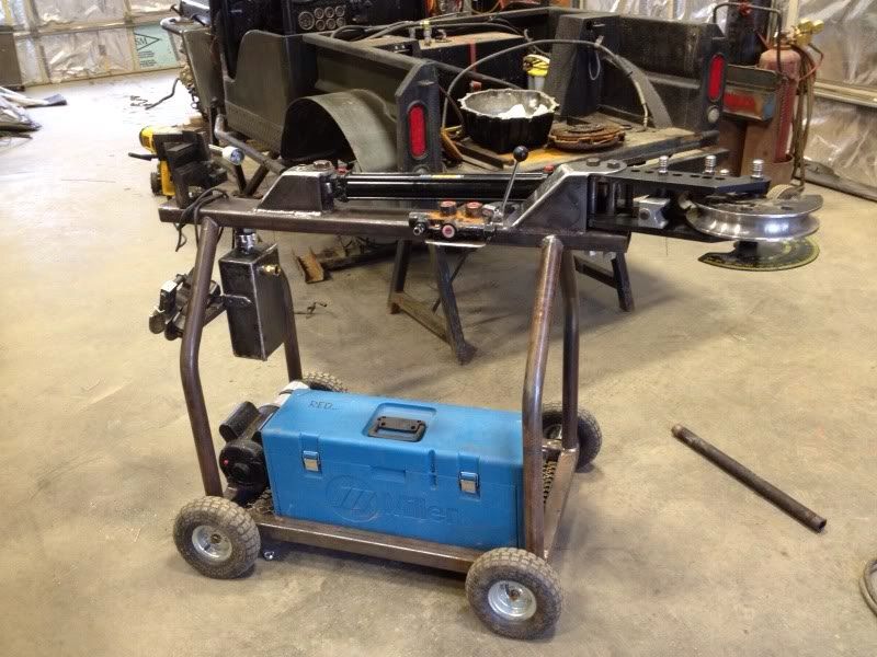

well I did get a little info off a guy in my same province but it wasn't enough or too specific. I thought with all the tube being bent on this site someone would be able to chime in. anyway he said " go with a 1.5 or 2 hp with a slow rpm speed. the slower the speed just makes it easier to control. I forget what my pump is but yes it can bend .250 wall tubing with no issues but it does not like 3/8" wall"
that being said I still don't know what size tubing he was bending with .250 wall. I will post a pic of his bender as it kinda what im looking to build.

Thanks rokcrler . I will post a nice write up when I start to do my hydraulic conversion. Here's two pics of the local guys and two pics of another one I like. Mine will be somewhere in between.

Those are the ones we modeled ours off of. Unfortunately, it still isn't done but we've been bending the **** outta some tube with it!
I def. notice more people are using a high 3450rpm motor. Bradzuki would u mind telling me how many rpm your motor is on your tube bender?
