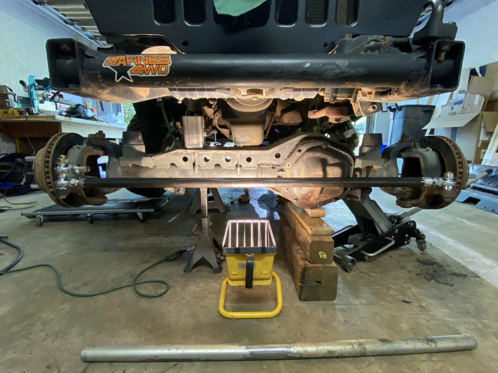

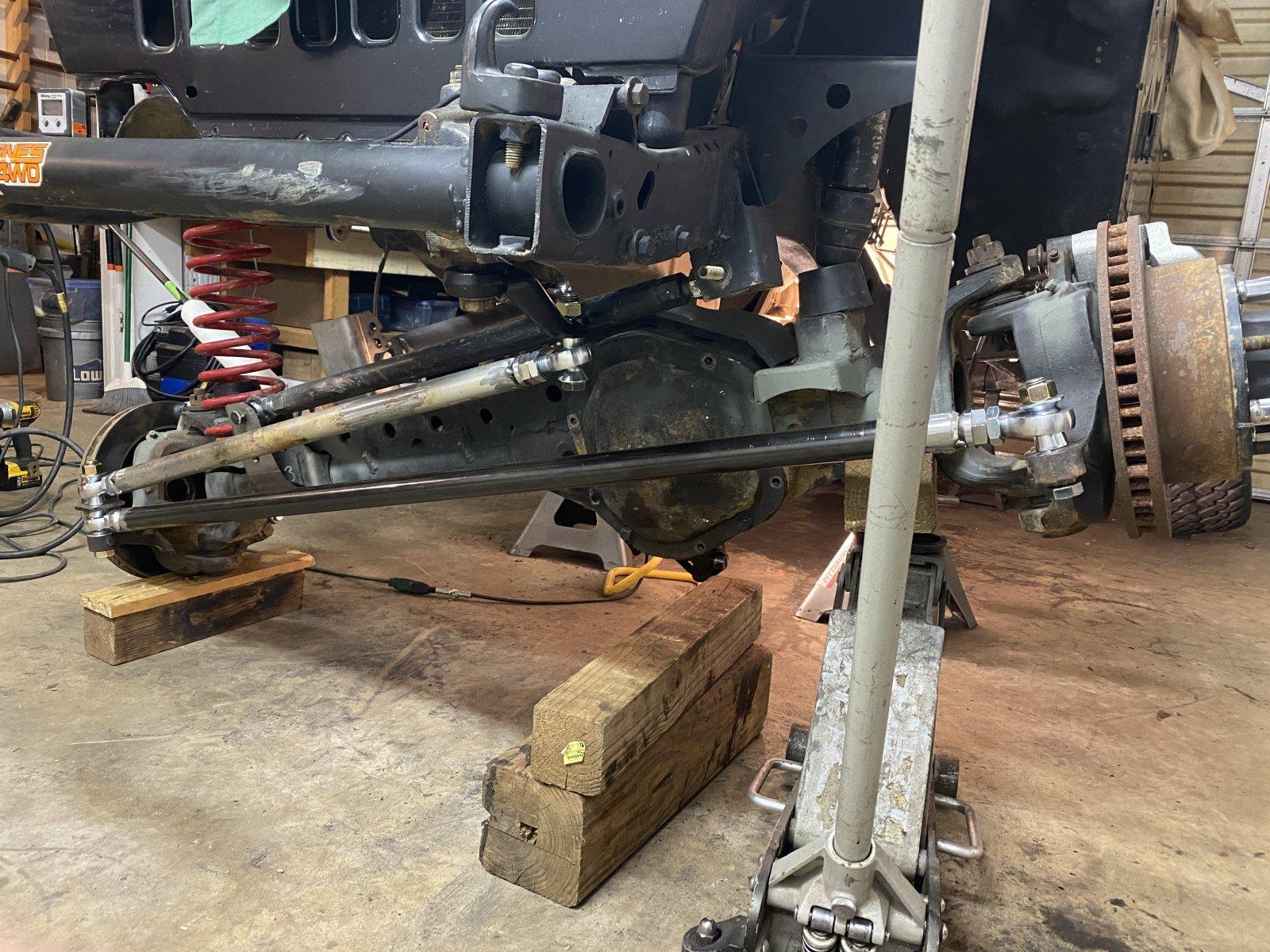

I would get rid of the y-link steering set up and go to full hiem joint cross over steering.
maybe put a piece of tube diagonal in that door too, to keep that perfect rock out of your lap.
x2 on the heim joint steering.
The cross over steering is in the works, unfortunately I just bought a new house so a lot of time has been dedicated to that and trying to get it to a more livable state. The LJ is currently on the backburner while I situate the house and the new two car garage!

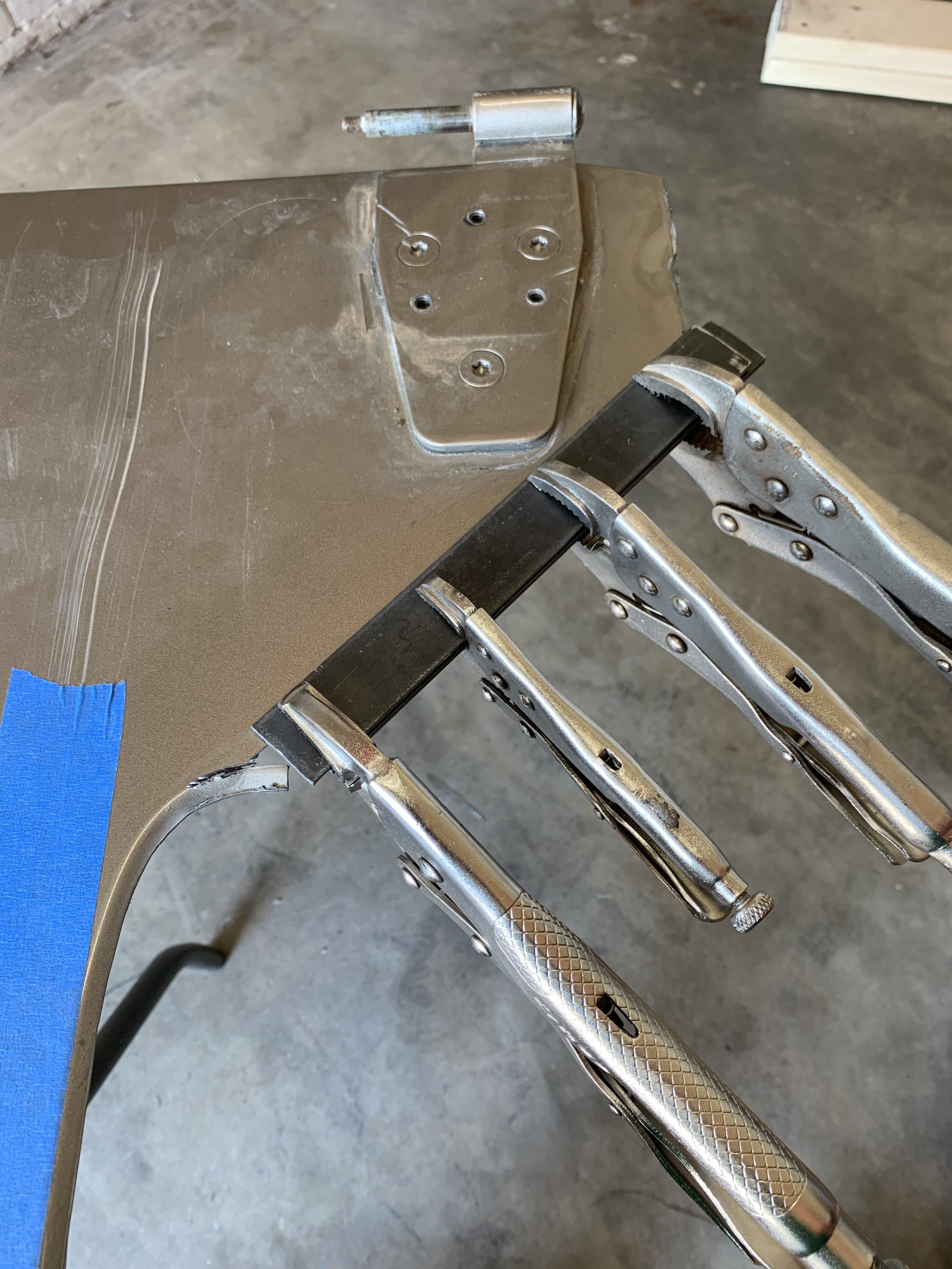

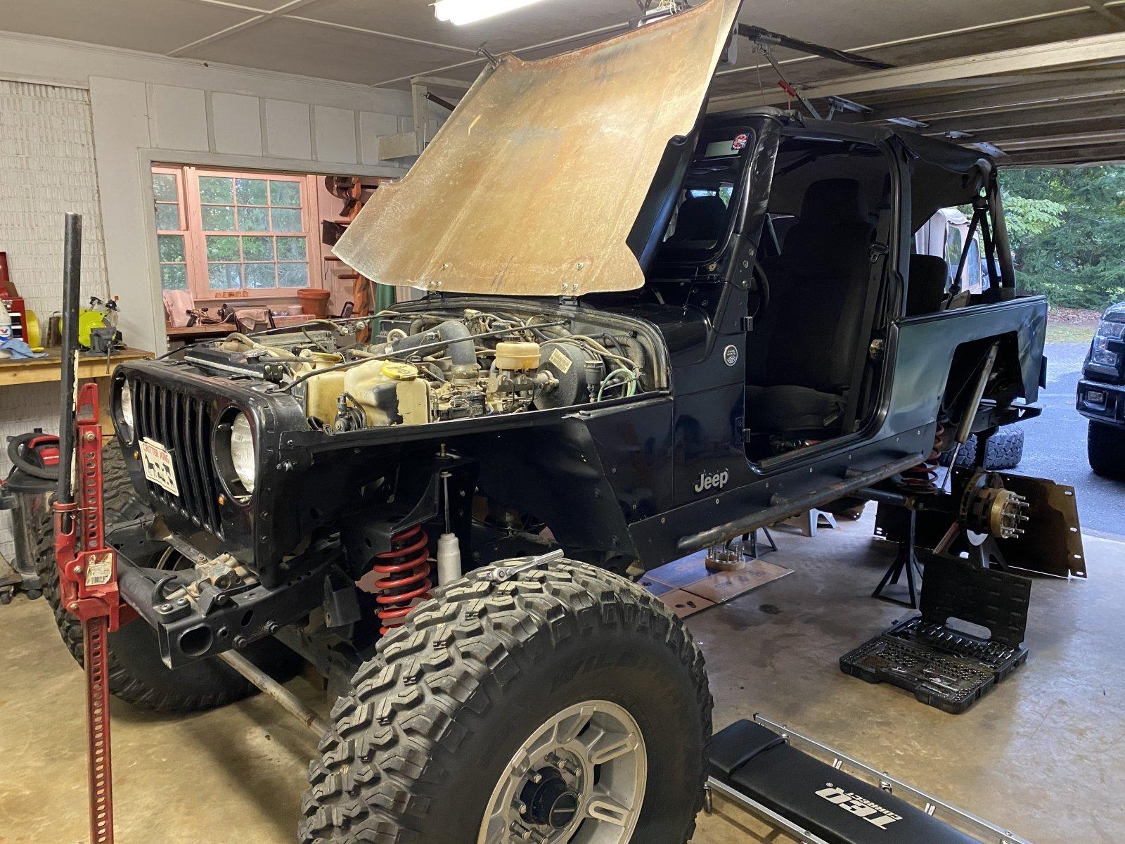

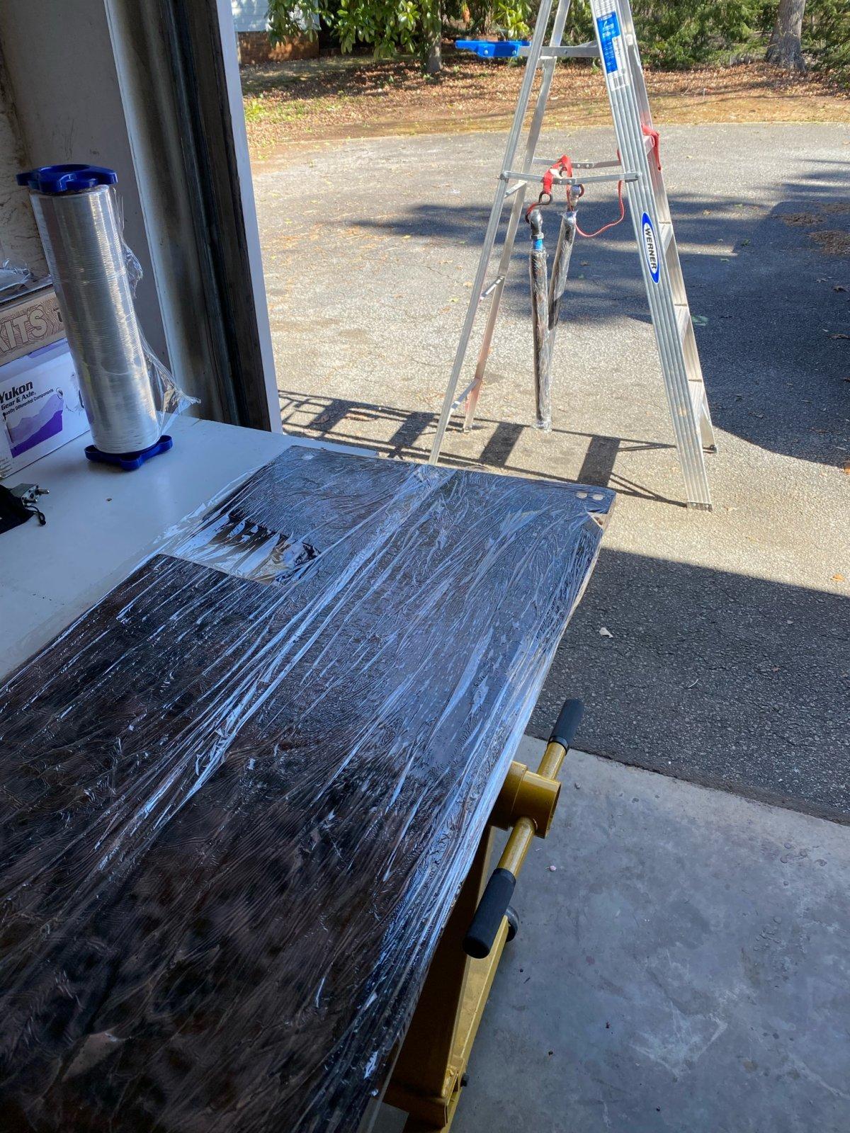

So like I said above, the LJ had to get placed on the backburner over the last few months while I bought a house, prepped to move, and then disappeared to the Grand Canyon for a month. The new house is taking up tons of time but, some nice things is I now have more garage space to work. I'm hoping that I will get a sub panel and some electrical laid into the garage soon to start up welding again and get those doors done. For now, here's a few small updates for the LJ.

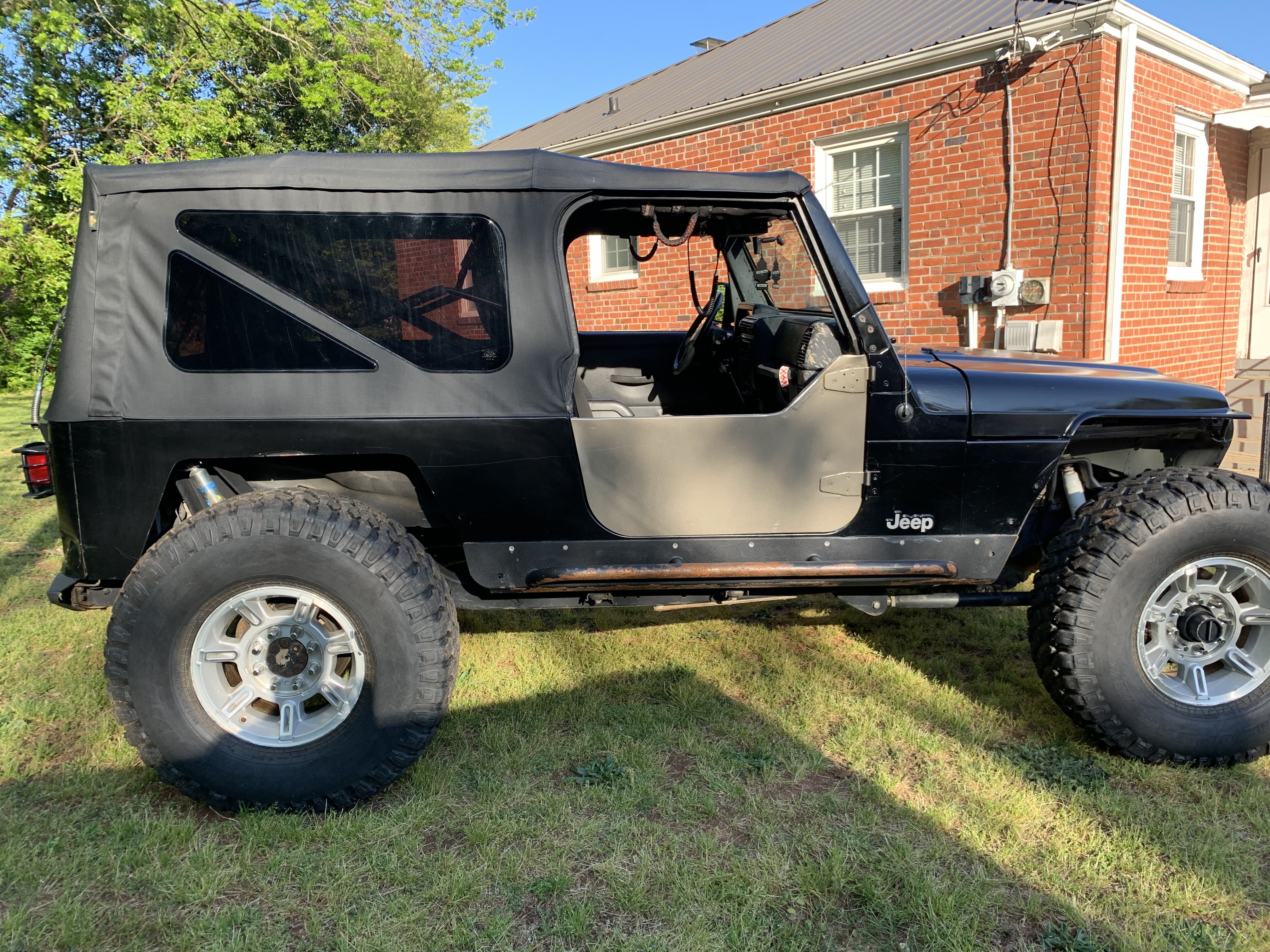

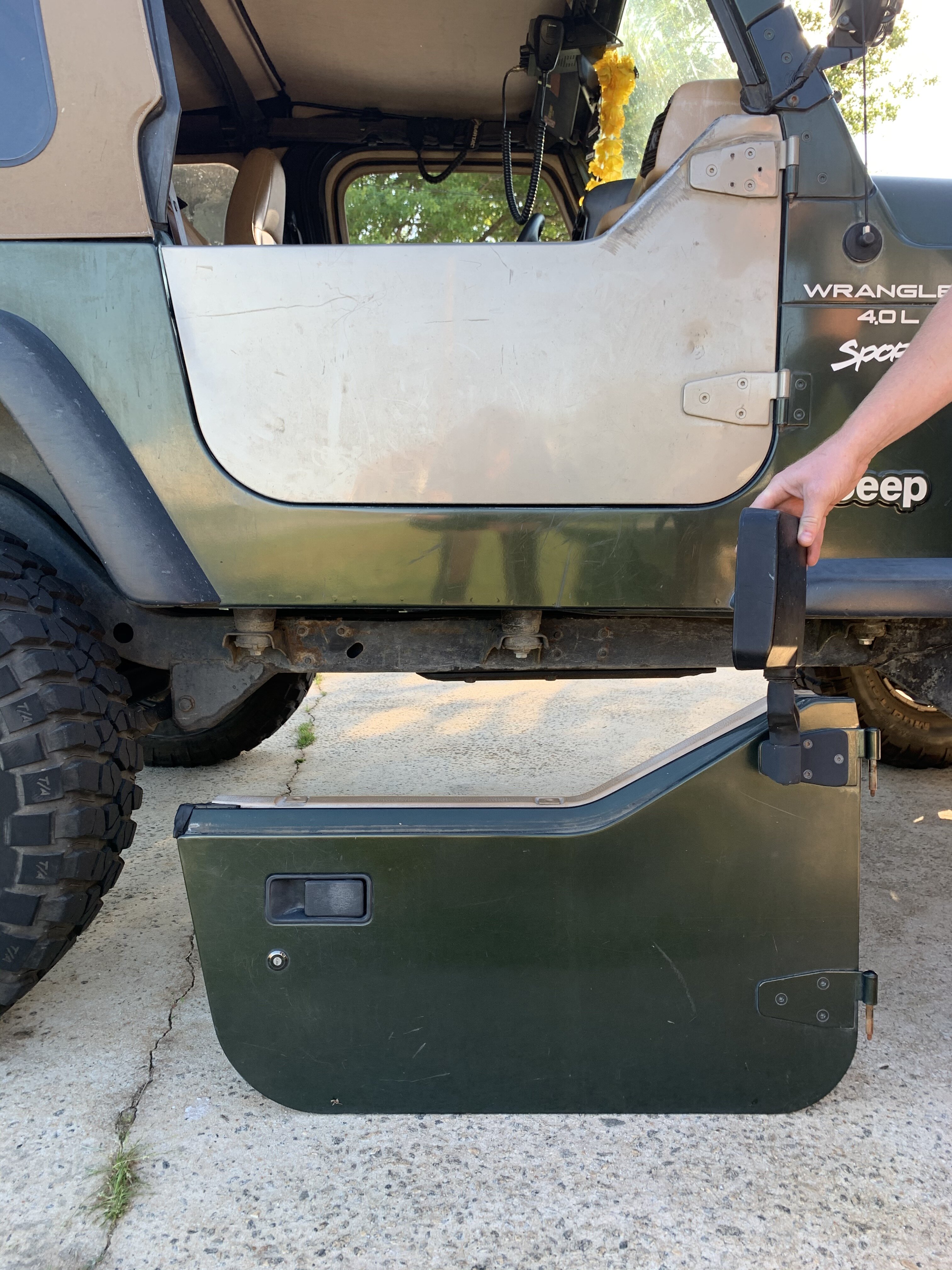

I did manage to finish the cuts on the doors so they are officially skins as of right now. I really like how they came out and think they are fairly nice compared to stock doors. I elongated the lower portion of the door and made the kick up steeper. I was ok with this because I will never want to run uppers on these doors. If I want protection from the elements I will simply use the full doors. Here's a couple shots of the door on the LJ after and my not so great attempt at bending the kick up to match the lower portion of the door. There is also a shot here of the door I cut compared to a stock half door.

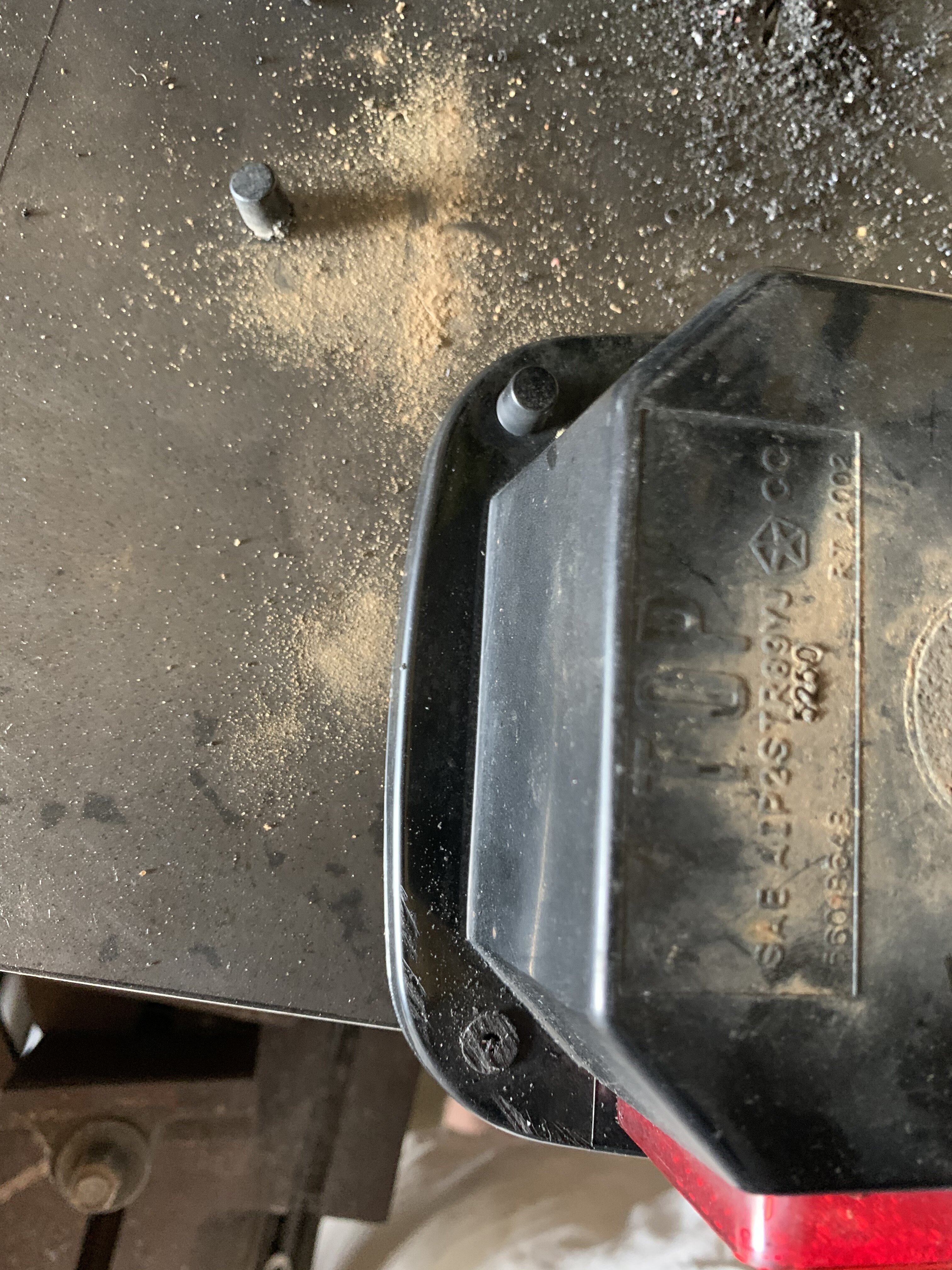

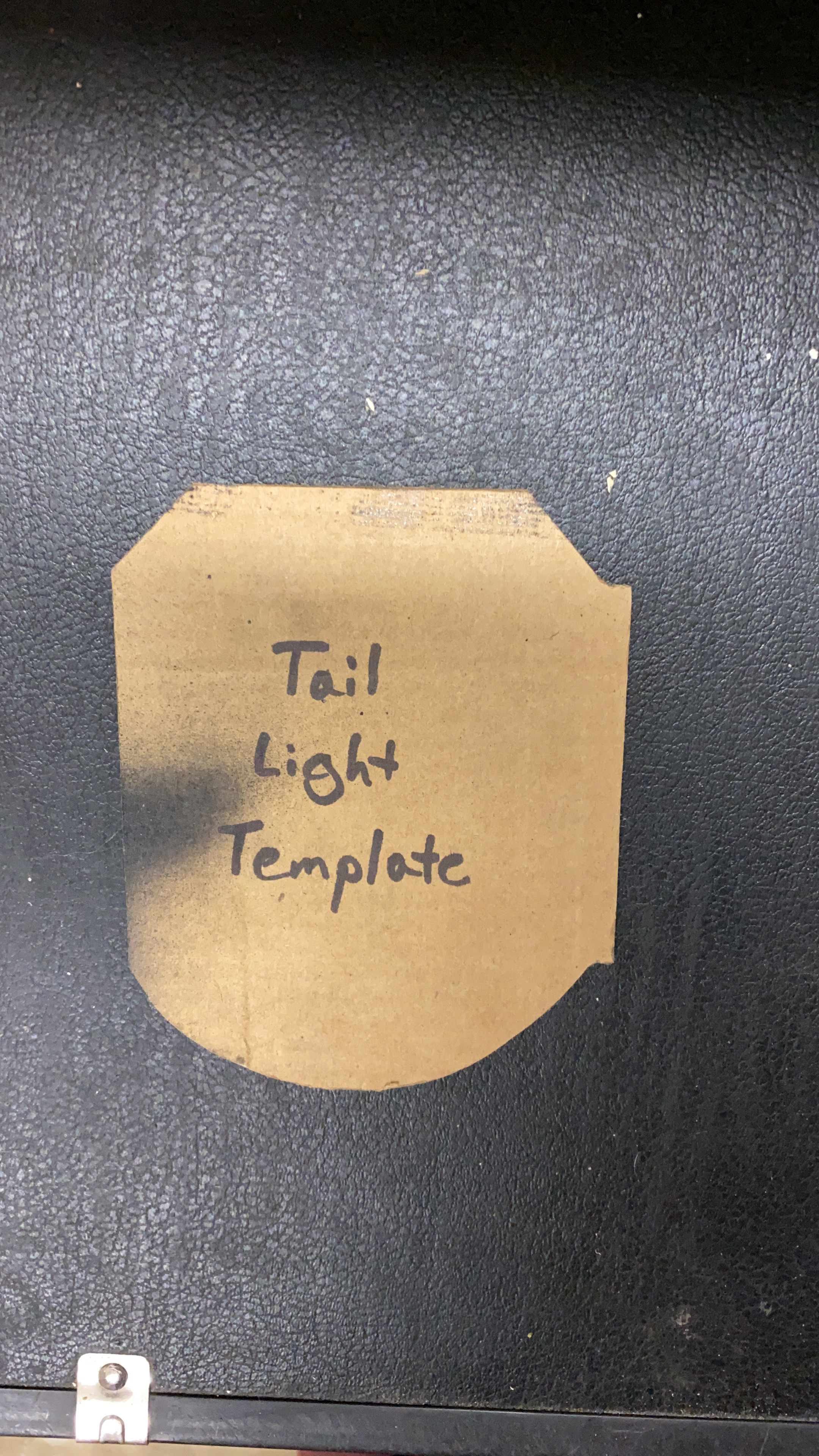

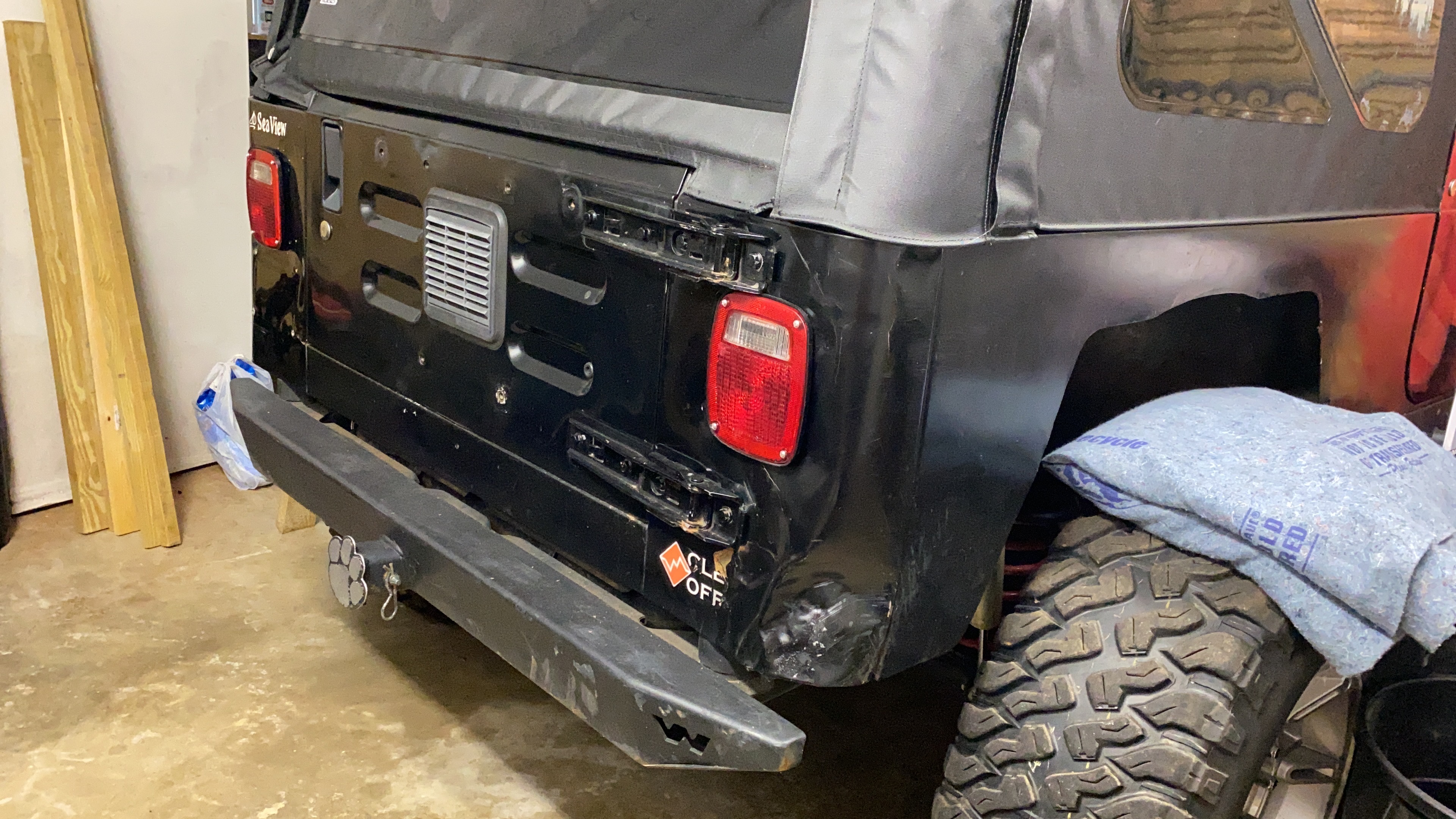

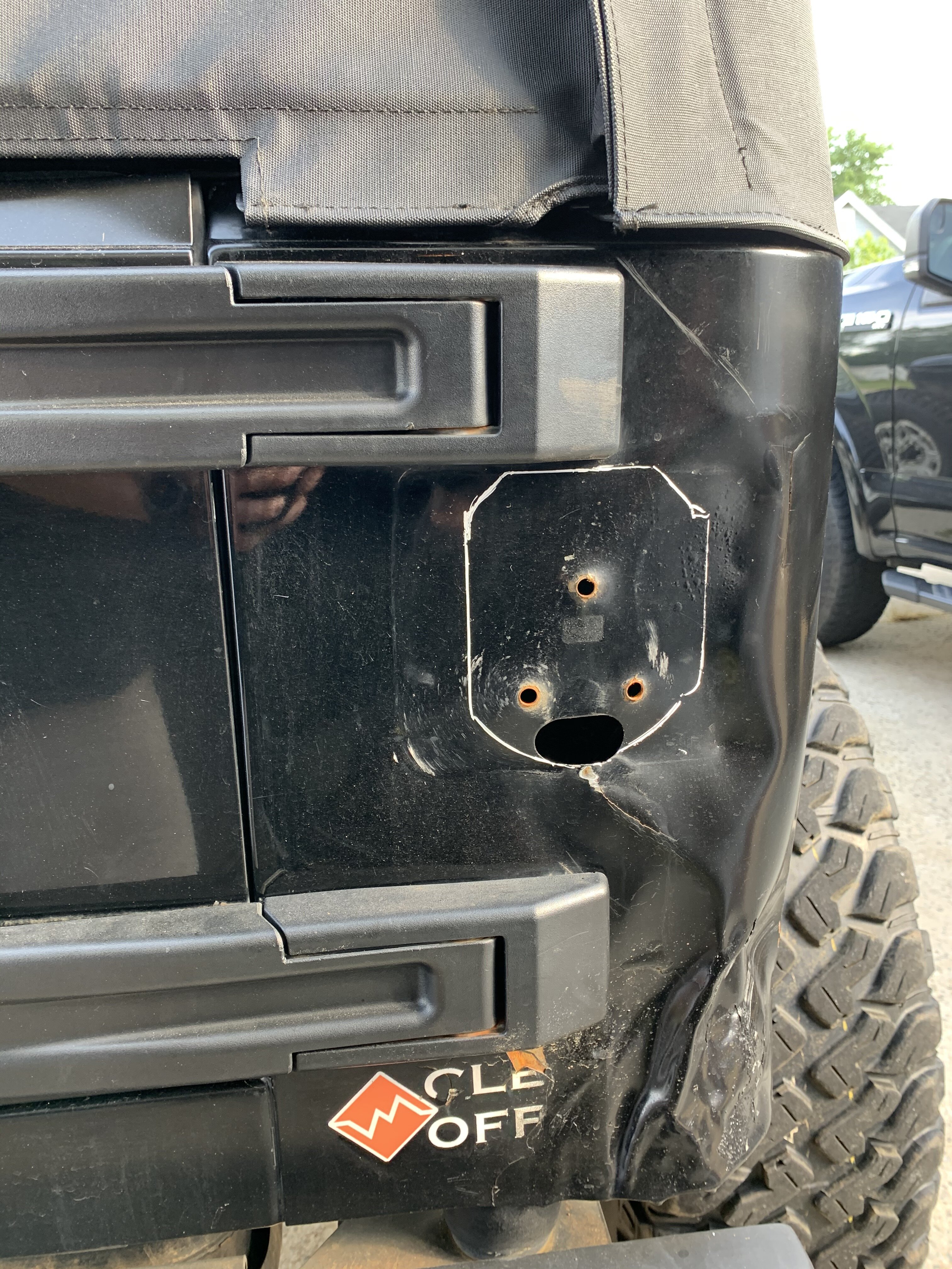

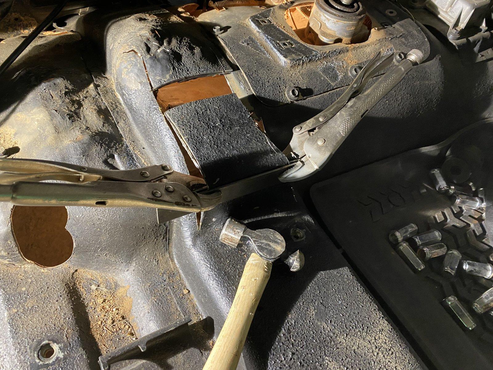

With the doors at a good stopping point, I decided to strip the roll cage of the stock padding to prep for some additions. I also finally ditched the terrible safari tail light guards. Yes they have kept me from smashing a tail light many times but they have dented my body panels in the process. So It was time for some recessed lighting. I took the stock tail lights and recessed them into the body by creating a template (I can scan the template and upload or share if anyone is interested) and marked out where to cut. I kept the opening tight as possible and cut the plastic nipples for the screws off the back of the tail lights with a bandsaw. I used some longer sheet metal screws to secure the light into place. At some point when it gets back on the road I will need to come up withe a way to illuminate my license plate again.

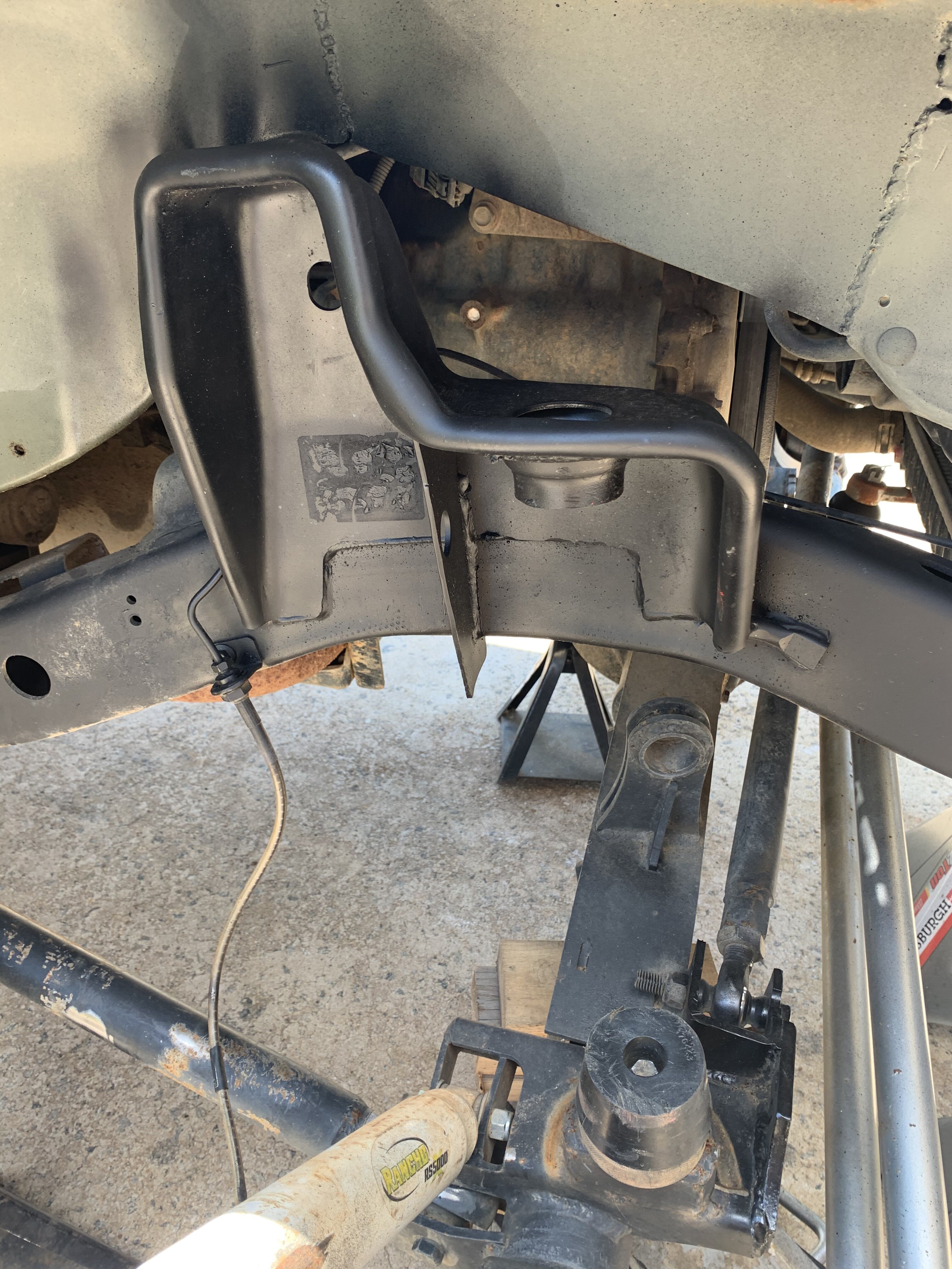

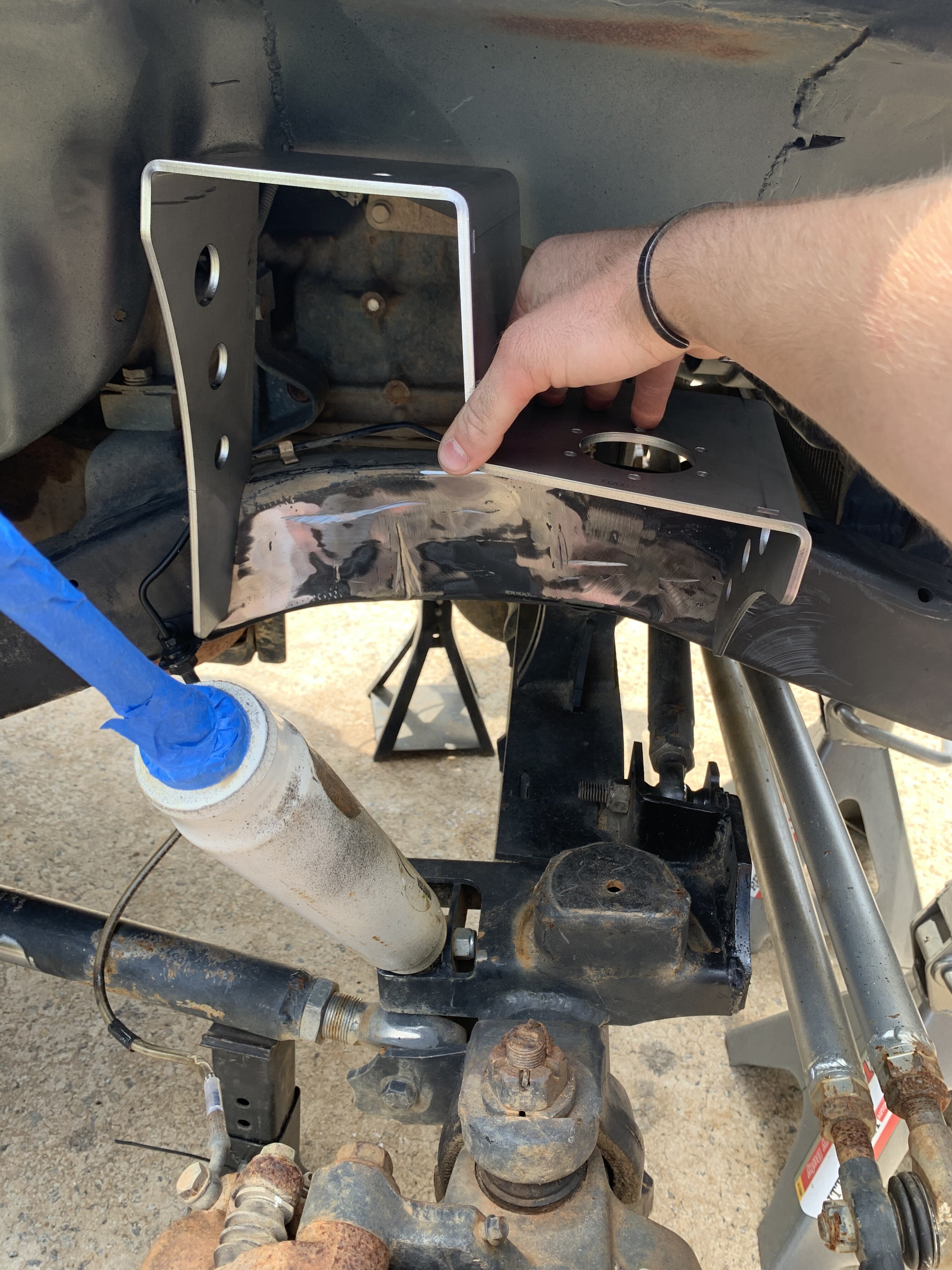

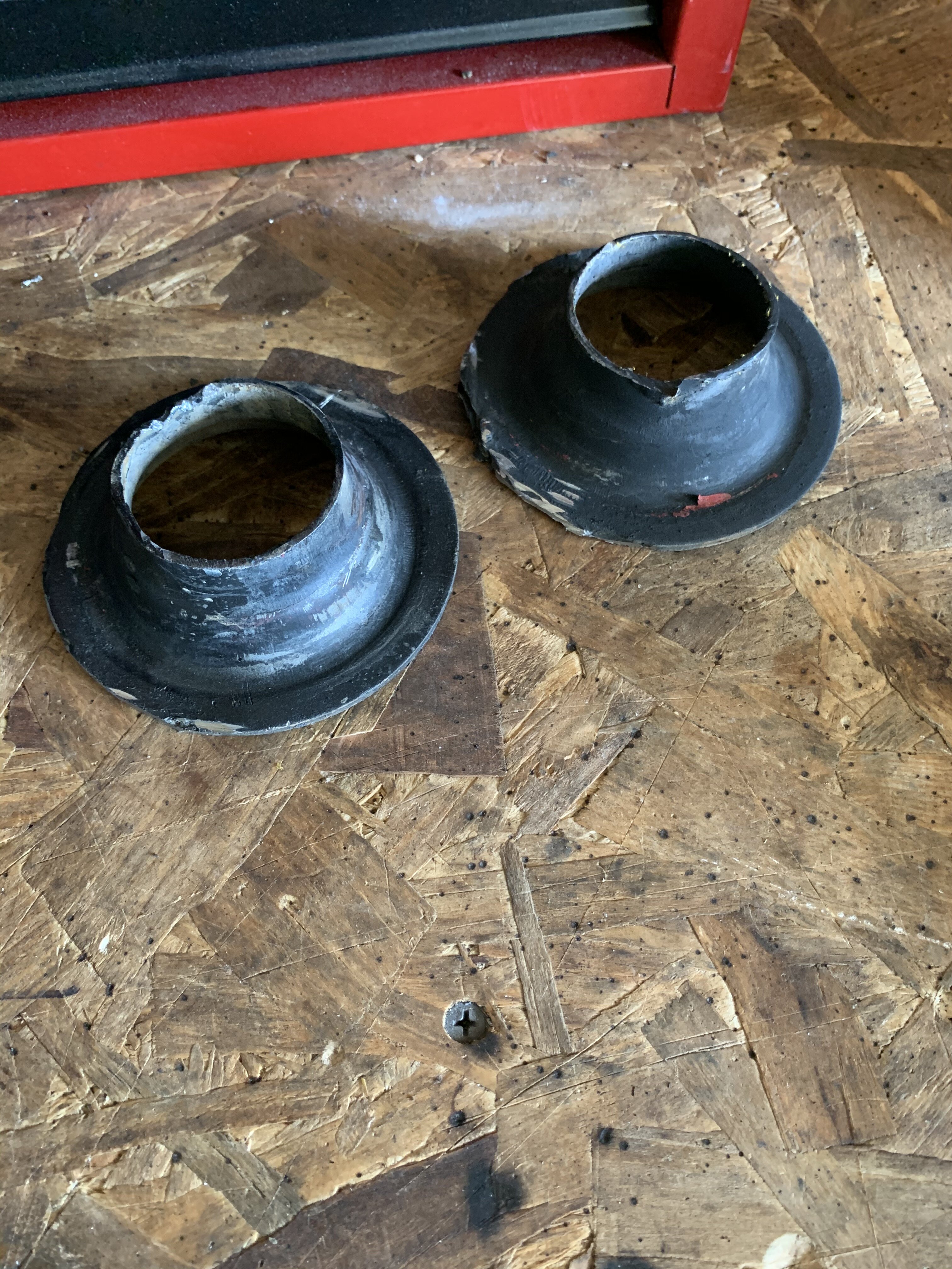

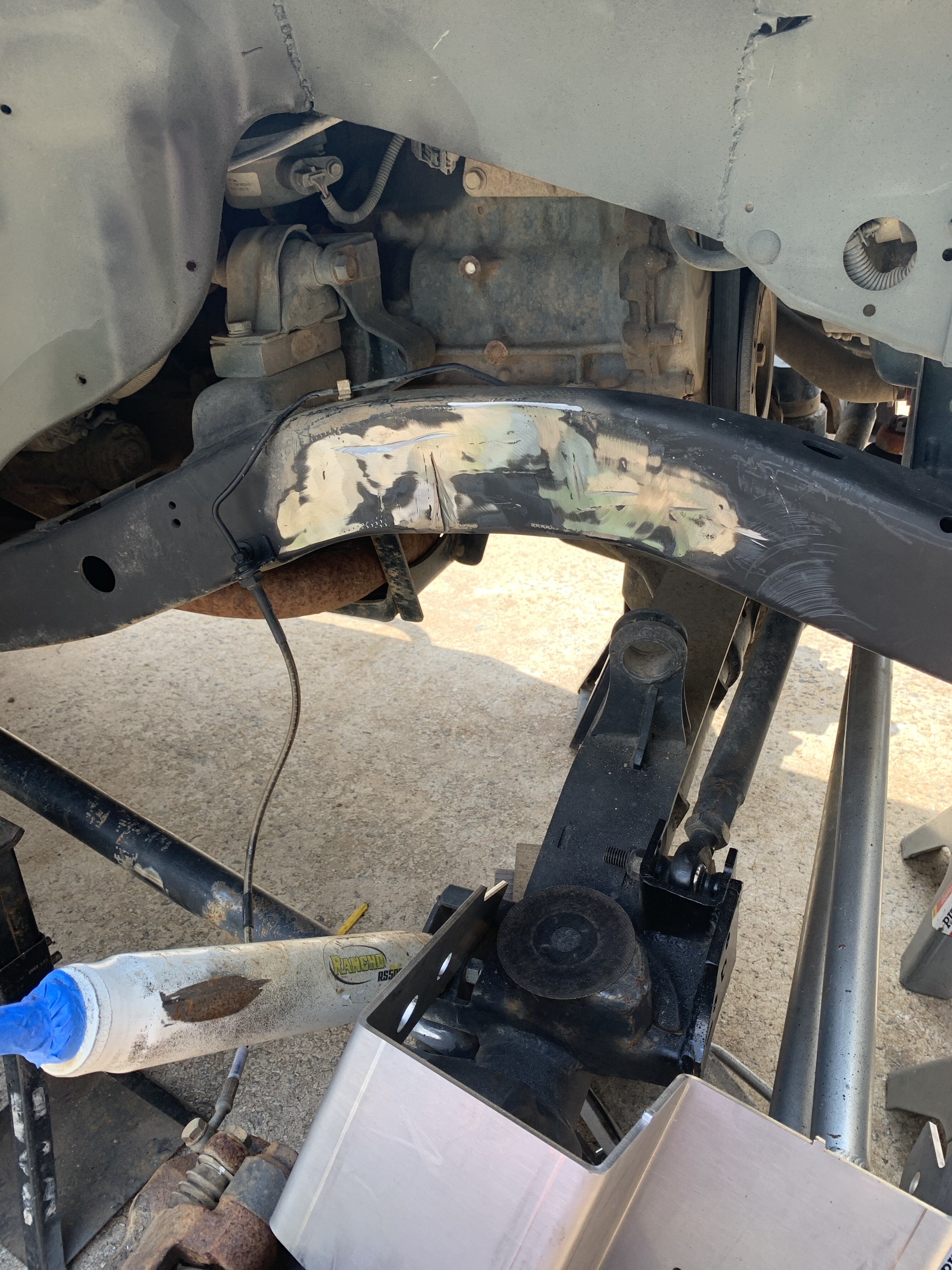

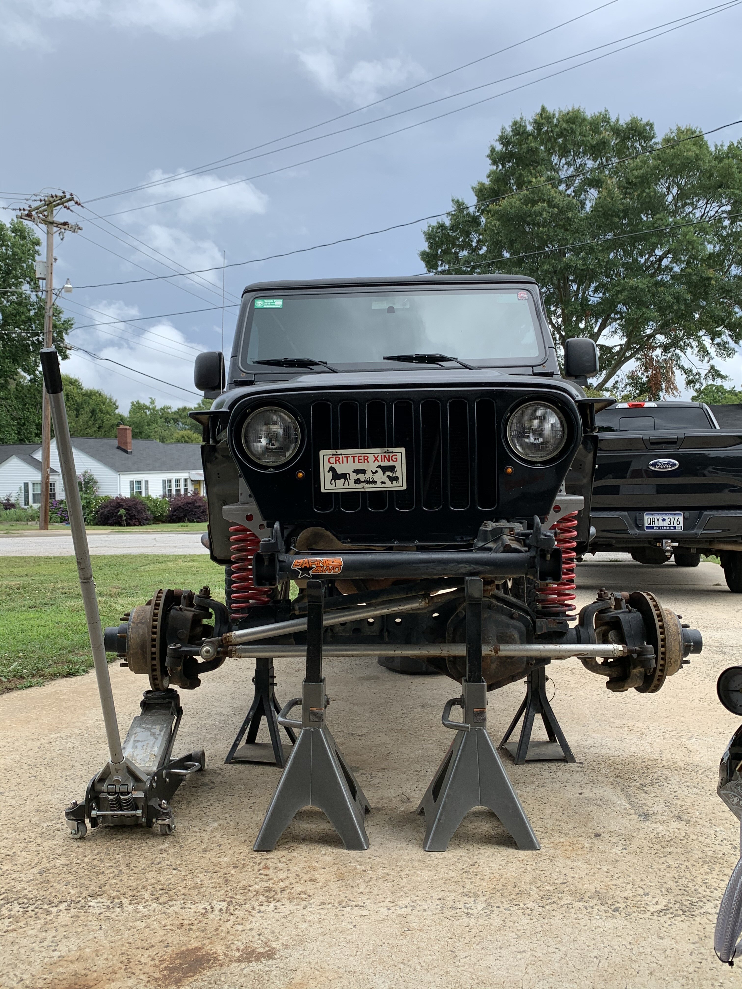

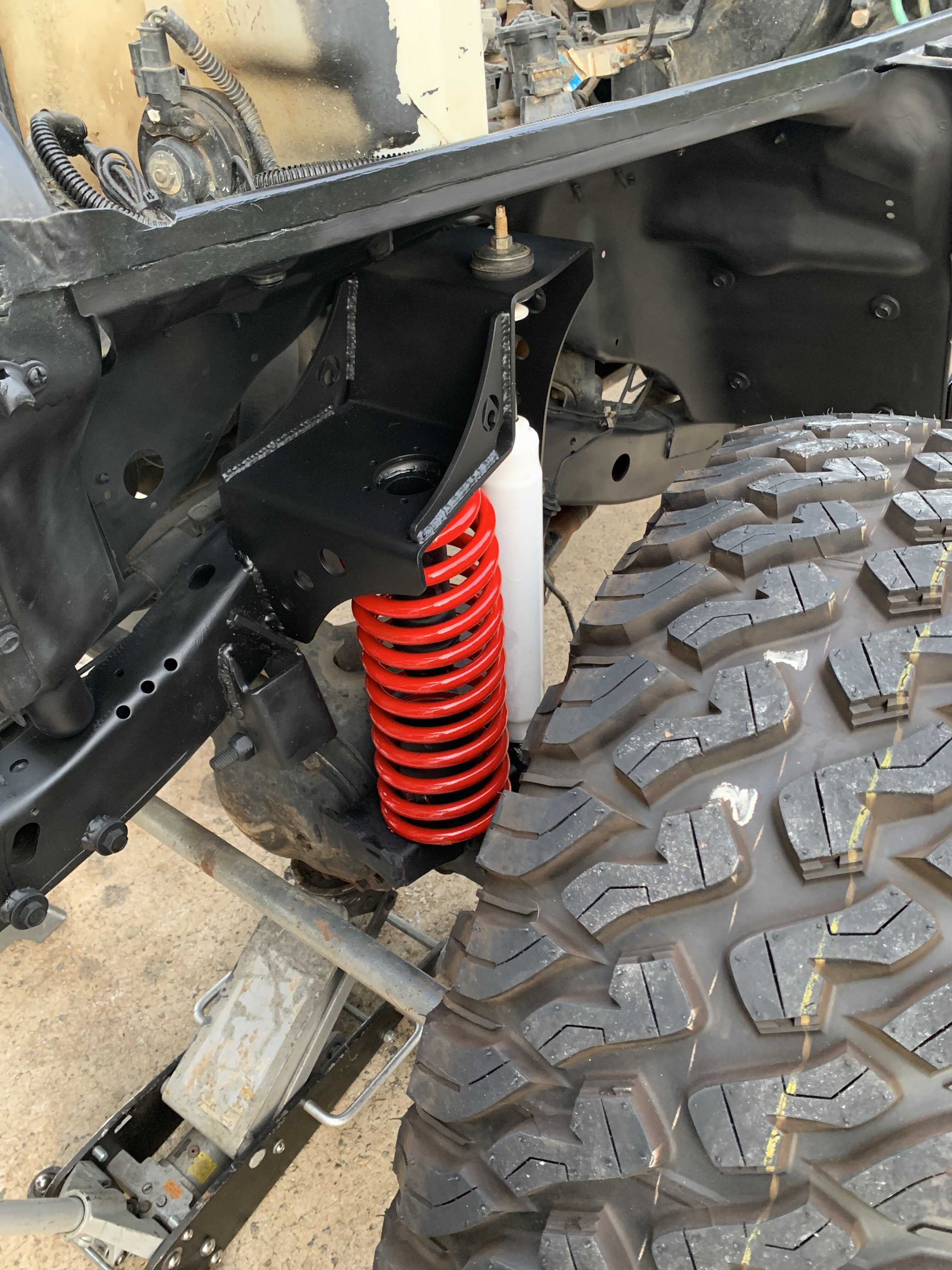

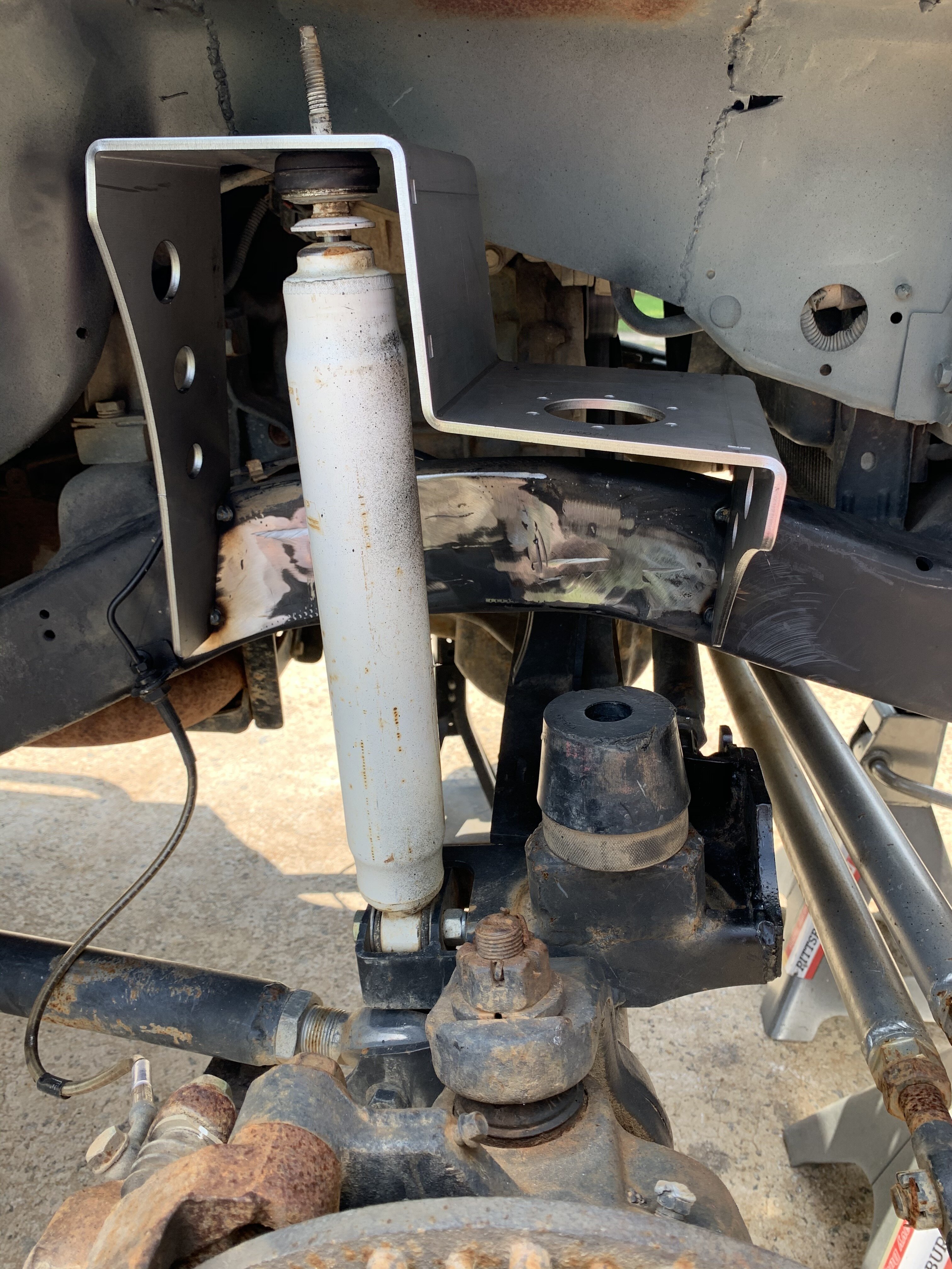

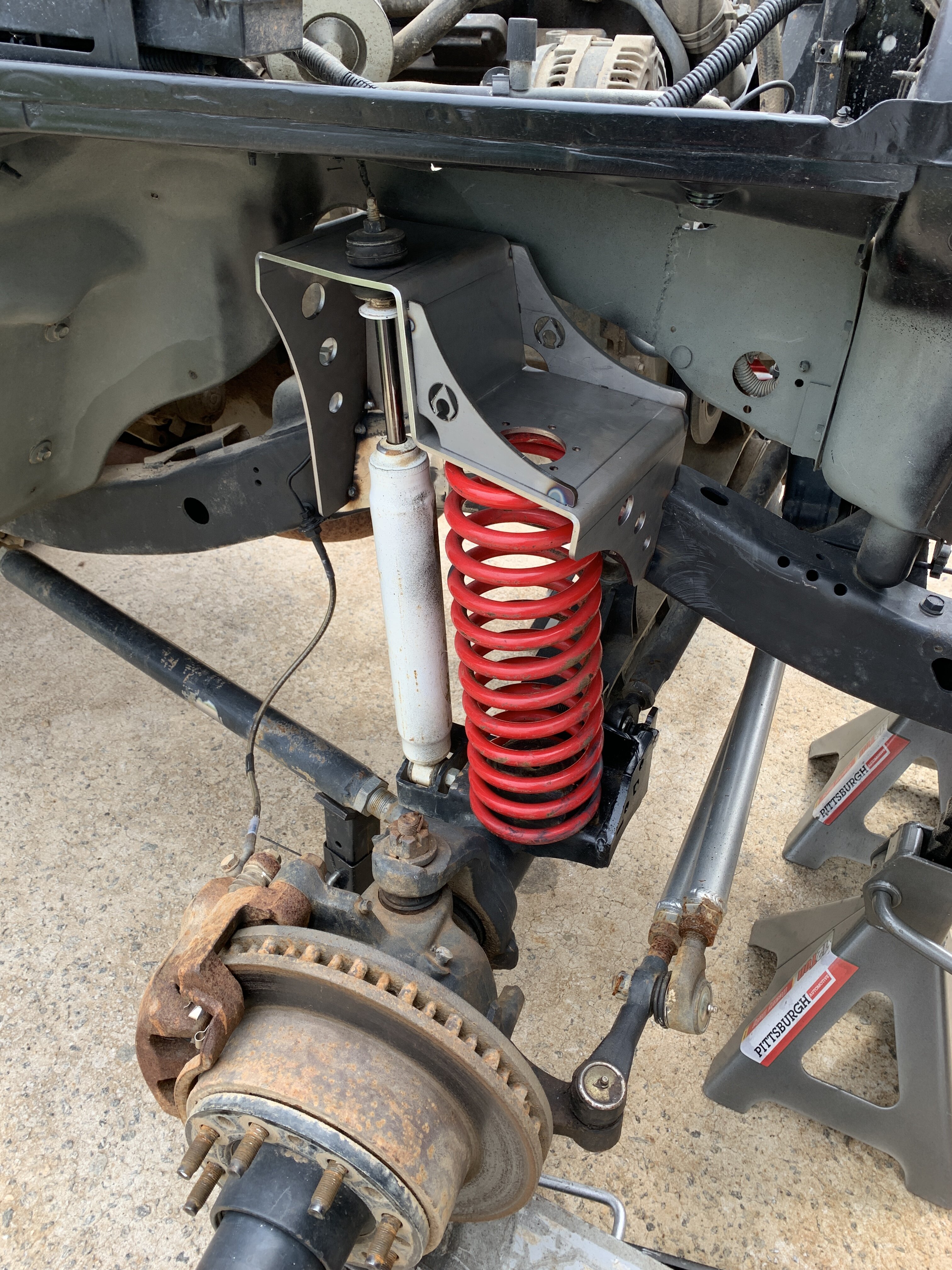

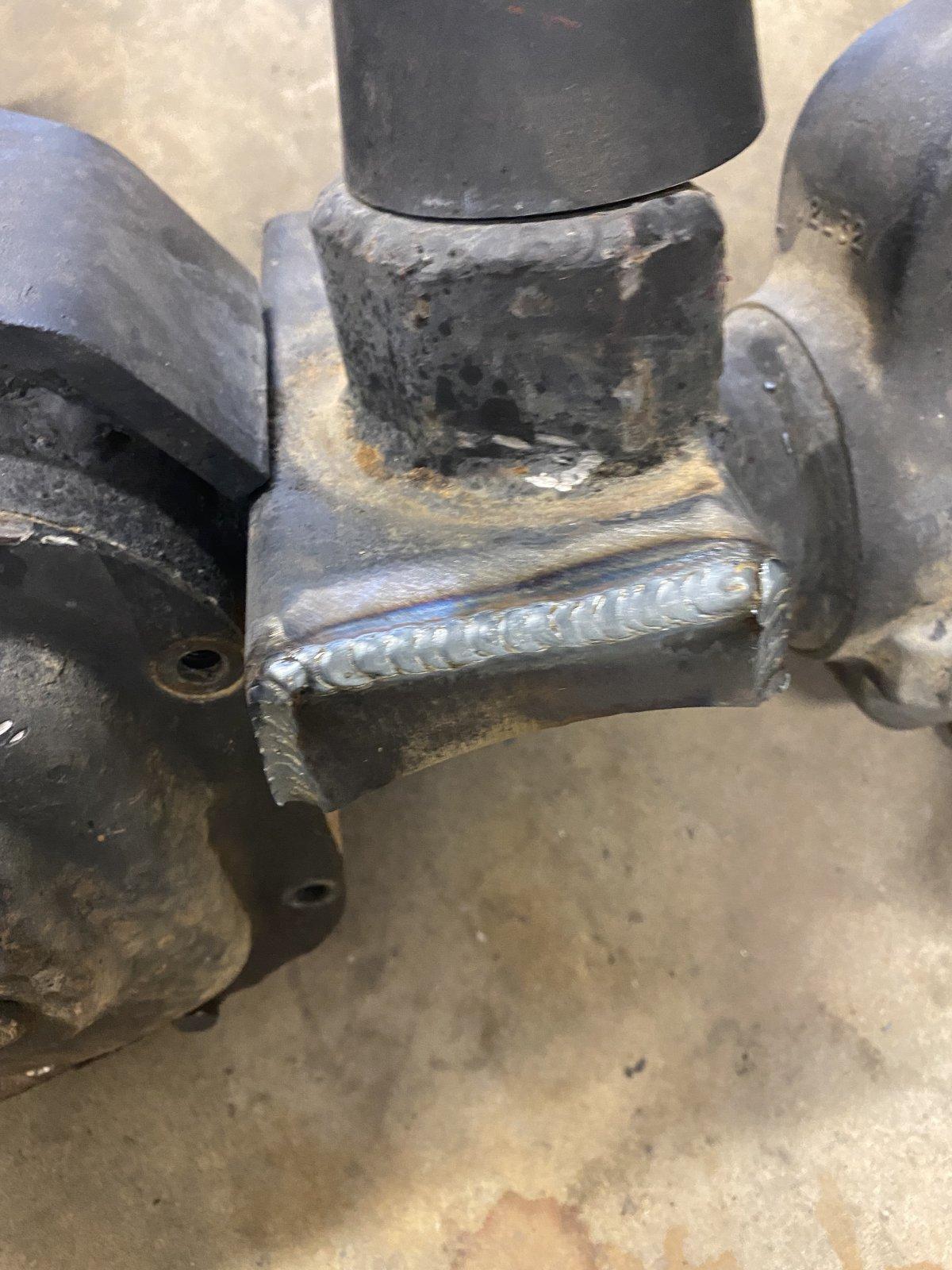

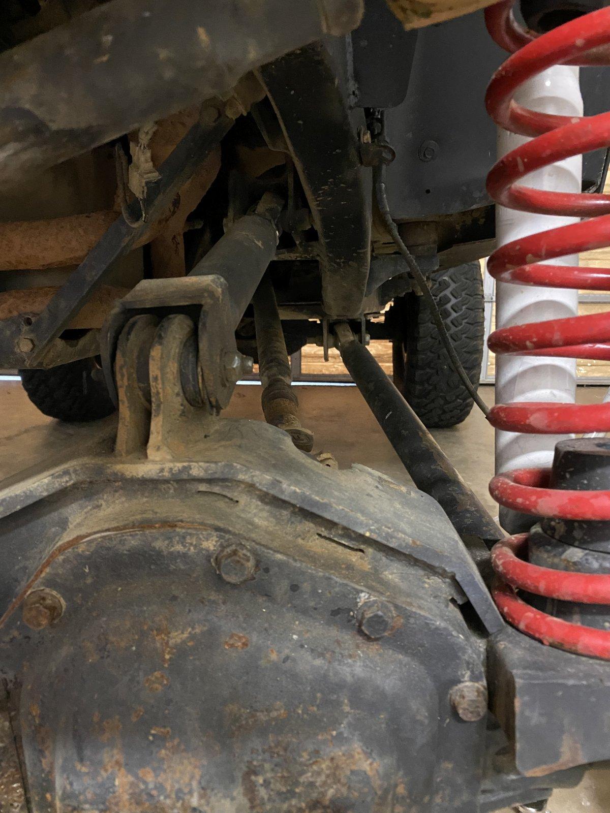

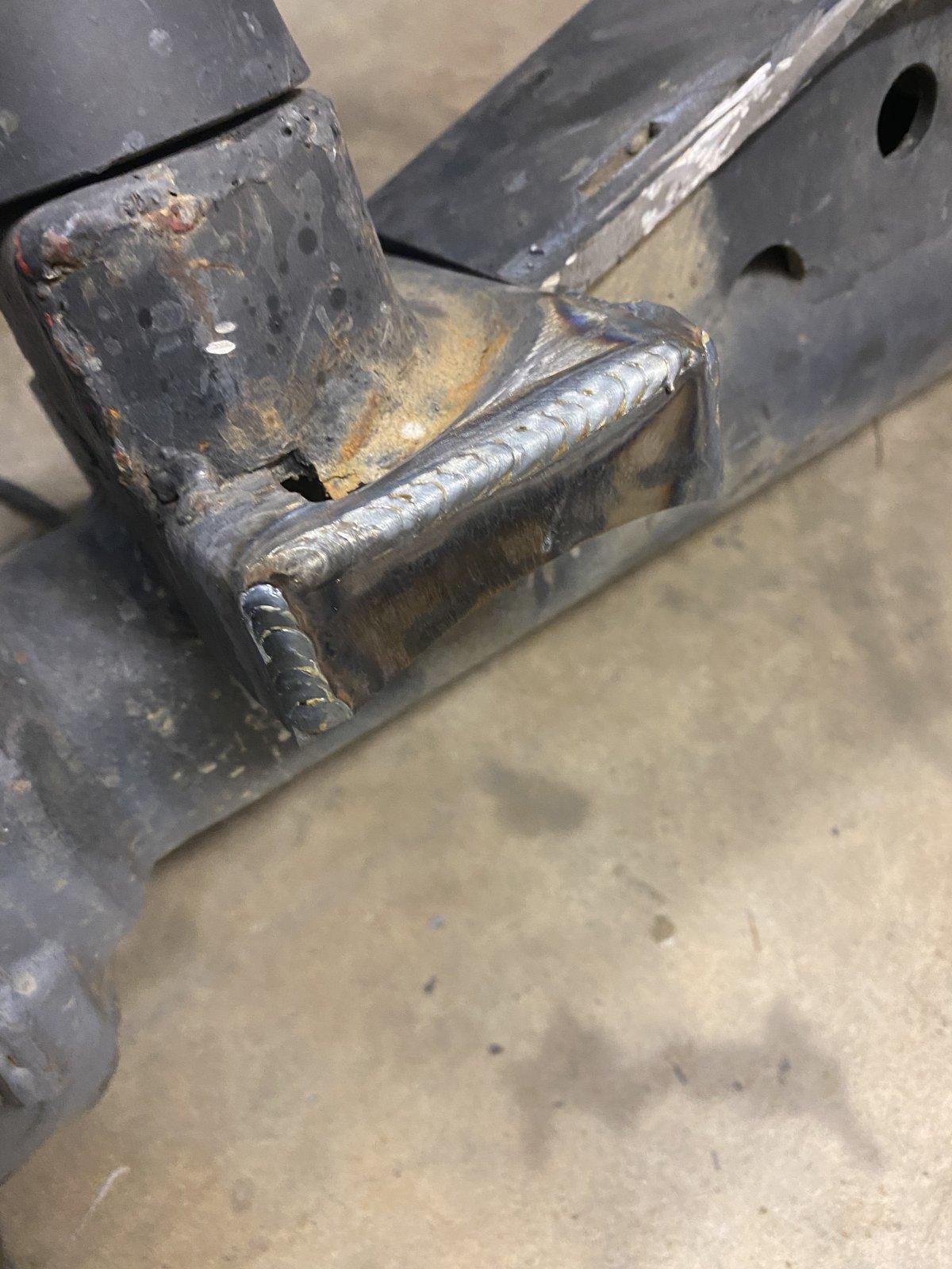

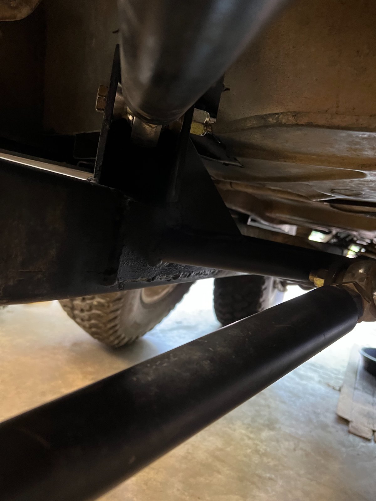

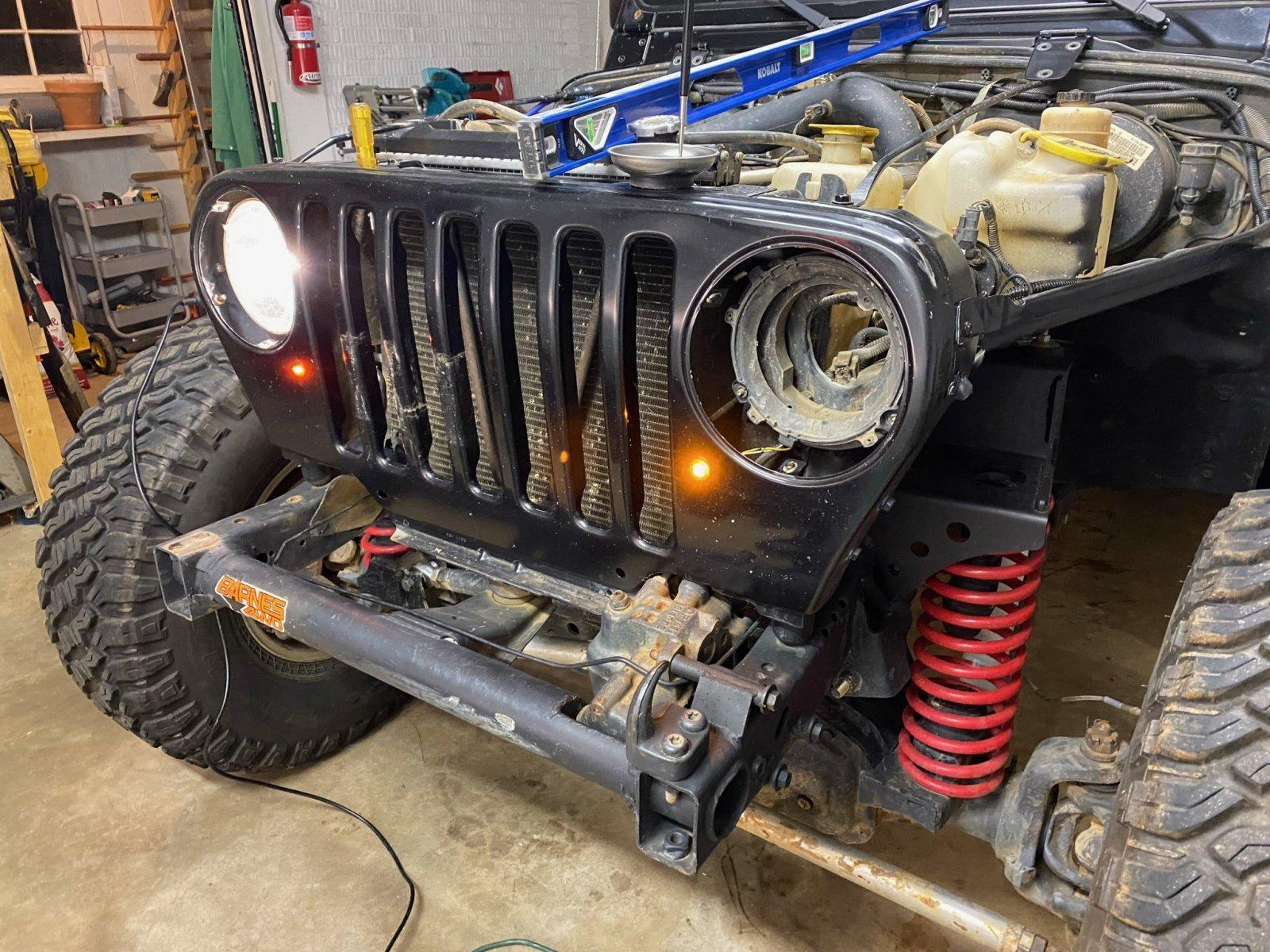

Crammed in this last minute project too before the move. I cut the front spring perches out and zipped in my new perches and towers. These are a set of Jeep TJ/LJ one ton swap, stock tower height perches from Artec. I bought them several months before and they sat on the shelf like all new parts do collecting dust. These perches are designed for one ton swaps with superduty axle truss kits from Artec. they push the perch and tower outboard further to eliminate the weird bow in the spring and angle in the shock caused by the differences in width. Unfortunately Artec stopped making these and I think they need to bring them back because they are the boom! I reused my bump stop collars and made some new bumpstops with thick wall tubing I had laying around. Shocks and springs also got a quick blast of rustoleum.

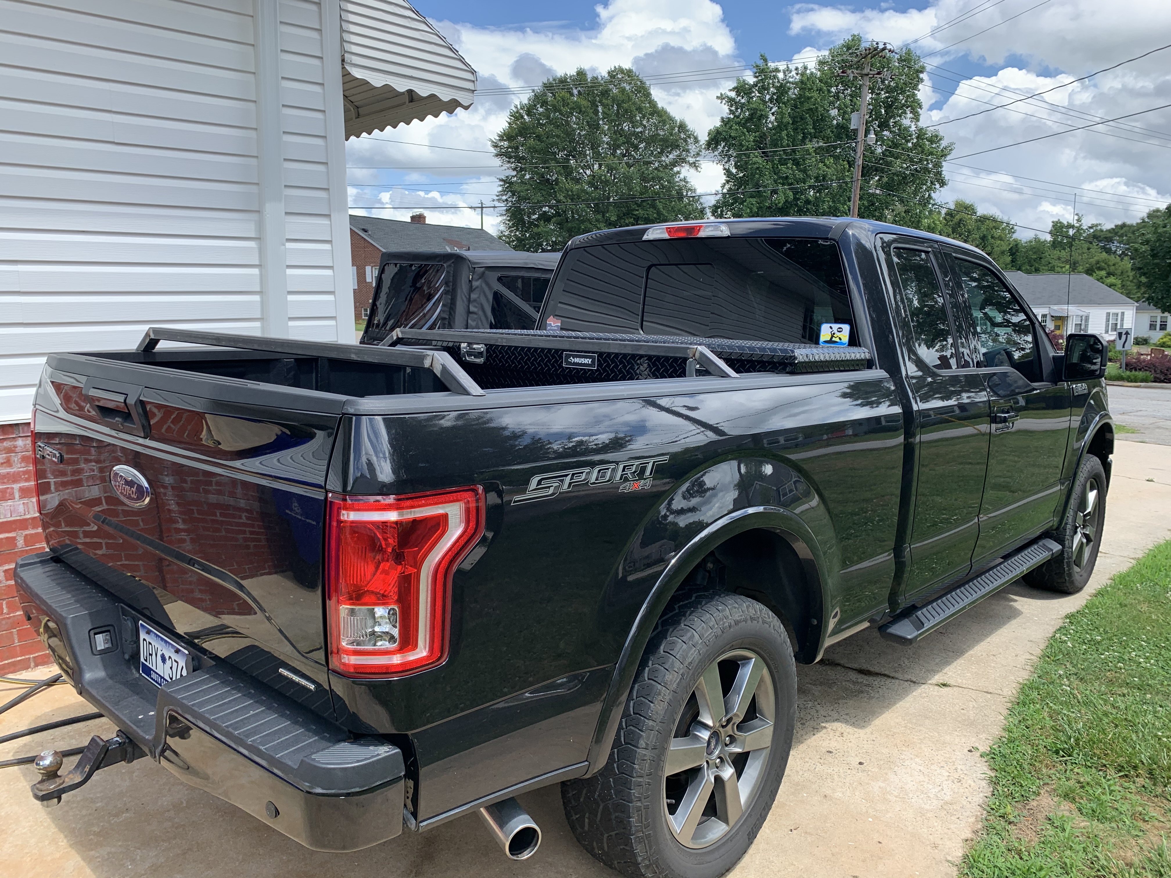

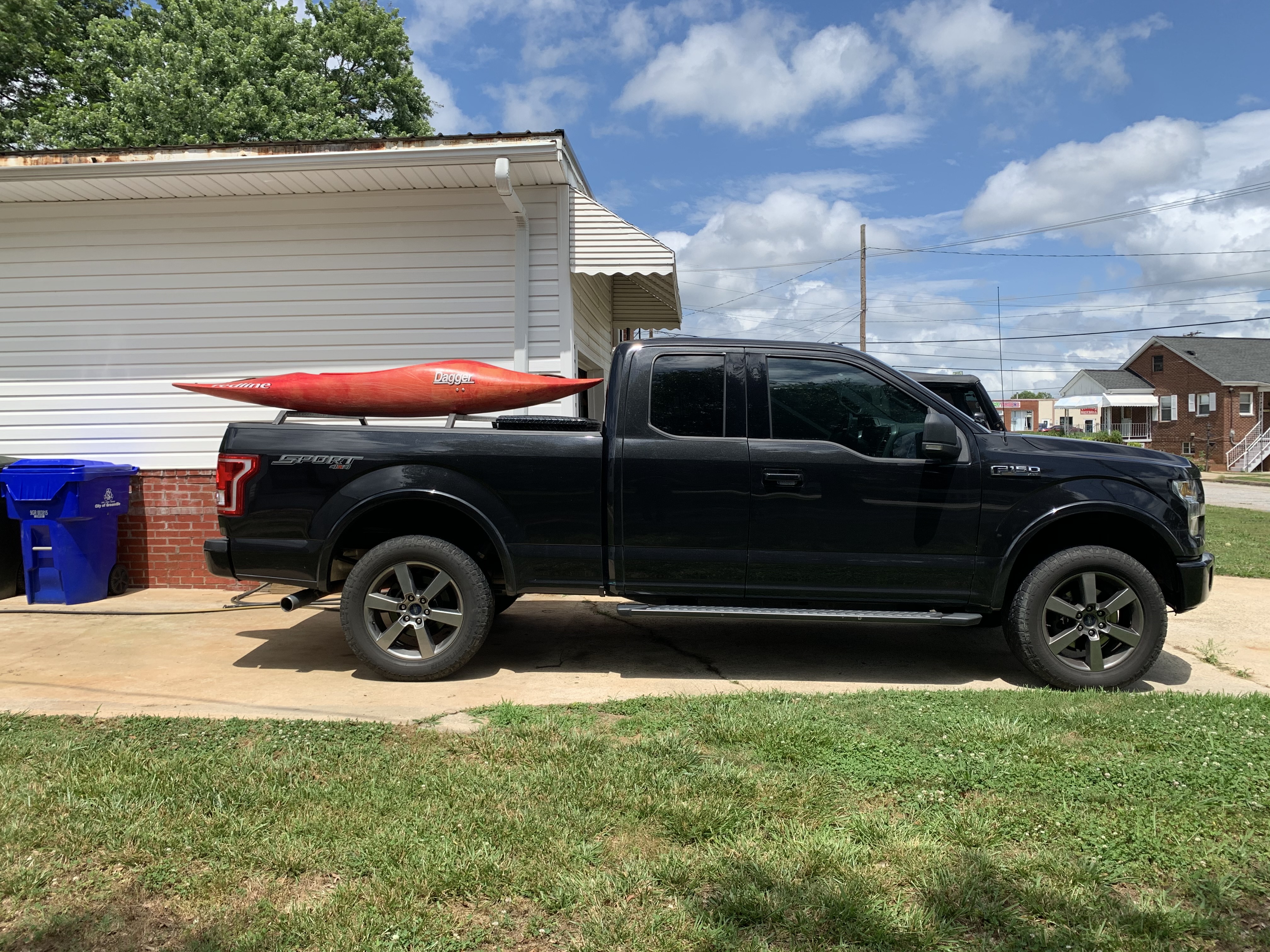

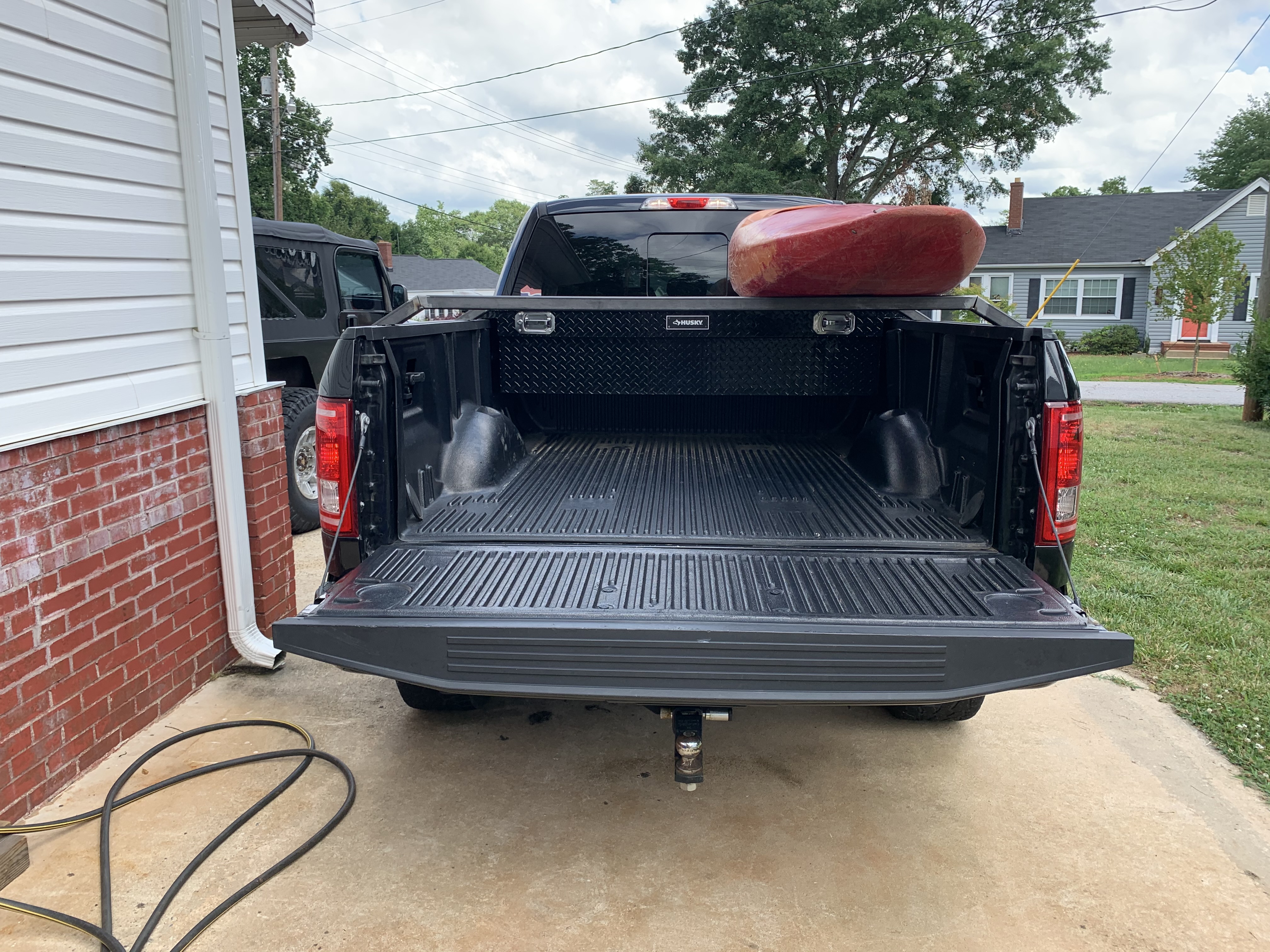

Just before the move, I whipped up one more side project but this time it was for the Grand Canyon trip and hopefully to use for a pop up truck tent down the road when wheeling. A couple of low Profile crossbars made from .120 wall 1.25" square DOM. Easily carried my kayaks across the country and back while still having all the bed space for camping gear.

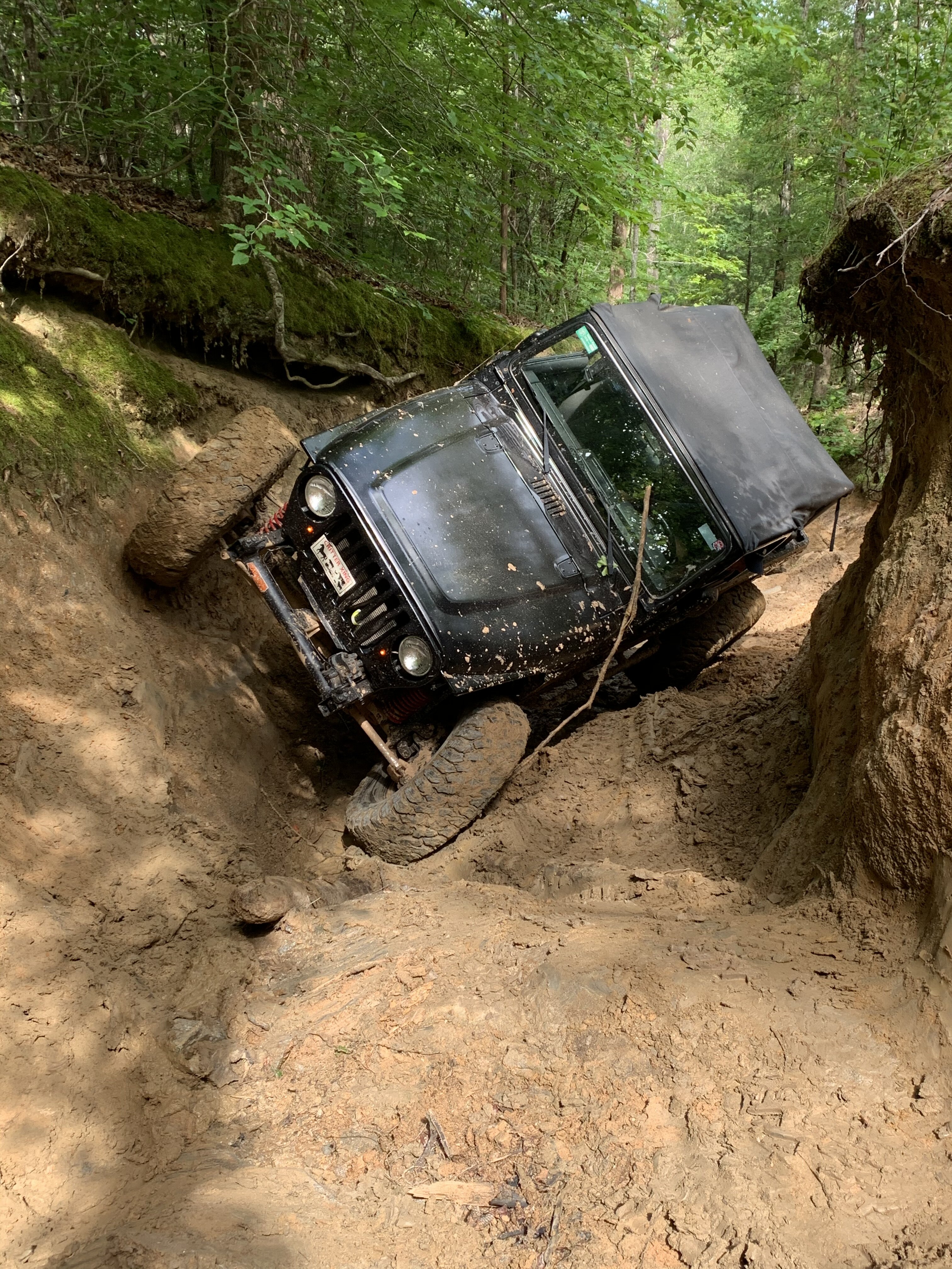

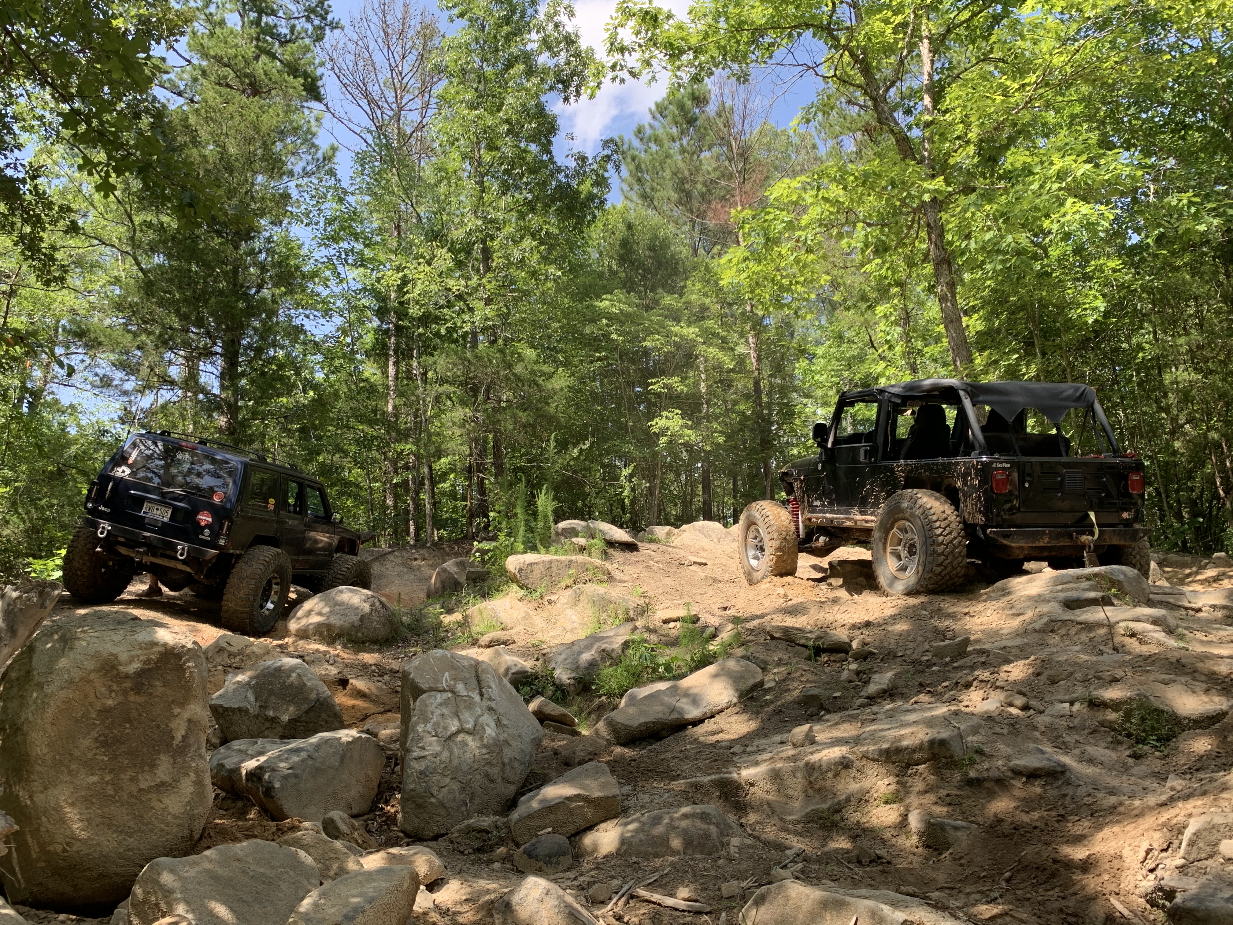

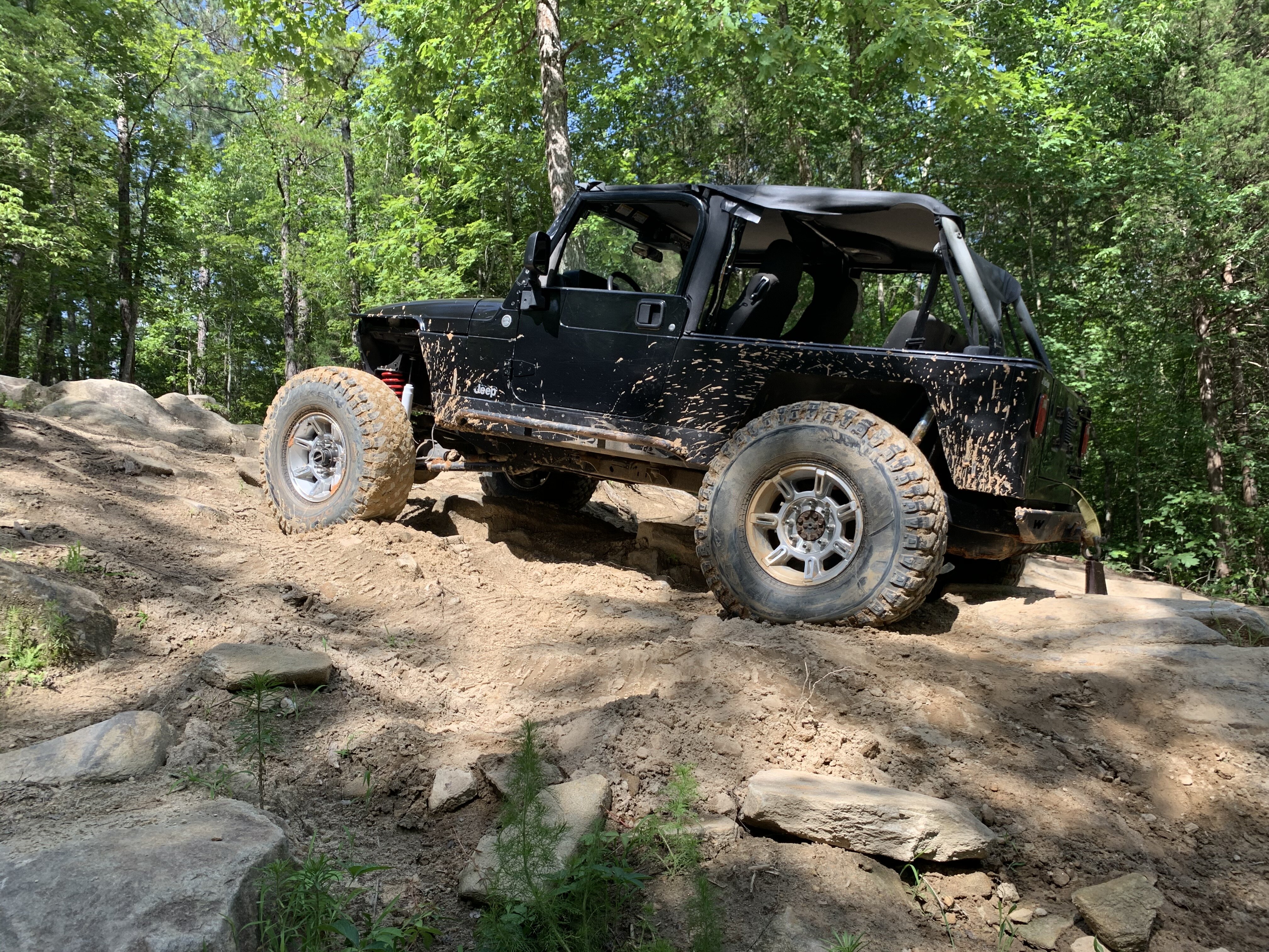

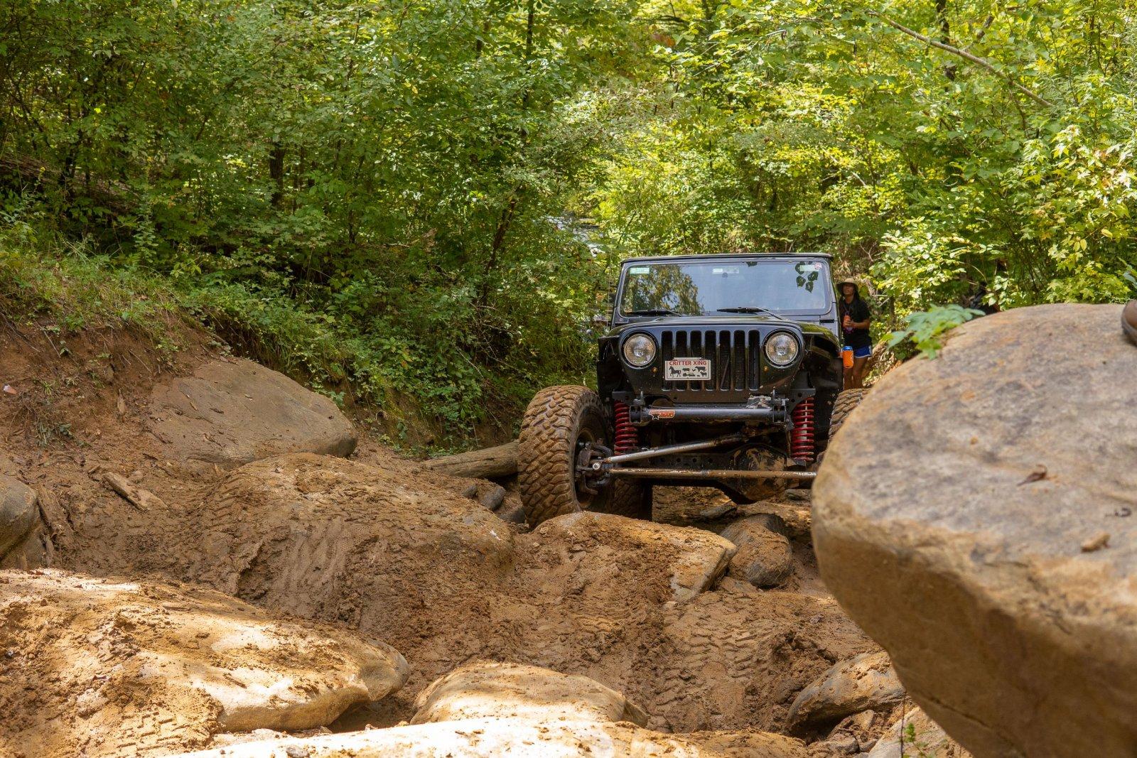

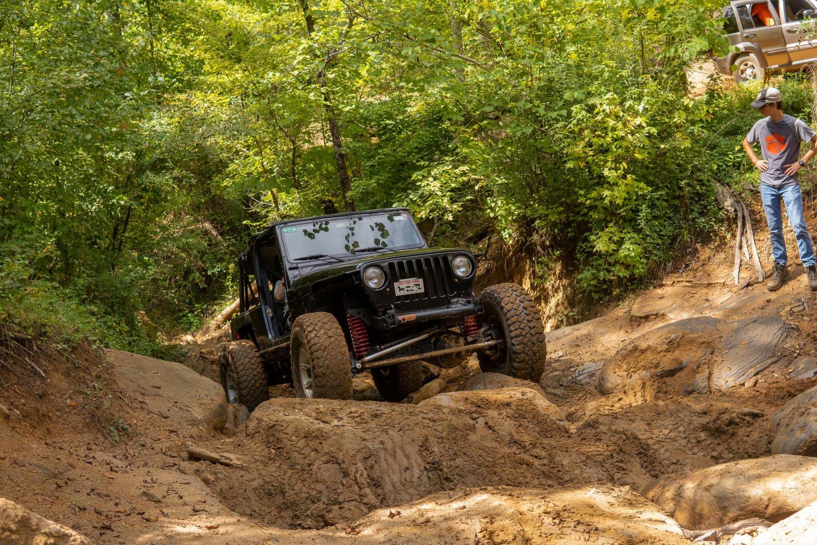

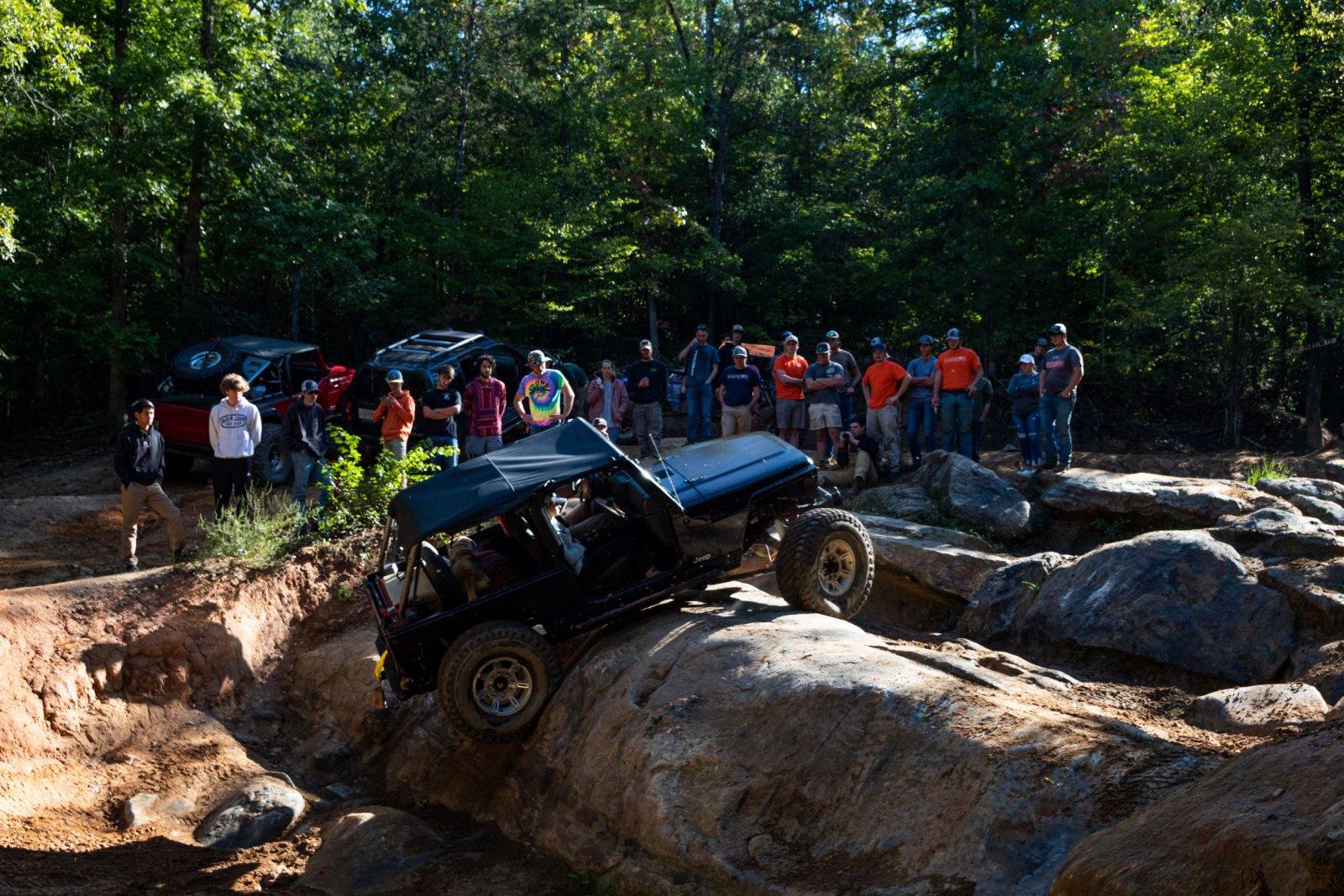

The week before move out my buddy talked me into getting a weekend of wheeling in. So the LJ hit the trails at Gulches and I was not disappointed with the new spring perches and shock towers.

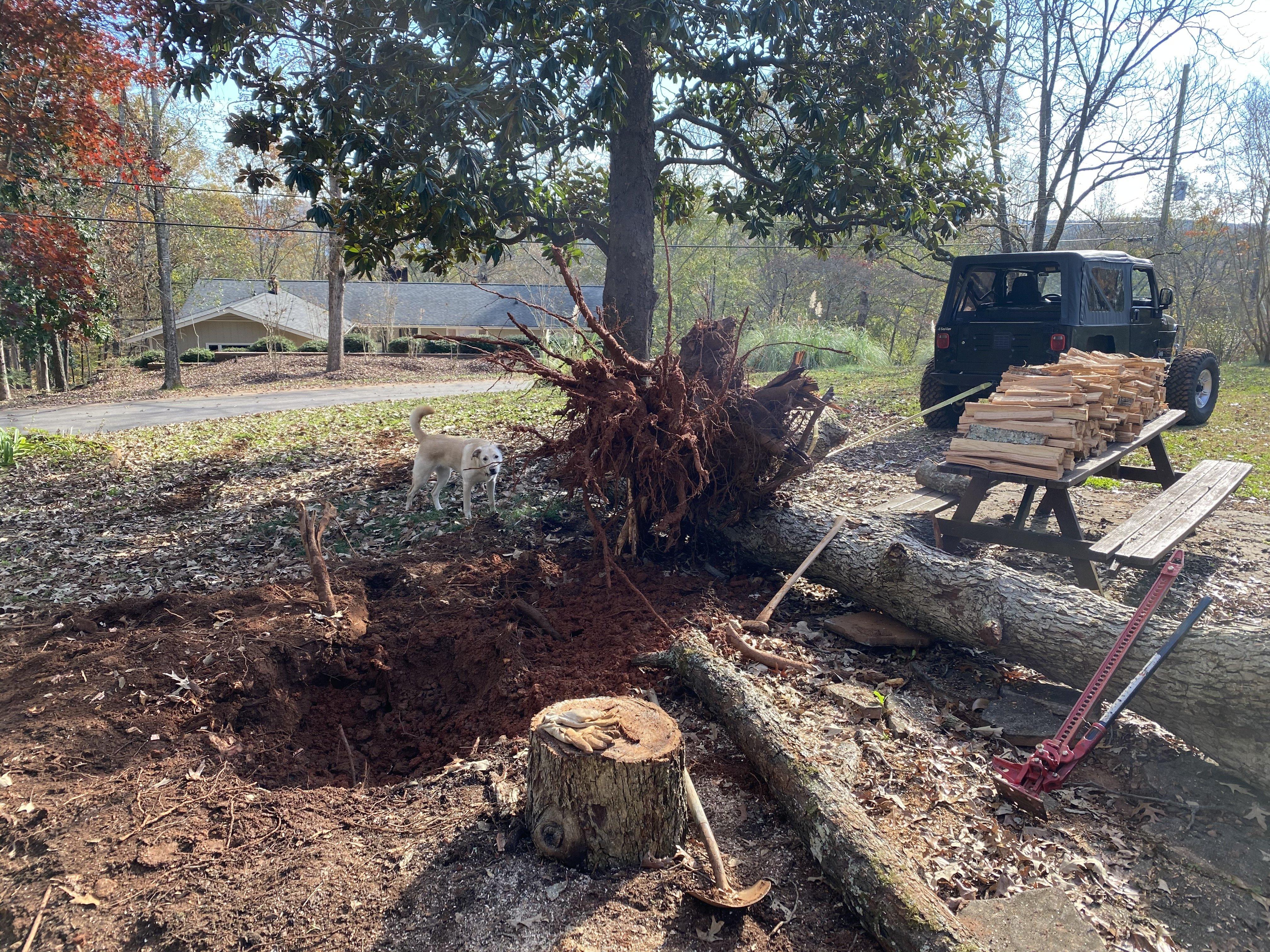

Got any updates on the one ton LJ?

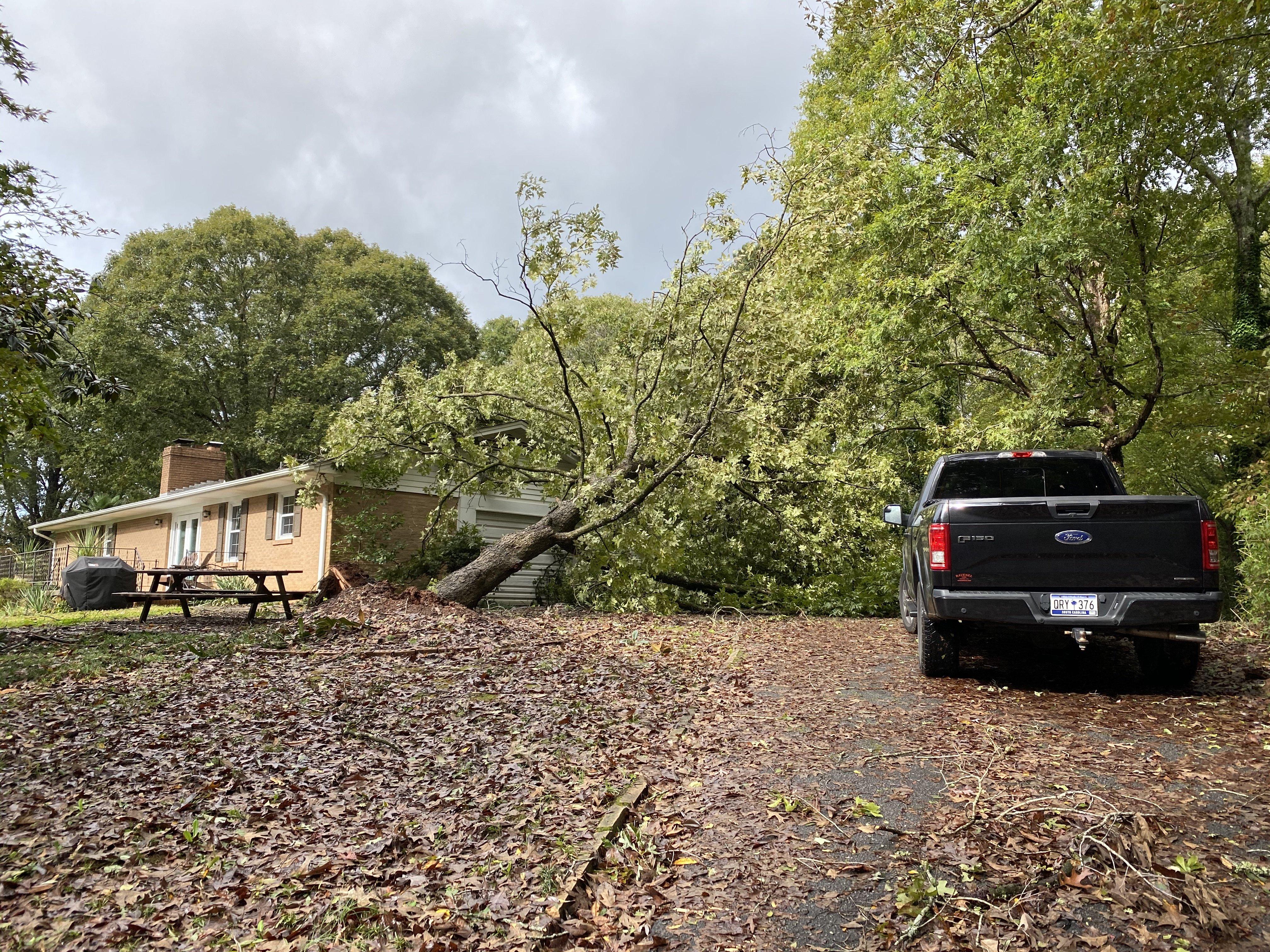

It's got a leaky rear right tire? lol. No, unfortunately, with most of my time and energy being directed toward the new house the LJ has been on hold. Once I get the garage more user friendly I think I will start back into it. Most use it got recently was I used it to pull a tree of he roof of my house that had fallen during one of the tropical storms.
